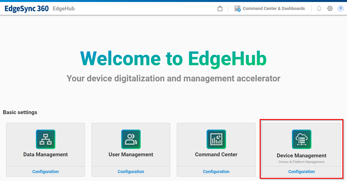

After the user logins EdgeHub, there are several icons displayed as below. Please click the Device Management icon to enter the main page of Device Management. overview-1-n.png

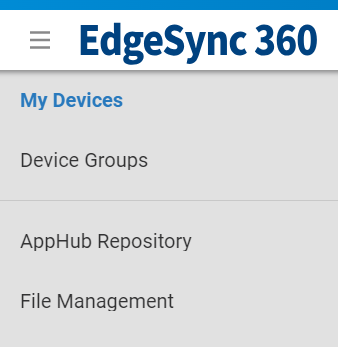

In the top left corner, click menu_small.png and user can see following menus. Click one menu item to switch to diffrent functions of Device Management.

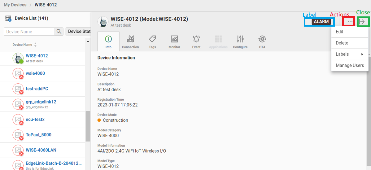

In the top right corner of side page, there are Device Labels(Please refer to the latter part of the document), Actions Menus, Close Side Page as the below figure. label-n.png

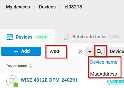

  1. Device Name/MAC filter: The user can select device name or MAC address and input a partial device name or mac address then press enter key. Devices which contain the search key word will be displayed. filter-name.png

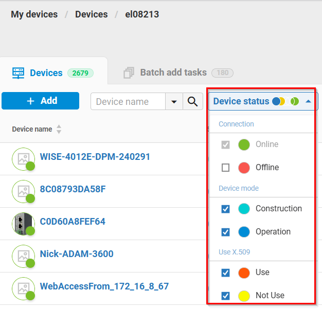

  2. Device Status filter: Users can use Device Connection(Online, Offline), Device Mode(Construction, Operation) or X.509(Use, Not use)to filter devices. filter-status.png

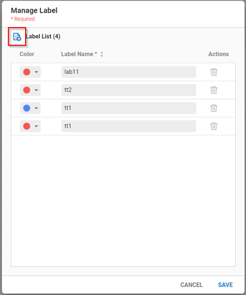

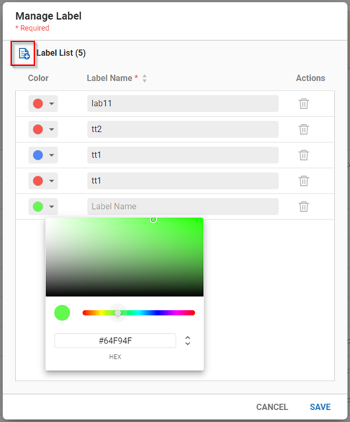

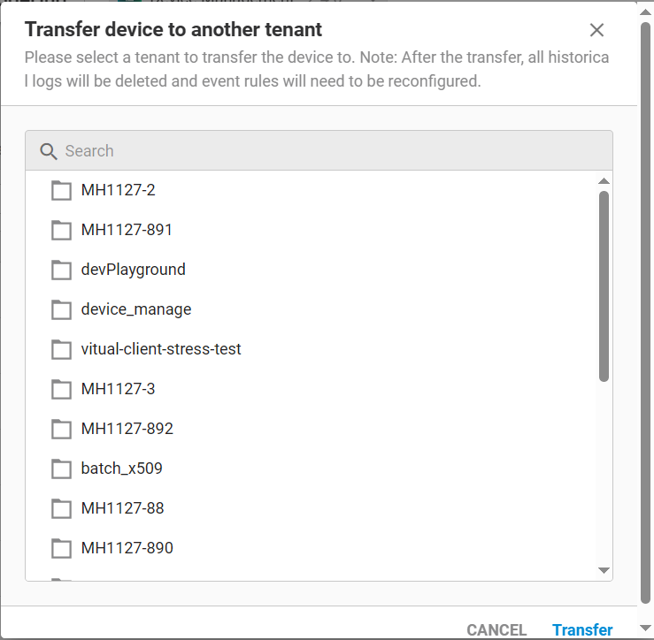

  3. The dialog is displayed which contains the list of current user's available tenants. Please choose the target tenant and click the Transfer button. mv-tenant-2.png

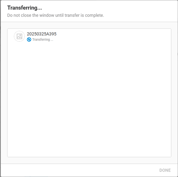

  4. The migration status of the device is displayed in the dialog. The status will change from Pending to Transferring and finally to Done. mv-tenant-3-2.png

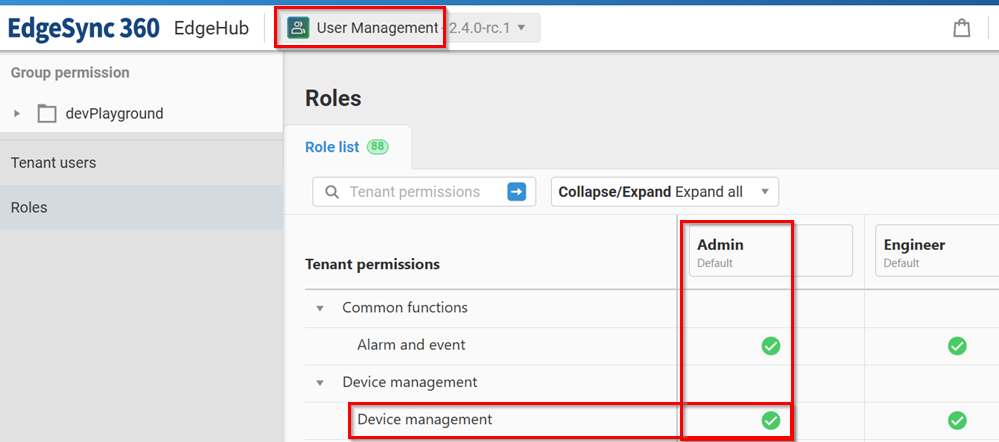

  1. The user must have the admin privilege in both the original and target tenant. Please check the user's priviledge in the role of the User Management. intro-2.png

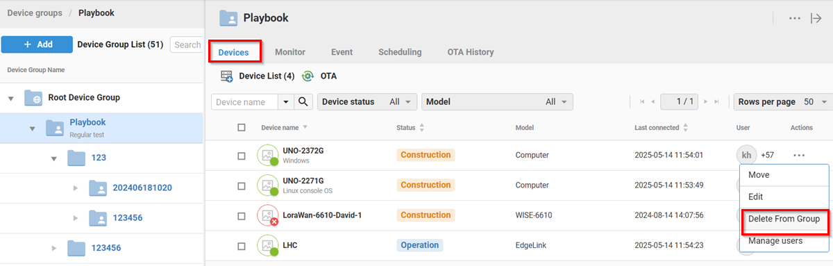

  2. If the device is bound to a device group, it cannot be migrated. As the below figure, the user can get the device's group name. intro-3.png Then remove the device from the device group. intro-4.png

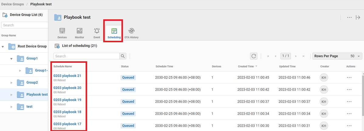

  3. If the device is bound to multiple scheduling rules, it cannot be migrated. The user must manually remove the device from scheduling rules. intro-5.png
