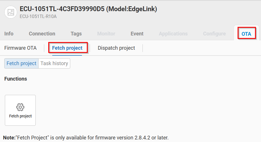

Device Management can request the device to upload its runtime project and store the runtime project. Then the project can be downloaded into the device by OTA. Please follow below steps:
  1. In the Fetch project sub-tab of the OTA tab, click the "Fetch project" button 1744960505328.png

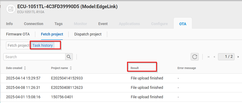

  2. The result of the project upload is displayed in the "Task history" tab. el-fetch-2.png

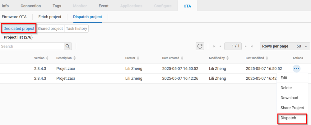

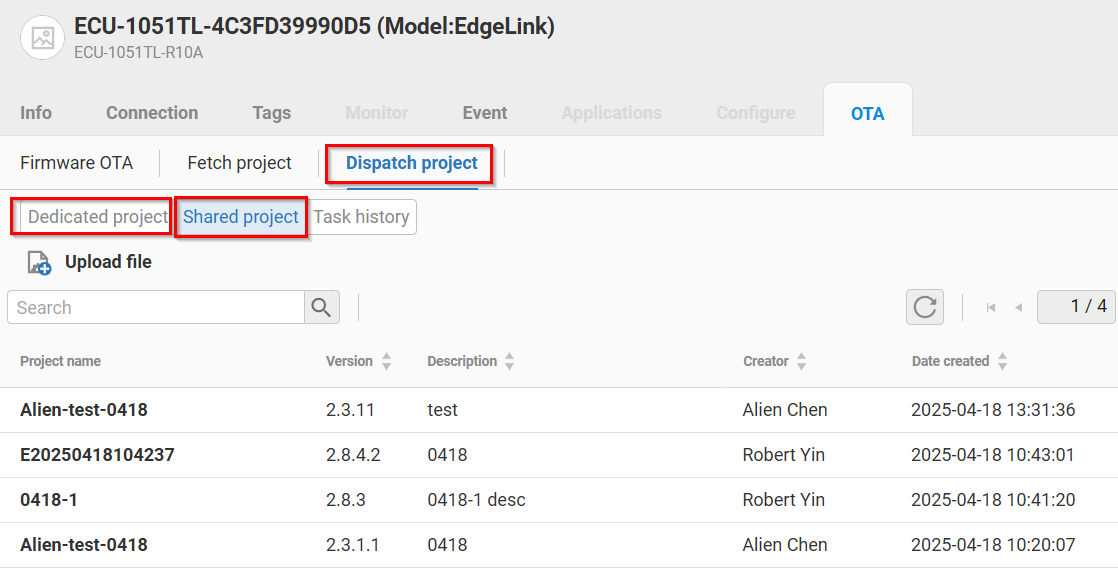

  3. The device uploaded project files are displayed in the "Dedicated project" sub-tab of the "Dispatch project" tab becaue these projects are only used by this device. 1744960337161.png
> Note: For each device, the maximum number of project files is 6. The oldest file is replaced if there are already 6 files for the device.
For each dedicated project file, the user can perform following actions:
  • Edit or Delete the project file
  • Download: Download the project file to the local compuer
  • Share the project file: Share(Copy) this project file to all the tenant users and this file can be found in the "File Management". After the file is shared, the user can dispatch the file to other devices.
  • Dispatch: Download the project file back into the current device.

Dedicated Project​
For the project which is fetched from this device:
  1. Please choose one project in the "Dedicated project" tab.
  2. Click the action button and choose the Dispatch button to perform the Project OTA. el-project-dedicate.png

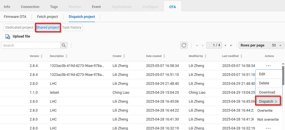

Shared Project​
For the project which are used for all devices in the tenant:
  1. Please choose one project in the "Shared project" tab.
  2. Click the action button and choose the Dispatch. The user can choose if the Project OTA should overwrite the system setting. If user clicks Overwrite setting, all settings in EdgeLink project will be overwrite in the device. el-project-shared.png

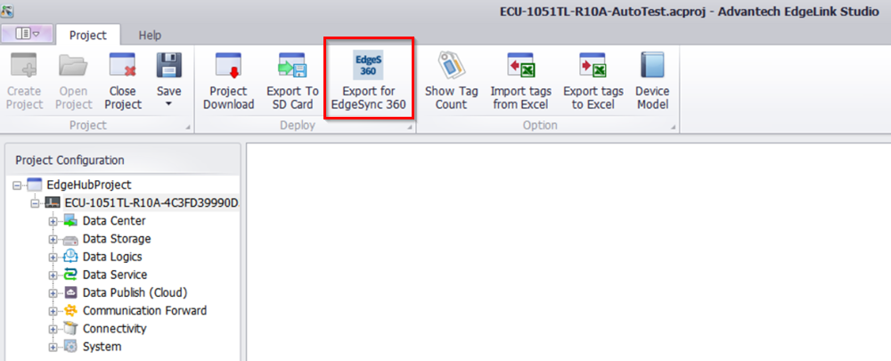

The project file can be obtained from the Advantech EdgeLink Studio. After the configuration of the project, the user can export the compiled project file and upload into the File Management. studio-1.png

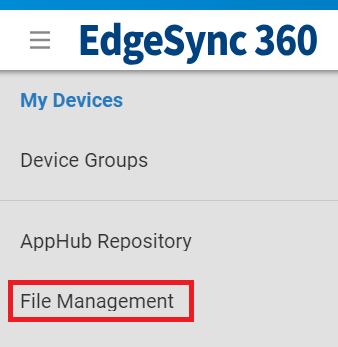

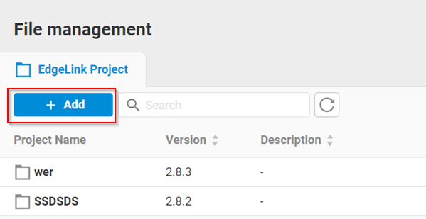

  1. In the top left corner, click icon-hangurger.png and select File Management to enter the page. file-1-n.png

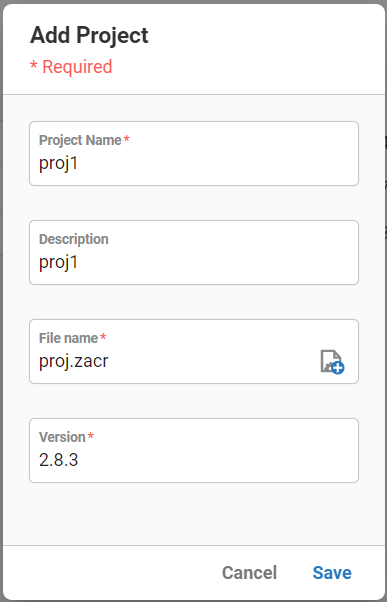

  3. Please fill in the Project Name, project file version(format: x.x.x) and click "+" to upload the project file. file-2.png
  4. Press the Save button and the project will be uploaded.

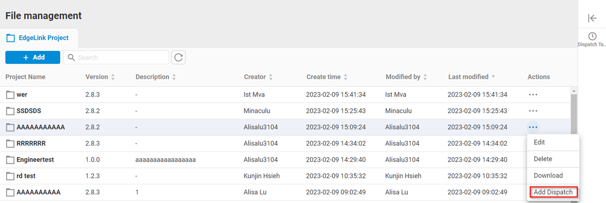

  5. To dispatch the project file, click Add Dispatch in actios of the selected project. file-4-n.png

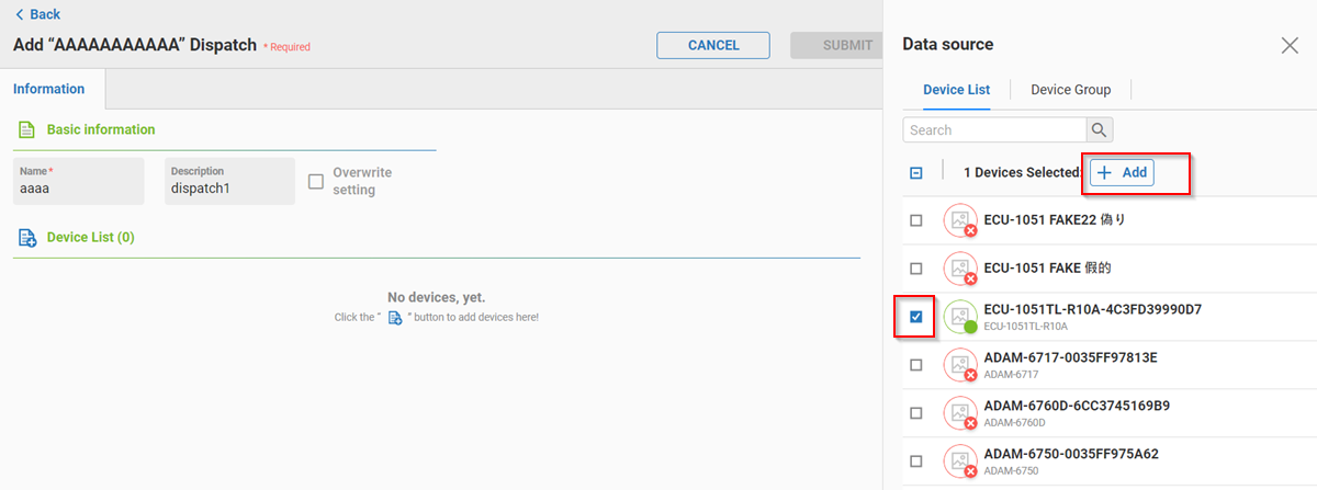

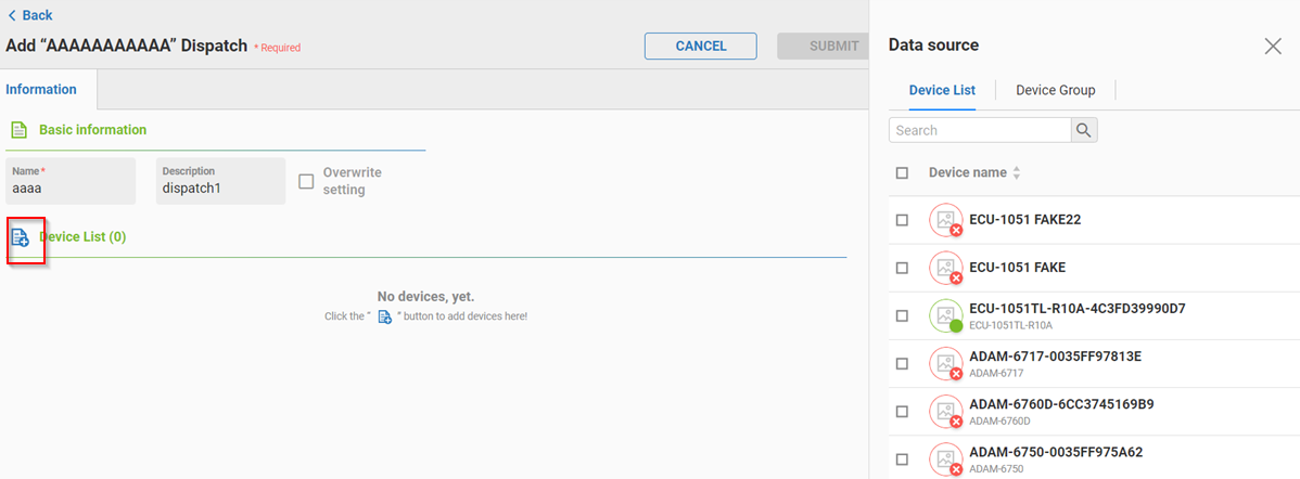

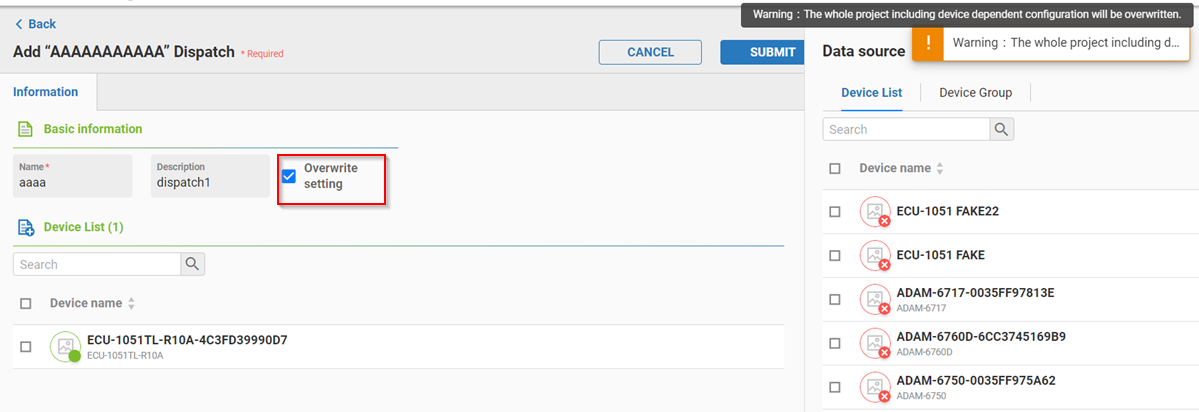

  6. Please fill in the dispatch name, description and click "+" to select target EdgeLink devices file-5-n.png
  7. Select target devices or target Device Group then click Add button file-6-n.png
  8. If the user selects the Overwrite setting, all settings in EdgeLink project will be overwrite in selected devices file-7-n.png
  9. Click SUBMIT to create dispatch task.

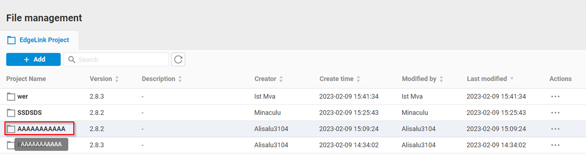

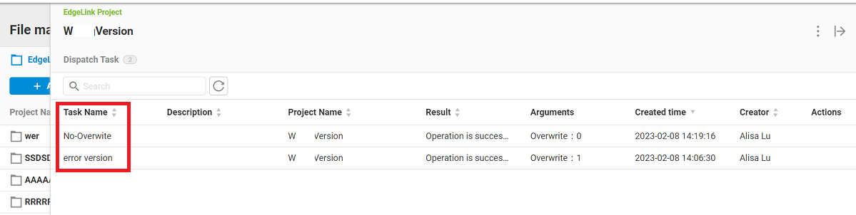

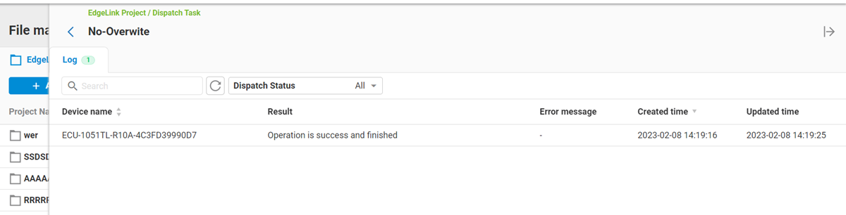

  10. To check the dispatch result, please click the project file. file-8-n.png
  12. Please click the task name and user can see the dispatch result of all selected devices. file-11-n.png

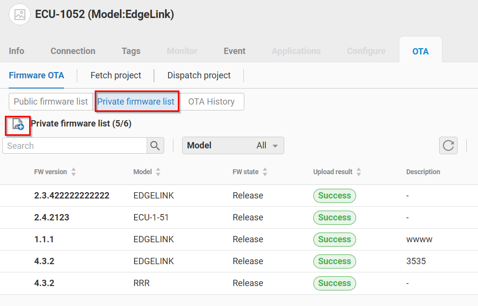

  • Private firmware: Customized firmware released by Advantech for private use. This type of firmware is uploaded by the user and only available within the user's tenant. A maximum of six firmware files can be uploaded per device model. el-fw-priv-1.png
Please follow below steps to perform firmware OTA:

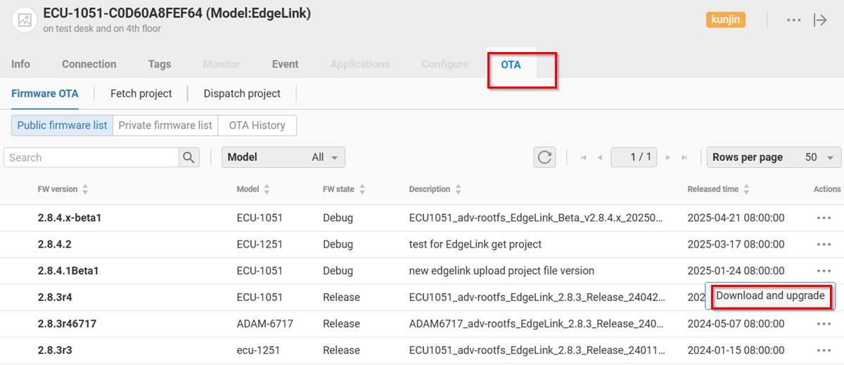

  1. In the Firmware OTA Tab, choose the public firmware or private firmware.
  2. There is a list of availabe firmwares for EdgeLink. Please choose the desired firmware and click "Download and Upgrade" to start Firmware OTA. el-fw-1.png

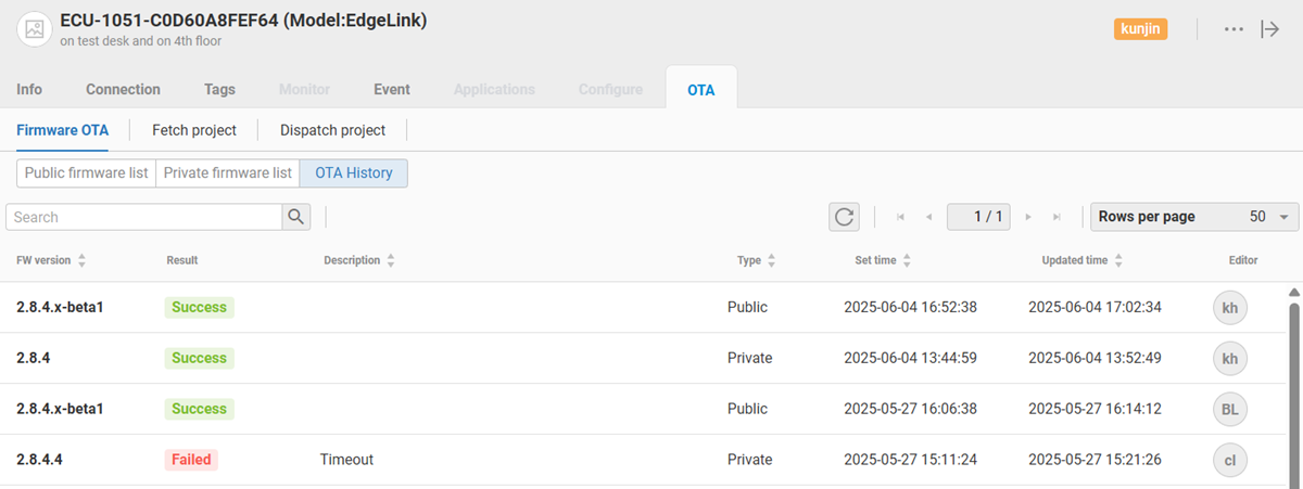

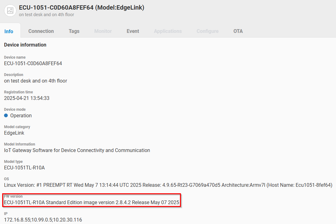

The firmware version of the device can be found in the info tab. el-fw-3.png

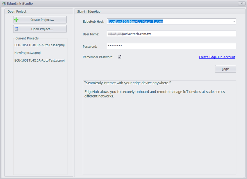

🔹EdgeLink Studio Integration

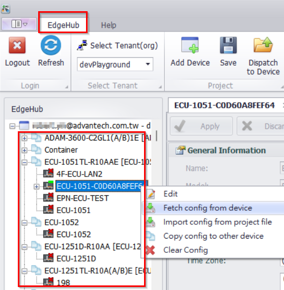

EdgeLink Studio supports the user login of the Device Management system. studio-3.png
After the user logins, the EdgeLink devices in the Device Management system are displayed. Thus the user can not only manage devices in the local network but also devices in the remote network. studio-4.png
