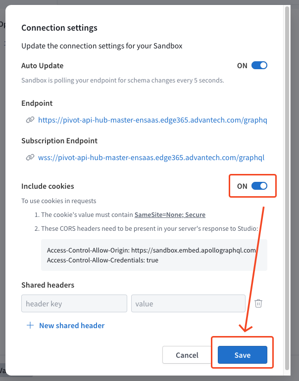

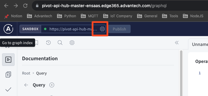

    EdgeHub GraphQL API utilizes cookies to record relevant login information. To ensure the proper functioning of the playground, settings must be configured on the interface.
    • Click on the settings icon in the top left corner of the screen. graphql-api-example-image 2.png
    • In the popped-up dialog box, change the Include cookies setting to ON, then click Save to save the configuration. graphql-api-example-image 3.png
  • After configuration, you can enter GraphQL commands in the center of the screen according to the instructions in this document, click Run, and finally, obtain the API return results on the right side of the screen. graphql-api-example-image 4.png

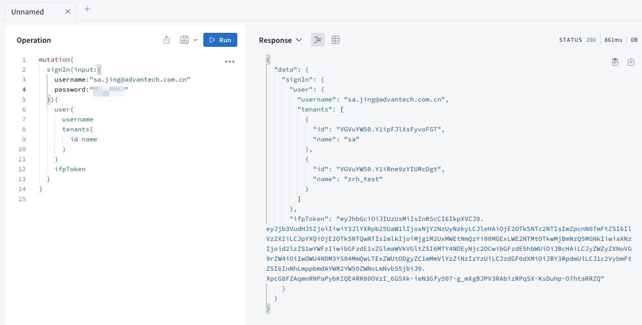

2.1 signIn​
  • Introduction graphql-api-example-image.png Log in with valid account credentials. Upon successful login, you can obtain information about the tenant with user permissions and Token information.
  • Request
    mutation{
    signIn(input:{
    username:sa.jing@advantech.com.cn
    password:123qwerty
    user{
    username
    tenants{
    id name
    ifpToken
  • Response
    data: {
    signIn: {
    user: {
    username: sa.jing@advantech.com.cn,
    tenants: [
    "ifpToken": "eyJhbGciOiJIUzUxMiIsInR5cCI6IkpXVCJ9.eyJjb3VudHJ5IjoiVFciLCJjcmVhdGlvblRpbWUiOjE2NjczNjY3NDIsImV4cCI6MTY4ODQ1OTk1NCwiZmlyc3ROYW1lIjoiU2EiLCJpYXQiOjE2ODg0NTYzNTQsImlkIjoiY2I5MmU2M2YtNWE2ZS0xMWVkLTgyNzYtMGE1ODBhZGY0MGNkIiwiaXNzIjoid2lzZS1wYWFzIiwibGFzdE1vZGlmaWVkVGltZSI6MTY2NzM2ODAxOSwibGFzdE5hbWUiOiJKaW5nIiwicmVmcmVzaFRva2VuIjoiZGZiMmU2YzctMWEzZC0xMWVlLTg4YmQtMGE1ODBhZGY0MGRiIiwic3RhdHVzIjoiQWN0aXZlIiwidXNlcm5hbWUiOiJzYS5qaW5nQGFkdmFudGVjaC5jb20uY24ifQ.EHHy72agREj2GpNJ0Za-CzCxNyA8Xc3Zw2BGSzFemAqS06D_3MUCxndIqln8XkRtOBjVpzUFvSFkJqckF-obRw"

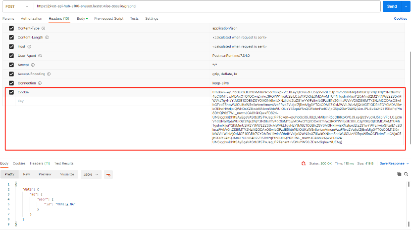

  • Note If you are integrating with EdgeHub's GraphQL API in the backend development, you must manually include the following information in the API cookie to use it.
    The content of the cookie is as follows:
    • IFPToken: Carry the content of ifpToken from the signIn request response body, for example: IFPToken=eyJhbGciOiJIUzUxMiIsInR5cCI6IkpXVCJ9.eyJjb3VudHJ5IjoiVFciLCJjcmVhdGlvblRpbWUiOjE2NjczNjY3NDIsImV4cCI6MTY4ODQ1OTk1NCwiZmlyc3ROYW1lIjoiU2EiLCJpYXQiOjE2ODg0NTYzNTQsImlkIjoiY2I5MmU2M2YtNWE2ZS0xMWVkLTgyNzYtMGE1ODBhZGY0MGNkIiwiaXNzIjoid2lzZS1wYWFzIiwibGFzdE1vZGlmaWVkVGltZSI6MTY2NzM2ODAxOSwibGFzdE5hbWUiOiJKaW5nIiwicmVmcmVzaFRva2VuIjoiZGZiMmU2YzctMWEzZC0xMWVlLTg4YmQtMGE1ODBhZGY0MGRiIiwic3RhdHVzIjoiQWN0aXZlIiwidXNlcm5hbWUiOiJzYS5qaW5nQGFkdmFudGVjaC5jb20uY24ifQ.EHHy72agREj2GpNJ0Za-CzCxNyA8Xc3Zw2BGSzFemAqS06D_3MUCxndIqln8XkRtOBjVpzUFvSFkJqckF-obRw
    • EIToken: Carry the content of ifpToken from the signIn request response body, for example: EIToken=eyJhbGciOiJIUzUxMiIsInR5cCI6IkpXVCJ9.eyJjb3VudHJ5IjoiVFciLCJjcmVhdGlvblRpbWUiOjE2NjczNjY3NDIsImV4cCI6MTY4ODQ1OTk1NCwiZmlyc3ROYW1lIjoiU2EiLCJpYXQiOjE2ODg0NTYzNTQsImlkIjoiY2I5MmU2M2YtNWE2ZS0xMWVkLTgyNzYtMGE1ODBhZGY0MGNkIiwiaXNzIjoid2lzZS1wYWFzIiwibGFzdE1vZGlmaWVkVGltZSI6MTY2NzM2ODAxOSwibGFzdE5hbWUiOiJKaW5nIiwicmVmcmVzaFRva2VuIjoiZGZiMmU2YzctMWEzZC0xMWVlLTg4YmQtMGE1ODBhZGY0MGRiIiwic3RhdHVzIjoiQWN0aXZlIiwidXNlcm5hbWUiOiJzYS5qaW5nQGFkdmFudGVjaC5jb20uY24ifQ.EHHy72agREj2GpNJ0Za-CzCxNyA8Xc3Zw2BGSzFemAqS06D_3MUCxndIqln8XkRtOBjVpzUFvSFkJqckF-obRw
    • IFPTenant:Carry the tenant ID from the signIn request response body, for example:
      IFPTenant=VGVuYW50.ZDet-2iqhavNUEAg

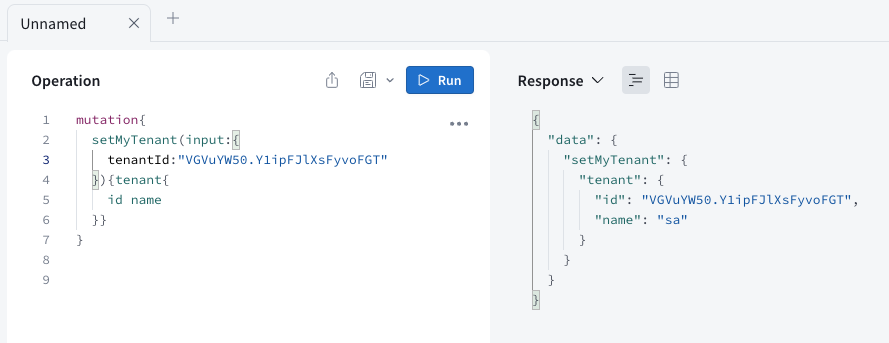

2.2 setMyTenant​
  • Introduction graphql-api-example-image 5.png Set the current tenant for the logged-in user. Subsequent API calls require information about which tenant's data is to be retrieved.
  • Request
    mutation{
    setMyTenant(input:{
    tenantId:VGVuYW50.Y1ipFJlXsFyvoFGT
    }){tenant{
    id name
  • Response
    data: {
    setMyTenant: {
    tenant: {
  • Note If you are developing the backend integration with EdgeHub's GraphQL API, this step may not be necessary. Simply ensure that the correct tenant ID (IFPTenant) is included in the subsequent API cookies.

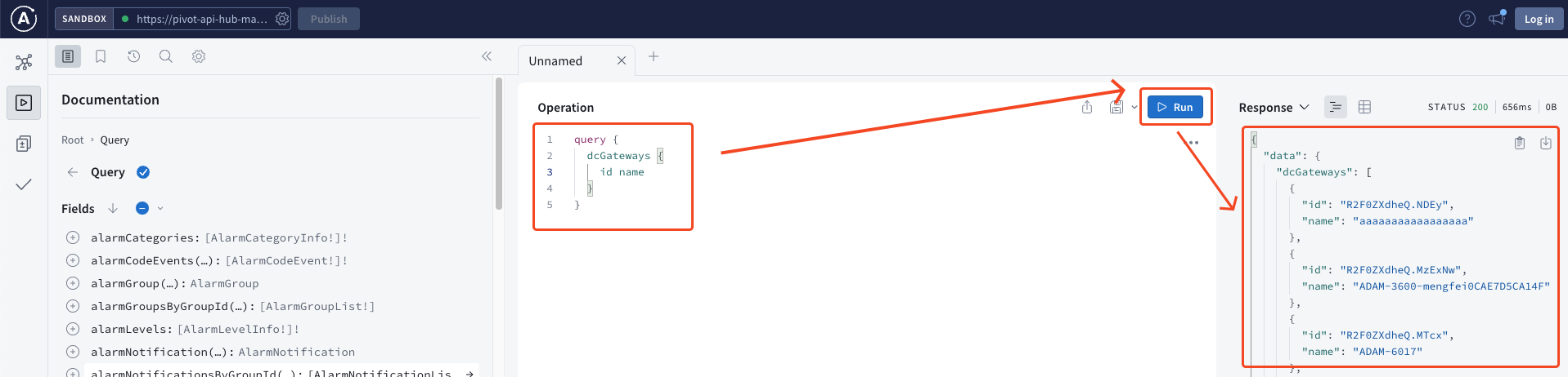

3.4.1 gateways (devices) information without tags​
  • Introduction Retrieve information about all gateways (devices) under a specific tenant. It is recommended not to simultaneously retrieve tag information when obtaining gateways to avoid impacting efficiency due to a large amount of returned data.
  • Request
    dcGateways {
    id
    name
    scadaId
    credentialKey
    currentStatus {
    status
    kind
    tagCount
  • Response
