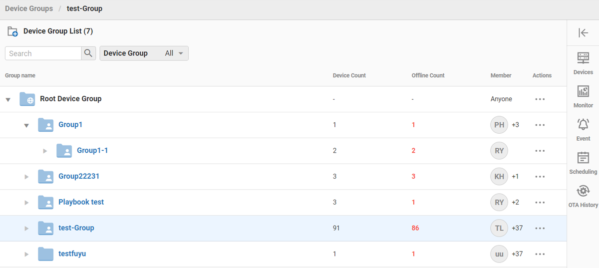

Device Group List contains group name, device count, device offline count, group members. group-2-n.png

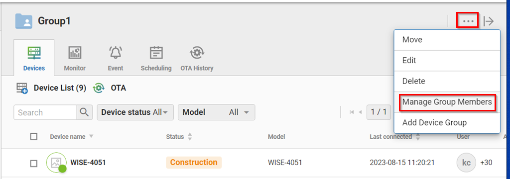

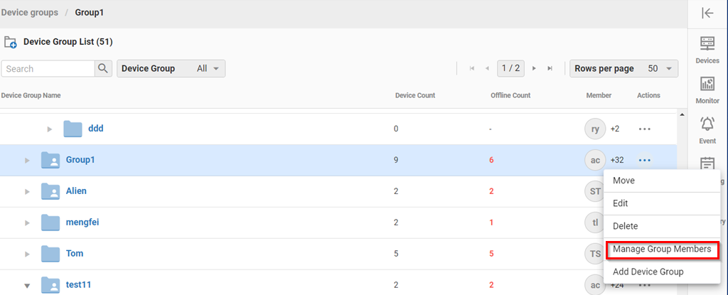

As below figure, you could manage group users in Device Group List: grp-user-1.png
Or you could manage group users in the Device Group: grp-user-2.png

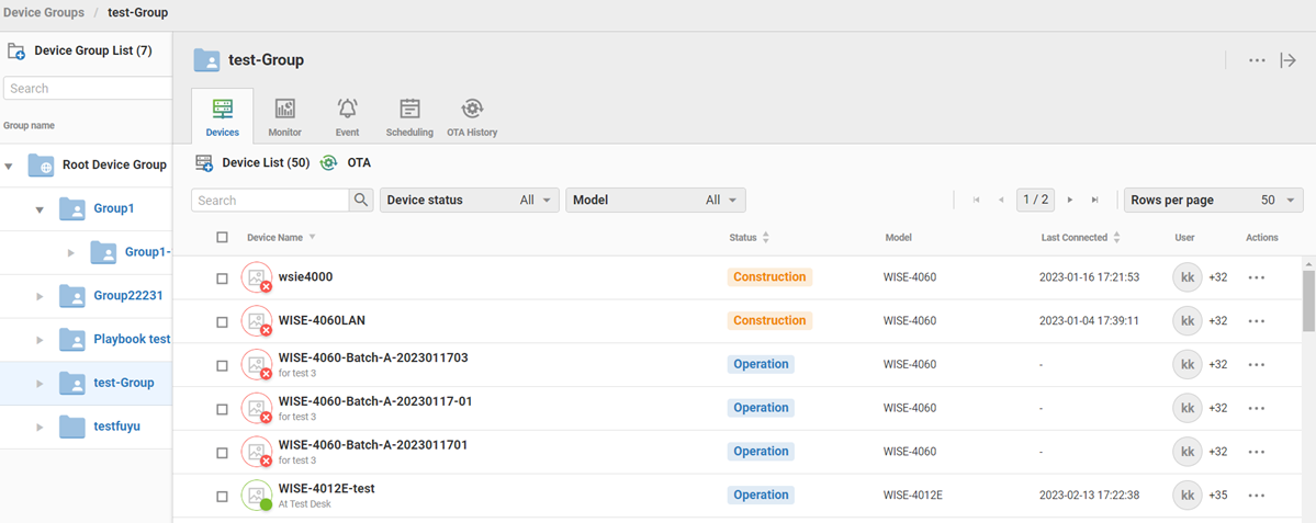

🔹 Device List and Filter​
Click one Device Group and a side page will appear to show related information. Default page is device list in the group. group-3-n.png

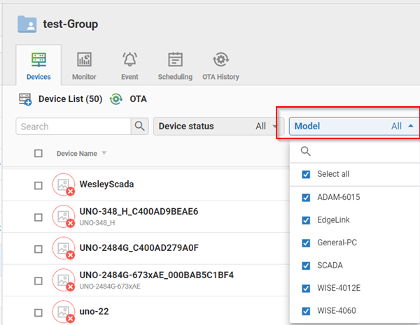

There are several ways to filter devices in Device List and these filters could be combined together.

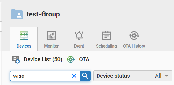

  1. Device Name: Please input partial device name and press enter. Devices which contains the search key word will be displayed. grp-filter-1.png

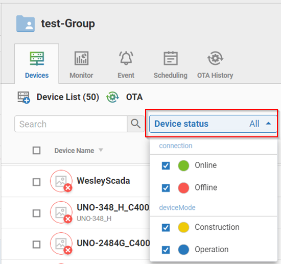

  2. Device Status: User could use Device Connection(Online, Offline) or Device Mode(Construction, Operation) to filter devices. grp-filter-2.png
  3. Device Model name: User could select desired Device Model name(ex: ADAM-6256, WISE-4012) to filter devices. grp-filter-3.png

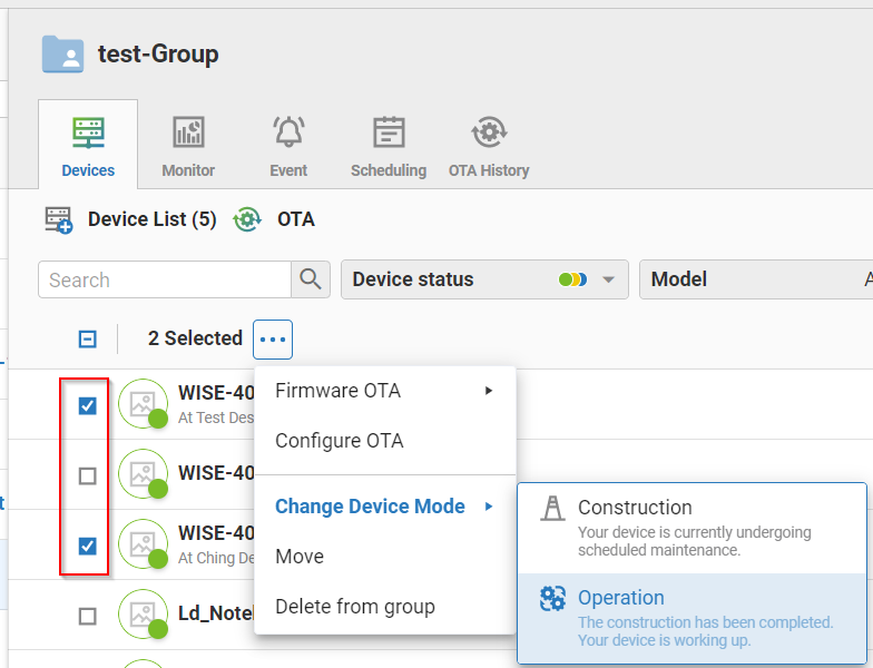

🔹 Multiple Devices Operation​
User could select multiple devices to perform the same operation. For example, use could select devices and change their Device Mode by click "..." button and select Change Device Mode as below figure: group-4.png

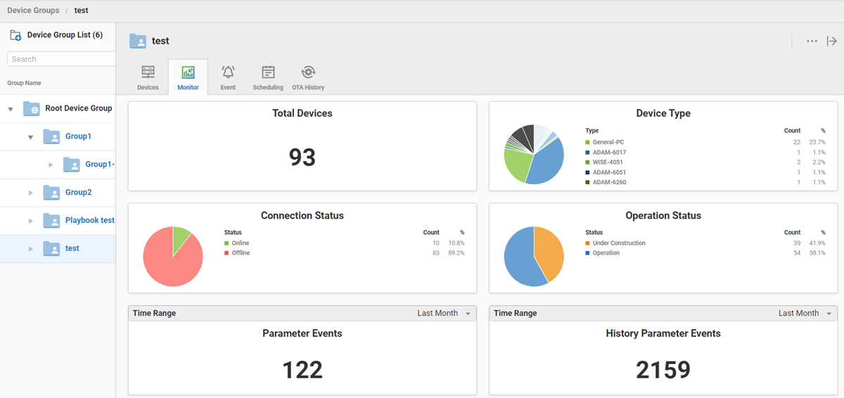

In Monitor tab, overview information for this Device Group is displayed. It includes: device amount, device module types, device connection status, device operation status, amount of current/history parameter events. grp-monitor-1-n.png

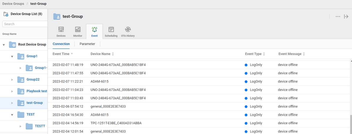

🔹 Group Events
In Event tab, there are Connection Event and Parameter Event for devices in the device group.

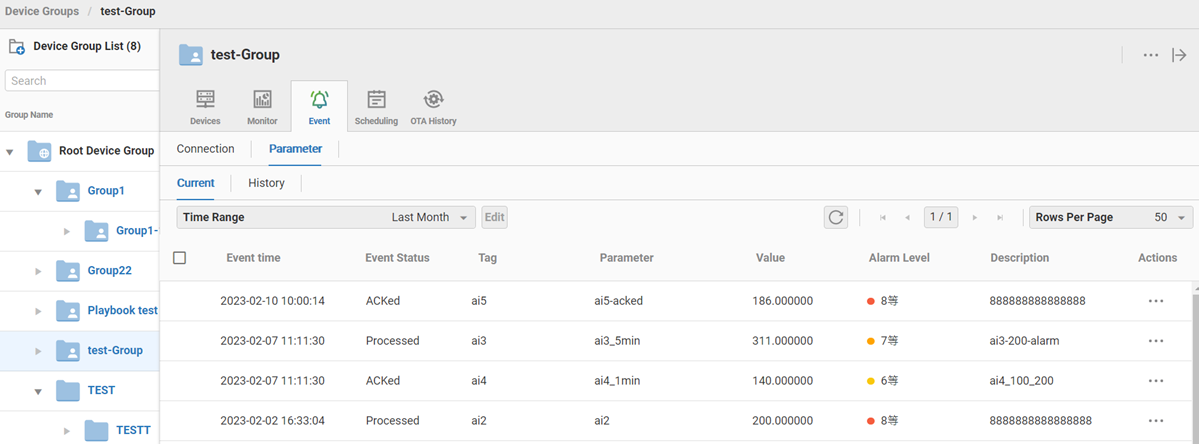

  • Connection Event: If device does not transmit MQTT messages more than 5 minutes, an offline event is raised. In Connection Tab, events of multiple devices are displayed. grp-event-1-n.png

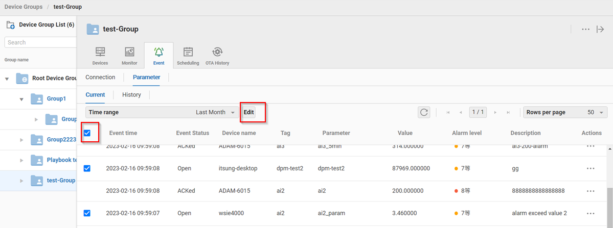

  • Parameter Event: If user has set Alarm rule for the parameter, a parameter event is raised when alarm condition is met. grp-event-2-n.png User could click check box before Event time to select multiple events and click Edit to perform actions. Please refer to Chapter: "Parameter Event" for details. grp-event-3-n.png

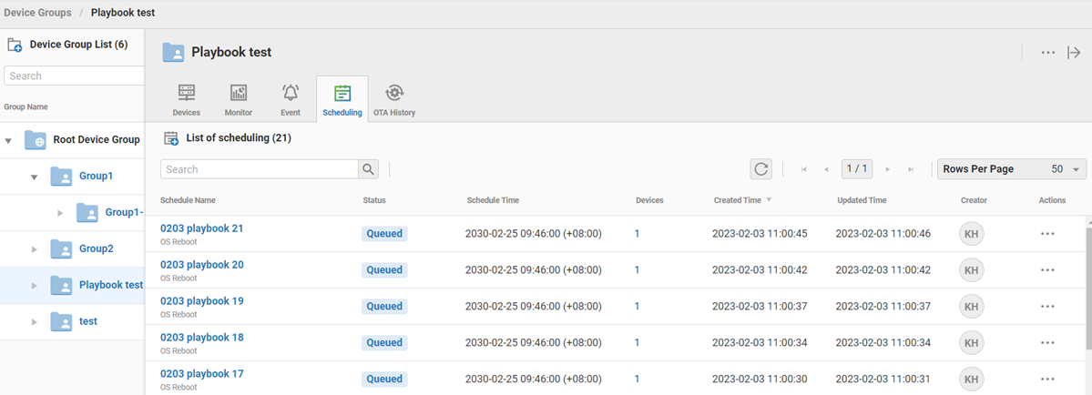

Scheduling is a set of commands that can be performed by devices at specified time. Each command can be set in specified order/sequence. One device group could contains multiple Schedulings. grp-pb-10-n.png

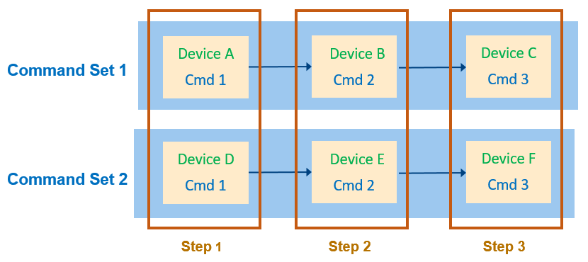

As the below figure, one Scheduling contains following items:
  • Device -- Devices which execute commands
  • Commmand -- Commands which execute in devices
  • Step -- Contains commands and devices -- System will execute commands sequentially according to Step number. User could choose:
    • Sync: waits for all commands to finished in current Step before execute next Step.
    • Non Sync: "not" waits for all commands to finished int current Step before execute next Step.
  • Command Set: -- Contains multiple Steps

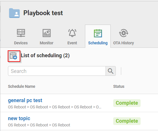

🔹 Create Scheduling​
Please follow below steps to create a scheduling:

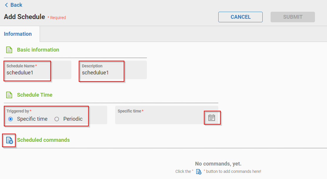

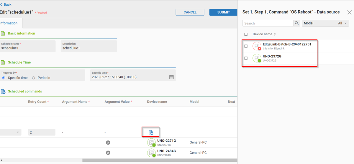

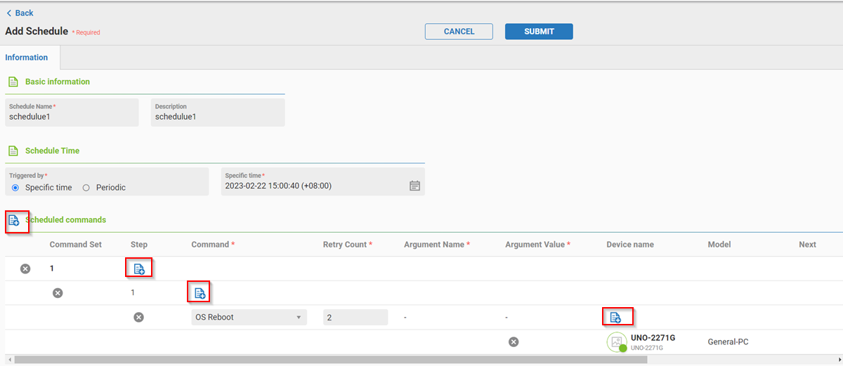

  2. Plase fill in Schedule Name and description. Then select type of scheduling: Specific time or Periodic. If user select Specific time, please click calender icon to set exectute time. grp-pb-4-n.png
  3. Click "+" icon near Scheduled commands to add Command Set. Then click "+" to add Step and Command. For each command, User could set retry count, device name. grp-pb-3.png
  4. Click "+" icon in Device Name field to select devices which execute this command. grp-pb-5.png

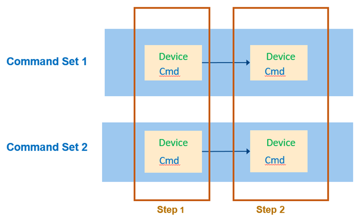

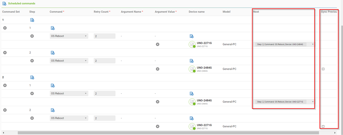

  5. If there are two Steps, user must set the Next Command in Next Step to specify the execution sequence.
  6. If there are two Command Sets and each Set has two Steps. User could click the "Sync Previous Step" checkbox to determine if Step 2 must wait until Step 1 (include Command Set 1 and 2) commands are finished. grp-pb-8.png
  7. Click SUBMIT button to create new Scheduling.
Below figure is the structure of above Scheduling Web UI: grp-pb-9.png

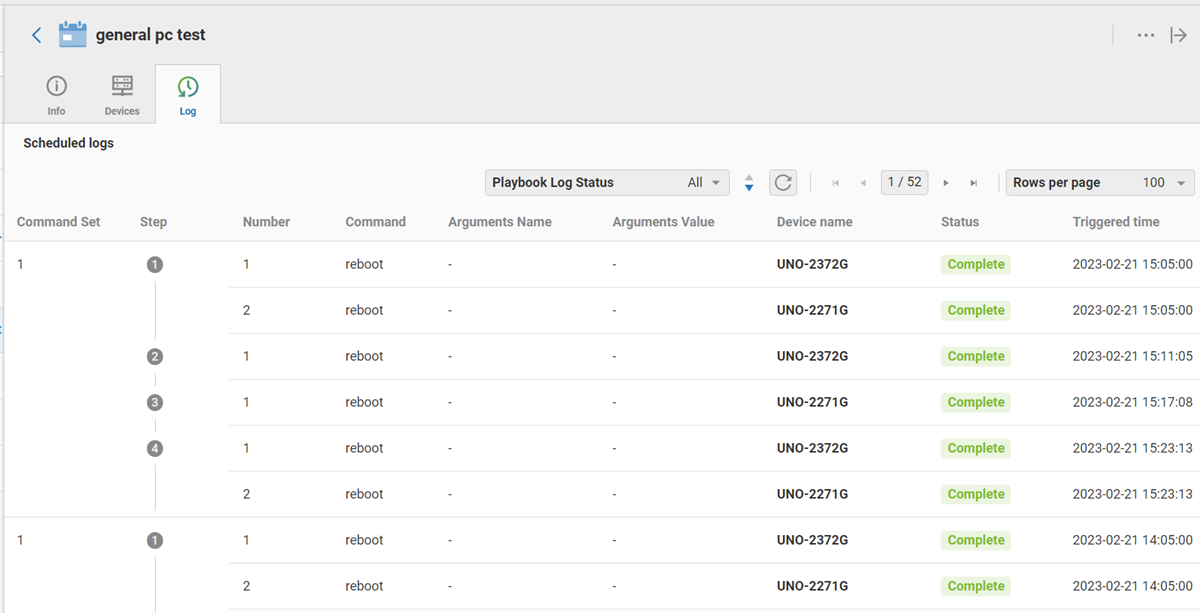

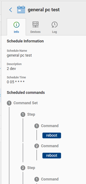

🔹 Scheduling Information​
To see the Scheduling information, user could click the scheduling name in Scheduling list. There are following tabs:
  1. Info: Display information about this Scheduling. grp-pb-result-1.png
  2. Devices: Display device list in this Scheduling.
  3. Log: Display result of this Scheduling. grp-pb-result-2.png

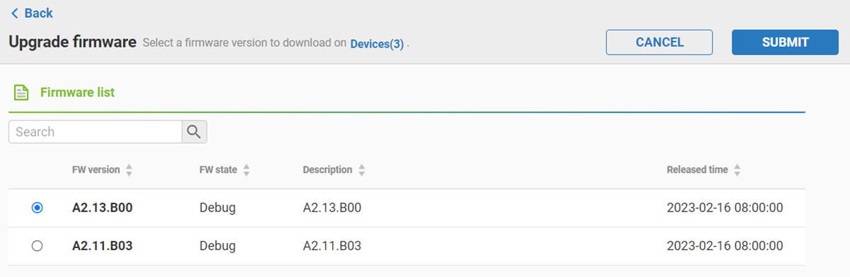

  1. As below figure, Click OTA icon and then select model name which user wants to perform firmware OTA grp-ota-1-n.png
  2. Select the desired Firmware version and click SUBMIT button grp-ota-2-n.png

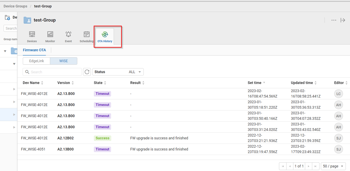

  3. Firmware OTA(FOTA) is performed and user could check progress/result in OTA History Tab. grp-ota-3-n.png
Method 2: Manually select individual devices

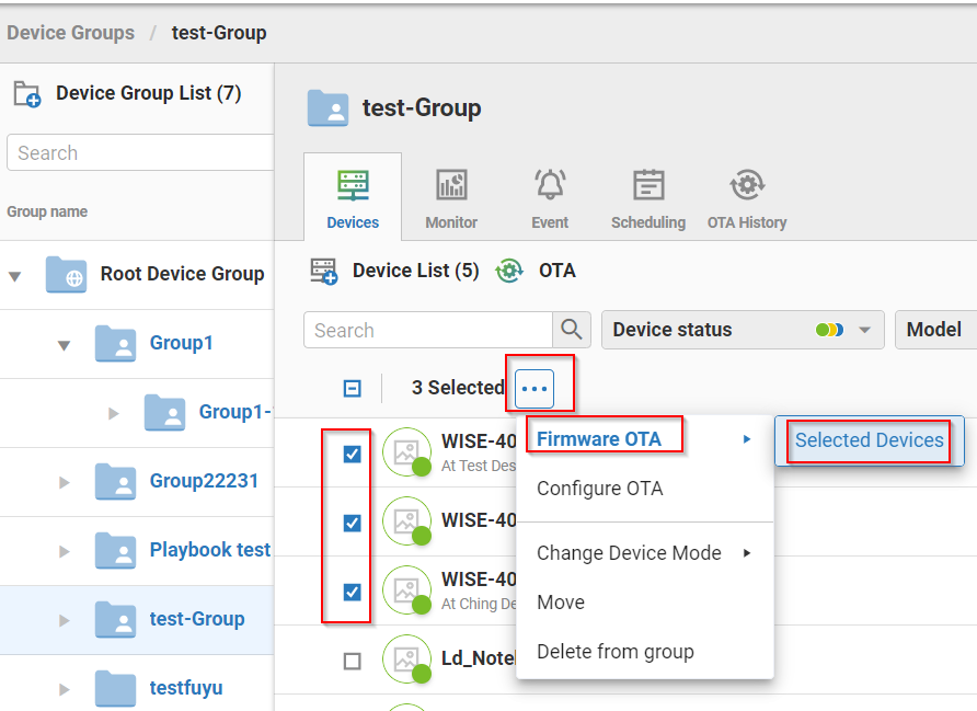

  1. As below figure, select devices and click "..." button. Click Selected Devices in Firmware OTA menu item. grp-ota-4-n.png
  3. Firmware OTA(FOTA) is performed and user could check the progress/result in OTA History Tab. grp-ota-3-n.png

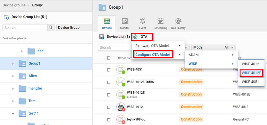

Method 1: Select devices by Model Name

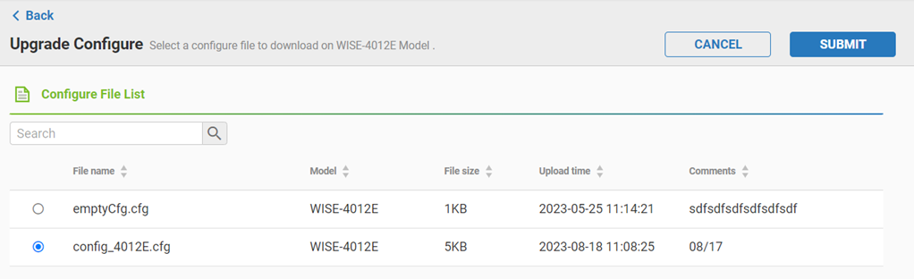

  1. As below figure, Click OTA icon and choose Configure OTA Model. Then select model name which user wants to perform Configuration OTA grp-cota-1-n.png
  2. Select the desired Configuration file and click SUBMIT button grp-cota-2-n.png

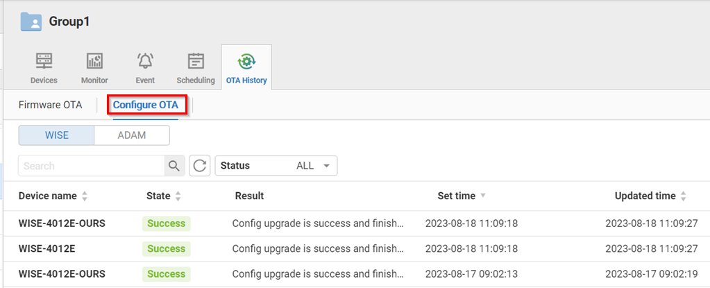

  3. Configuration OTA(COTA) is performed and user could check progress/result in OTA History Tab. grp-cota-3-n.png

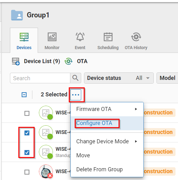

  1. As below figure, select devices and click "..." button. Click Configure OTA in the menu item. grp-cota-4.png
  3. Configuration OTA(COTA) is performed and user could check the progress/result in OTA History Tab. grp-cota-3-n.png
