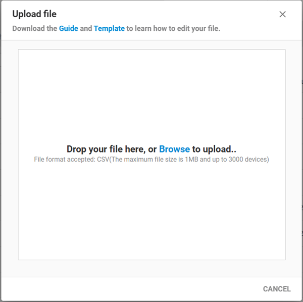

- Upload a CSV file: Create specific model device or unknown devices for the device provisioning. Please click the Add button and select the
Batch import. Upload the CSV file by dropping or selecting it. The format of the CSV file could refer to the below section of this article.

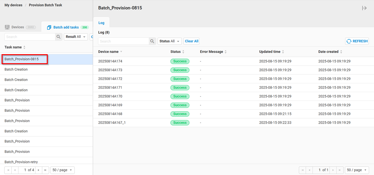

The Result Log

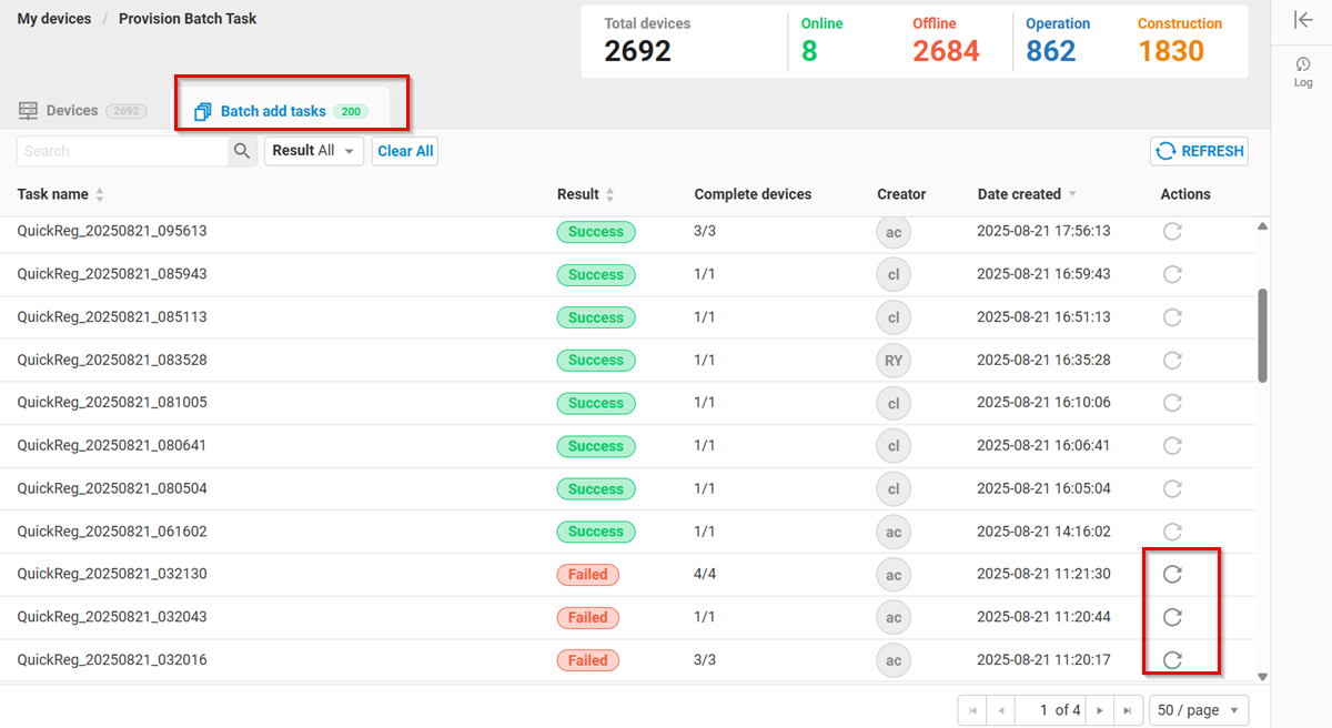

When the user uses the Quick Registration or uploads a CSV file, the system creates one task to create devices. In the tab of Batch add tasks, the new created task is displayed. Each task contains the result of the device creation.
If the task result is failed, the user can click "Retry failed devices" at the Action filed. The system will add a new task and try to create failed devices again. The user can click one task to see the device creation status in this task. Please click the “Refresh” icon to refresh device creation status.
