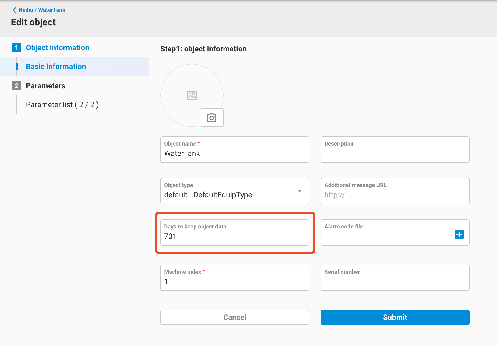

EdgeHub is a public cloud service that stores data uploaded by different tenants. To ensure system stability and serve as many tenants as possible, there is a limit on the data retention time. Each Object's settings require the configuration of the "Days to keep object data" field. Data-Archiving-2-01.png The setting in this field will affect the data retention time for each Parameter of the Object. The detailed rules are as follows:

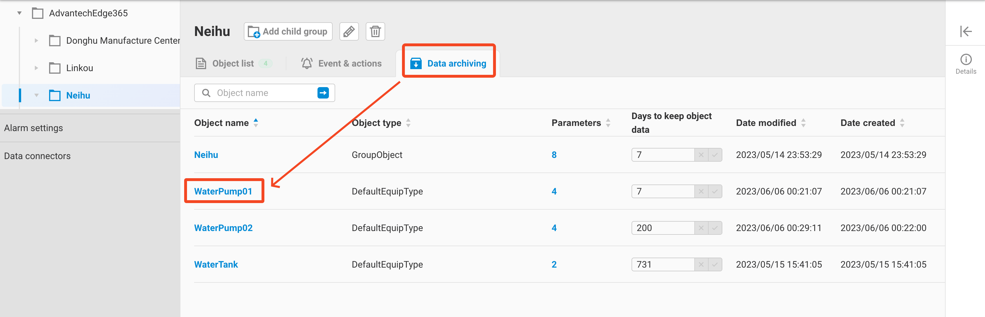

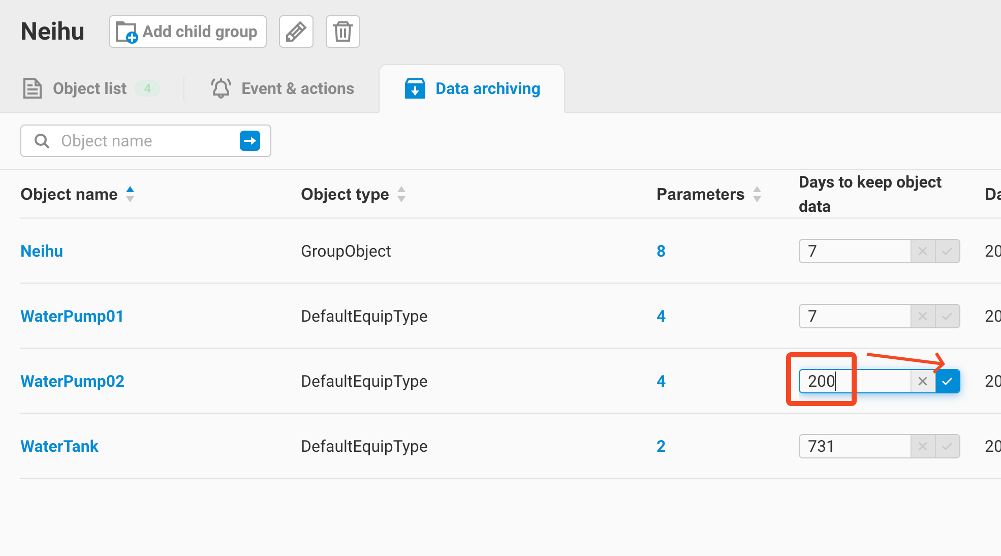

    1. Go to a group and select the Data Archiving tab. Inside, you will see the Object list.

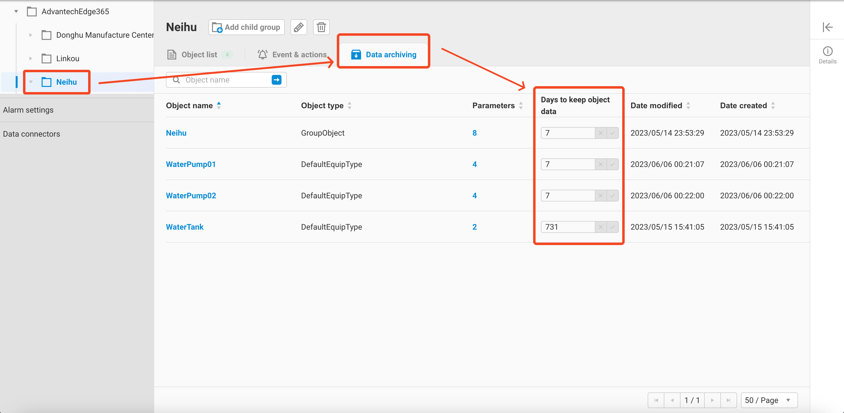

    2. Each Object can have its "Days to keep object data" adjusted. Data-Archiving-3-01.png

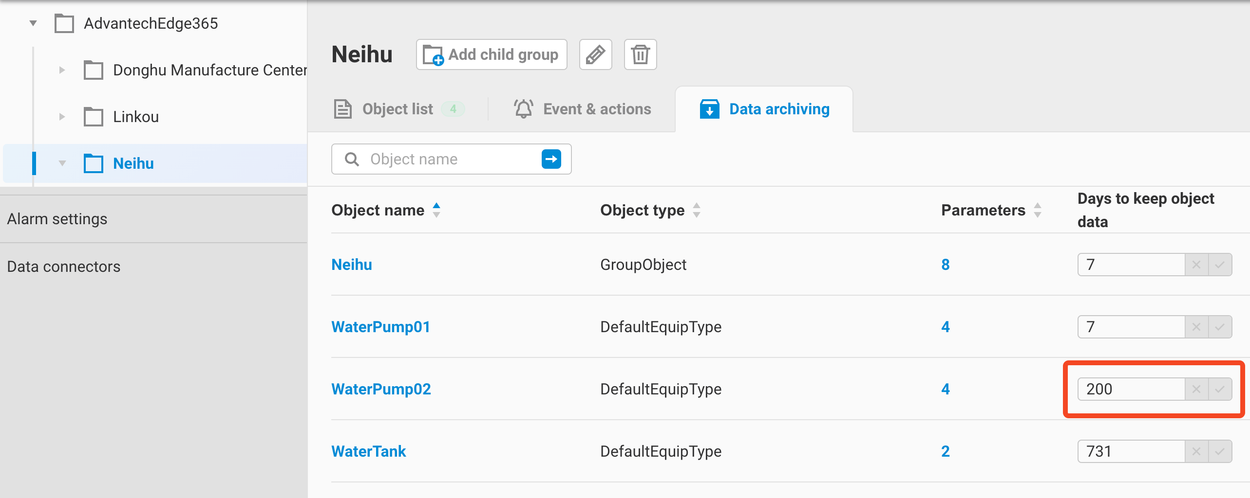

    3. To adjust the "Days to keep object data" for an object, fill in the desired value and click on the ✓ button. Data-Archiving-3-02.png
    4. After the modification, refresh the page to see the changes. Data-Archiving-3-03.png

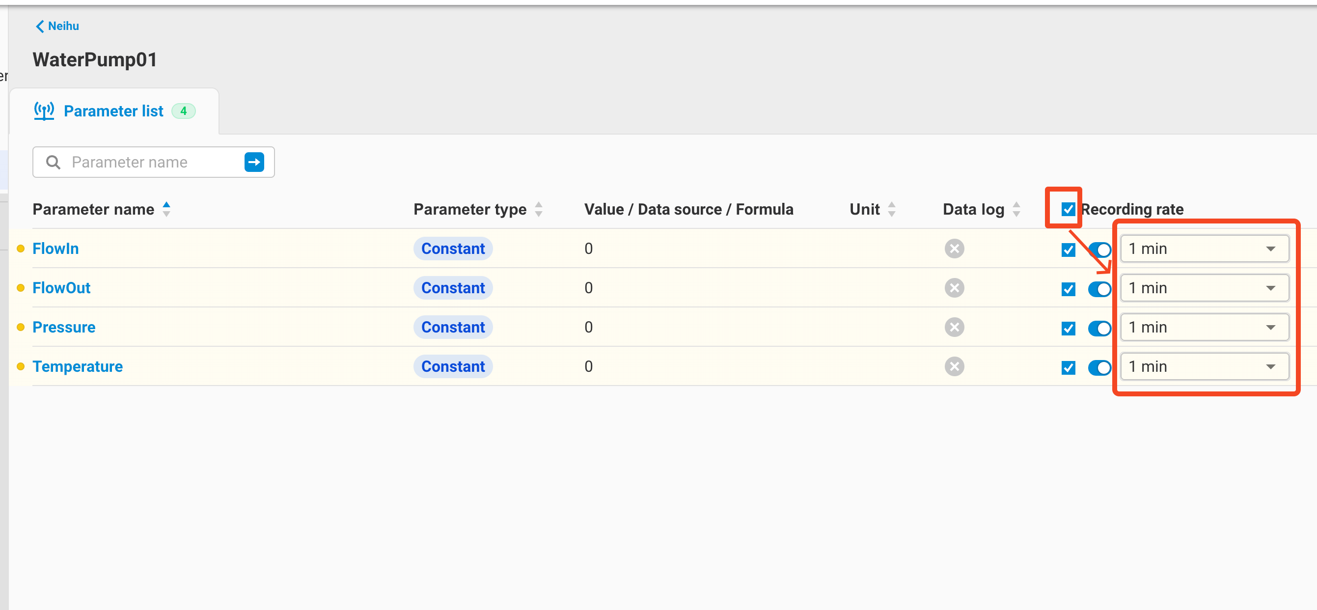

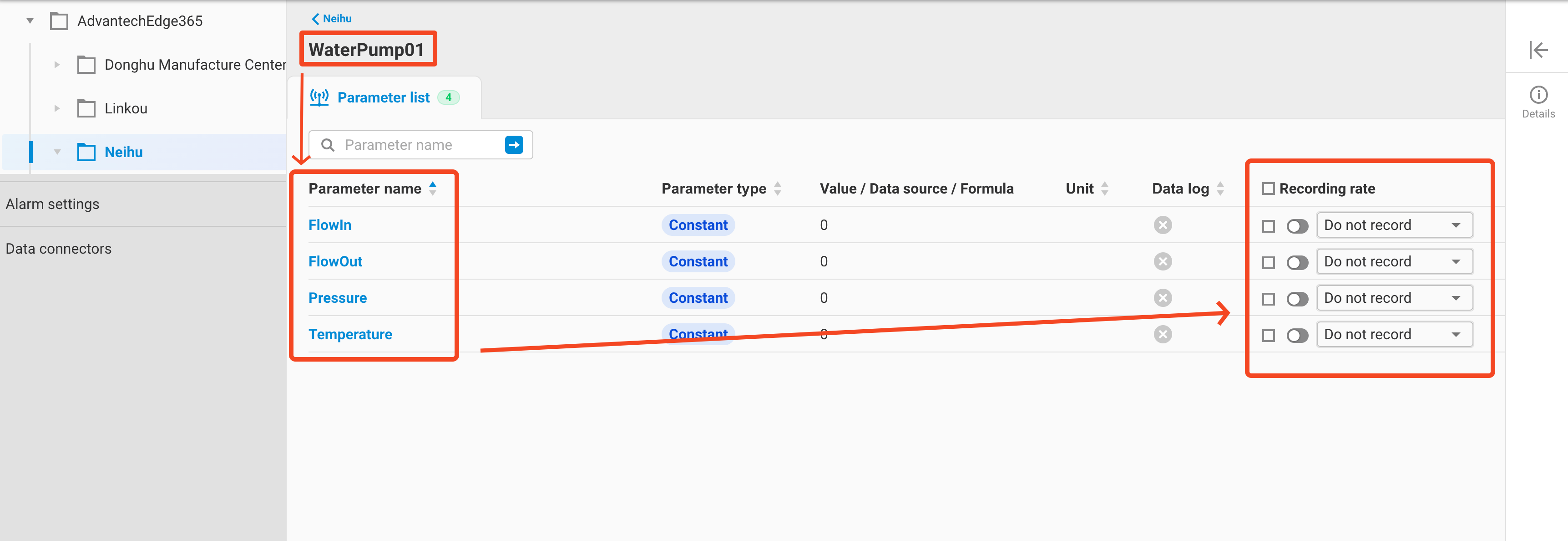

    2. Inside the object, you can see the parameter list and the Recording Rate for each parameter. Data-Archiving-3-05.png
    3. Check the "Select All" checkbox and choose a recording rate for one parameter. This setting will be applied to all parameters on the current page. Data-Archiving-3-06.png

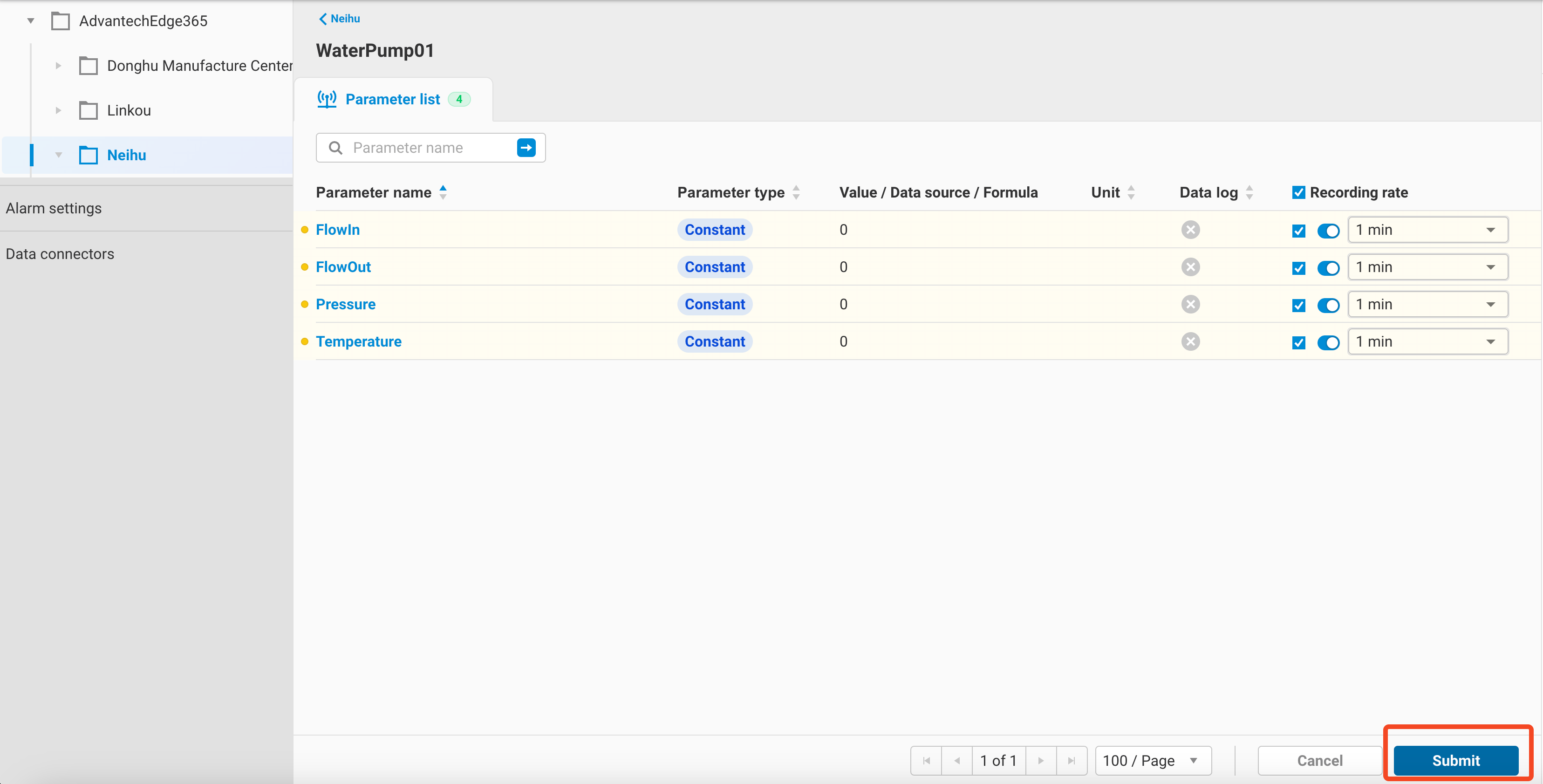

    4. Click "Submit" to complete the batch Recording Rate configuration for the current page. Data-Archiving-3-07.png

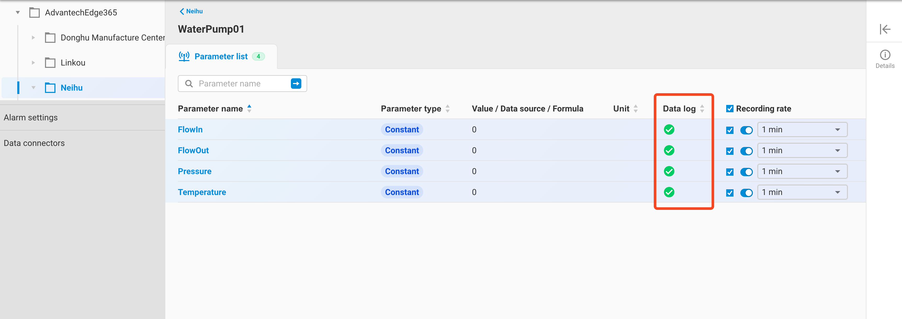

    5. Confirm that the Data Log field shows a green checkmark, indicating that the Recording Rate setting has been enabled. Data-Archiving-3-08.png
