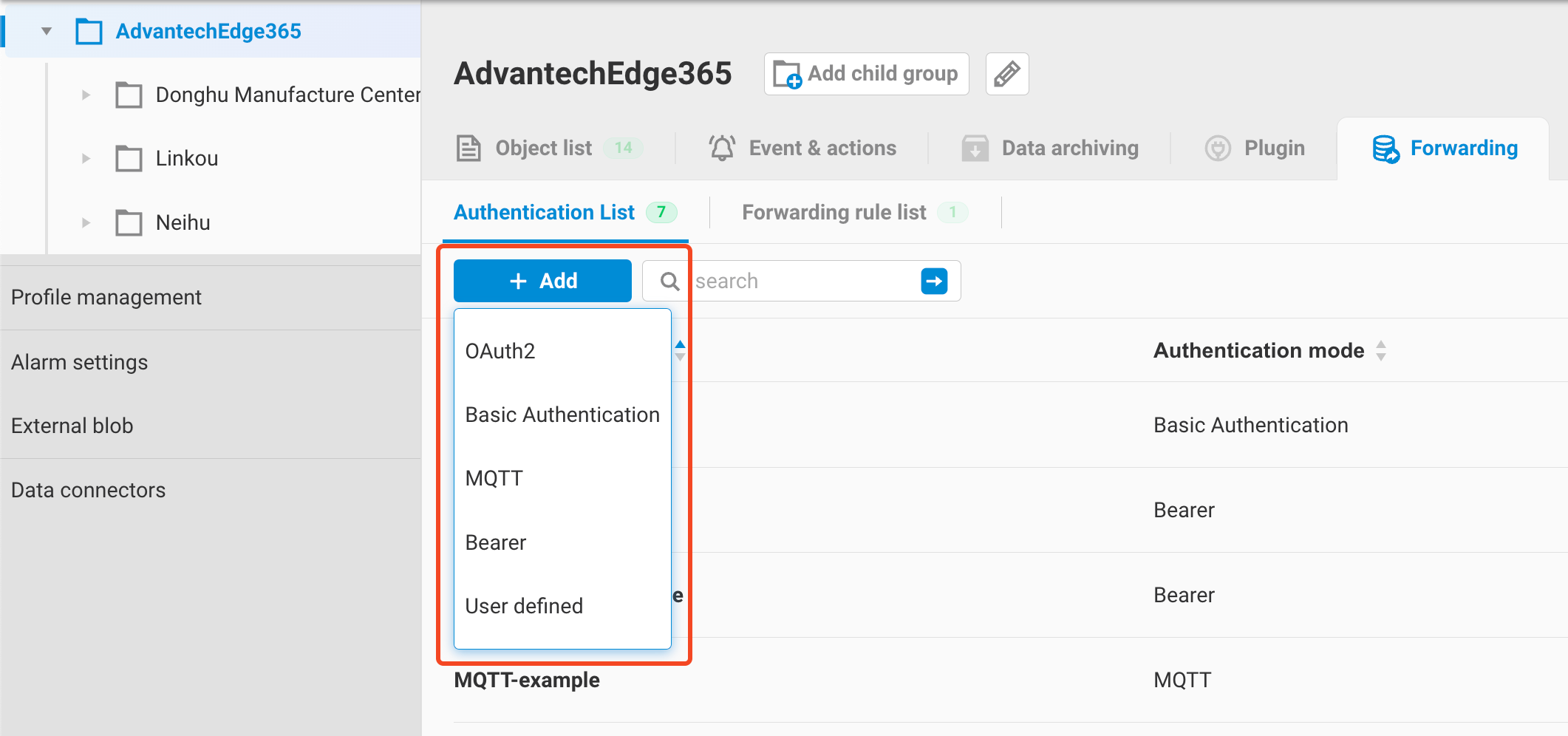

Users need to first establish the authentication method. forwarding-auth-00-add-new.png Currently supported authentication methods are as follows:

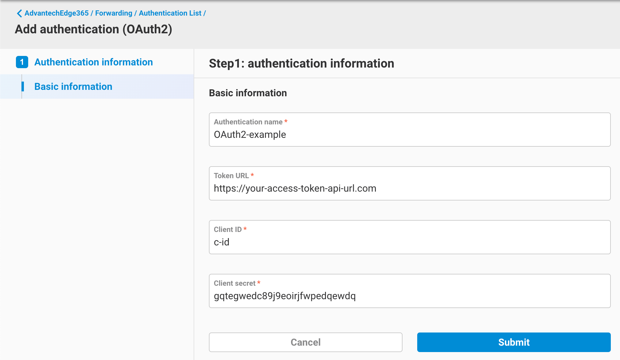

2.1.1 OAuth2
Forwarding supports OAuth2 authentication, and the details of OAuth2 are defined as follows:
  • Grant Type: Currently only supports the Client Credentials mode, users need to fill in the following three pieces of information
    • Token URL: API URL to obtain subsequent access tokens
    • Client ID: Client ID for the client credential mode
    • Client secret: Client secret for the client credential mode
  • Authorization data: Currently only supports filling in Request Headers
    • After obtaining the token, it will be added to the header in the calling Forwarding API as follows: Authorization: Bearer

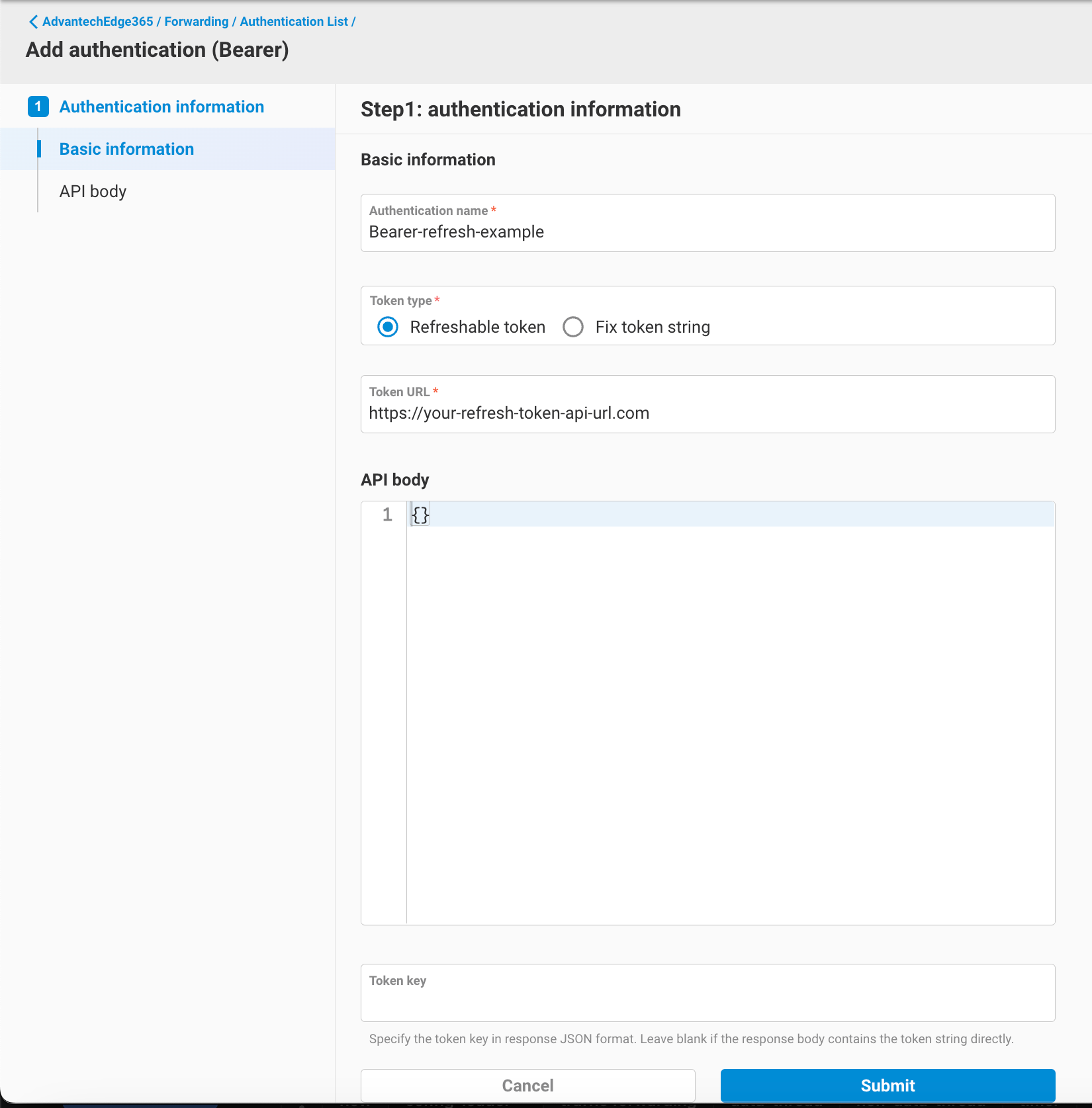

Bearer Token mode, currently supports two types
  • Refreshable token
    The user's API needs to first use a custom Token API to obtain the token and include it in the Authorization: Bearer Header. Subsequently, the token needs to be reacquired using this Token API. forwarding-auth-03-bearer-refresh-new.png

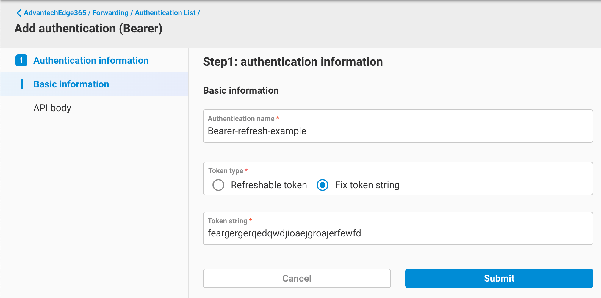

  • Fix token string
    The user already knows the Bearer Token String and does not need to update the token. The token string can be directly used and included in Authorization: Bearer Header. forwarding-auth-04-bearer-fix-new.png

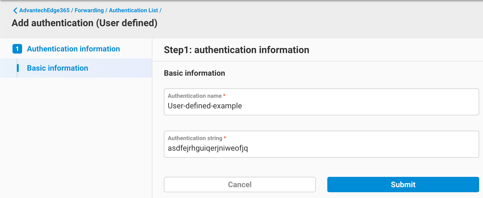

2.1.4 User Defined

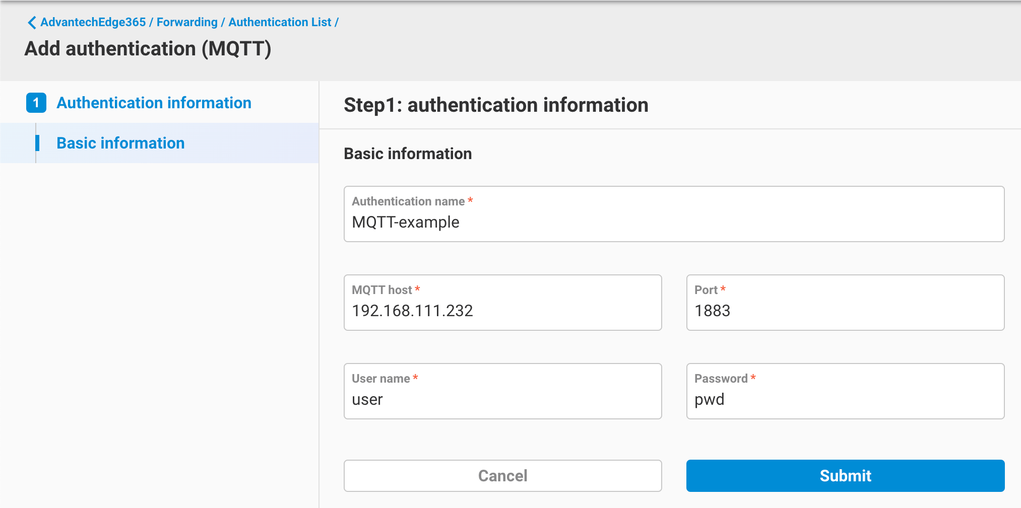

If the user knows what string needs to be filled in the Authorization header, they can directly use this mode. forwarding-auth-05-user-defined-new.png 2.1.5 MQTT
If the user wants to use MQTT to send data, they can configure MQTT connection and account information here. forwarding-auth-06-mqtt-new.png
