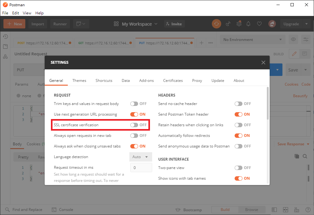

  1. Turn off SSL certificate verification

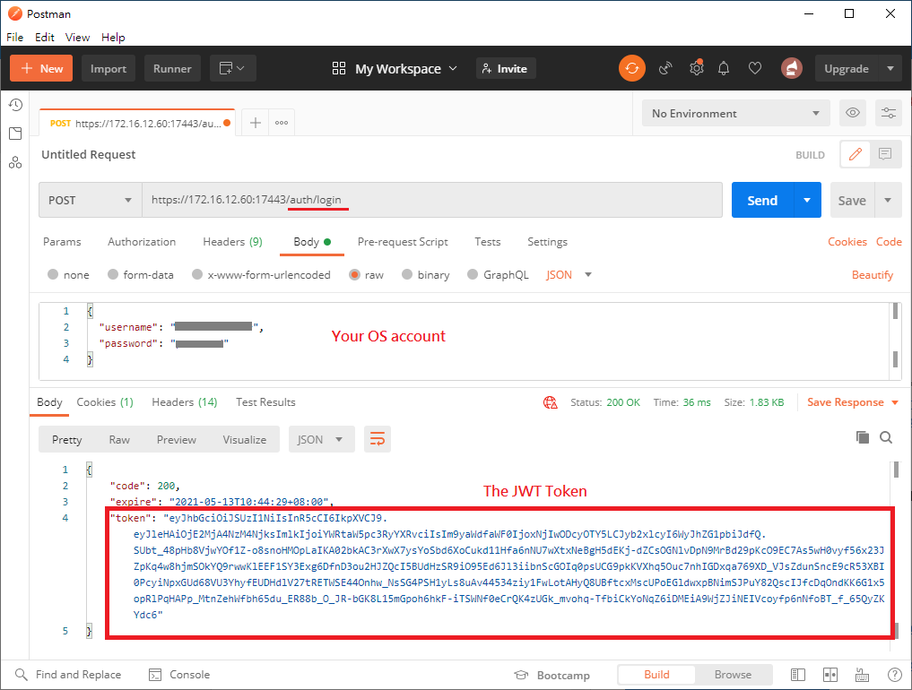

  2. Login with your OS account or the "admin" account to get a token

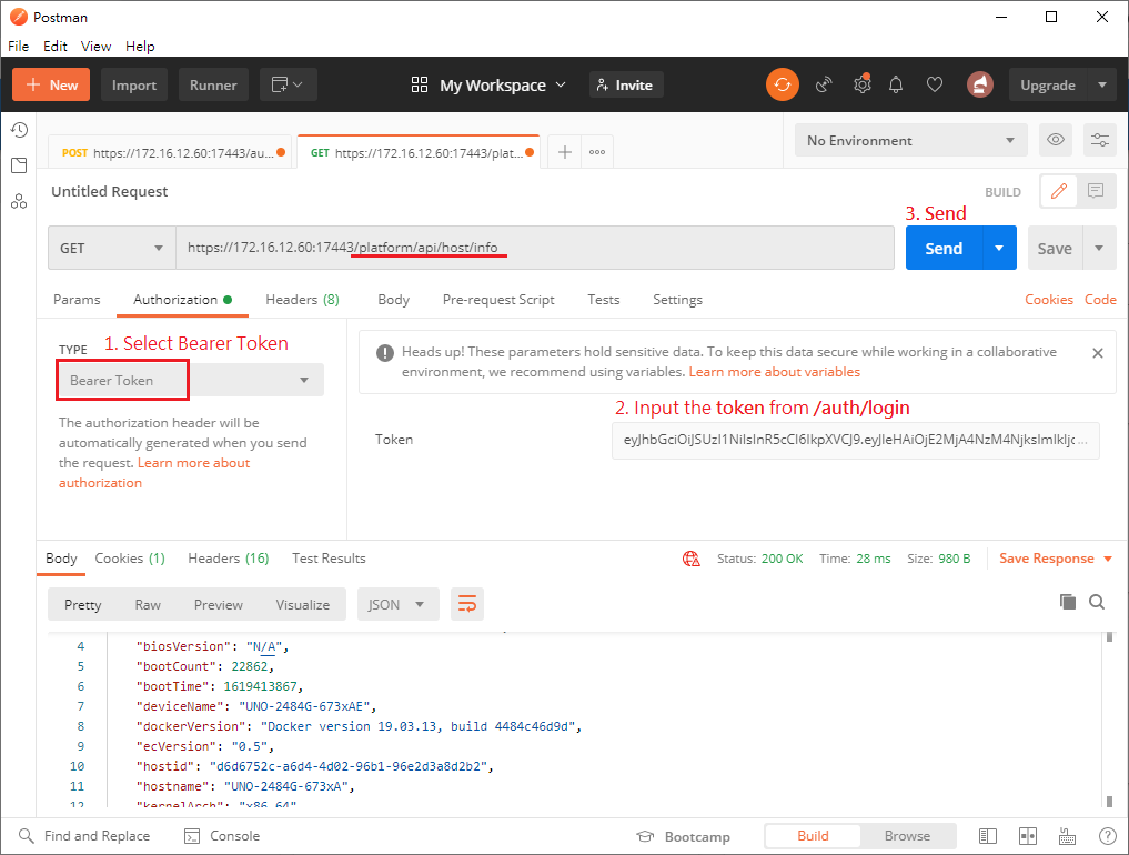

Calling GET /platform/api/host/info
  1. Switch to Authorization Tab and set TYPE to Bearer Token
  2. Input the token from Prerequisite Step 2
  3. Send the Request

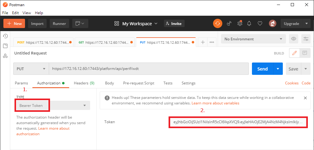

Calling PUT /platform/api/perif/wdt

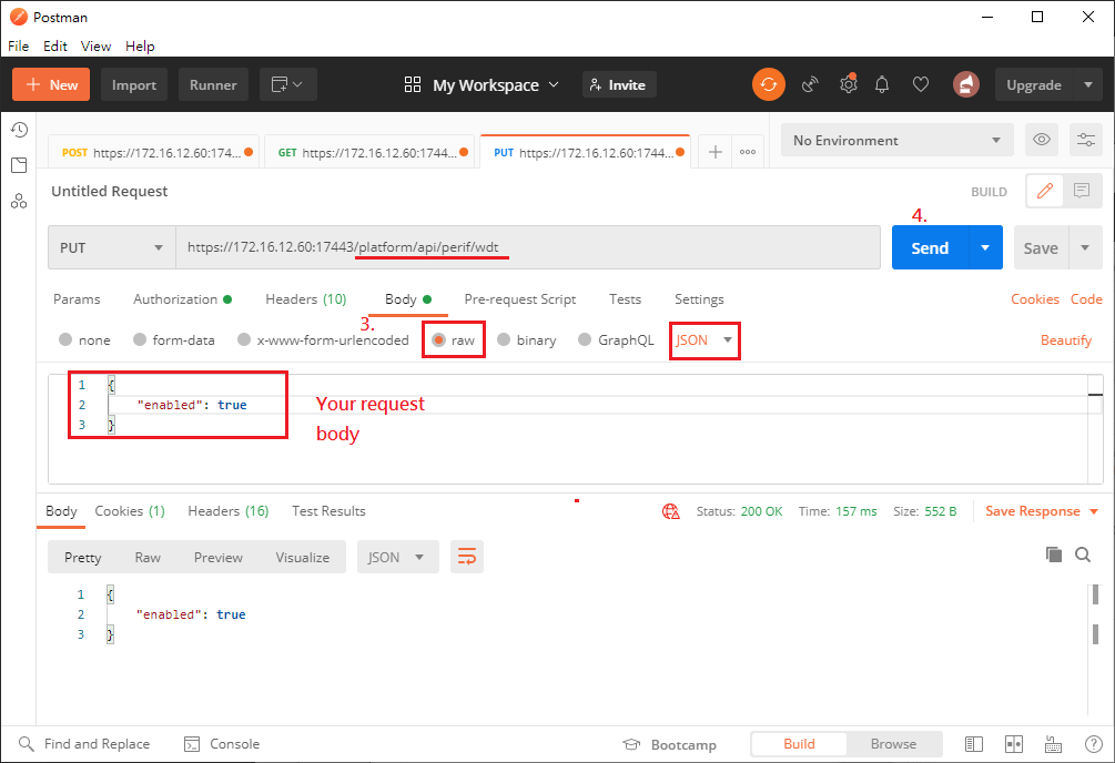

  3. Switch to Body Tab, select raw and JSON, then input the request body as below
    "enabled": true
  4. Send the Request
