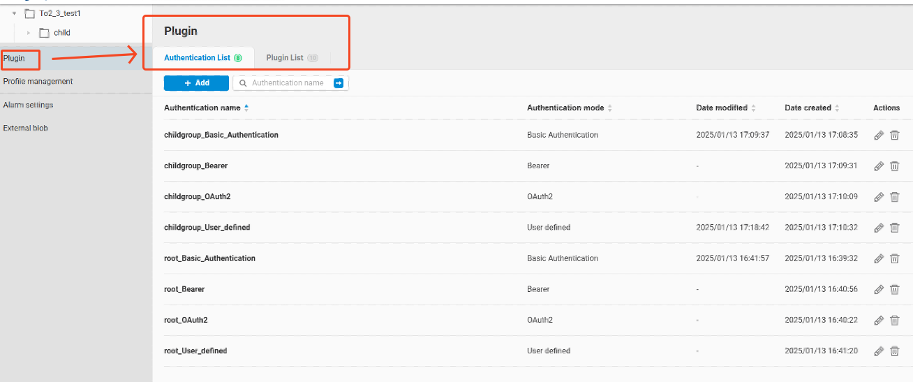

Starting from EdgeHub version 2.3, the Plugin functionality has been migrated from having a separate Authentication list / Plugin list for each Group to a single Authentication list / Plugin list for each Tenant.
- Before EdgeHub version 2.2, each Group had its own Plugin functionality, which included an Authentication list and a Plugin list.
- From EdgeHub version 2.3 onwards, all Plugins within the Groups under the same Tenant are consolidated into the
Pluginfunction on the left panel. This ensures that each Tenant has only one Authentication list and one Plugin list.
When upgrading from EdgeHub 2.2 to 2.3, the system will automatically complete the Plugin migration process without affecting the existing configured calculation parameters. The method of using Plugins remains the same as before. The steps are as follows:
Configure Authentication (refer to Section 2.2)
Configure Plugins (refer to Section 2.3)
Set up calculation parameter to use Plugins (refer to Section 2.4)

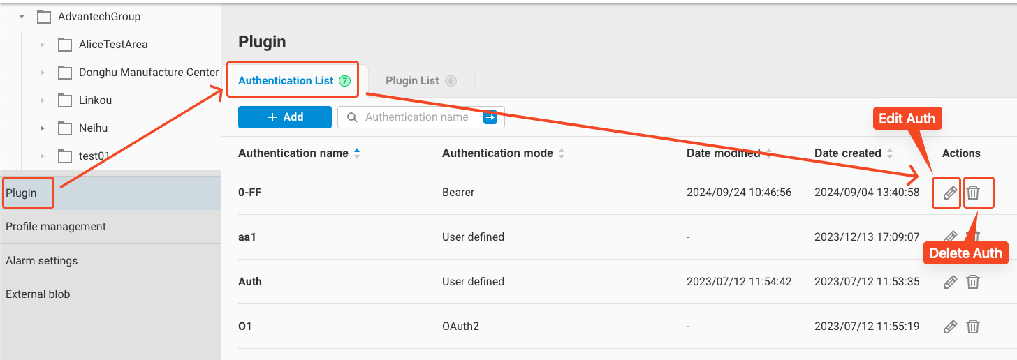

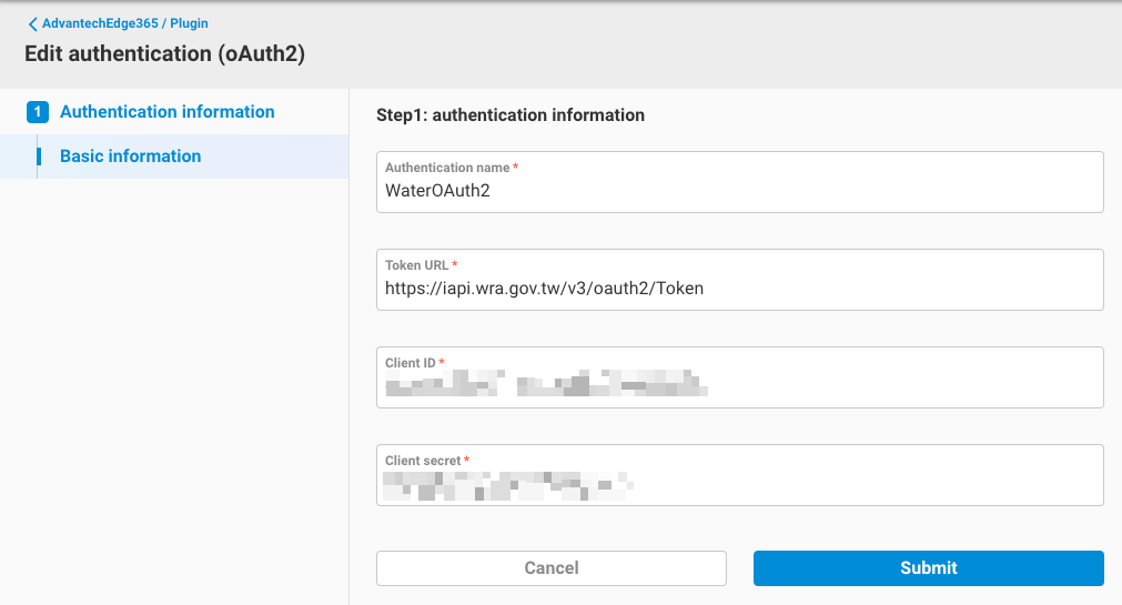

2.2 Authentication List

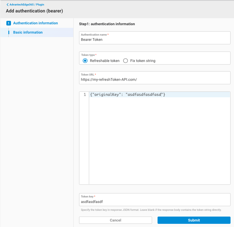

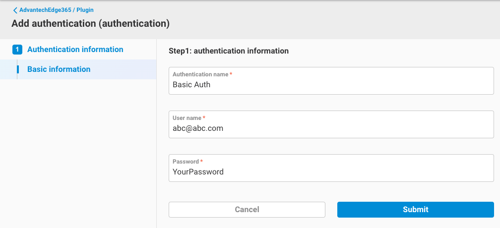

To create an authentication method, first select the authentication method according to the requirements of the third-party API. The following authentication methods are currently supported:
OAuth2
Basic Authentication
Bearer
- Refreshable token
Enter:
- Token API URL
- API body
- Token key: If the API response is a JSON file, provide a key to parse and obtain the token. If the API response is a token string directly, this value is not required.
- Refreshable token
Enter:

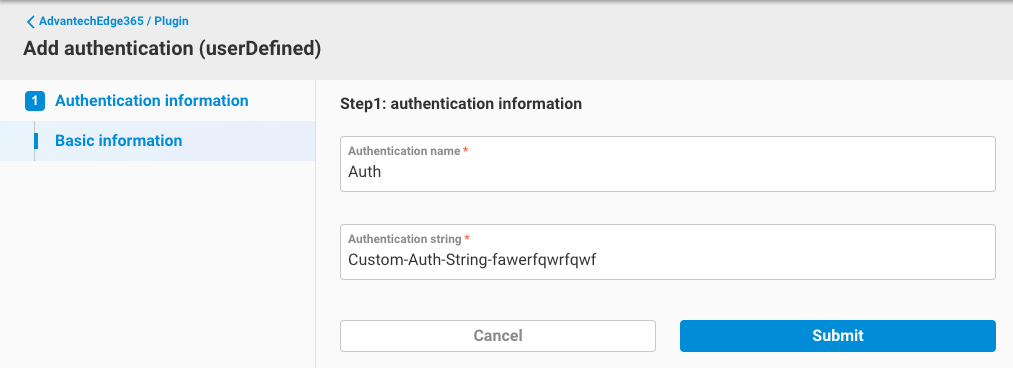

Fix token
User-defined authentication string
After saving the above settings, a set of authentications will be displayed in the list, and you can perform editing and deletion operations as shown in the following figure:

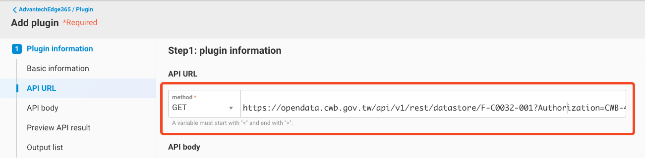

API URL
- Method: The API method to be called. Currently supports GET/POST.

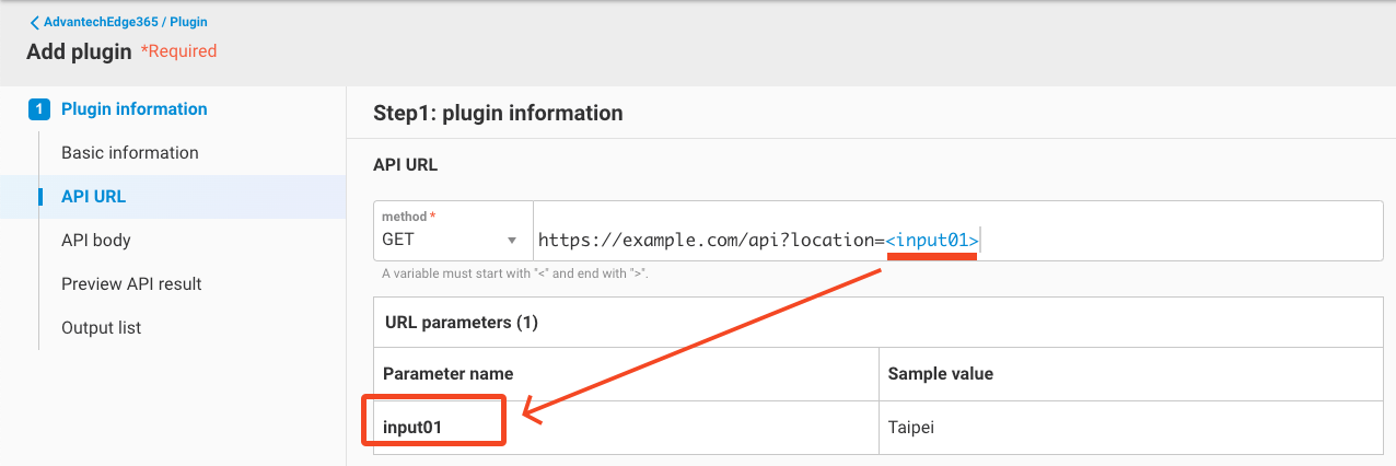

- URL: Enter the API URL to be called. The URL can use symbols as input variables. For example:
https://example.com/api?location=- After entering, you will notice that the UI automatically recognizes the input01 variable and prompts you to enter a sample value for the next step, which is used to call the "Preview API result".

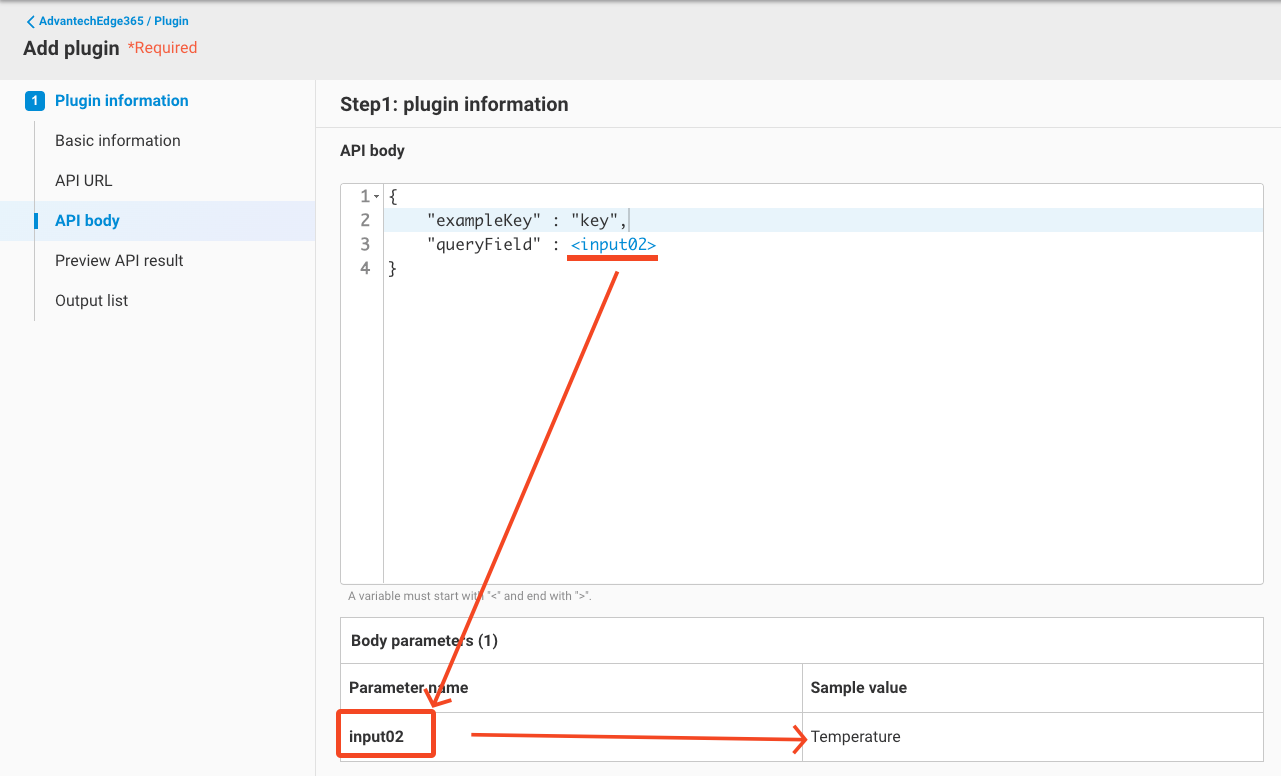

API Body
- Enter the required request body for the API (if needed). Currently, the request body only supports valid JSON format.
- Similar to the URL, the API body can also use symbols as input variables. Using the example in the previous figure:
- Enter ``
- You will see that the UI automatically recognizes the input02 variable and prompts you to enter a sample value for the next step, which is used to call the "Preview API result".

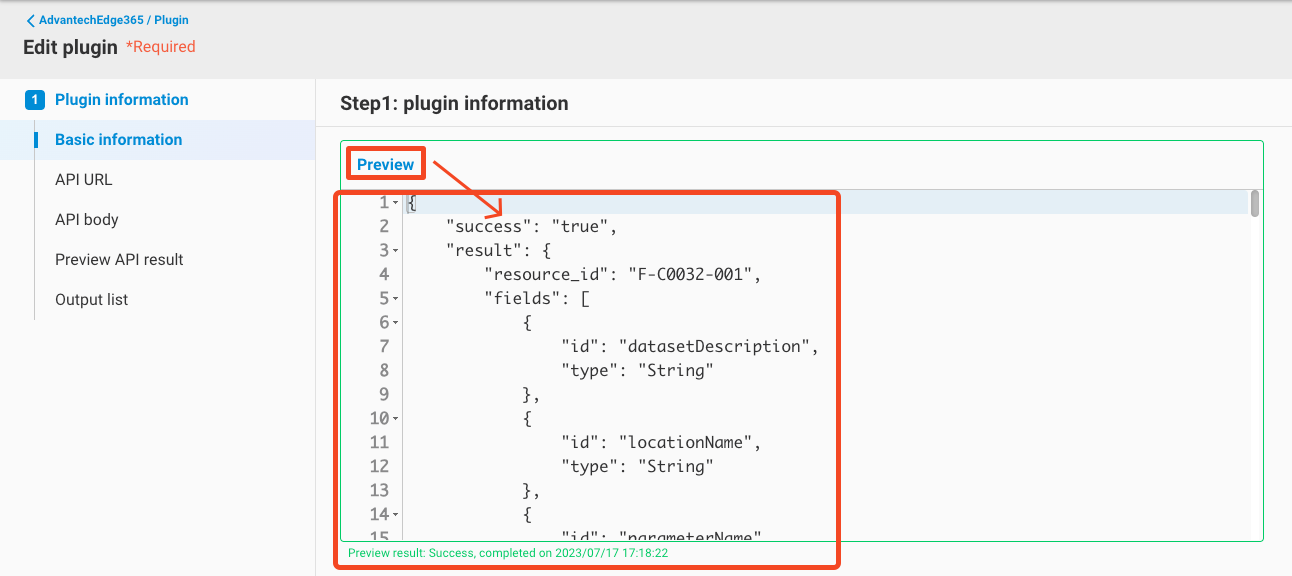

Preview API result
- This step must be performed when adding a new plugin to ensure that the API you entered can be used correctly and returns a result. After correctly entering the API URL and API body, click
Preview. - If the API is correct, you will see the correct API response.
- Please note that currently only JSON format API responses are supported.

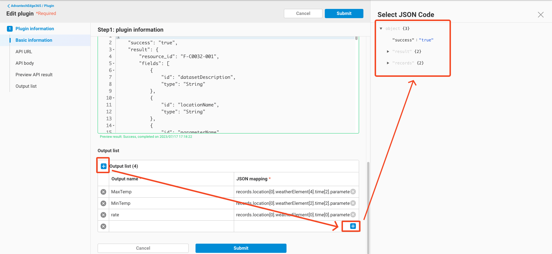

Output list
- Click
+ Outputto add an output for the plugin. - Enter the Output name.
- Click the
+symbol in the JSON mapping field to expand the fields on the right side, where you can see the API response for this call.
- In the JSON code structure on the right, select a key to map to this output. For each subsequent call, the backend will consistently retrieve the value of this key from the response as the value of this output.
- In the example above, set an Output =
descriptionand map it to thedatasetDescriptionfield in the JSON code as the return value.

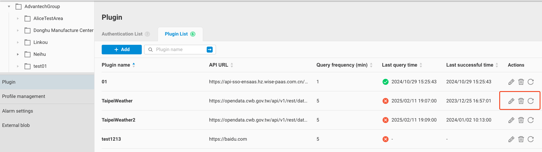

Submitto add this plugin. The newly added plugin will be displayed in the Plugin list.

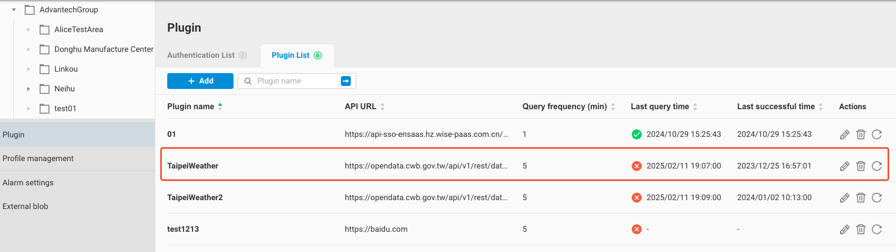

In the Plugin list, each plugin can be edited, deleted, or refreshed.
- Refresh: For all different inputs referencing this plugin (configured in the calculation parameter settings, explained in section 2.4), it queries the API one by one. If the plugin has not been referenced, the API is queried using the plugin's sample value.

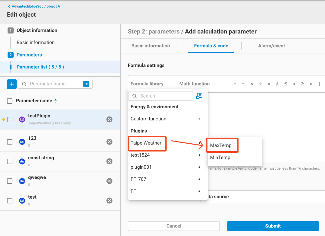

2.4 Use Plugin Function in Calculation Parameter
The newly added plugin function must be invoked by a calculation parameter. Here's how to use it:
Create a new calculation parameter and select the desired plugin from the Formula library. Choose one of the plugin's outputs.
You will see that the formula automatically includes the plugin formula in the following format:
(, , ...).- Example:
- TaipeiWeather().MaxTemp
- examplePlugin(tagId, tagName, value1, value2).a1
Click on "Check formula." If the plugin has any inputs (configured in section 2.3, API URL / API Body), the input variables will be displayed in the Code list. The further steps for operation are the same as the calculation parameter settings.
