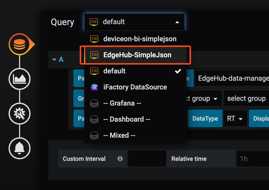

You can start using the EdgeHub datasource in the Dashboard by following these steps:

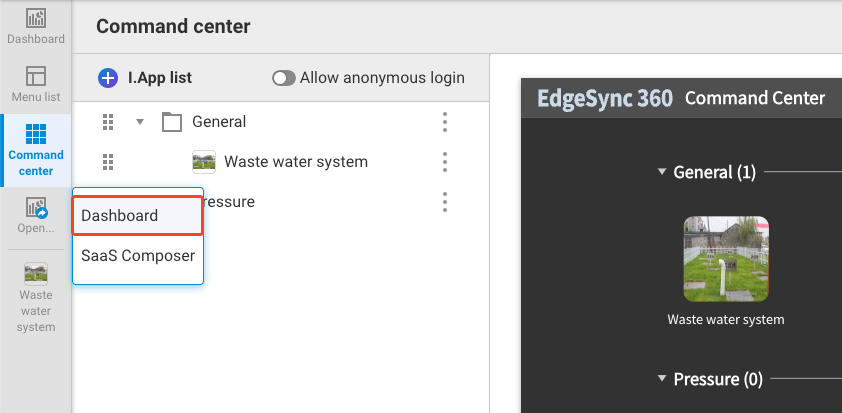

  • Use Command Center -> Open... -> Dashboard
  • A new page will open, displaying the Dashboard page

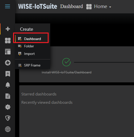

  • Hover your mouse over + and select Dashboard to create a new dashboard

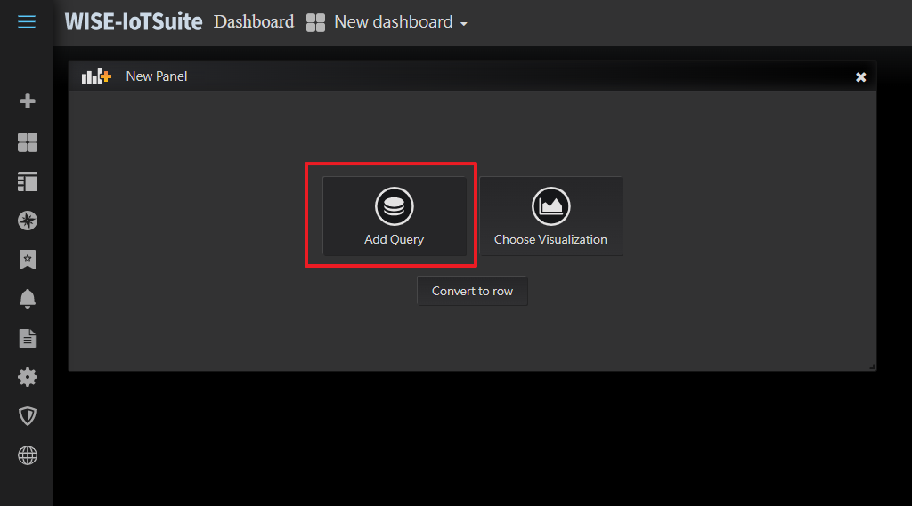

  • A new dashboard has been created. Click on Add Query
  • You can see that the EdgeHub datasource is set as the default datasource, and you can see all of the configuration options for the EdgeHub datasource.
  • If there are other datasources present in your Dashboard environment, you can switch back to the EdgeHub datasource option by selecting EdgeHub-SimpleJson datasource.

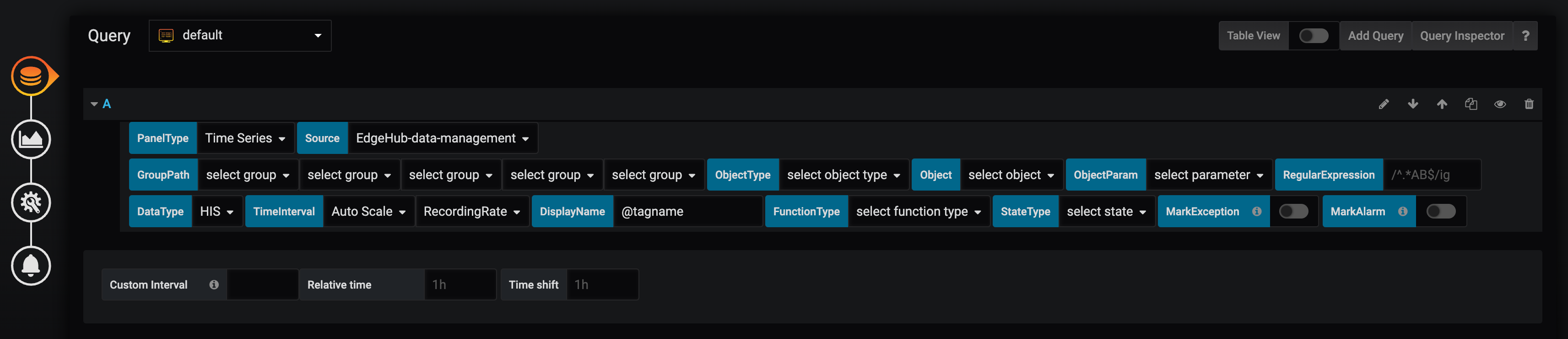

2. Datasource field description​
This section explains the usage of each field in the EdgeHub datasource. The current version of the EdgeHub datasource is shown in the figure below.

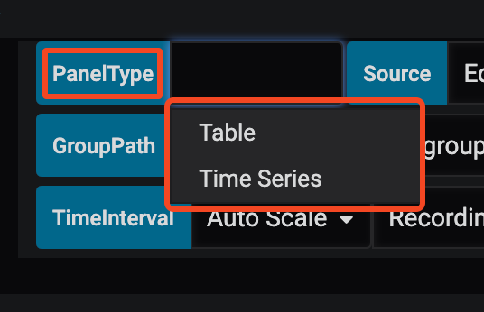

2.1 PanelType​
Used to specify the format of the returned data, which can be classified into two types:
  • Time Series
    Returns data to the Dashboard in time series format. The data will include the following three basic fields:
    • target: The source of the data, usually a parameter name.
    • value: The data value.
    • time: The time of the data.
    This format is typically used for displaying line graphs, tables, bar charts, etc., and is also the default value for the current EdgeHub datasource.
  • Table
    Returns data to the Dashboard in table format. The data will include the following four basic fields:
    • Timestamp: The time of the data.
    • Parameter: The source of the data, which carries the parameter name.
    • Description: A description of the data, which carries the parameter description (set on the parameter settings page).
    • Value: The data value.
    This format is typically used when presenting data in tables.

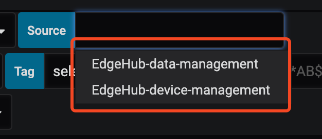

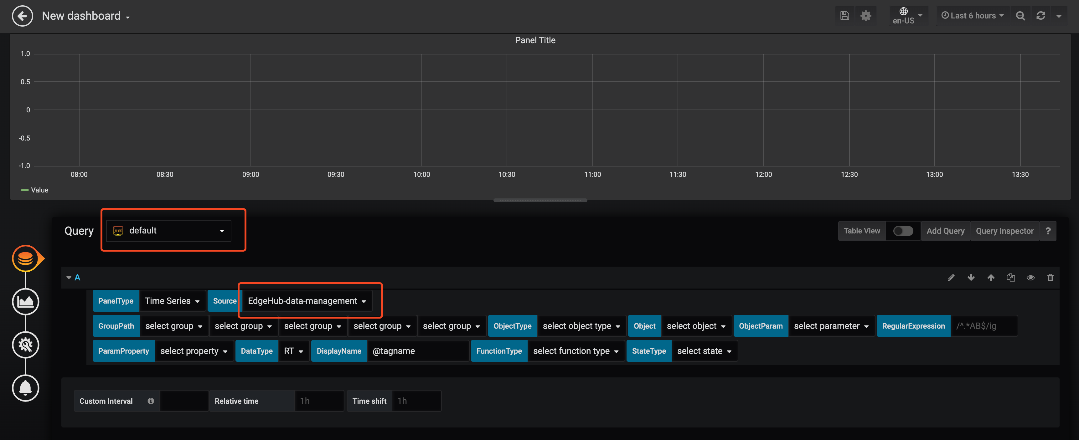

2.2 Source​
The source for accessing internal data in EdgeHub. Currently, it support the following options:
  • EdgeHub-data-management : used to access data related to group/object/parameter. When selecting this option, the following fields need to be configured:
    • GroupPath (Ref. to section 2.3)
    • ObjectType (Ref. to section 2.4)
    • Object (Ref. to section 2.5)
    • ObjectParam (Ref. to section 2.6)
    • ParamProperty (Ref. to section 2.8)
  • EdgeHub-device-management: supported from EdgeHub version 2.3 onwards, used to access Device/tag data. When selecting this option, the following fields need to be configured:
    • Device (Ref. to section 2.17)
    • Tag (Ref. to section 2.18)
    • TagProperty (Ref. to section 2.19)

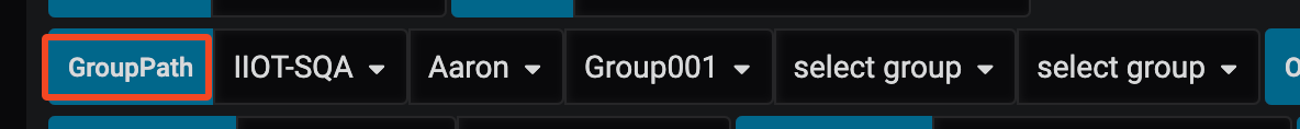

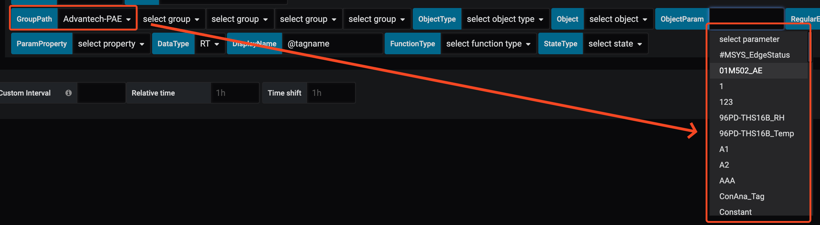

2.3 GroupPath​
Select the Group relationship structure configured in EdgeHub. Currently supports up to five layers. To query data under a specific Group, please select the corresponding Group in order.

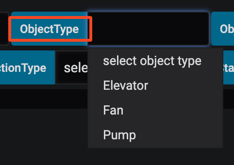

2.4 ObjectType​
Corresponds to the Object type field configured in EdgeHub. If the Object under the selected GroupPath has an Object type configured, you can filter using this menu. If it has never been configured, this menu can be ignored.
  • ObjectType Menu
  • The EdgeHub configuration can be found in the Edge object feature.

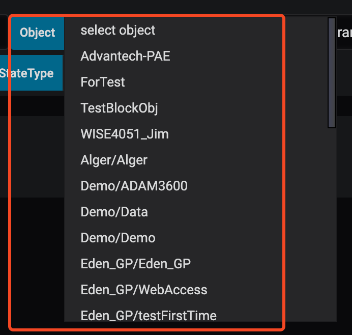

2.5 Object​
Displays a list of Objects under the GroupPath, and it will also list the Objects of sub-Groups.

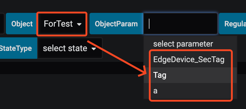

2.6 ObjectParam​
Displays the parameters of the selected Object.
You can also choose not to select an Object and directly select ObjectParam, which will list all parameters of the Objects under the GroupPath.

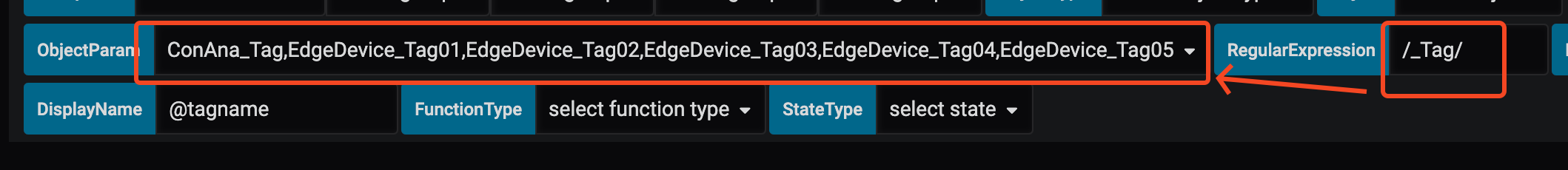

2.7 RegularExpression​
Input a regular expression to filter the displayed ObjectParam list (or Tag list).

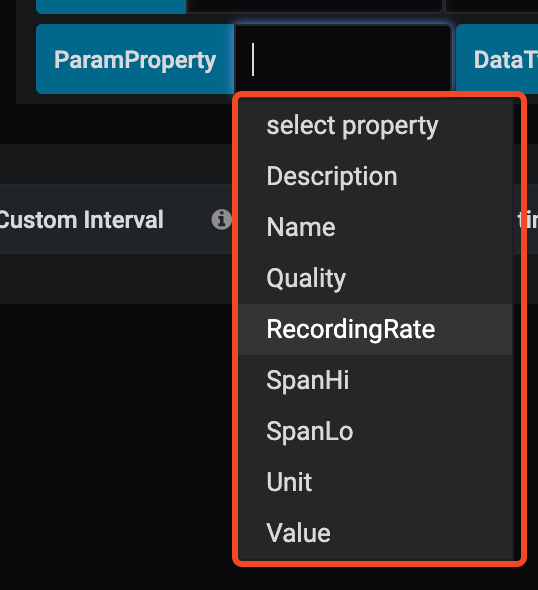

2.8 ParamProperty​
Select the property to display for the currently selected parameter. The default value is Value, which is the value of the Parameter.

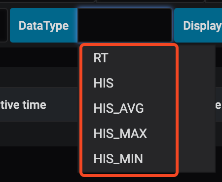

2.9 DataType​
Used to query different data types:
  • RT: Real-time value
  • HIS: Historical data - Last value
  • HIS_AVG:
    • Parameter type = Current: Displays historical data - Average value
    • Parameter type = Cumulative: Displays historical data - Difference
  • HIS_MAX: Historical data - Maximum value
  • HIS_MIN: Historical data - Minimum value
Please note that starting from EdgeHub version 2.3, Source = EdgeHub-device-management (Ref. to section 2.2) is supported, allowing users to query Device/tag data. However, the data type is limited to RT and does not support queries related to HIS/HIS_AVG/HIS_MAX/HIS_MIN.

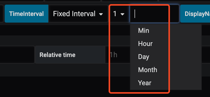

    • If the scaling mode is selected as Fixed Interval, the following time intervals can be chosen:
      • Minutes: 1, 5, 10, 15, 20, 30
      • Hour: 1, 2, 3, 4, 6, 8, 12
      • Day: 1, 2, 3, 5, 7
      • Month: 1, 2, 3, 6
      • Year: 1

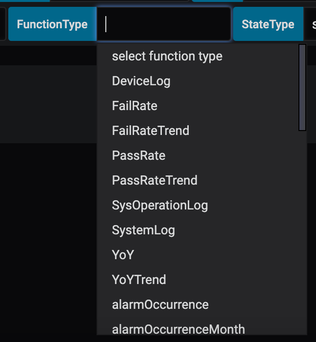

2.12 FunctionType​
Various calculation functions provided by EdgeHub. Please refer to the article Datasource functions for more details.

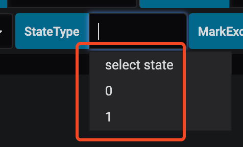

2.13 StateType​
Used in conjunction with certain specific FunctionTypes. When the function needs to select the state of a discrete parameter, select it through this menu.

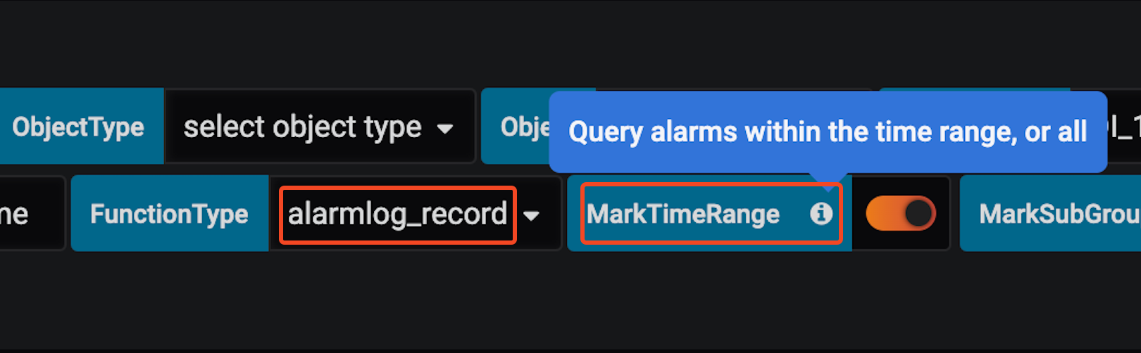

2.16 MarkTimeRange​
This option will appear when alarm_record is selected as the FunctionType, and it is used to determine how to query real-time alarm records:
  • Enabled: Query according to the Time Range selected on the Dashboard.
  • Disabled (default): Query all currently active real-time alarms.

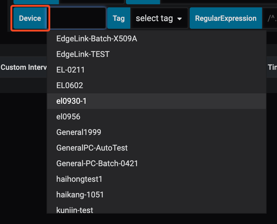

2.17 Device​
This field setting is displayed only when Source = EdgeHub-device-management (Ref. to section 2.2).
It shows the list of Devices under the corresponding Tenant. Please select the Device to query.

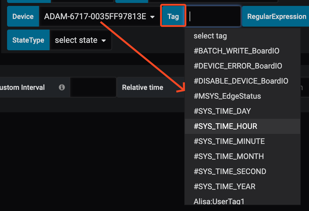

2.18 Tag​
It shows the list of Tags for the selected Device. Please select the Tag to query.

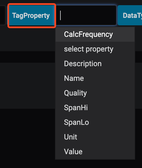

2.19 TagProperty​
Similar to section 2.8, this allows selecting the properties of the currently selected Tag. The default value is Value, which represents the value of the Tag.
