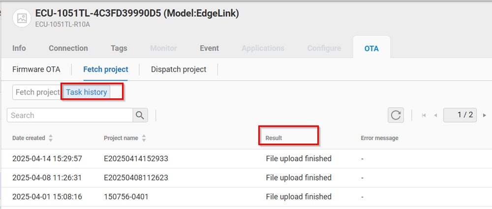

🔹Fetch EdgeLink Runtime Project

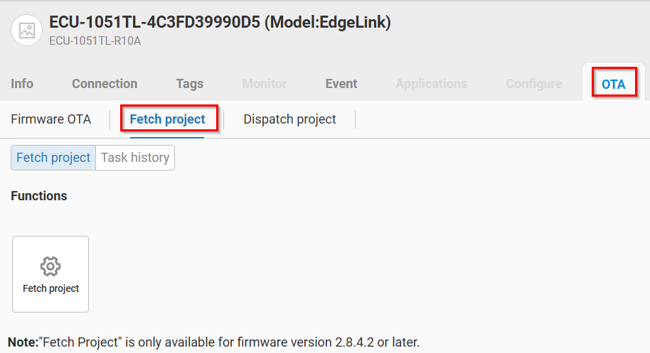

Device Management can request the device to upload its runtime project and store the runtime project. Then the project can be downloaded into the device by OTA. Please follow below steps:
- In the
Fetch projectsub-tab of theOTAtab, click the "Fetch project" button
- The result of the project upload is displayed in the "Task history" tab.
- The device uploaded project files are displayed in the "Dedicated project" sub-tab of the "Dispatch project" tab becaue these projects are only used by this device.
> Note: For each device, the maximum number of project files is 6. The oldest file is replaced if there are already 6 files for the device.

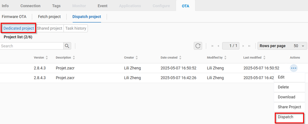

For each dedicated project file, the user can perform following actions:
- Edit or Delete the project file
- Download: Download the project file to the local compuer
- Share the project file: Share(Copy) this project file to all the tenant users and this file can be found in the "File Management". After the file is shared, the user can dispatch the file to other devices.
- Dispatch: Download the project file back into the current device.

Dedicated Project
For the project which is fetched from this device:
- Please choose one project in the "Dedicated project" tab.
- Click the action button and choose the
Dispatchbutton to perform the Project OTA.

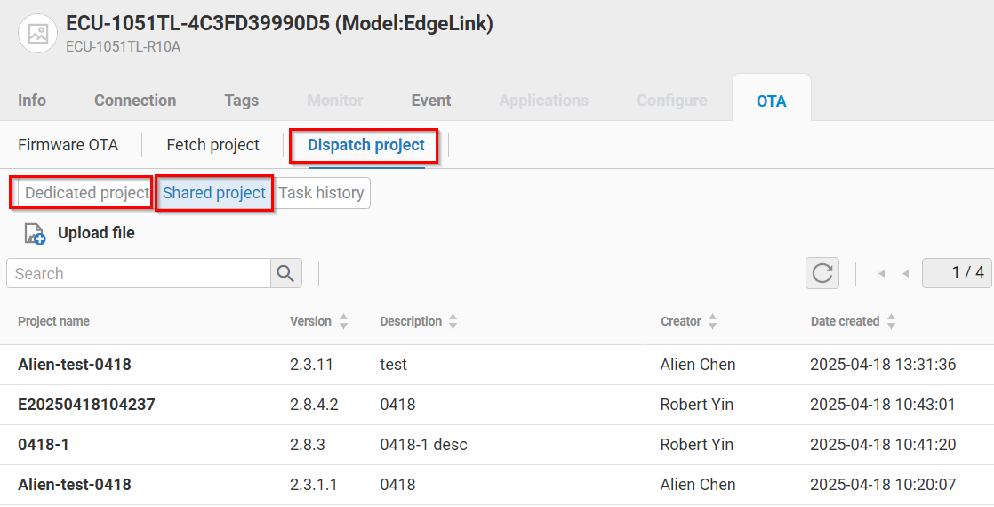

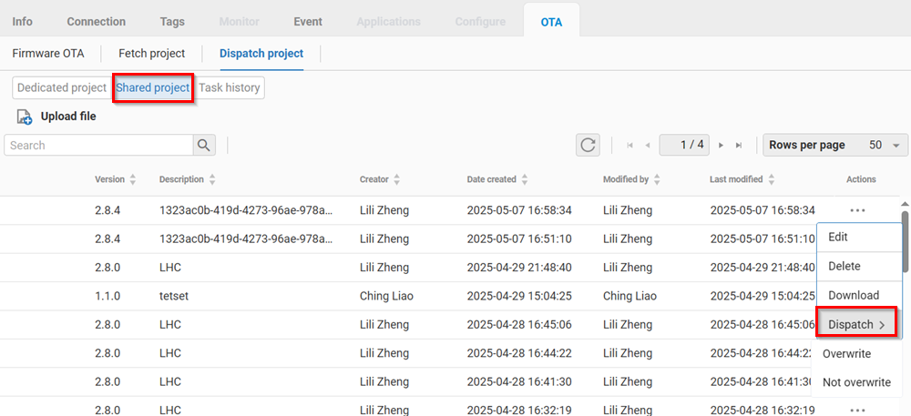

Shared Project
For the project which are used for all devices in the tenant:
- Please choose one project in the "Shared project" tab.
Dispatch. The user can choose if the Project OTA should overwrite the system setting. If user clicks Overwrite setting, all settings in EdgeLink project will be overwrite in the device.

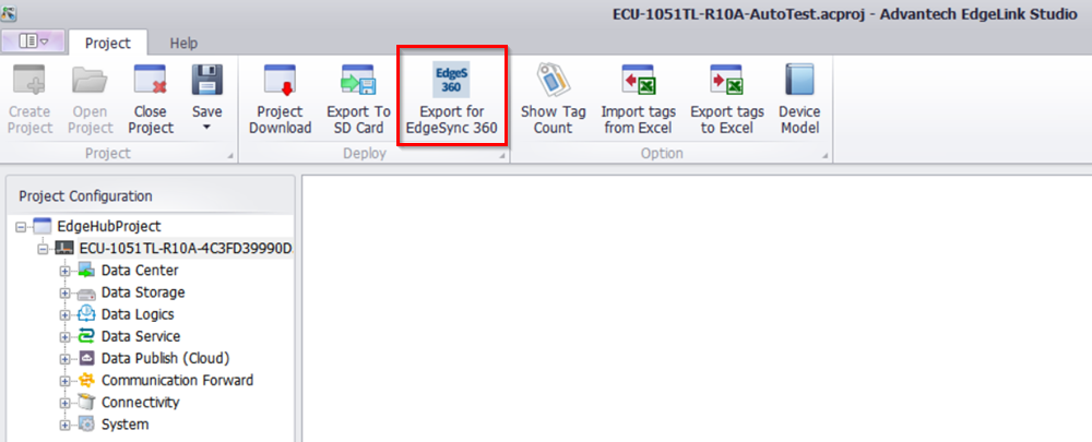

The project file can be obtained from the Advantech EdgeLink Studio. After the configuration of the project, the user can export the compiled project file and upload into the File Management.

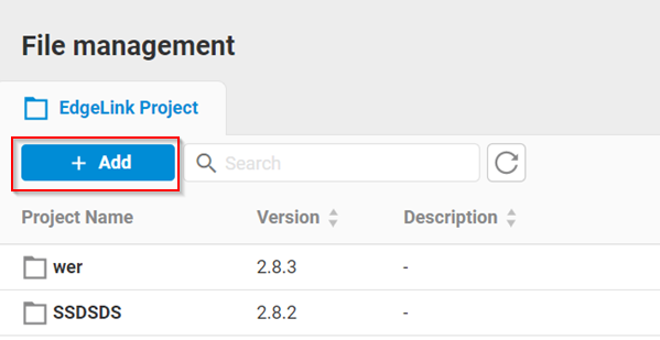

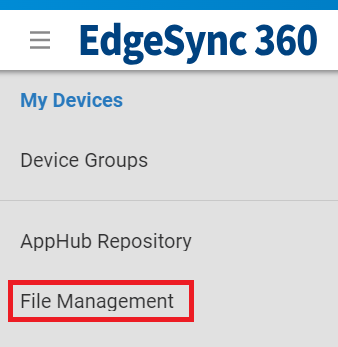

In the top left corner, click
and select File Management to enter the page.

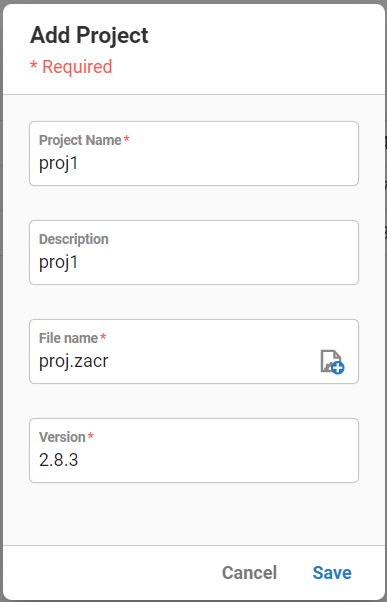

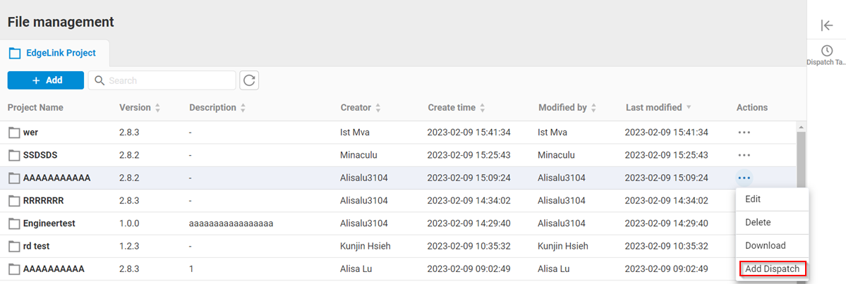

Click Add to create EdgeLink Project file
Please fill in the Project Name, project file version(format: x.x.x) and click "+" to upload the project file.
Press the Save button and the project will be uploaded.

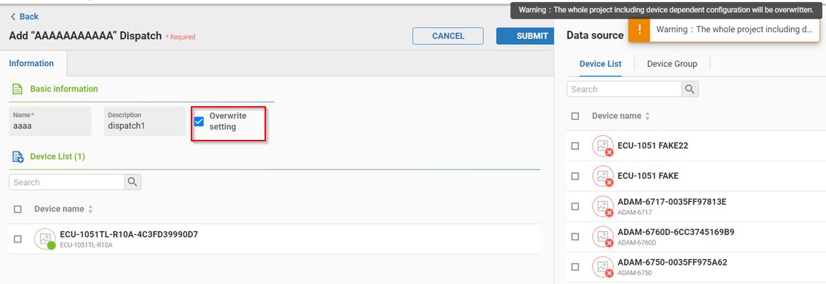

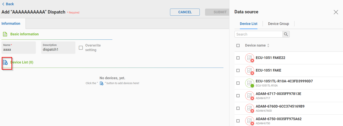

To dispatch the project file, click Add Dispatch in actios of the selected project.

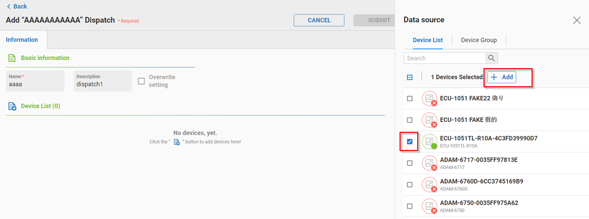

Please fill in the dispatch name, description and click "+" to select target EdgeLink devices
Select target devices or target Device Group then click Add button
If the user selects the Overwrite setting, all settings in EdgeLink project will be overwrite in selected devices
Click SUBMIT to create dispatch task.

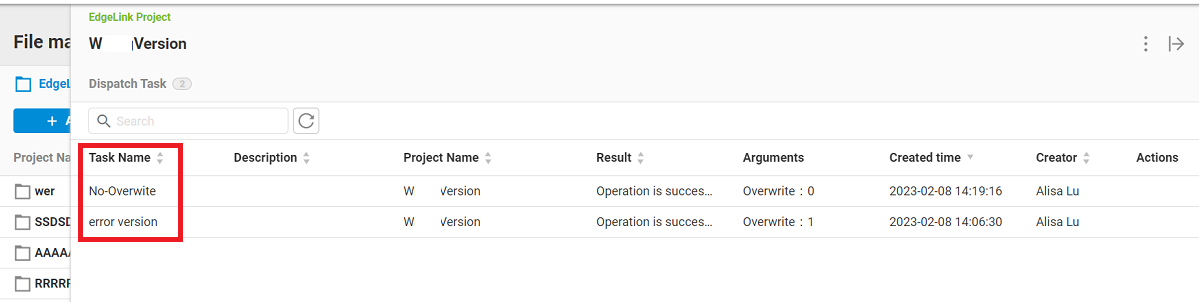

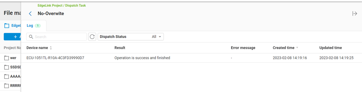

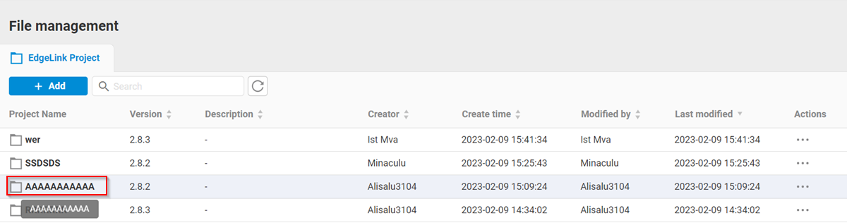

To check the dispatch result, please click the project file.
User can see all related dispatch tasks for this project.
Please click the task name and user can see the dispatch result of all selected devices.

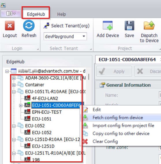

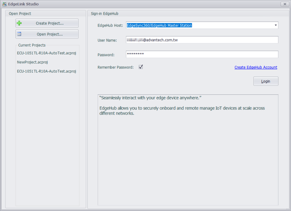

🔹EdgeLink Studio Integration
EdgeLink Studio supports the user login of the Device Management system.
After the user logins, the EdgeLink devices in the Device Management system are displayed. Thus the user can not only manage devices in the local network but also devices in the remote network.
