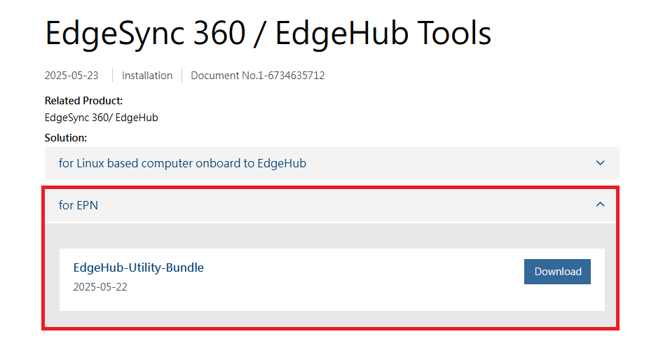

5. Where can I download EdgeHub Utility?
EdgeHub Utility can be downloaded from the EdgeHub web portal after logging into your tenant. Please navigate to the Direct Access section. Or you can download the installer through Advantech Website utility.png
