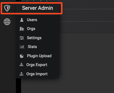

  1. You need to have Root Tenant Admin permissions.
  • Users with Root Tenant Admin permissions in the Dashboard have System Admin privileges and can access the Server Admin menu. anonymous-login-1-01.png

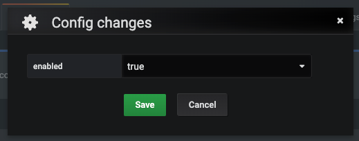

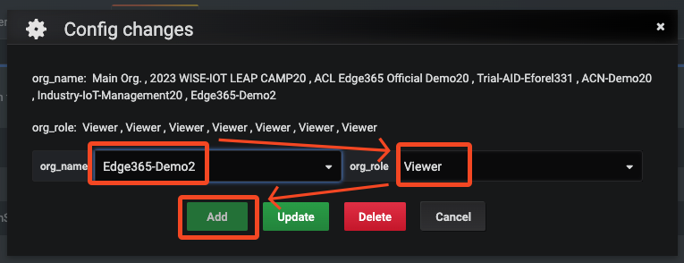

  4. Edit the org_name option and select the organization for which you want to enable anonymous login. Choose the "Viewer" role and click Add to add it. anonymous-login-1-05.png
  5. After completing Step 5, click the green update button on the Settings page to apply the changes. anonymous-login-1-06.png

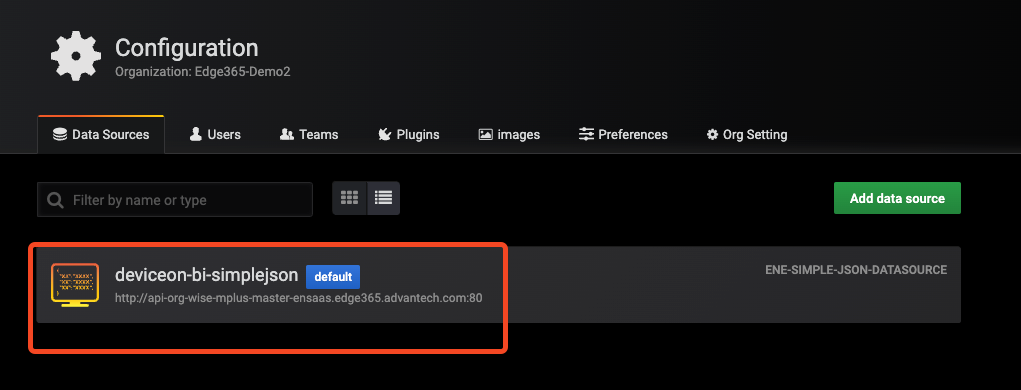

Configuring the Datasource​

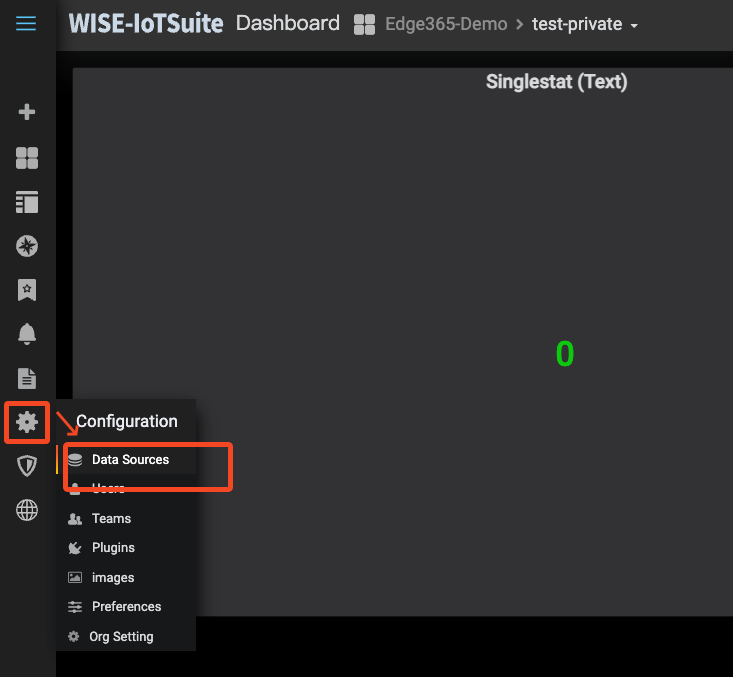

  1. Go to the Data Sources settings of the organization you want to configure. anonymous-login-2-01.png

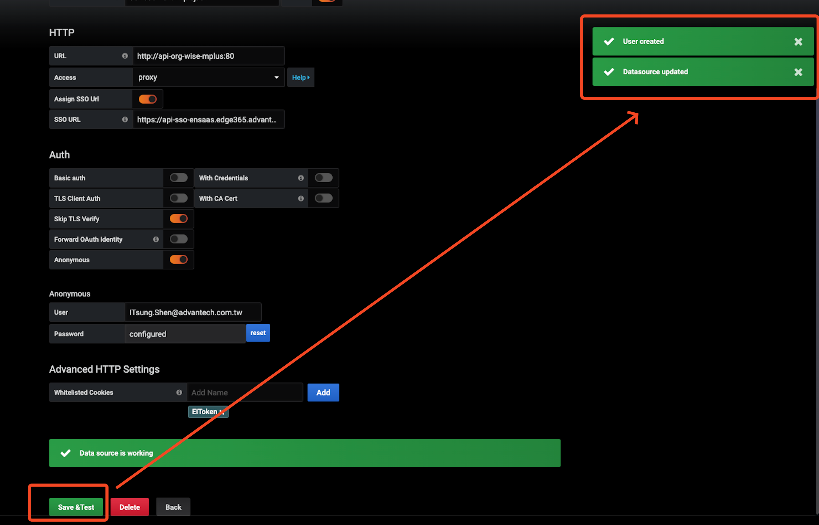

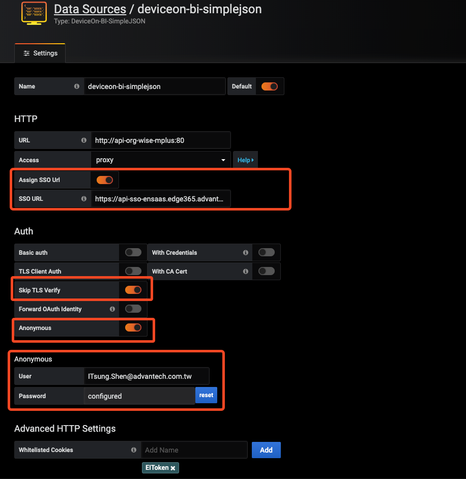

  3. The following additional settings need to be added:
  • Assign SSO URL: Enable
  • SSO URL: Enter the SSO API URL, for example, for EdgeHub master site:
  • Skip TLS Verify: Enable
  • Anonymous: Enable
  • Anonymous.user: Enter a username from your environment to be used for anonymous login.
  • Anonymous.password: Enter the password for the above user. anonymous-login-2-03.png
  1. Click Save & Test to confirm the successful configuration. anonymous-login-2-04.png

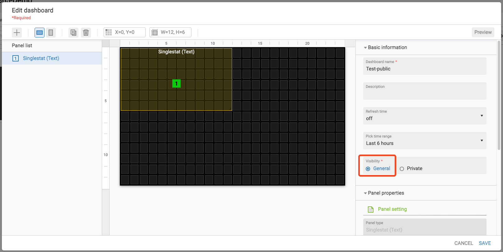

  1. Create a dashboard that can be viewed by the public. anonymous-login-3-01.png
  2. When adding/editing the dashboard, set its Visibility to "General". anonymous-login-3-02.png

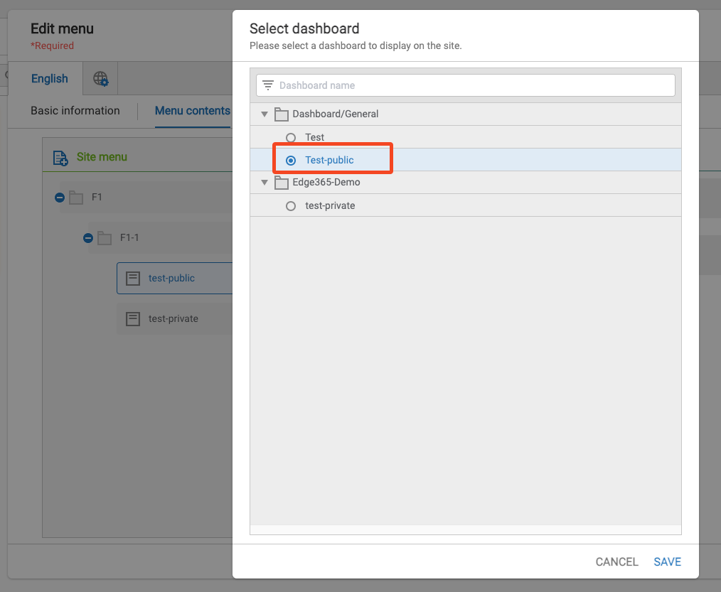

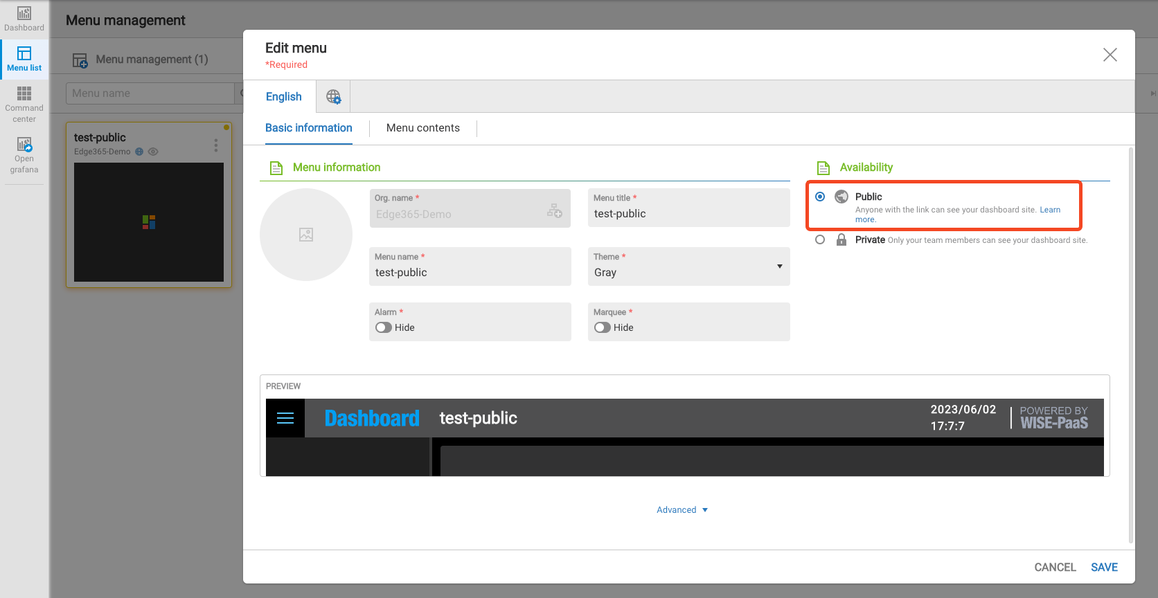

  3. Access the Menu List feature and add/edit a menu. Set the Availability to "Public". anonymous-login-3-03.png
  4. Edit the Dashboard within the menu and select the dashboard with General Visibility (as set in Step 2). This type of dashboard will be placed in the Dashboard/General folder. anonymous-login-3-04.png

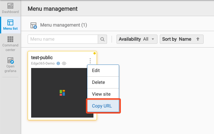

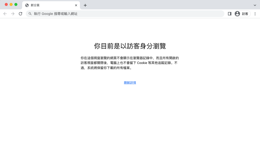

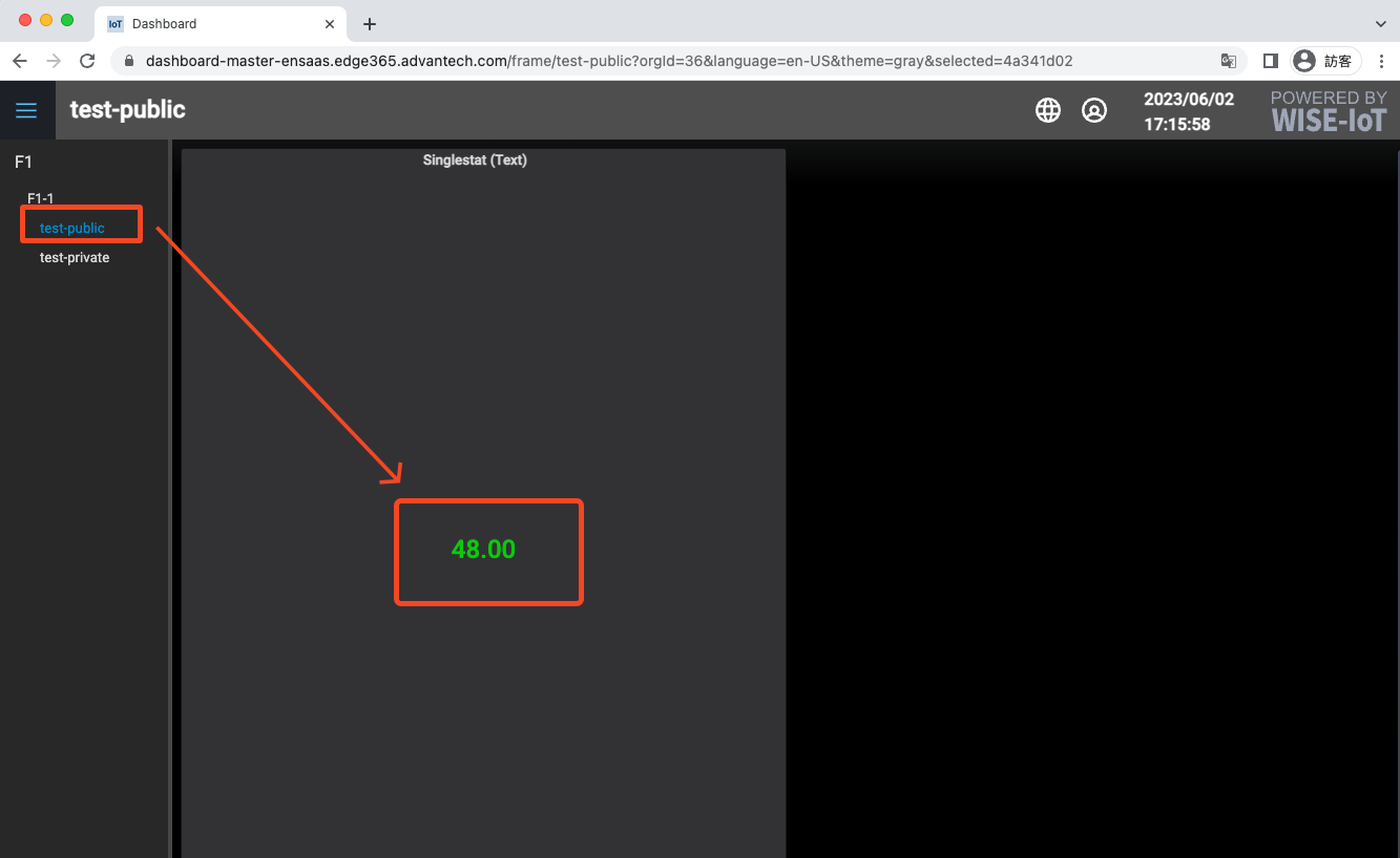

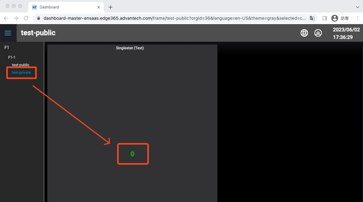

  7. Paste the Menu URL and verify that the dashboard content is visible without the need for login. anonymous-login-3-07.png

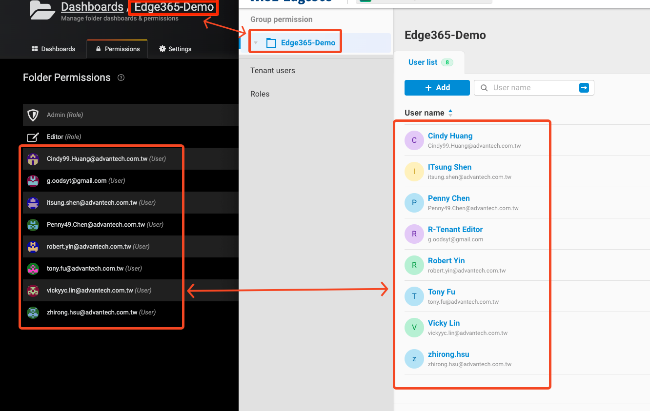

For security reasons, EdgeHub has added Group User permissions to Dashboard Folder permissions. This means that:
  • Group User = Dashboard Folder User
  • "Viewer" permissions are removed from Dashboard Folder permission, other users within the organization will not be able to see the contents of that folder.

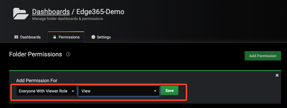

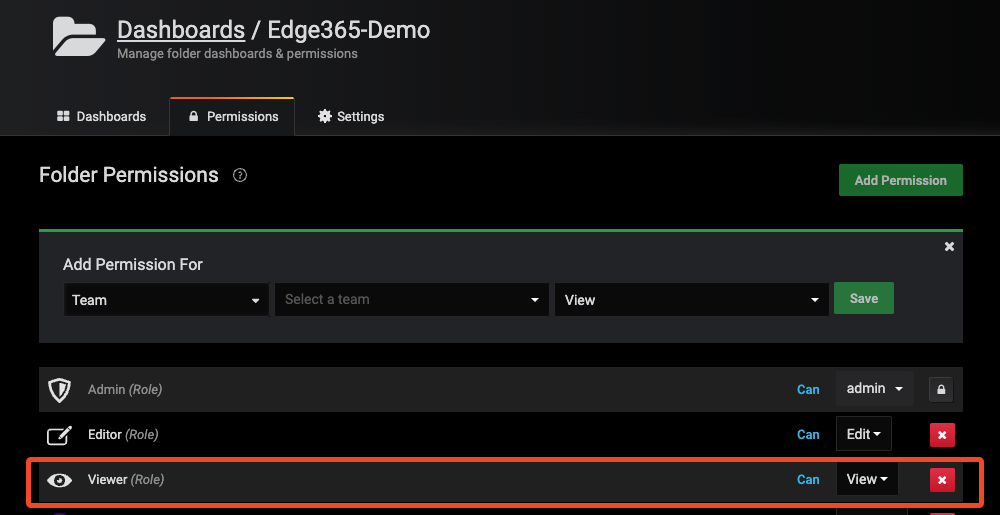

If you want to allow anonymous access to all Dashboards within a specific folder, you can directly add "Viewer" permissions to that folder:

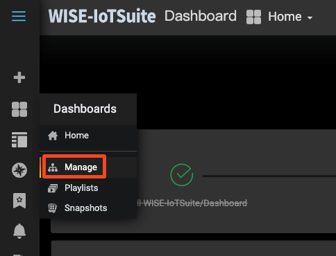

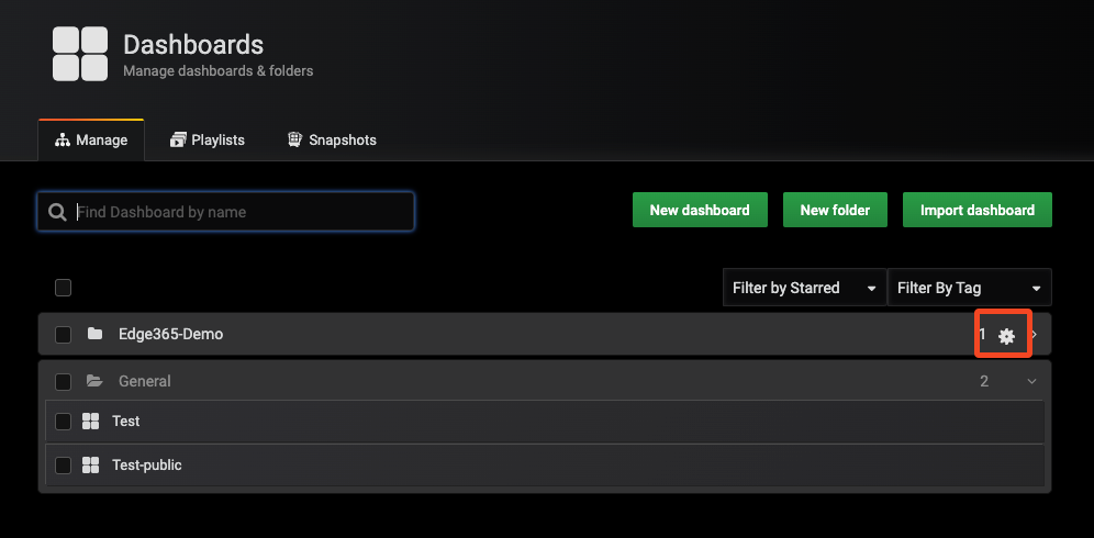

  2. Find the folder you want to edit and click on Settings anonymous-login-4-02.png
  3. Switch to the Permissions tab and click Add permission anonymous-login-4-03.png
  4. Select Everyone With Viewer Role and choose View. Then click Save to save the settings. anonymous-login-4-04.png
  5. You will see that a new Viewer is added to the list of people in the folder. anonymous-login-4-05.png
  6. In the Menu settings, select a Dashboard that is placed within your Group. anonymous-login-4-06.png
  7. Open a guest browser and verify that the Dashboard is displayed correctly. anonymous-login-4-07.png
