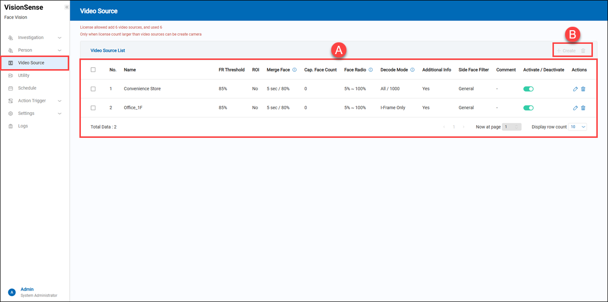

Video Source_List.png A.【Video Source List】 ⇒ The tip displays how many cameras can be added and how many cameras are used.
  • Name: The name of the video source.
  • FR Threshold: Face Recognition confidence threshold.
  • ROI: Indicates whether Region of Interest detection is enabled.
  • Merge Face: Settings for merging faces by time and confidence.
  • Cap. Face Count: Number of captured faces. The number of faces that can be detected and recognized when there are multiple faces within the same image frame.
  • Face Ratio: The minimum and maximum face ratio for detection.
  • Decode Mode: Video decoding method, e.g., All or I-Frame Only.
  • Additional Info: It indicates whether the analysis of gender, age, and emotion is enabled.
  • Side Face Filter: Displays the side face filtering level.
  • Comment: User-defined comments or notes.
  • Activate/Deactivate: Toggle to activate or deactivate the video source.
  • Action: Click icon_編輯.jpg 'Edit' to modify the video source or 'Delete' to delete it.
B.【Operation】 ⇒ Click the Icon_+Create_normal.png '+ Create' to add a video source, or the icon_刪除.jpg 'Delete' to remove multiple selected video sources.
