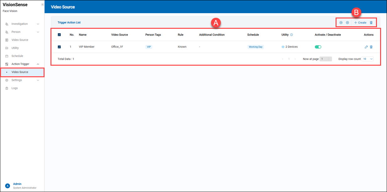

Action Trigger_Video Source_List.png A.【Trigger Action List】
  • Name: Rule name used to identify each trigger setting.
  • Video Source: The video source whose face recognition matching results will be used as input to trigger this rule.
  • Person Tags: The tags for identified individuals.
  • Rule: The recognition result that will be used to trigger the action.
  • Additional Condition: Using gender or body temperature as trigger conditions.
  • Schedule: Assigned schedule controlling when the trigger is active.
  • Utility: Utilities triggered.
  • Activate/Deactivate: Toggle switch to enable or disable the rule.
  • Action: Click the icon_編輯.jpg 'Edit' to enter the edit page or click the icon_刪除.jpg 'Delete' to delete the assigned data.
B.【Operation】
  • + Create/Delete: Users can click Icon_+Create_normal.png '+ Create' to add a new action trigger or click icon_刪除.jpg 'Delete' to remove multiple selected action trigger at a time.
  • Start/Pause: Users can click the Icon_Enable.png ‘Enable’ to enable multiple selected devices, the Icon_Disable.png ‘Disable’ to disable them.

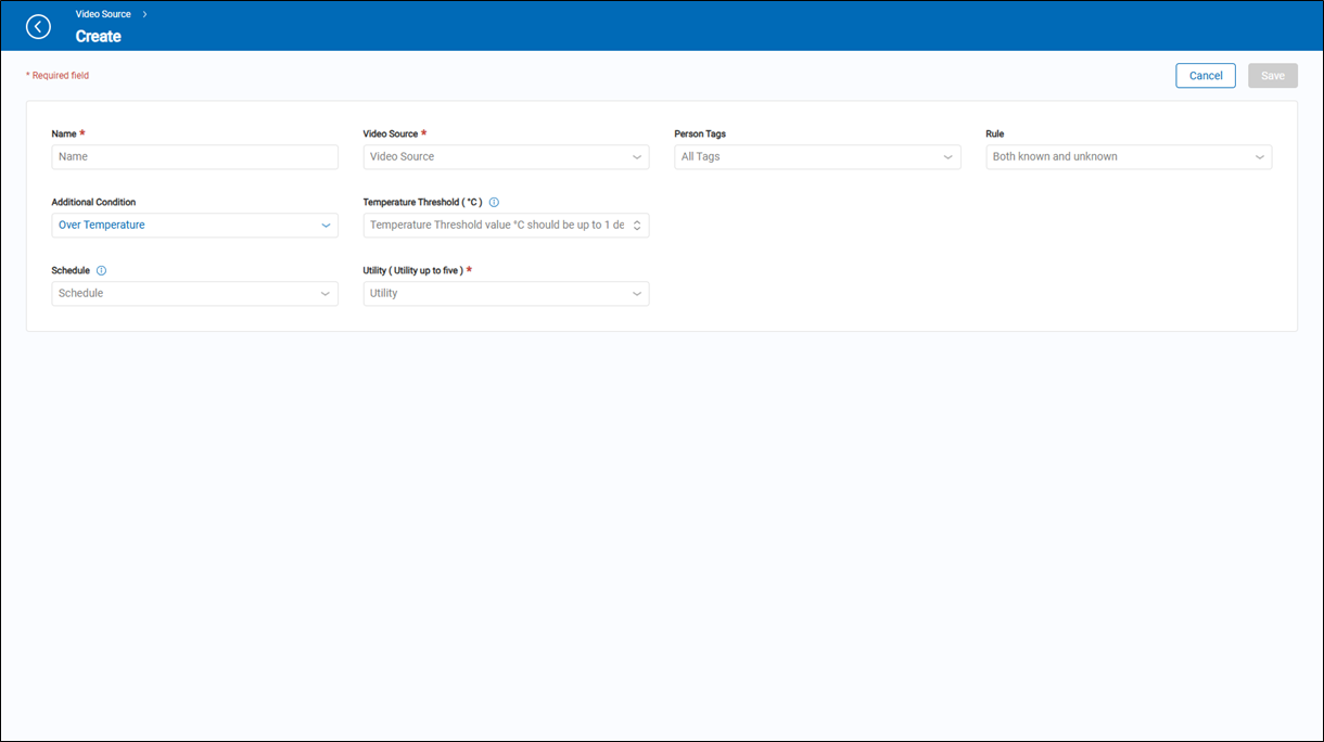

  • Name: A user-defined name for the the rule.
  • Video Source: Select the video source (e.g., IP camera) to which this trigger rule applies.
  • Person Tags: Select the person tag(s) to which the rule applies, such as VIP or Visitor. Multiple selections allowed.
  • Rule: Select the type of person to trigger the rule: Known, Unknown, or Both.
  • Additional Condition: Set additional conditions such as "Over Temperature" or "Gender."
  • Temperature Threshold(°C): When “Over Temperature” is selected, enter the temperature threshold (in °C) that triggers the action.
  • Schedule: Specify the time schedule during which the trigger rule is active, such as working days only.
  • Utility: Select the actions (utilities) to be executed when the rule is triggered, such as sending email, push notifications, or I/O control. Up to five actions can be selected. This is a required field.
