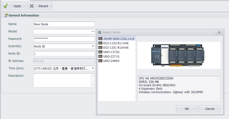

  1. Right-click on the project name to add a device.
  2. Enter a device name.
  3. Enter a password. This default password is 00000000. Users can change the password referring to Password Setting. After the password is changed, users need to enter the new one to download the project.
  4. Here allows users to identify the device by Node ID or IP Address.
  5. Enter the corresponding Node ID or IP Address.
  6. Select the time zone in which the device is located.
  7. Fill in the device description (optional).
