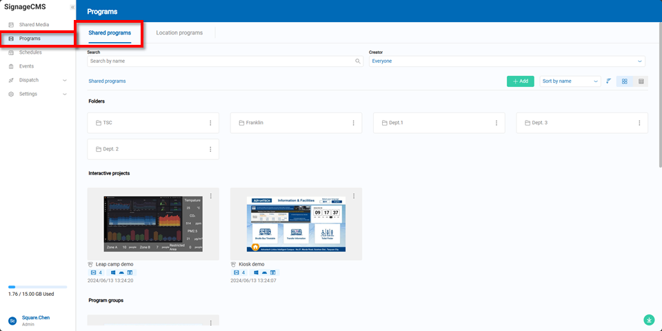

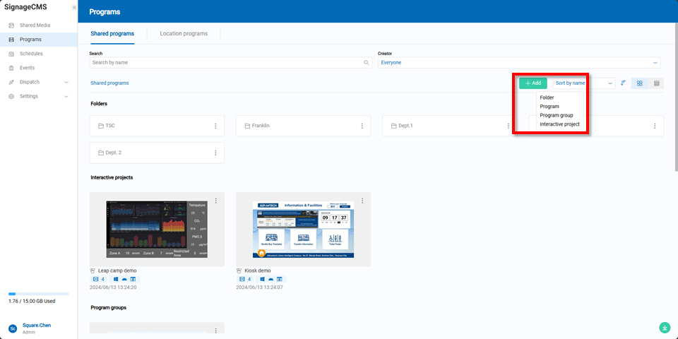

On the program management page, users can search for and locate programs and program groups created by others, as well as access folders, interactive projects, and programs from the shared program list. 投影片4.PNG
In the shared programs section, users can create new folders, programs, program groups, and interactive projects by clicking the "Add" button. 投影片5.PNG

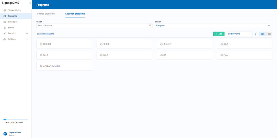

Within the location programs section, users can view already established locations. To add a new location, go to the system settings on the homepage and navigate to "Location Management." 投影片6.PNG

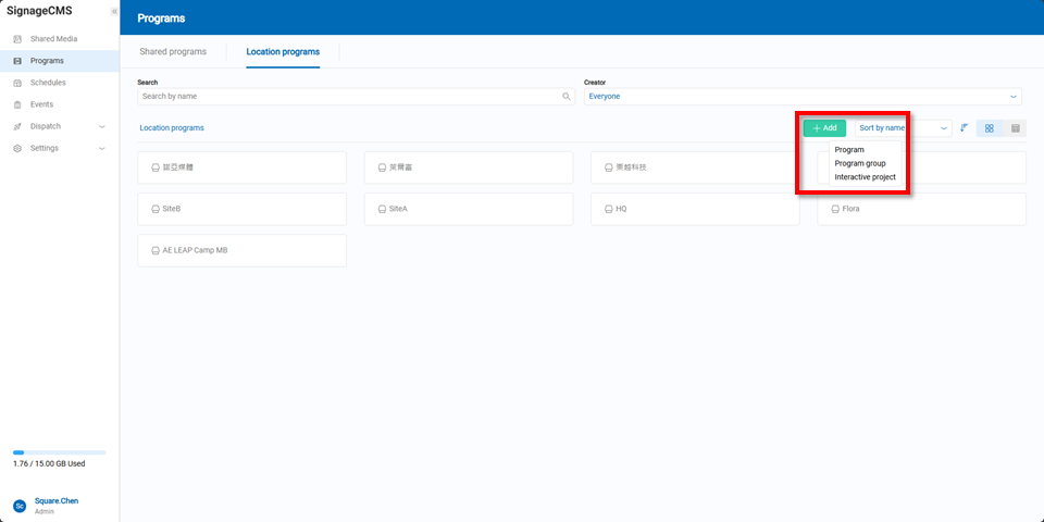

Users can also search for and locate programs created by others within the location programs section. By clicking the "Add" button, users can create new programs, program groups, and interactive projects. 投影片7.PNG

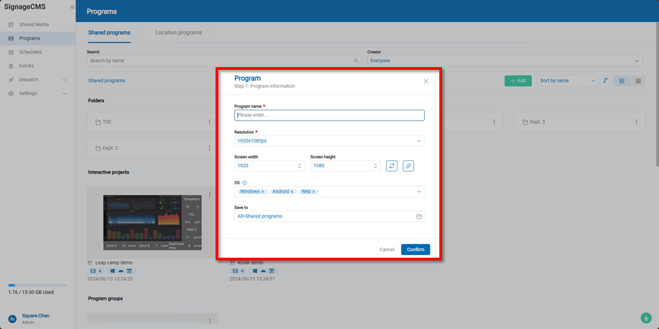

Whether adding a program in the shared programs or location programs section, users must name the new program, set the resolution, select the operating system, and choose where or which location to save it. 投影片8.PNG

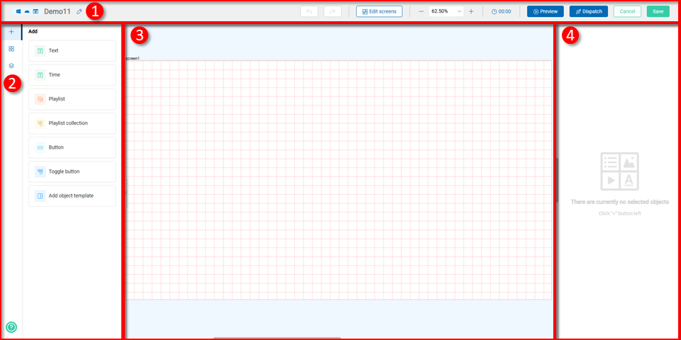

  1. Display Area:In this section, users can view the platform being used for the program, modify the program name, edit the screen, adjust the canvas editing area, preview, and deploy the program.
  2. Add Block Area:Users can add components, widgets, and adjust layers.
  3. Canvas Editing Area:All newly added blocks will be displayed in the editing area, where users can make adjustments to achieve the best results.
  4. Component Adjustment Area:After adding blocks, users can add, modify, and fine-tune them in the adjustment area. 投影片9.PNG

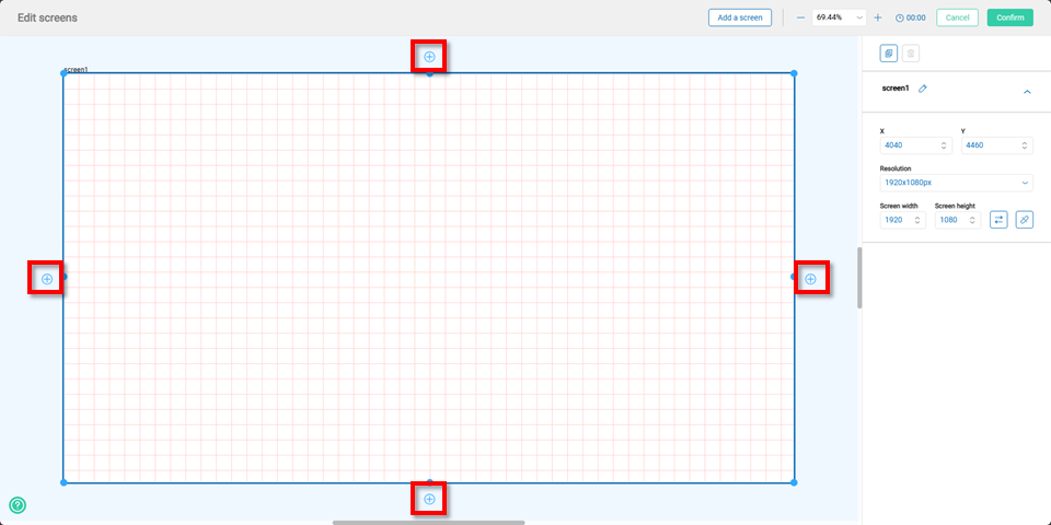

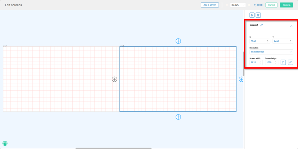

Users can click on the "+" icons at the edges of the screen to add screens, or click the "Add Screen" button at the top. 投影片10.PNG
After clicking on a newly added screen, users can adjust its coordinates and resolution, and switch between portrait and landscape modes to match the content being played on the player. 投影片11.PNG

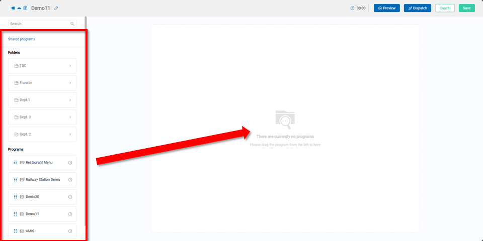

On the left side of the shared programs section, previously created programs are listed. Users can drag and drop the desired programs to the right side as needed. 投影片13.PNG

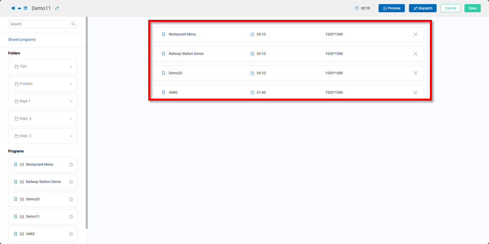

Once complete, users can see the programs that will be grouped, and they can drag and drop them to adjust the playback order. 投影片14.PNG

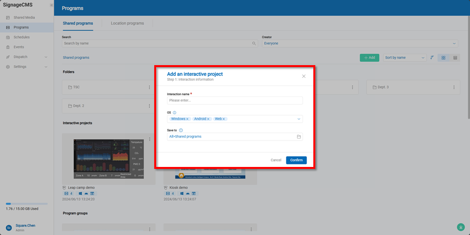

When creating a new interactive project, users must name it, select the operating system, and choose where or which location to save it. 投影片15.PNG

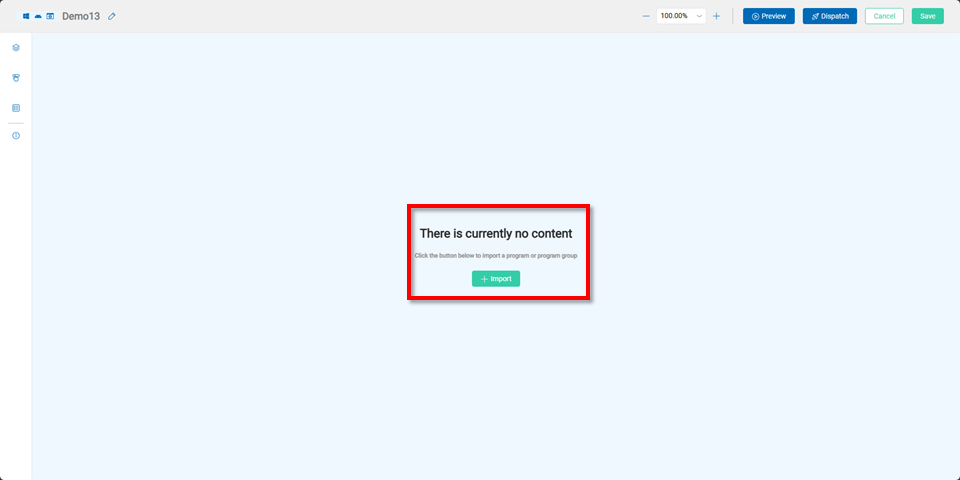

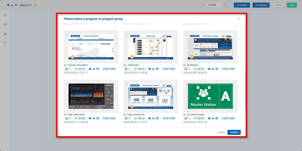

Click the button below to start adding programs or program groups. 投影片16.PNG

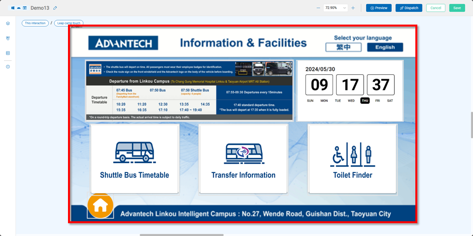

Once complete, you can begin building the interactive project. For detailed instructions, please refer to the specific guide:Link 投影片18.PNG
