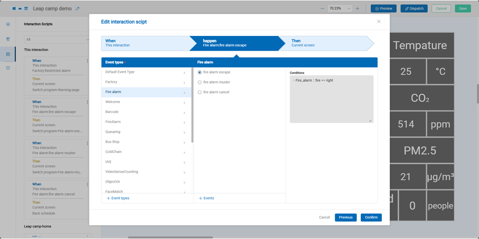

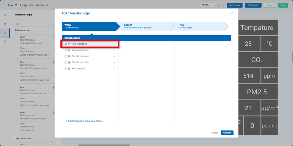

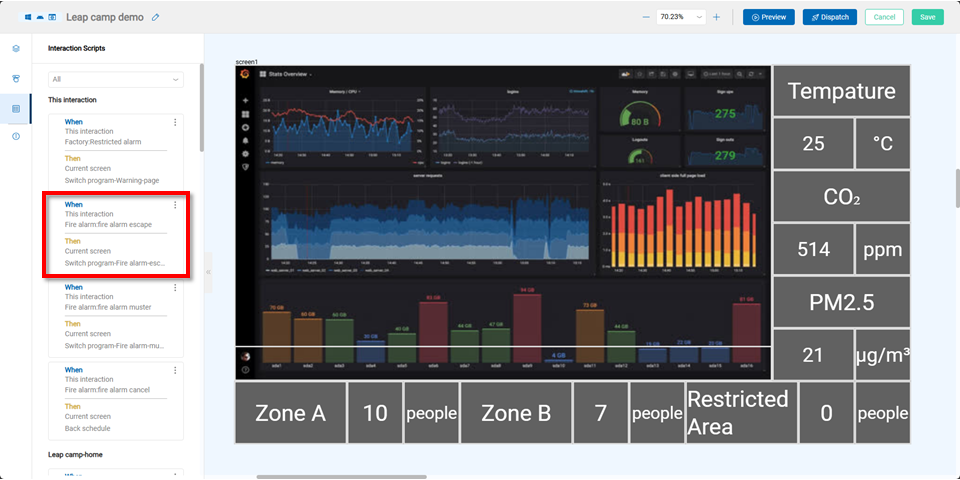

First, make sure that the interactive project includes a screen-switching requirement. 投影片4.PNG

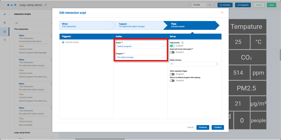

In the SignageCMS Interaction & API Integration Guide, the logic follows: “When someone triggers an event, then someone performs an action.” Example configuration: “When the interactive project triggers a fire alarm event, then the current screen switches to the fire emergency program.” In other words: “This interactive project” → triggers “fire alarm escape” → then “switch program” 投影片5.PNG 投影片6.PNG 投影片7.PNG

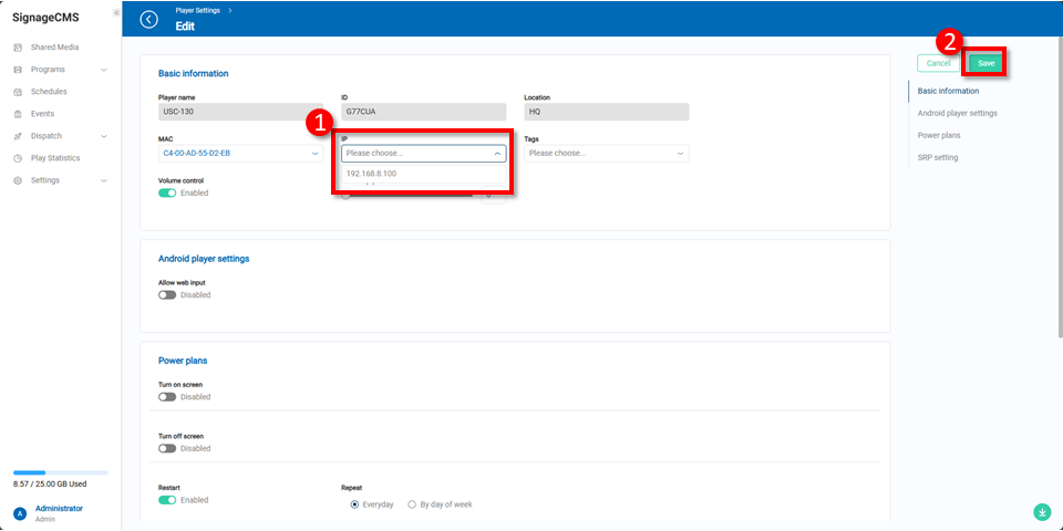

After confirming that the settings are correct, you must bind a static IP address to the player so the API can correctly trigger and switch content.
Please set a static IP address for the player. If no static IP is configured, incorrect IP settings may prevent the API from functioning properly.
Navigate to Settings → Player, and click the Edit icon for the target player. 投影片8.PNG

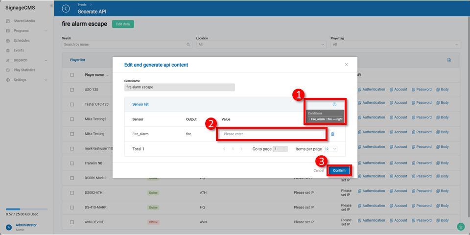

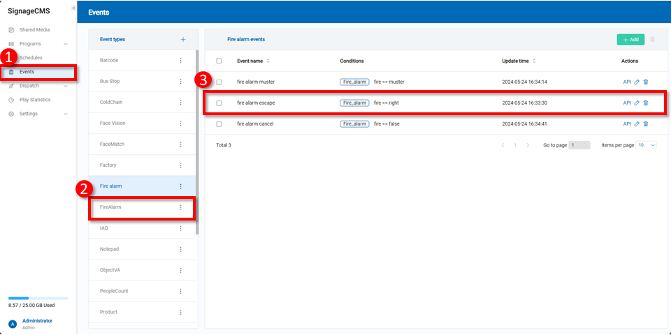

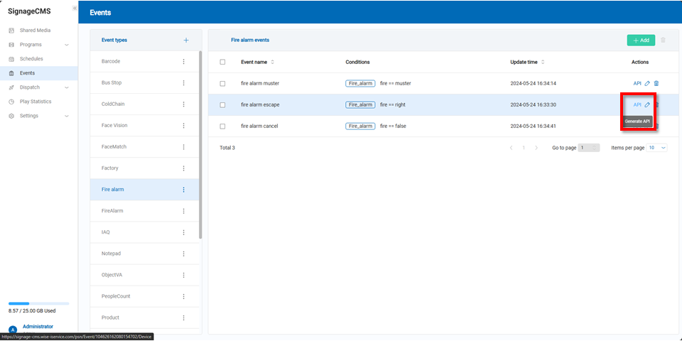

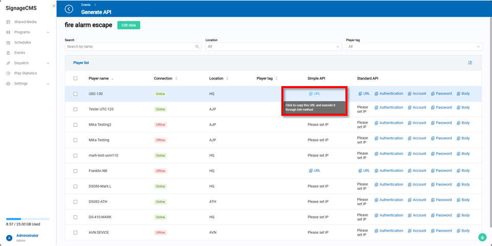

Go to the Events page, locate the event you previously created, and click the API icon to generate the API path. 投影片10.PNG 投影片11.PNG
Enter the values you set during event creation into the blank fields. If you're unsure what to input, hover your mouse over the “i” icon to see tooltips. After filling out the fields, click the Confirm button. 投影片12.PNG

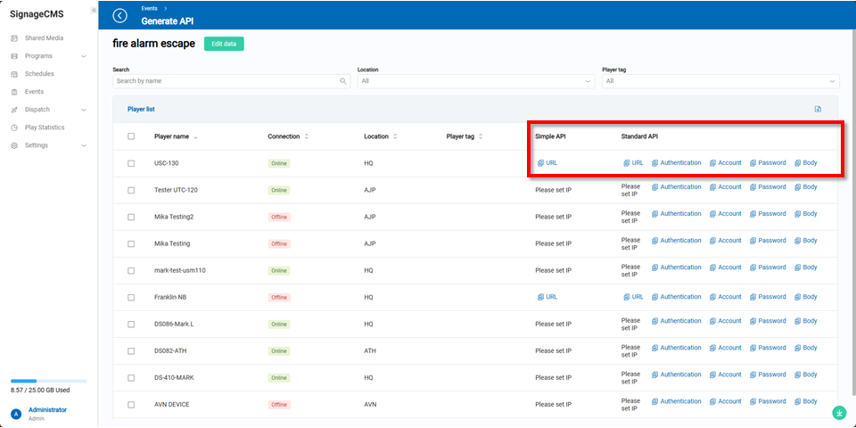

Once the API is generated, you will see two types: Simple API and Standard API. These are detailed below.
If no URL appears, it means the player IP has not been set. Please return to the player settings page to bind the IP.
Simple API​

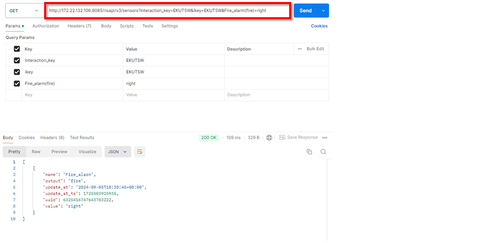

The Simple API allows users to copy the URL and paste it directly into a browser to trigger the desired action. 投影片14.PNG
Using Postman to execute the Simple API: Paste the copied URL into Postman, set the method to GET, then click Send. 投影片15.PNG

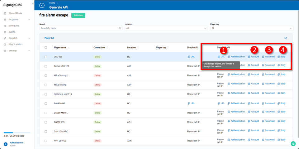

Standard API​
The Standard API is designed for users with development needs, allowing for preset configuration through integration. 投影片17.PNG

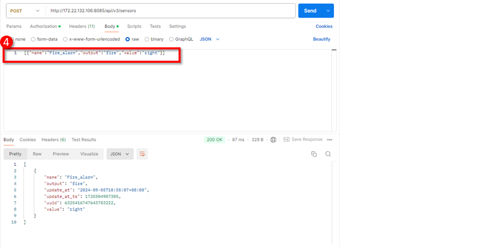

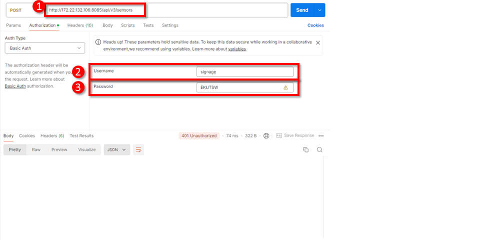

Using Postman to execute the Standard API: Fill in the required fields:
  1. URL, 2. Account, 3. Password, 4. Body Copy these values into Postman and click Send. 投影片18.PNG 投影片19.PNG
The screen will then successfully switch to the designated program. 投影片20.PNG
