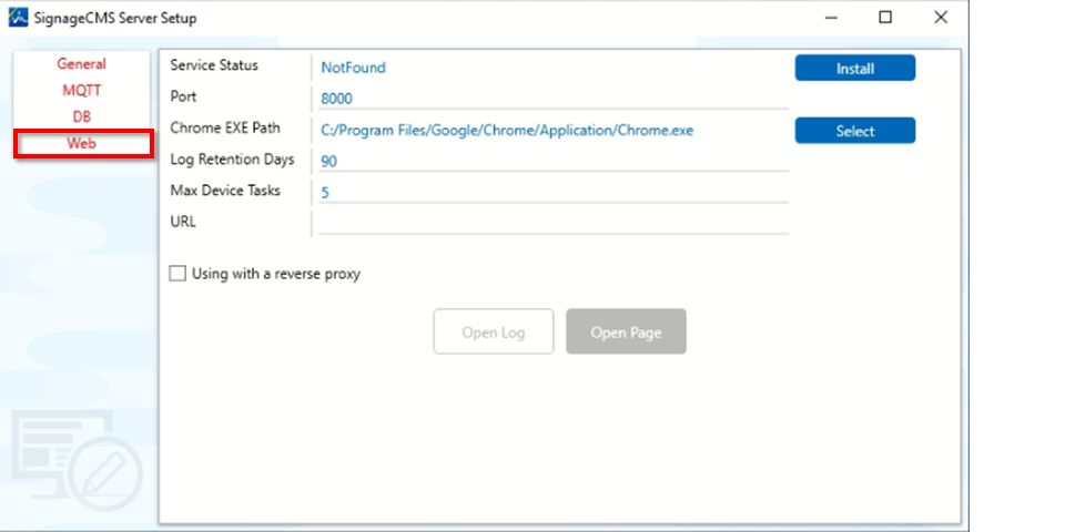

投影片11.PNG Service Status: Displays the current service status, which can be either NotFound or Running. Install Button: Click to install the Web service. Port: The default port number for the Web service, set to port 8000 by default. Chrome EXE Path: The installation path for Chrome. Select Button: If the Chrome installation path has changed, select the corresponding path. Log Retention Days: The number of days logs are retained, with a default setting of 90 days. Max Device Tasks: The maximum number of devices that can receive programs or schedules at once, with a default setting of 5 devices. URL: To ensure the proper operation of the dispatch and alert notification functions. Please enter http://SERVER_IP/. If an external domain is used, configure the corresponding URL, such as http://domain name/. Using with a Reverse Proxy: If you are using a Proxy Server, check this option and set the Proxy Server location and port number. This option is unchecked by default. Open Log Button: Click to open the log location. Open Page: Click to open the server web page.
