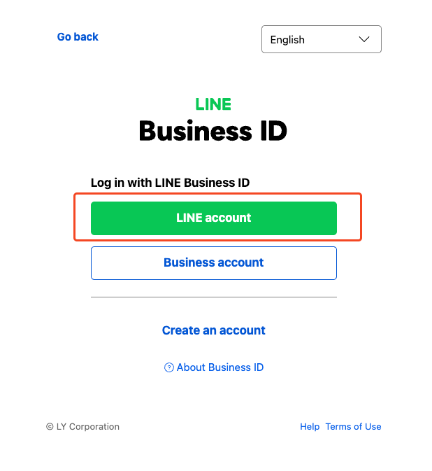

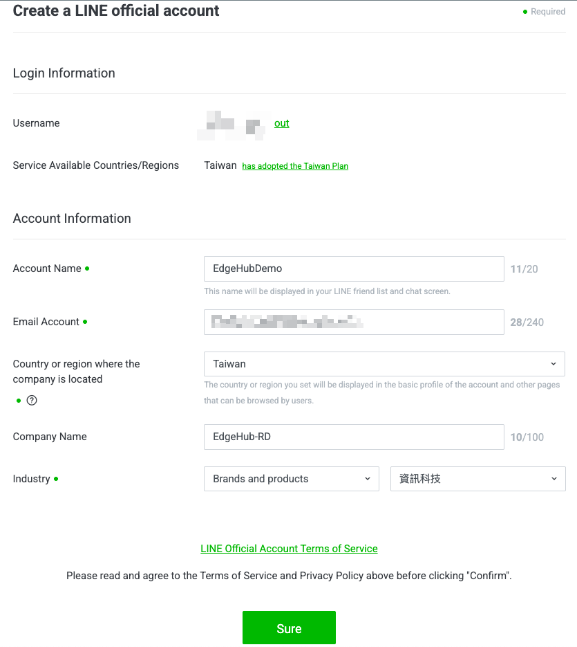

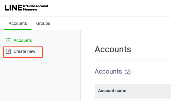

  1. Go to LINE Business ID and sign in with your LINE account.
  2. Click Create new.

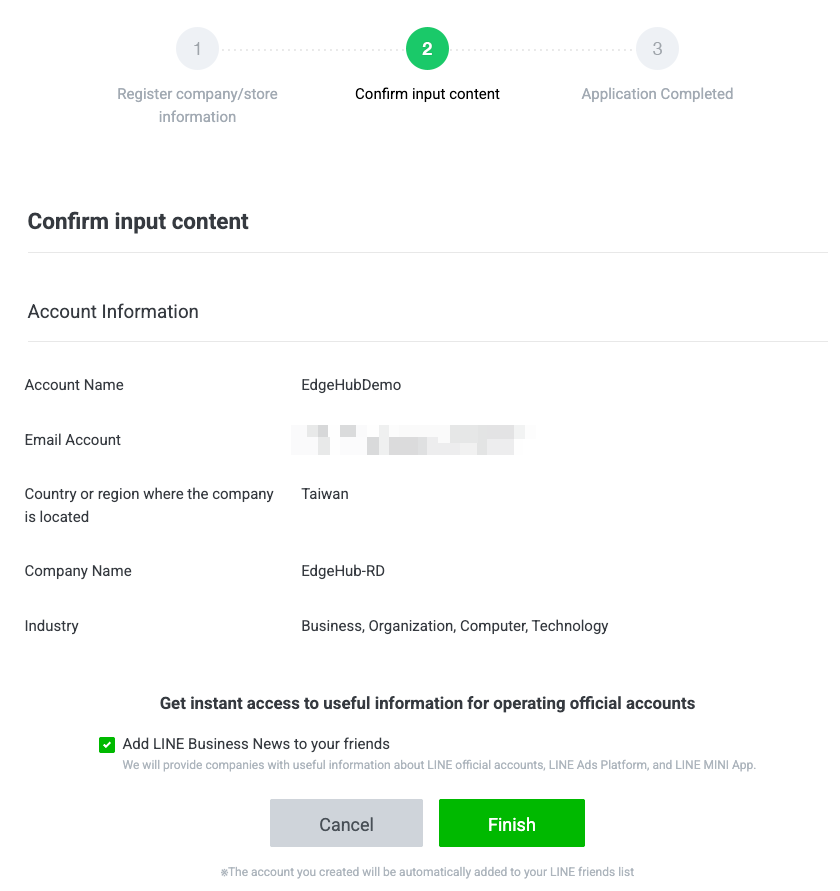

  3. Fill out the registration form and submit it.
  4. Confirm the information you entered.

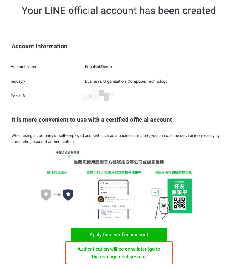

  5. After the account is created, choose Verify later.

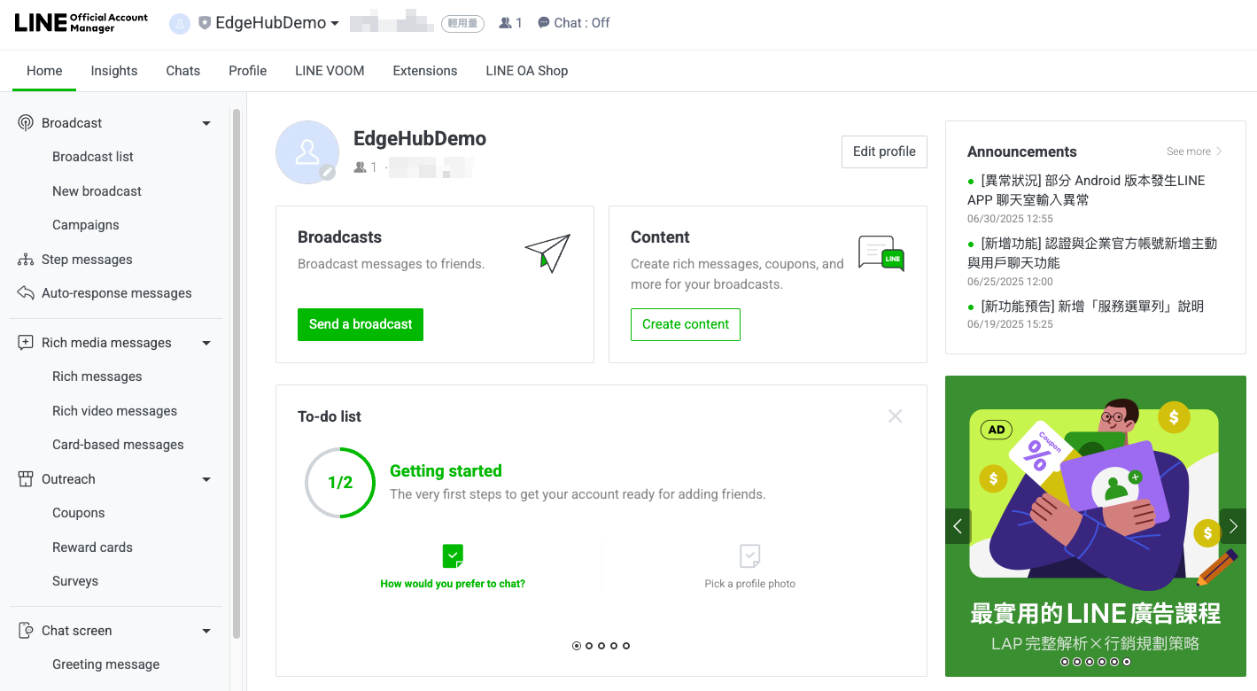

  6. Return to the console; you can now manage your LINE Official Account.

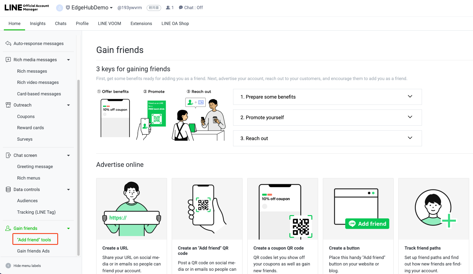

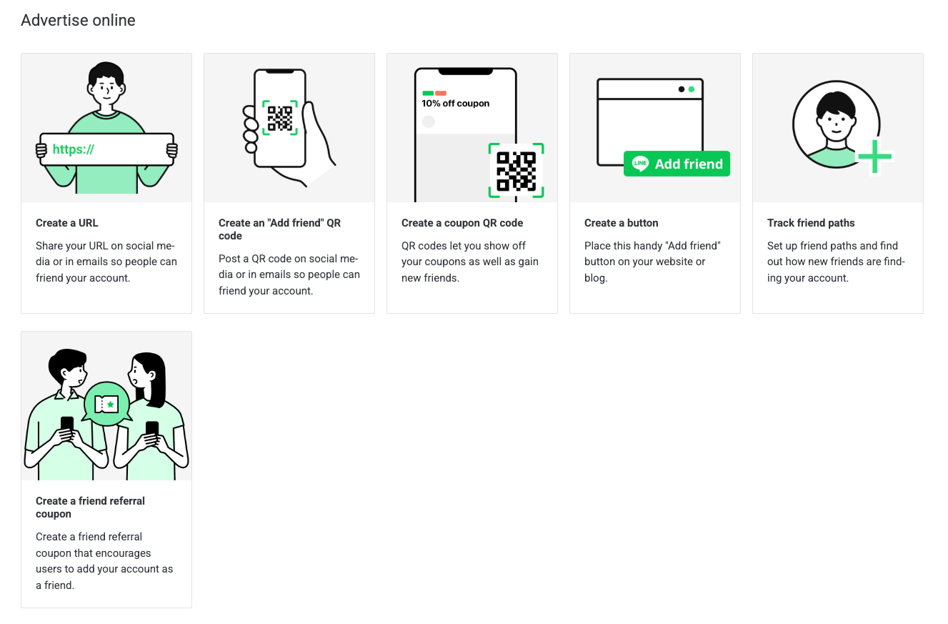

  1. In the console, navigate to Gain friends → “Add friend” tools.
  2. LINE provides several ways to invite users to your OA—QR code, link, etc. Follow the on-screen instructions to invite users. LINE-OA-2.2-02-add-by-many-ways.png

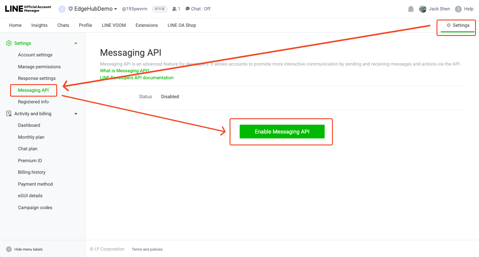

  1. In the console, go to Settings → Messaging API → Enable Messaging API.

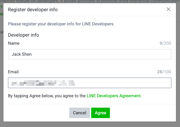

  2. Enter developer information.

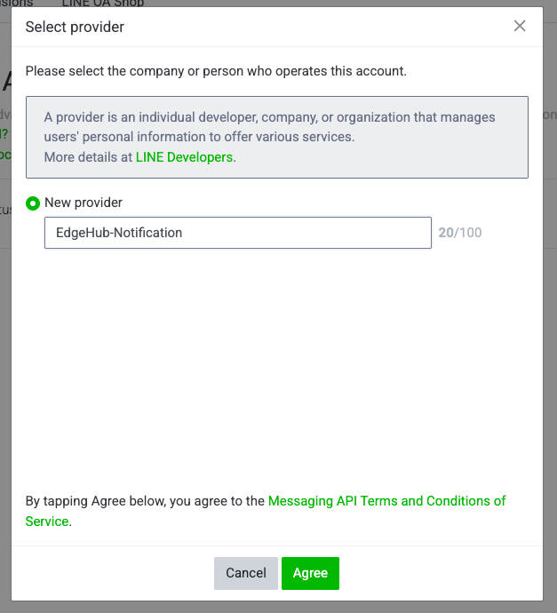

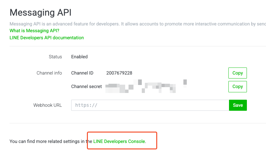

  3. Enter any string as the provider name.
  4. Once enabled, the status shows Enabled. Click LINE Developers Console.

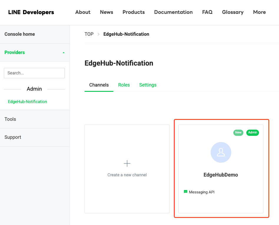

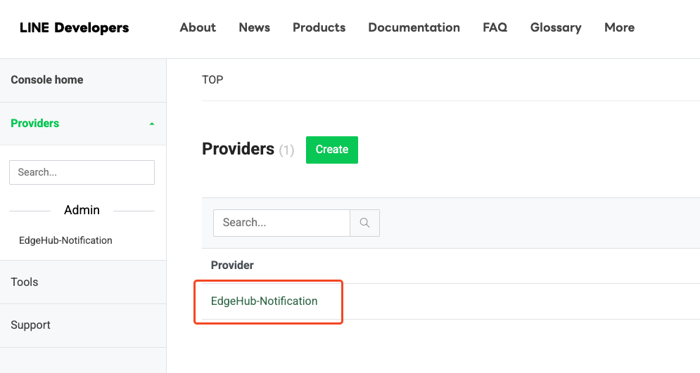

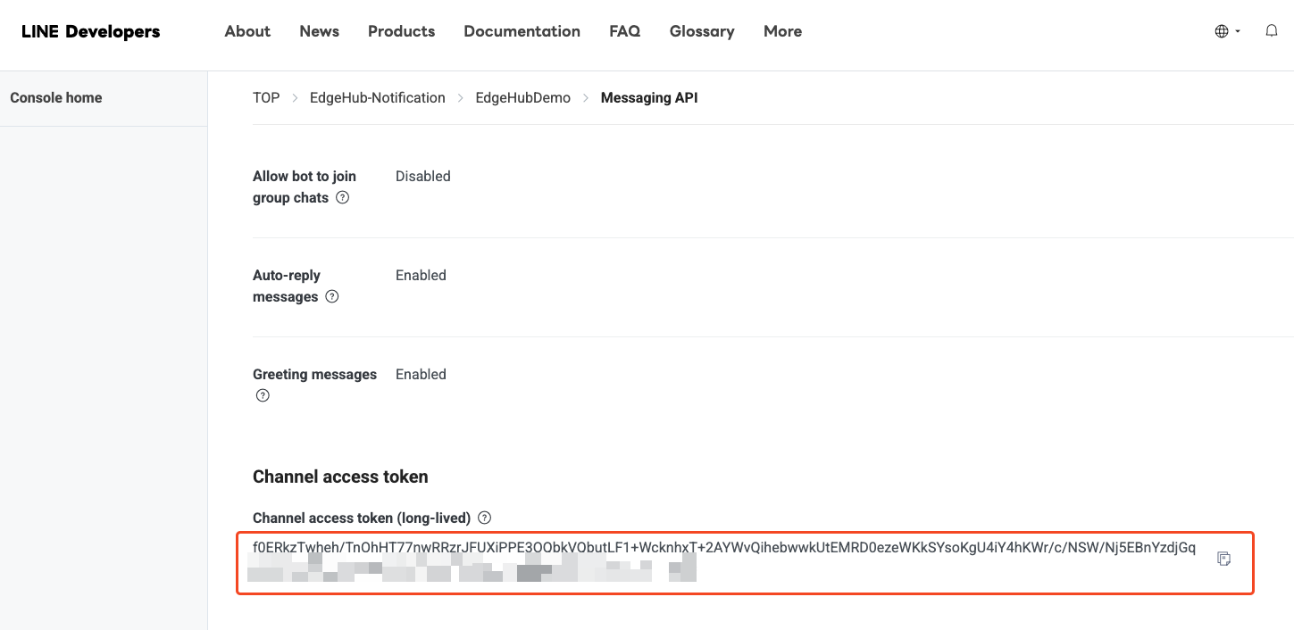

  5. In the Developers Console, click the provider you just created.
  6. Select the Channel that corresponds to your OA.

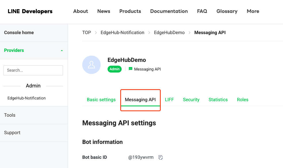

  7. Open the Messaging API tab.

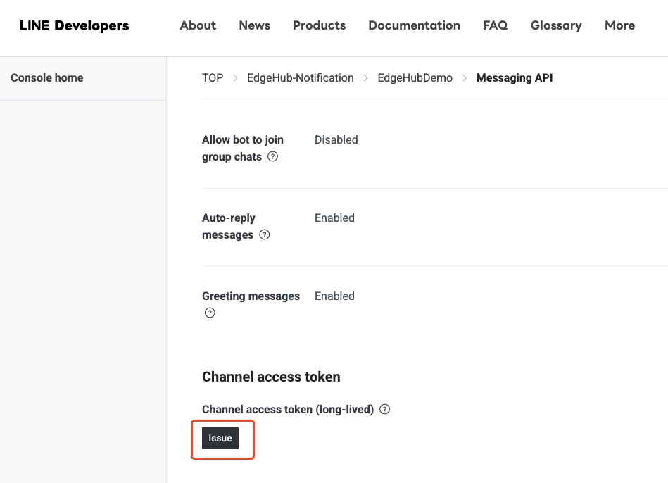

  8. Scroll to Channel access token, then click Issue.
  9. Copy the generated token and paste it into EdgeHub’s Alarm User Group settings.

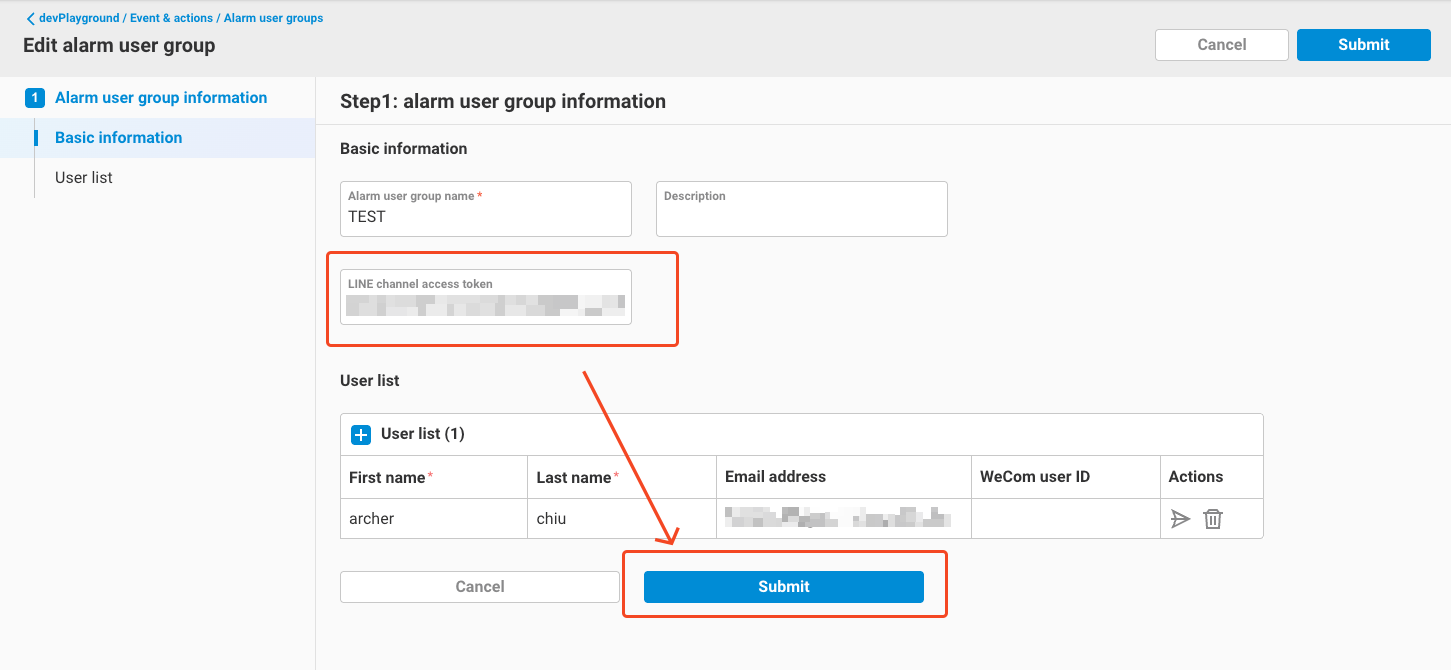

  1. Open the Alarm User Groups tab and click Add to create a new group or Edit to modify an existing one.
  2. In the setting page, you will see a LINE Channel Access Token field. Paste the token from section 2.3, fill in the remaining fields, and submit.
  3. After saving, the configuration is complete. Other notification settings remain unchanged. For details, refer to the Event & Actions documentation.
