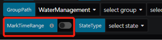

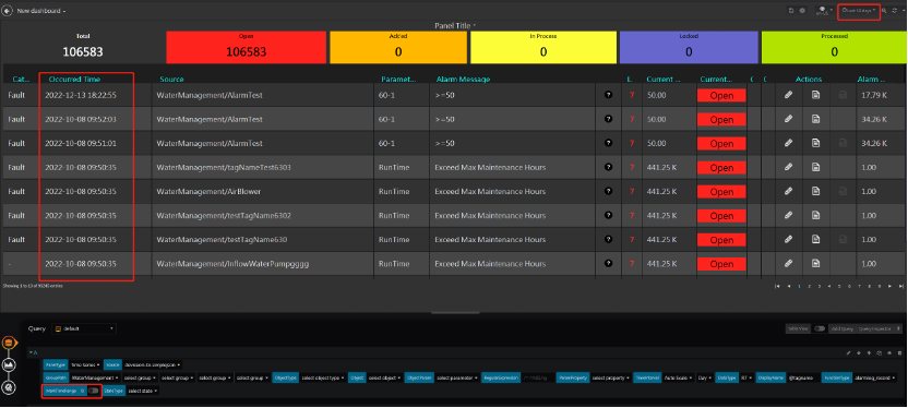

Additional options:​
When query for RT alarms, select the 'MarkTimeRange' checkbox datasource-function-04.png
to enable the feature of limiting the alarm time range by using the "Dashboard.TimeRange". datasource-function-05.png datasource-function-06.png

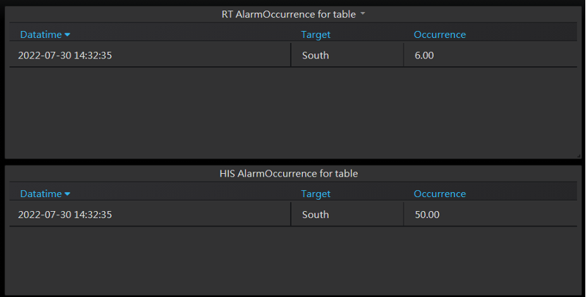

Support two format: Table,Timeseries datasource-function-08.png Timeserie format
  • target: “GroupName or ObjectName”
    • datapoints:
      • alarm occurrence
Table format:
  • Datatime
  • Target:Group name or Object name
  • Occurrence:alarm occurrence

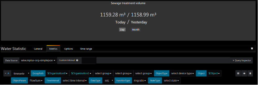

Description:​
Compare the selected parameter value with the previous time interval (currently support day / month)
Use this function with water-statistic-panel​

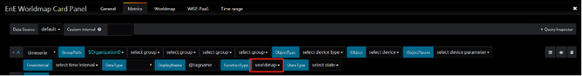

Description:​
Display Group Map Card Information of selected org and its sub-orgs which contain the following parameter:
  • status (Discrete):
    • Group status, which need to contain the following state:
      • 0:Normal
      • 1:Warning
      • 2:Critical
    • The data should come from your device or a calculation parameter. Please noted that this function needs to collaborate with EnE WorldMap Card Panel
Input:​
  • GroupPath
  • FunctionType:worldmap

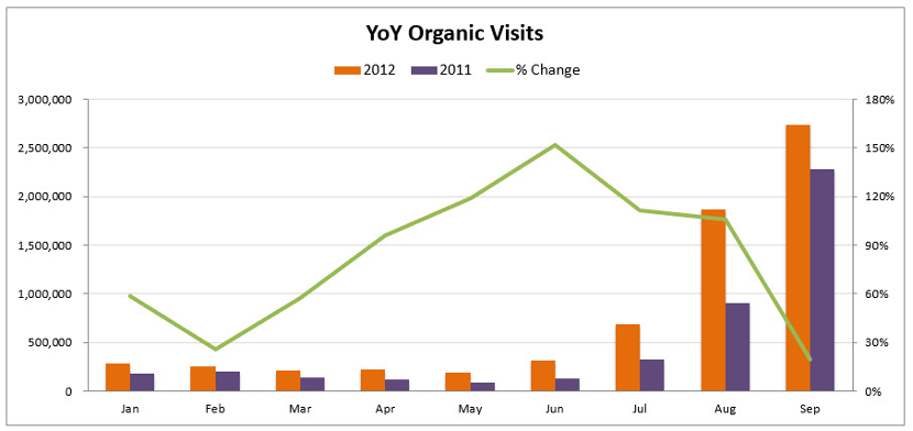

Diagram:​
YoY Trend​
Function name translation:​
en: ['YoYTrend'],
zh_cn: ['同比趋势'],
zh_tw: ['同比趨勢'],
ja: ['前年同期比の傾向']
Description:​
Calculate the “Year on Year” trend of specific parameter (Currently support day, month, year data) with in specific time range.
Input:​
  • GroupPath
  • Object
  • ObjectParam
  • FunctionType: YoYTrend
  • TimeInterval:
    • Min: no support, return same data as Day.
    • Hour: (This hour - Same hour yesterday) / Same hour yesterday, One data per hour.
    • Day: (Today- Same day last year) / Same day last year, One data per day.
    • Month: (This month - Same month last year) / Same month last year, One data per month.
    • Year: (This year - Last year) / Last year, One data per year.
Return:​
Timeserie format
  • target: “Current”
    • datapoints:
      •  Trend of current data, one data per TimeInterval (hour/day/month/year)
  • target: “Past”
    • datapoints:
      • Trend of past data (same hour yester or same TimeInterval last year for Day/Month/Year), one data per TimeInterval (day/month/year).
  • target: “ratio”
    • datapoints:
      • YoY ratio per TimeInterval (hour/day/month/year)
Diagram​

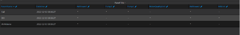

ReportAnalogBasic​
en: ['reportAnalogBasic', 'report'],
zh_cn: ['报告模拟量基本信息', '报告'],
zh_tw: ['報告類比量基本資訊', '報告'],
ja: ['アナログ量の基本情報のレポート', 'レポート作成']
Description:​
Return 1 to multiple selected parameters’ last/max/min/avg historical data in table format (one data per TimeInterval). Currently only support Analog parameter. Notice that this function needs to collaborate with ene-report-panel. datasource-function-37.png
Input:​
  • GroupPath
  • Object
  • ObjectParam:one to multiple parameters that you want to display. The input format could be:
    • {param01,param02,…}
    • (param01|param02,….)
    • Param01,param02,….
  • FunctionType:reportAnalogBasic
  • TimeInterval:Time interval of data
Return:​
datasource-function-39.png Table format:
  • Objname:Selected parameter’s object name
  • Datatime:data time
  • Parameter.last:Selected parameter’s last value
  • Parameter.avg:Selected parameter’s average value
  • Parameter.max:Selected parameter’s max value
  • Parameter.min:Selected parameter’s min value

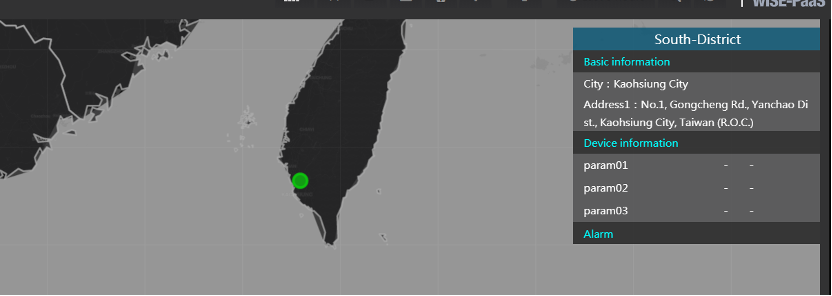

ReportGroupInfo​
en: ['reportGroupInfo'],
zh_cn: ['报告组织数据'],
zh_tw: ['報告組織資料'],
ja: ['レポート・グループ情報']
Description:​
Return basic group information (Postal code, Location (Group Name), Address (Address1 + Address2)) and Parameter data for each object under each location (group). The detailed function description is as follows:
  • Each group, for each time interval, is one row.
  • Each row content = [time, Postal code, Location (Group Name), Address (Address1 + Address2), object01(param01), object02(param01), ..., object01(param02), ...]
  • Multiple queries need to be configured for usage, each query selecting its own Group
    • Each query can choose different data types, including RT/HIS/HIS_AVG/HIS_MIN/HIS_MAX
    • Each query can choose different time intervals, supporting recording rate/hour/day/month/year
  • Each query can select only its parameters without choosing objects, listing all selected same-named parameter values under this group, presented in the format objectName:parameterName, one column per parameter.
  • All Queries selecting the reportGroupInfo function will be merged into one table and returned. If the same parameter name exists in different rows, it will be merged into one column, example as follows:
    • QueryA; Group1 => Param1 (in obj1, Obj2)
    • QueryB: Group2 => Param1 (in obj2, obj3), Param2 (in obj2)
      TimePostal codeLocationAddressObj1:Param1Obj2:Param1Obj3:Param3Obj2:Param2
      t100Group1addr-G11020--
      t101Group2addr-G2-304055
  • Table columns are sorted by Query and Parameter order, within the same Query, the same Parameter is sorted by objectName, and the length is auto-extended.
  • For parameters not existing in the group, the value is returned as ‘-‘.
  • If a query selects only one parameter, display name is supported.
  • If a query selects multiple parameters, display name is not effective.
  • If different parameters across multiple queries are set to the same display name, they will be displayed as the same column. Users should be aware.
  • If two queries select the same named parameter and the display name is the same, they will be merged into one column.
  • If two queries select the same named parameter but the display name is different, they will be split into two columns.
Input:​
  • GroupPath:select the group that you want to display
  • Object:optional
  • DataType:RT/HIS/HIS_AVG/HIS_MIN/HIS_MAX
  • TimeInterval:recording rate / hour / day / month /year
  • FunctionType:reportGroupInfo
  • DisplayName:
    • Please manually modify to @objname:@tagname to enable the display format objectName:parameterName, or change to a custom display name.
    • Modifying the display name is only supported if a query selects a single parameter.
Return:​
Table format:
  • Datatime
  • PostalCode
  • Location:
  • Address:
  • Object1:Parameter1
  • Object2:Parameter1
  • Object3:Parameter1
  • Object1:Parameter2
  • Object2:Parameter2
  • Object3:Parameter2

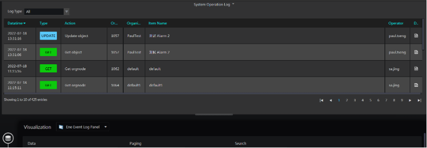

SysOperationLog​
en: ['SysOperationLog'],
zh_cn: ['系统操作日志'],
zh_tw: ['系統操作日誌'],
ja: ['システム操作ログ']
Description:​
Use this function to get EdgeHub's system operation logs datasource-function-52.png
Return:​
Use this function together with Ene Event Log Panel datasource-function-53.png
In Ene Event Log Panel, open Log Type setting and filter the log type on it. datasource-function-54.png
Each Log Type can be set diffenent display style in Column Styles setting. datasource-function-55.png

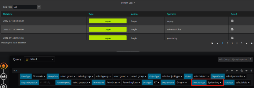

SystemLog​
en: ['SystemLog'],
zh_cn: ['系统日志'],
zh_tw: ['系統日誌'],
ja: ['システムログ']
Return:​
Return the login / logout logs of EdgeHub portal. Please refer to SysOperationLog function for futher setting details. datasource-function-56.png
