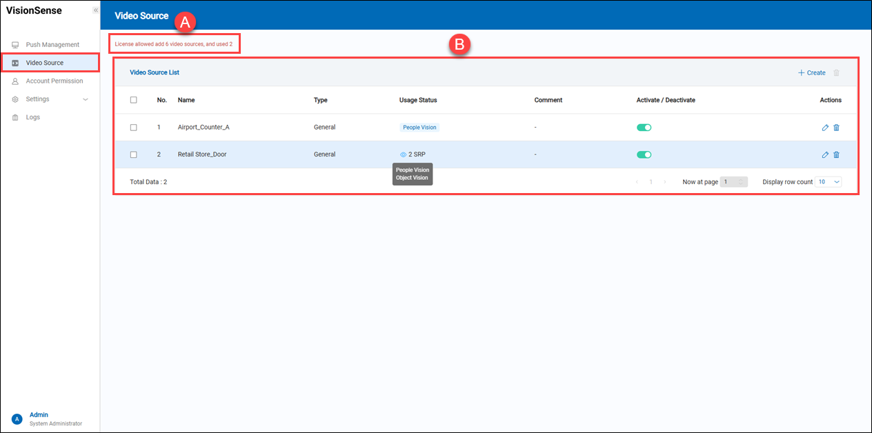

Video Source_1-1.png A.【Number of Licenses】 ⇒ The tip displays how many cameras can be added and how many cameras are used. B.【Video Source List】 ⇒ Users can quickly search for a people-counting unit's history by following conditions.
  • Name: It displays the name of the added counting unit.
  • Type: It displays the type of video source. 'General' refers to an IP camera, while 'Webcam' refers to a webcam.
  • Usage Status: It displays which application service is using the video source. If multiple application services are using it, click the 'view' to view details.
  • Comment: (optional) Users can input any string for notes.
  • Activate/Deactivate: Users can activate or deactivate this video source profile. If users deactivate the video source, the counting unit will stop working until it is activated again.
  • Action: Users can edit and delete the added video source.
  • + Create/Delete: Users can click Icon_+Create_normal.png '+ Create' to add a video source and click icon_刪除.jpg 'Delete' to remove multiple video sources at a time.

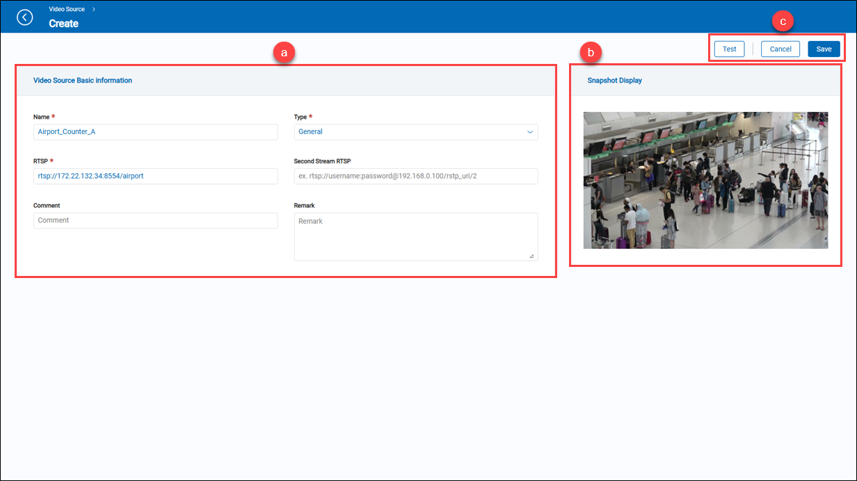

  • Name: A user-friendly name for identifying this camera.
  • Type: Allows users to add an IP camera or a webcam. 'General' refers to an IP camera, while 'Webcam' refers to a webcam.
  • Webcam: Existing webcam options list.
  • RTSP: The main stream of the IP camera's full RTSP URL path, including the device’s username and password. (i.e.: rtsp://root:pass@192.168.100.66:554/axis-media/media.amp)
  • Second Stream RTSP: The sub stream of the IP camera's full RTSP URL path, including the device’s username and password. (i.e.: rtsp://root:pass@192.168.100.66:554/axis-media/media.amp)
  • Reamrk: (optional) Users can input any string for notes.
b.【Snapshot Display】 ⇒ This is the live stream snapshot field. c.【Operation】 ⇒ To save or cancel those settings. Once users have done these settings, they can click the 'Test' to get a live snapshot from the video source. If successful, the live snapshot will be displayed in the snapshot field.
