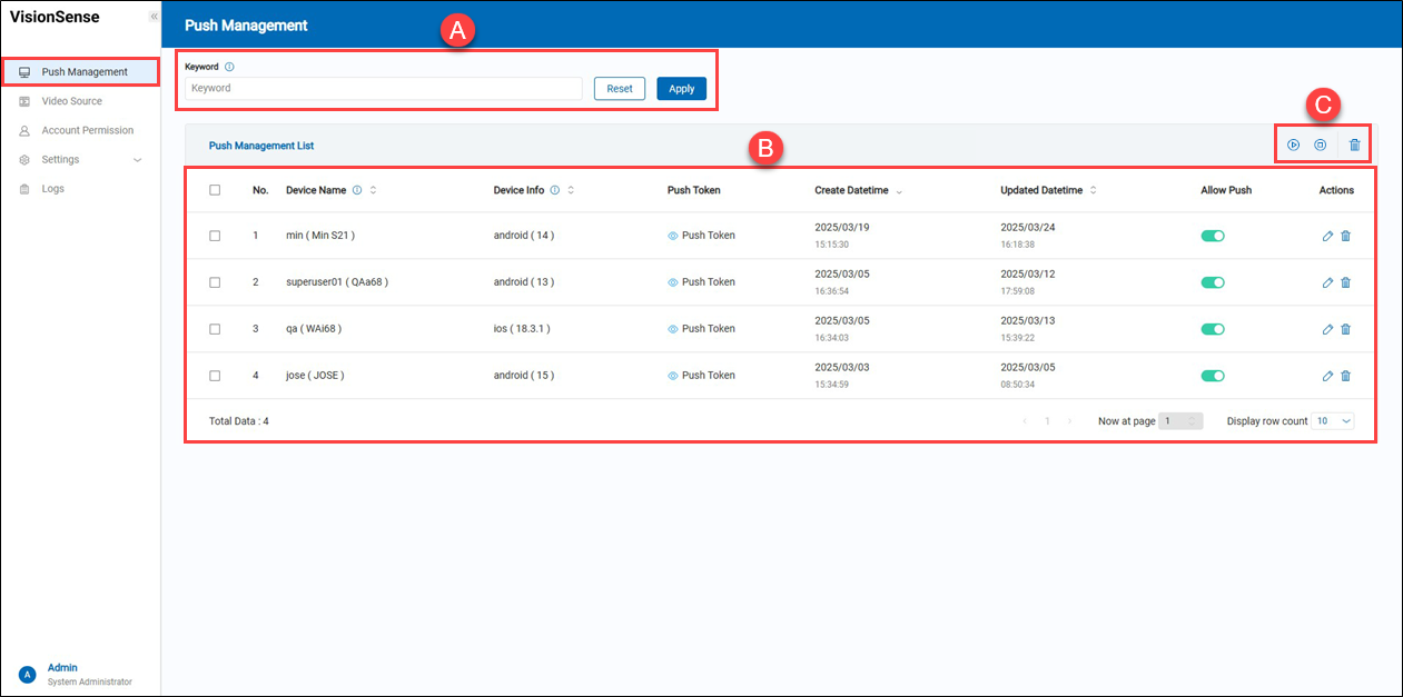

Before using the VisionSense app, go to Settings → Account Permission and create an account for use with the app. After the account is created, log in to the system using the app. Once logged in successfully, the mobile device will appear in the Push Management List. Refer to the login guide for the app
Push Management.png A.【Filtering】 ⇒ Use the filters to narrow down results by account or device name. B.【Push Management List】 ⇒ It displays all mobile devices that have been used to connect to the system using the VideoSense app.
  • Device Name: It displays the mobile app account and the mobile device's name.
  • Device Info: It displays the mobile device's OS version.
  • Push Token: It displays the push token information that is used to connect to the system for receiving push notifications.
  • Create Datetime: It displays the first time the VisionSense mobile app logged in to VisionSense Edge.
  • Updated Datetime: It displays the last time the VisionSense mobile app logged in to VisionSense Edge.
  • Allow Push: A toggle switch enables the feature when turned on and disables it when turned off.
  • Action: The user can click the icon_編輯.jpg 'Edit' to rename the device or the icon_刪除.jpg 'Delete' to remove it.
C.【Operation】 ⇒ Users can click the Icon_Enable.png ‘Enable’ to enable multiple selected devices, the Icon_Disable.png ‘Disable’ to disable them, or the icon_刪除.jpg ‘Delete’ to remove them all at once.
