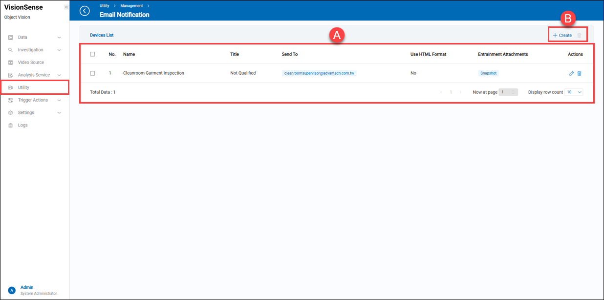

Utility_Email Notification_List.png A.【Devices List】
  • Name: Customized Email Notification Name.
  • Title: Customized notification letter title.
  • Send To: Mailboxes of people to be notified.
  • Use HTML Format: The content of the letter supports HTML format.
  • Entrainment Attachments: Real-time snapshots from the detection area will be attached.
  • Actions: Click the icon_編輯.jpg 'Edit' to enter the edit page or click the icon_刪除.jpg 'Delete' to delete the assigned data.
B.【+ Create/Delete】 ⇒ Users can click Icon_+Create_normal.png '+ Create' to add a new email notification or click icon_刪除.jpg 'Delete' to remove multiple selected email notifications at a time.

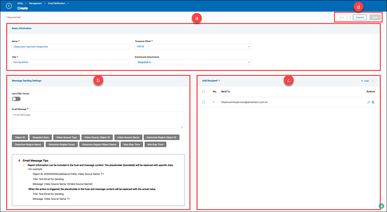

【Create a new email notification】 Utility_Email Notification_Create.png a.【Basic Information】
  • Name: The customized email notification name.
  • Title: The customized email notification title.
  • Timezone Offset: Select the time zone of the location where the recipients of the email notifications are based.
  • Entrainment Attachments: Include real-time snapshots of detection area photos.
b.【Message Sending Settings】
  • Use HTML Format: A toggle switch enables the feature when turned on and disables it when turned off. The content of the letter supports HTML format. If enabled, it will additionally support attaching a snapshot in the email message.
  • Email Message: Content of the email notification. It supports not only text but also variables for replacing specific data.
  • Placeholders: A list of predefined variables that can be used in the request body, including object ID, snapshot date, detection region name, and more.
  • Push Notify Tips: Provides guidelines on how variables will be replaced with specific data.
c.【Add Recipient】
  • Send To: Email addresses of the recipients for email notifications. (multiple recipients can be set).
  • + Add/Delete: Click Icon_+Add.png '+ Add' to add a new Email Notification or the icon_刪除.jpg 'Delete' to delete multiple selected data. Utility_Email Notification_Create_Add Send To_Ori.png
d.【Operation】 Click the 'Save' to apply all settings or the 'Cancel' to return to the previous page without saving. Also, click the Icon_Test Button.png 'Test' to send a test email to the recipient. Utility_EmailNotification_Test_Ori.png

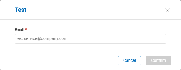

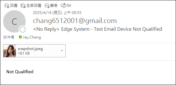

【Email Notification Example】 Utility_Email Notification_Create_Test Mail Sample.png

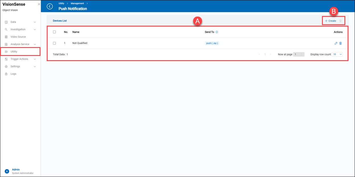

Utility_Push Notification_List.png A.【Devices List】
  • Name: Customized Push Notify name.
  • Send To: Specify the recipient of the push notification.
B.【+ Create/Delete】 ⇒ Users can click Icon_+Create_normal.png '+ Create' to add a new push notification or click icon_刪除.jpg 'Delete' to remove multiple selected push notifications at a time.

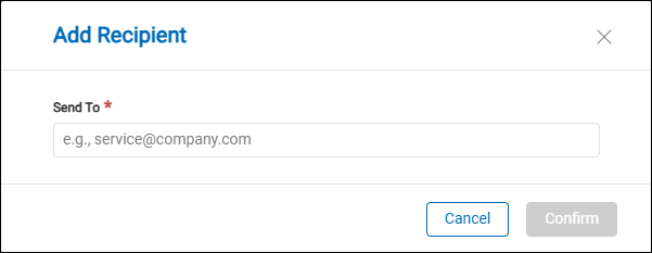

c.【Edit Recipient】
  • Target: The name of the device receiving the push notification.
  • Actions: Click the icon_刪除.jpg 'Delete' to delete the assigned data.
  • + Add/Delete: Click '+ Add' to add a new push notification device or the 'Delete' to delete selected data. Utility_Push Notify_Edit Recipient_Ori.png

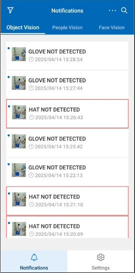

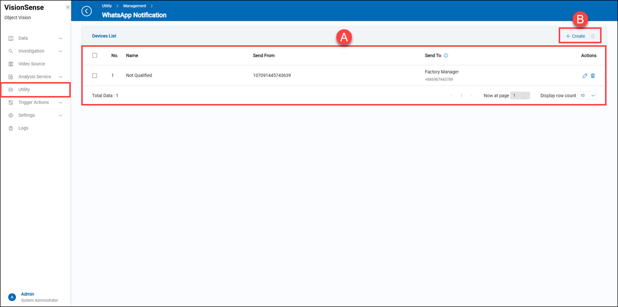

Utility_WhatsApp_List.png A.【Devices List】
  • Name: The customized WhatsApp notification name.
  • Send From: Sender's phone number.
  • Send To: The recipients of the WhatsApp notifications.
B.【+ Create/Delete】 ⇒ Users can click Icon_+Create_normal.png '+ Create' to add a new WhatsApp notification or click icon_刪除.jpg 'Delete' to remove multiple selected WhatsApp notifications at a time.

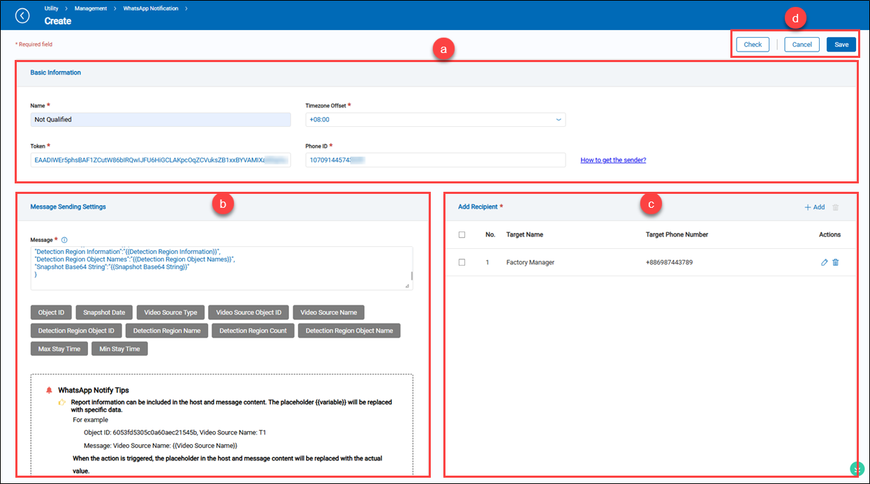

【Create a WhatsApp notification】 Utility_WhatsApp_Create.png a.【Basic Information】
  • Token: Enter a valid WhatsApp Token.
  • Timezone Offset: Select the time zone of the location where the recipients of the WhatsApp notifications are based.
  • Select the time zone of the location where the recipients of the WhatsApp notifications are based.
  • Phone ID: Enter a valid phone number associated with the token.
  • Message: Content of the WhatsApp notification. It supports not only text but also variables for replacing specific data.

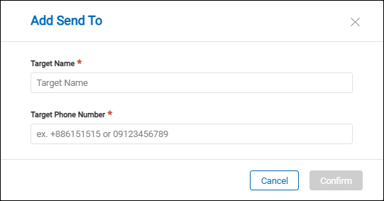

c.【Add Recipient】
  • Target Name: The recipient's name of the WhatsApp notification.
  • Target Phone Number: The recipients' cell phone number of the WhatsApp notifications.(multiple recipients can be set)
  • Action: Click the icon_編輯.jpg 'Edit' to enter the edit page or click the icon_刪除.jpg 'Delete' icon to delete the assigned data.
  • + Add/Delete: Click '+ Add' to add a new WhatsApp notification recipient or the 'Delete' to delete selected data. Utility_WahtsApp_Create_Add Send To_Ori.png
d.【Operation】 Click the 'Save' to apply all settings or the 'Cancel' to return to the previous page without saving. Also, click the Icon_Check.png 'Check' to send a test WhatsApp notification to the recipient. Utility_WahtsApp_Create_Check_Ori.png

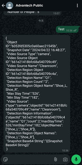

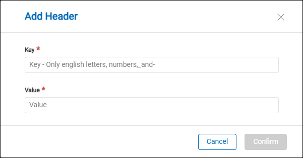

c.【Add Header】
  • Key: The name of the header field.
  • Value: The value assigned to the header field.
  • + Add/Delete: Click '+ Add' to add a new header or the icon_刪除.jpg'Delete' to delete selected data. Utility_HTTP Command_Create_Add Header_Ori.png

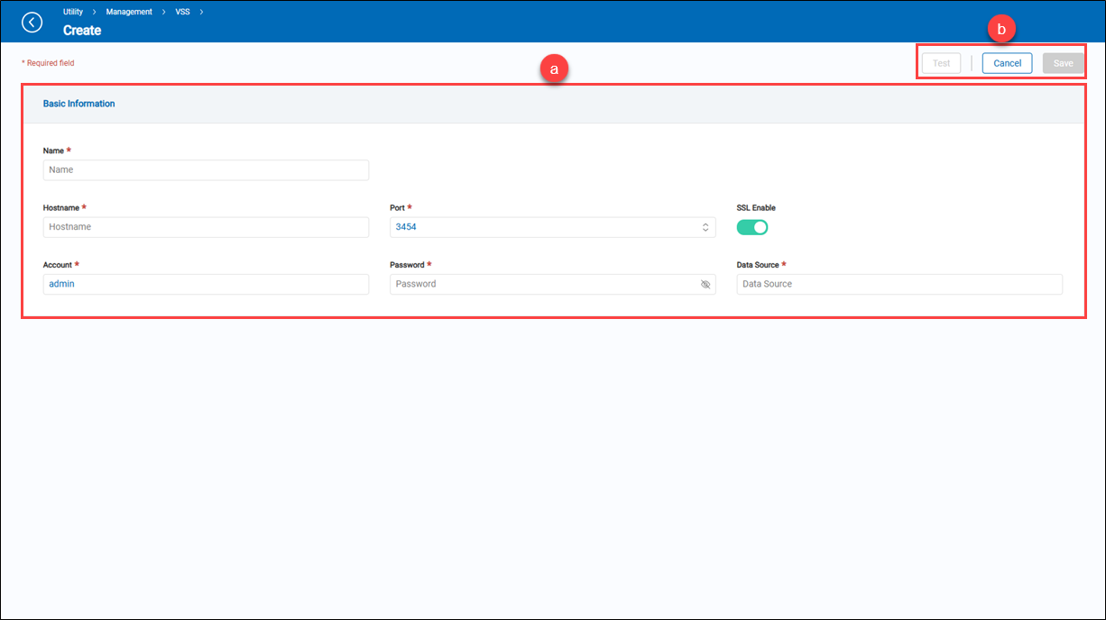

【Create a new VSS device】 Utility_VSS_Create.png a.【Basic Information】
  • Name: Enter a descriptive name for the VSS device.
  • Hostname: Set up the host location or IP address of the VSS device.
  • Port: Set up the port number to connect to this VSS device.
  • SSL Enable: Toggle the switch to enable or disable the SSL protocol.
  • Account & Password: Please enter the username and password required by the VSS.
  • Data Source: Enter the source name of the VSS device.
b.【Operation】 Click the 'Save' to apply all settings or the 'Cancel' to return to the previous page without saving. Also, click the Icon_Test Button.png 'Test' to check whether the connection settings are correct or not.
