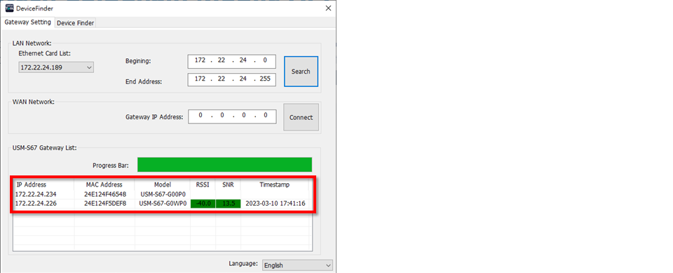

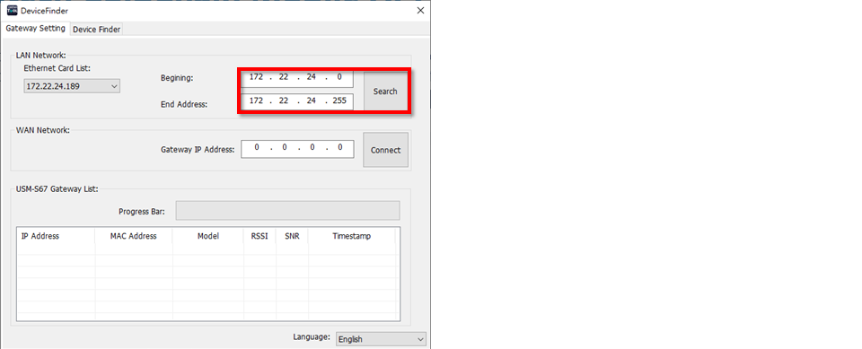

1.Open Device Finder tool, ensure the windows and gateway in same network segment, then press search button to find the gateway. 121-1.png
2.The gateway will show on the list when the gateway has be found. If not, please double confirm the pc and gateway in the same network segment, and press search button agin.

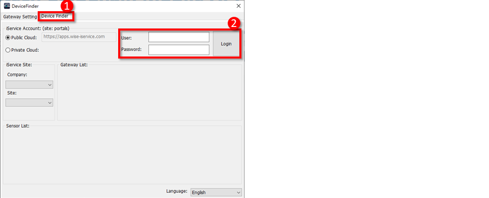

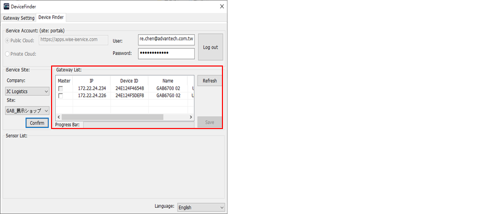

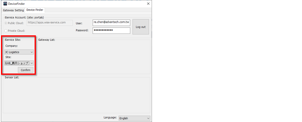

5.The tool will get data to gateway list from WISE-iService web site. 125-1.png

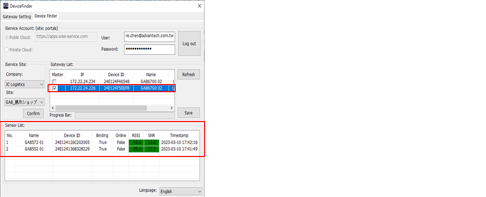

6.Select gateway you want to become the master one, the sensors will show on Sensor List. Non-register sensor will show false. 126-1.png

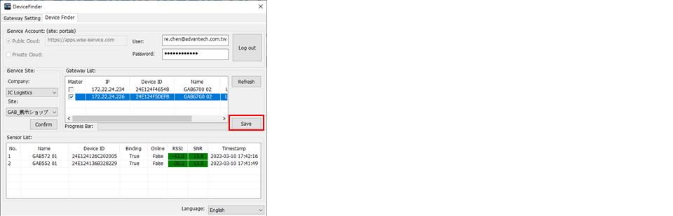

7.Press Save button, the tool will bind the sensors with gateway one by one automatically. 127-1.png

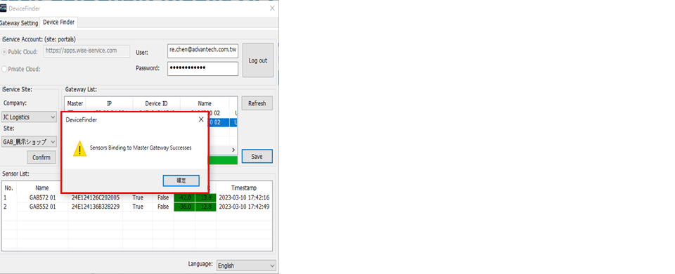

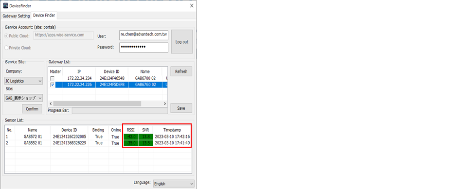

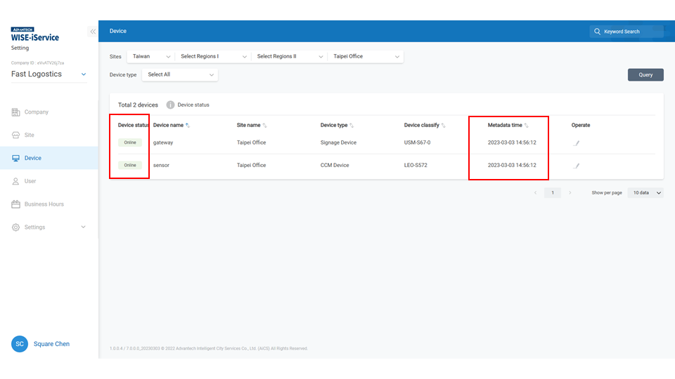

11.Go back to Device page on WISE-iService, devices status will change to online and Metadata time will keep updating. 1211.png
