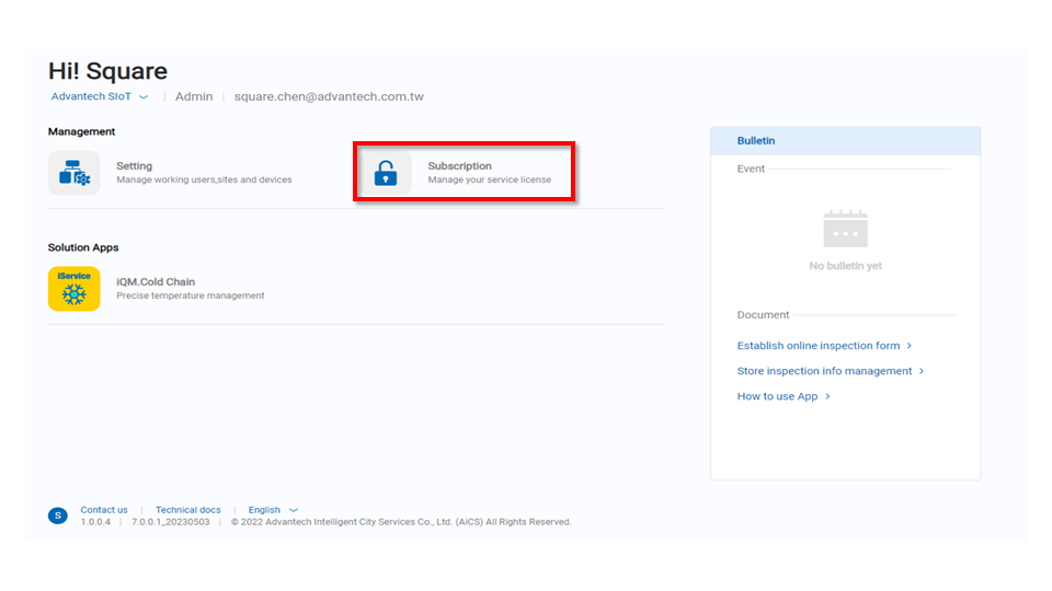

1.Press Subscription icon to subscribe service on WISE-iService web site. > If you can't see this icon, it means you don't have permission, please contact acoount admin.

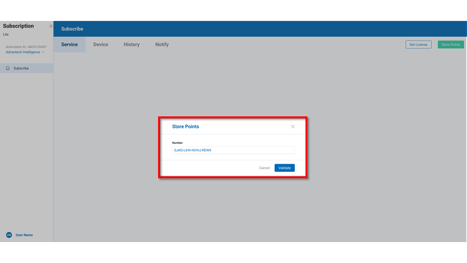

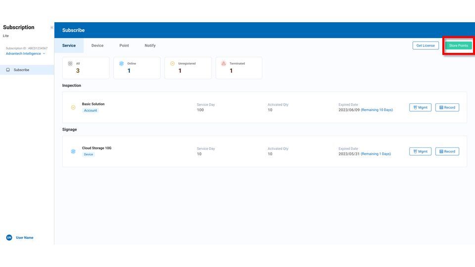

3.Input 16 digital code, then press validate button to store the point. > If you don't have the license, please contact the saleas person to purchase.

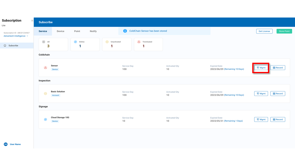

4.you will see the Coldchain filed has been created, press Management button to activate the sensors. 74.png

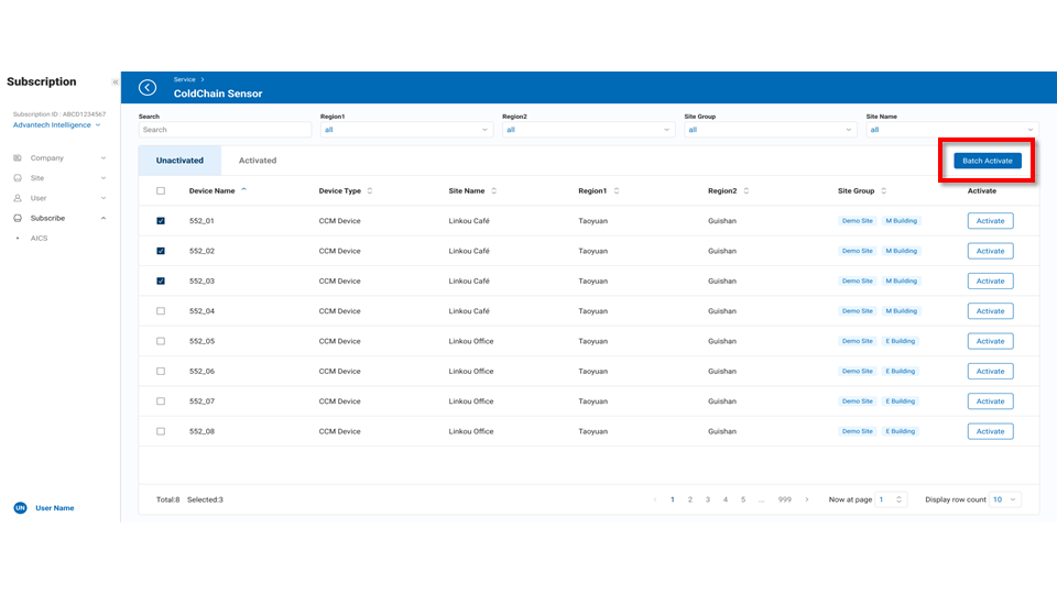

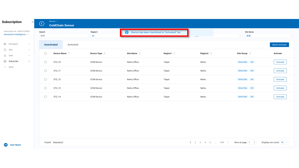

5.Select sensors you want to activate, then press batch Activate button. 75.png
