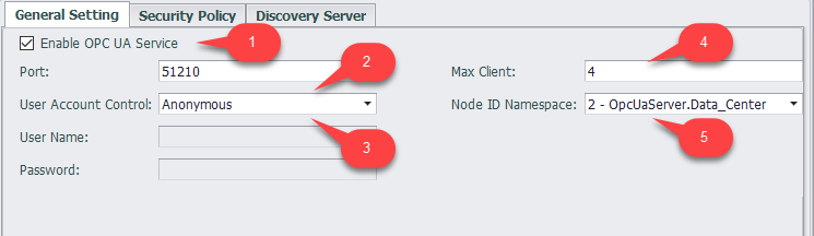

General Settings​
  1. The user can choose to enable or disable the OPC UA service. The OPC UA configuration document is not generated when the service is not enabled.
  2. Port: The port number of the OPC UA server on the device. The default is 4840.
  3. User account control: The server allows the client to access the server anonymously or to verify the username and password when accessing.
    Anonymous: The default connection mode. The server allows the client to create a connection anonymously without the need to configure a username and password.
    User Name/Password: The client needs to configure the username and password when creating the connection. The username must be entered and the password can be empty.
  4. Max Client:A maximum of several clients are allowed to connect to the server at the same time.
  5. Node ID Namespace:Index of the node namespace
    1. OPC UA Namespace
    2. Local Server
    3. OpcUaServer.Data_Center

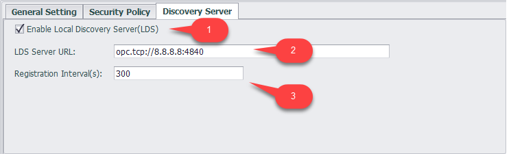

Local Discovery Server(LDS)​
The Local Discovery Server (LDS) is a DiscoveryServer that maintains a list of all OPC UA Servers and Gateways available on the host/PC that it runs on, and is the OPC UA equivalent to the OPC Classic OPCENUM interface.
  1. Enable LDS
  2. LDS Server URL:The address of the LDS server
  3. Registration Interval:The interval for registering the OPC UA server with the Local Discovery Server, in seconds.
