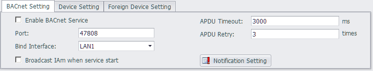

  1. Double-click "BACnet Server" under "Service" item in the left menu tree to pop up the configuration interface.
The main configuration interface of BACnet server is shown as below.​
  • BACnet Setting: To define the parameters of BACnet IP Server. Current version of BACnet server only supports TCP/IP network communication protocol by default.
    Port: It is the port number of TCP/IP communication on BACnet server. The default number is 47808 (0xBAC0).
    Bind Interface: EdgeLink has 2 LAN Port, user should configure which LAN will be bind to do broadcast.
    Broadcast IAm when service start[Checkbox]: To configure whether broadcast IAm when the device power on.
    APDU Timeout: To define the timeout value of APDU request/response, the unit is millisecond.
    APDU Retry: To define the retry times of APDU request/response.
    APDU Segment Timeout: To define the timeout of APDU Segment request/response, the unit is millisecond.

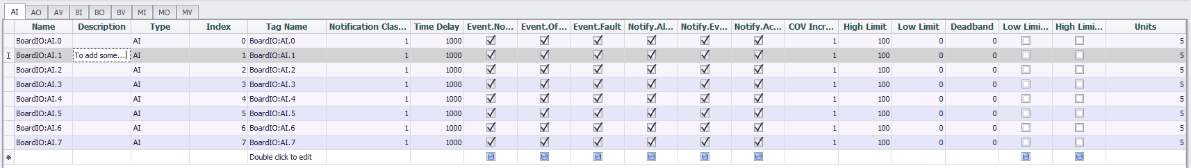

  • Add new BACnet object
    User can add new BACnet object by [Double click to edit], then will mapping an EdgeLink Tag to this BACnet Object, and the system will auto create the object instance index for you, please keep the continuity of the index, and the system will start from index 0.
  • Update BACnet obejct
    User can update and edit the existed BACnet obejct, some property should left click to edit, and some property should do double click to edit such as re-link a new EdgeLink Tag.

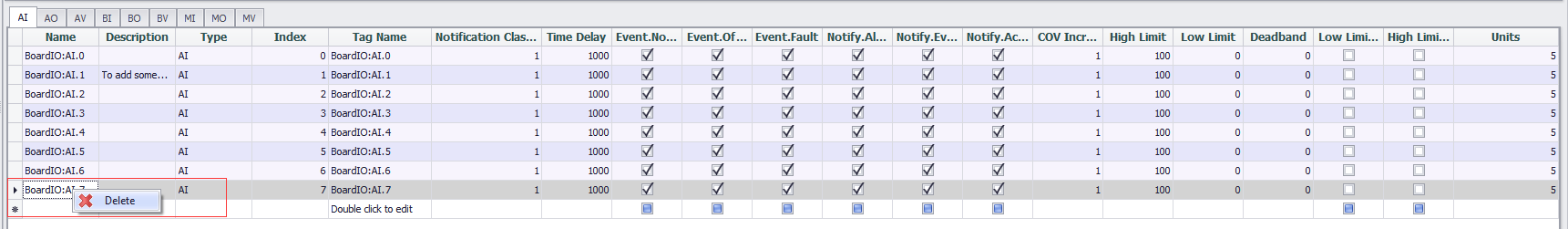

  • Delete BACnet obejct
    User can delete the existed BACnet obejct, select one or more lines and then right click to call [delete] popup menu out then to delete it.
