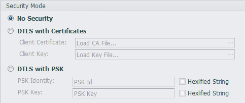

Security Mode​
  • No Security:Select this option to use an in-secure connection. In this case, the Server URI should be filled with coap:// instead of the address starting with coaps://. Conversely, if you choose the two security options below, then the Server URI should be filled with the address starting with coaps://.
  • DTLS with Certificates:Use a secure connection for a given client certificate. Load the client certificate file in the Client Certificate and load the client certificate key file in the Client Key.
  • DTLS with PSK:Use the secure connection of the given PSK method. Please fill in the PSK string in PSK Identity. If the string is a hexadecimal format string, please check the Hexlified String option. Fill the PSK Key with the PSK key and check the Hexlified String option as appropriate.
