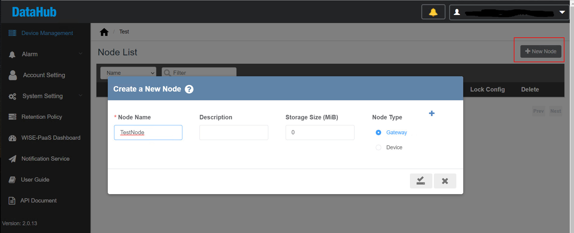

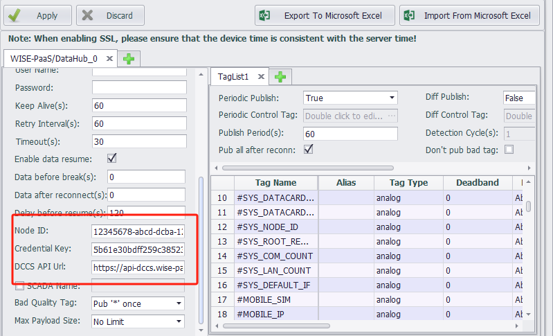

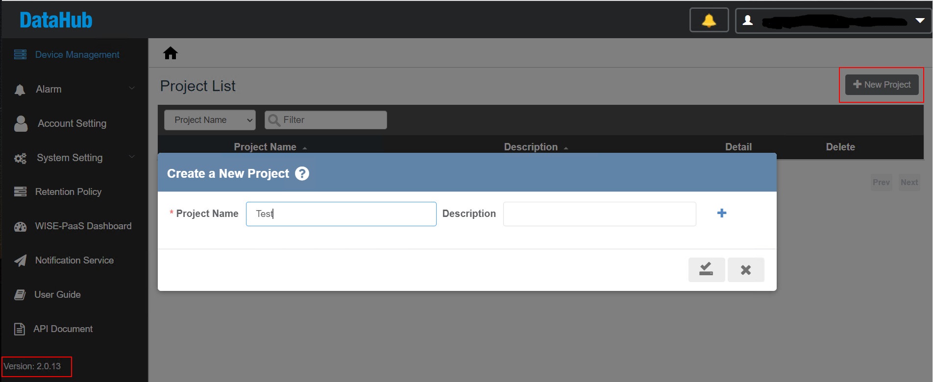

(1) Obtain WISE-PaaS/DataHub Connection Information
  • Add a Project in WISE-PaaS/DataHub;

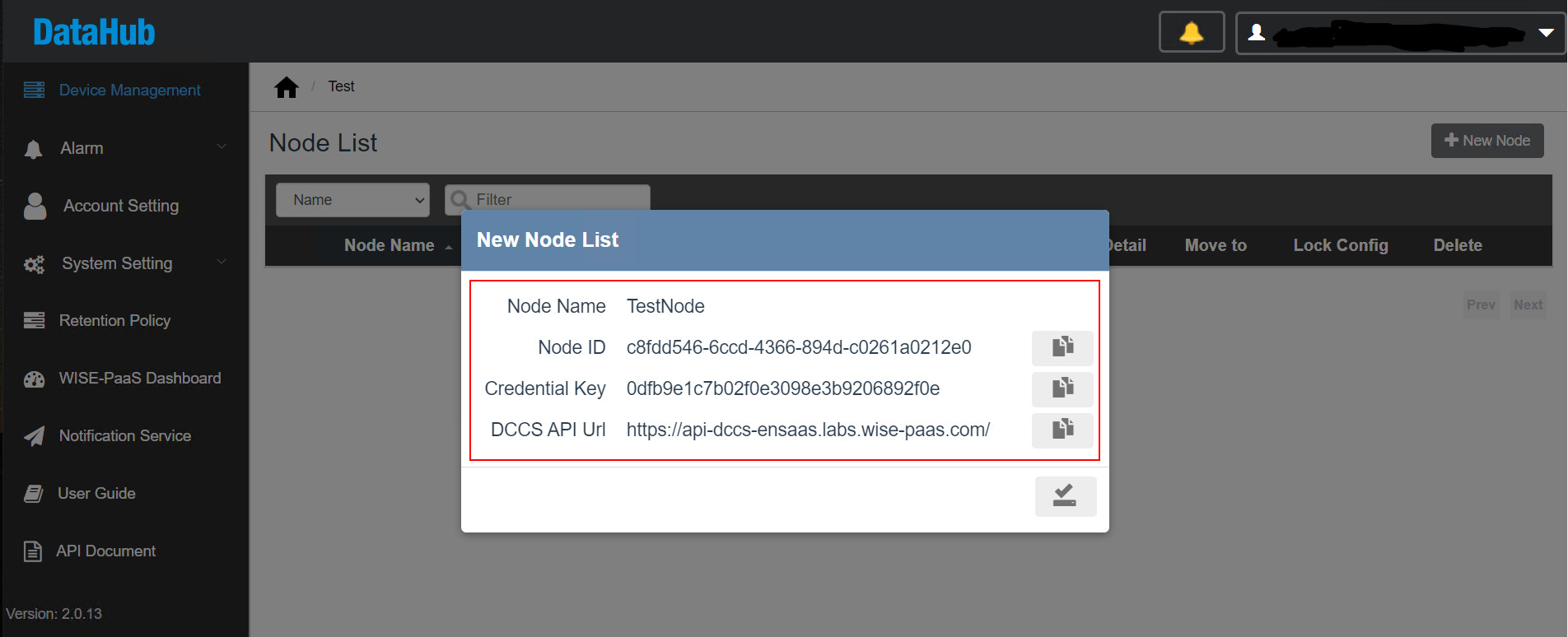

  • Add a Node to the Project, which will generate DataHub ID, Credential Key, and DCCS API Url;

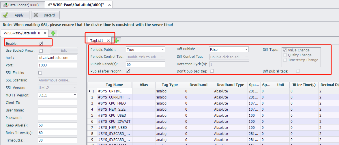

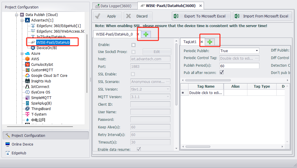

(2) Configure EdgeLink Project
  • Double-click WISE-PaaS/DataHub under Cloud Services in the EdgeLink Studio project configuration panel to configure WISE-PaaS/DataHub_0;
  • Enable the connection;
  • Set the upload interval to 5 seconds;
  • Add the tag list to be uploaded to WISE-PaaS/DataHub;
  • Enter the DataHub ID, Credential Key, and DCCS API Url generated in step 1 into the corresponding fields in the EdgeLink Project;
  • Keep other connection parameters as default.

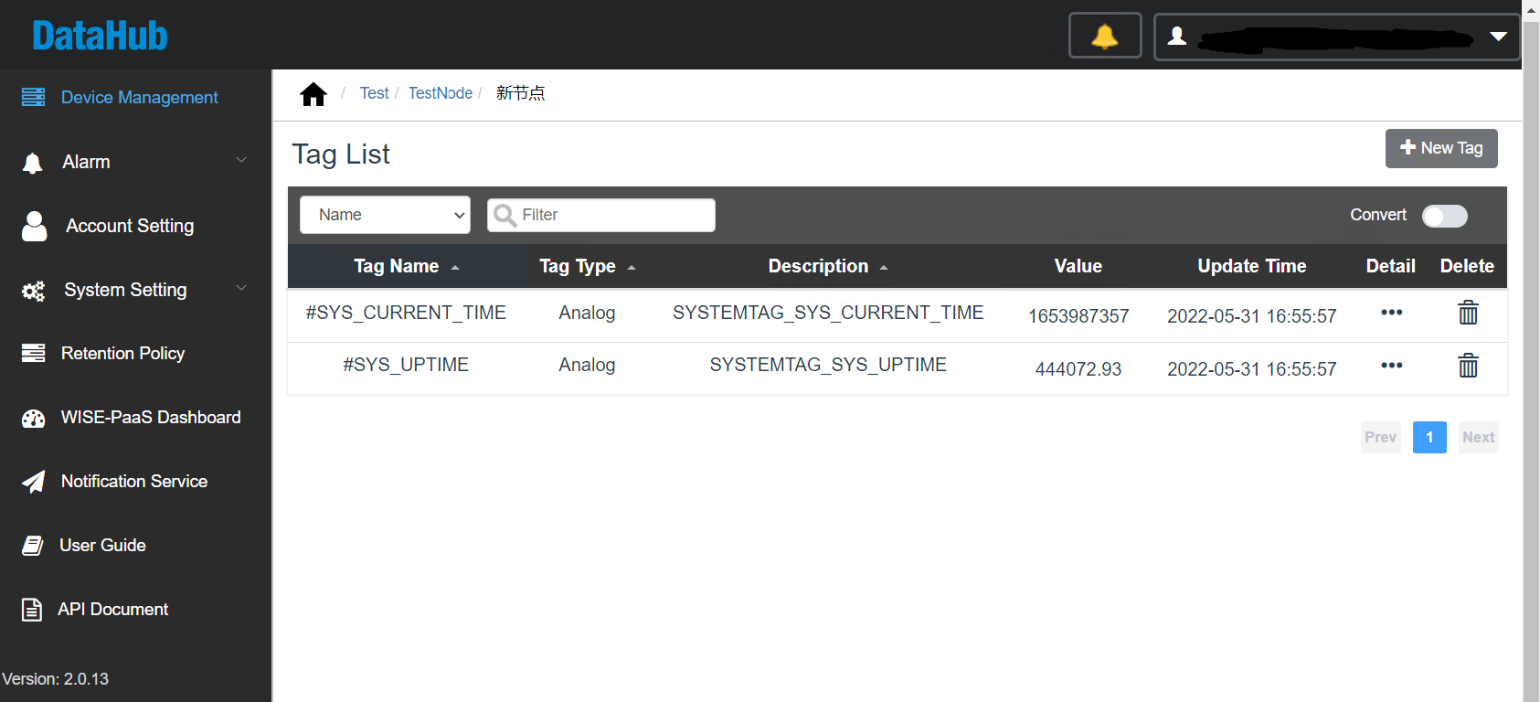

(3) Verify Successful Connection
  • Download the EdgeLink project;
  • After successful restart, real-time data will be visible in the WISE-PaaS/DataHub interface, indicating successful connection and data upload from EdgeLink to WISE-PaaS/DataHub.

ParameterDescription
Connection TypeMQTT connection (cannot be modified)
Enable This ConnectionCheck to activate the current connection; the current page configuration will take effect
Enable SOCKS5 ProxyEnable if EdgeLink requires a proxy server to connect to the MQTT Broker. After enabling, configure the SOCKS5 server information.
HostEnter the MQTT Broker IP or domain name. This parameter is mutually exclusive with DCCS; DCCS takes priority.
PortEnter the MQTT Broker listening port (default: 1883). EdgeLink currently does not support WebSocket connections.
Enable SSLEnable SSL
SSL Verification MethodSelect from three verification methods based on the Broker's configuration.
MQTT VersionSpecify the MQTT protocol version (default: 3.1.1). Adjust if the Broker has specific requirements.
Client IdentifierUsed by the Broker to distinguish clients. Leave blank for automatic assignment or manually enter a unique identifier.
UsernameConnection username
PasswordConnection password
Keep AliveTime interval (in seconds) for sending MQTT PING packets to maintain the connection. Configure based on project needs and Broker settings.
Reconnect IntervalTime interval (in seconds) for reconnection attempts if the connection fails or is interrupted.
TimeoutMaximum response time (in seconds) for client-to-cloud communication. The connection will terminate if no response is received within this time.
Periodic UploadOptions: Enable, Disable, or Control via Tag.
Periodic Upload Control TagSelect the control tag. Data upload occurs when the tag value is non-zero.
Upload IntervalPeriodic upload interval (in seconds).
Change-Based UploadOptions: Enable, Disable, or Control via Tag.
Change-Based Upload Control TagSelect the control tag. Data upload occurs when the tag value is non-zero.
Detection IntervalTag change detection interval.
Change DetectionSelect which tag parameters trigger uploads (value, quality, timestamp). Tag value changes are affected by threshold type, width, and jitter time configured in the tag list. See Tag List Configuration.

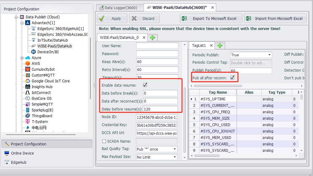

Publish All Tags After ReconnectWhether to upload all current tag values to the cloud upon reconnection. Enabled by default.
Enable Resume from BreakpointEnable/disable breakpoint resumption.
Pre-Breakpoint DataDefault: 0. Resume data from n seconds before disconnection.
Post-Reconnect DataDefault: 0. Resume data until n seconds after reconnection.
Resume DelayDefault: 120. Delay (in seconds) before resuming data upload after reconnection.
Topic/Payload TypeWISE-PaaS/DataHub.
Node IDRequired. Generated when creating a Node in WISE-PaaS/DataHub.
Credential KeyRequired. Generated when creating a Node in WISE-PaaS/DataHub.
DCCS API UrlRequired. Generated when creating a Node in WISE-PaaS/DataHub.
SCADA NameOptional. Used as the device name in WISE-PaaS/DataHub if no sub-devices are configured. If left blank, the gateway node name from the project will be used.
Bad Quality TagUpload behavior for tags with non-zero (non-GOOD) quality: Pub * once, Pub * always, Still pub value, or Don't pub.

4.1 Resume from Breakpoint​

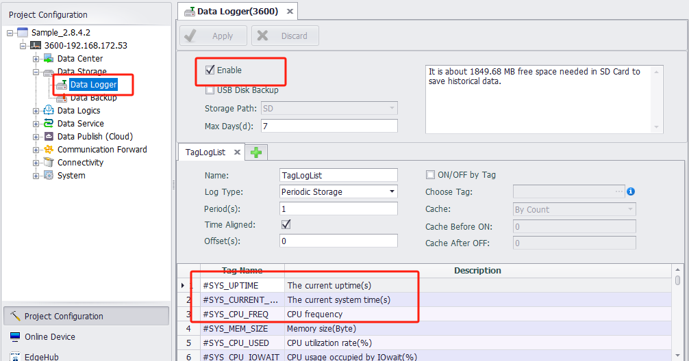

  • Prerequisite: Configure tags for breakpoint resumption in DataLogger for local storage. The device must have a storage card. Refer to the DataLogger documentation for setup.
  • Enable breakpoint resumption in WISE-PaaS/DataHub. The configuration below ensures that all current tag values are published immediately upon reconnection, and data upload resumes 120 seconds later, covering only the disconnection period.
  • After downloading the project configuration, data resumption will occur if EdgeLink disconnects from WISE-PaaS/DataHub during operation.

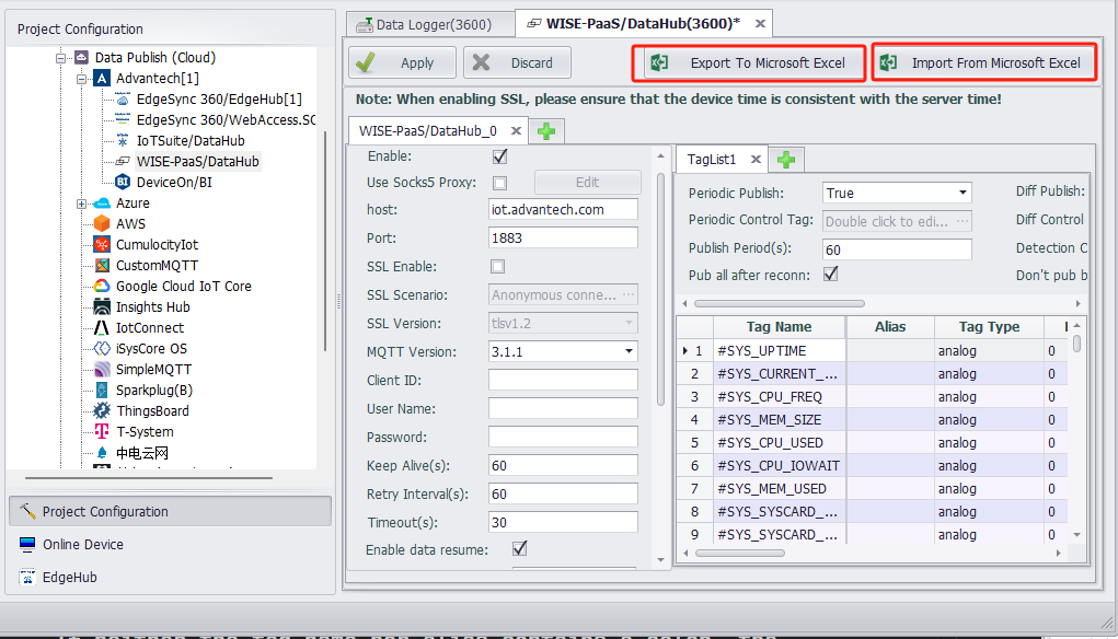

4.4 Tag List Import/Export​
  • EdgeLink Studio's cloud service configuration supports tag list import/export.
  • Excel format:
