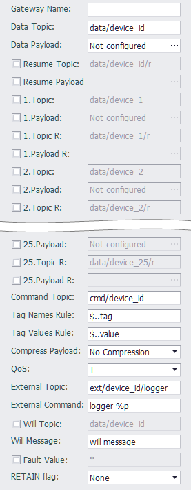

Parameter Settings​
!CustomMQTT_1
  • Gateway Name:
    Optional. Used in data publishing templates with sub-device models. If the point name cannot be resolved to a sub-device name, this value will be used as the sub-device name. If not specified and needed, _DEFAULT_DEV_NAME_ will be used.
  • Data Topic:
    Required. Specifies the topic for publishing real-time data. It's recommended to include a unique device identifier in the topic to aid parsing on the cloud server.
  • Data Payload:
    Required. Specifies the payload format for publishing real-time data.
    Payload Configuration Guide
  • Resume Topic:
    Optional. Specifies the topic for publishing resume (breakpoint continuation) data. If not set, Data Topic will be used.
  • Resume Payload:
    Optional. Specifies the payload format for resume data. If not set, Data Payload will be used.
  • [N].Topic
    [N].Payload
    [N].Topic R
    [N].Payload R:
    Optional. N ranges from 1 to 25, indicating 25 configurable topic-payload groups:
    • [N].Topic: Real-time data topic
    • [N].Payload: Real-time data payload format
    • [N].Topic R: Resume data topic
    • [N].Payload R: Resume data payload format
  • Command Topic:
    Optional. Topic for receiving commands. The cloud server can send messages to this topic to modify tag point values on the device. Supported message format example:
    "w":[
    "tag":"AO_1",
    "value":12.88
    "tag":"AO_2",
    "value":18.76
    "ts":"2017-12-28T12:22:21+0000"
    If this format is not usable, Write Names Rule and Write Values Rule using JSONPath can be configured.
    For assistance, use https://jsonpath.com.
  • Write Names Rule
    JSONPath rule to extract tag names. Default is $..tag. Should return an array of strings. To combine sub-device and tag names: e.g. $..device;$..name.
    "device": "PLC1",
    "data": [{
    "name": "Status",
    "value": 1
    "name": "Flags",
    "value": 88
    "name": "PV",
    "value": 123
    "device": "PLC2",
    "data": [{
    "name": "Status",
    "value": 0
    "name": "PV",
    "value": 456
    For keys as device names, use ~ in JSONPath: e.g. $[*].*~;$..name
    "PLC1": [{
    "name": "Status",
    "value": 1
    "name": "Flags",
    "value": 88
    "name": "PV",
    "value": 123
    "PLC2": [{
    "name": "Status",
    "value": 0
    "name": "PV",
    "value": 456
  • Write Values Rule
    JSONPath rule for extracting values. Default is $..value. Must produce a flat array of primitive types and match length with tag names.
  • Compress Payload:
    Enables GZIP compression for payloads. Ensure cloud server also supports GZIP for both sent and received messages.
  • QoS:
    Controls QoS level (default: 1).
    • QoS 0: At most once. No response or retries.
    • QoS 1: At least once. Ensures delivery.
    • QoS 2: Exactly once. Most reliable but most overhead.
  • External Topic:
    Topic subscribed to receive external commands.
  • External Command:
    Command to execute when a message is received on External Topic. E.g., logger %p logs payload.
    Wildcards:
    • %t: topic
    • %p: payload string
    • %pf: payload saved to file
    Avoid unsafe characters and commands needing root.
  • Will Topic:
    Optional. Topic for last will message.
  • Will Message:
    Optional. Content of last will message.
  • Fault Value:
    Value to upload when tag quality is bad (default: *).
  • RETAIN Flag:
    Publish RETAIN flag options:
    • None
    • For periodic pub
    • For diff pub
    • For periodic & diff pub
From version 2.8.4.1, multiple TagLists are supported with individual upload settings.
  • Upload all points after reconnect
  • Skip bad quality points
  • Upload all points on change
