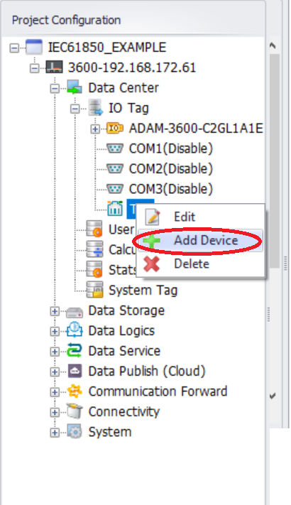

1. Add Device
DataCenter —> IO Tag —> TCP —> Rigth click: Add Device
IEC-61850 MMS Device attribute configuration

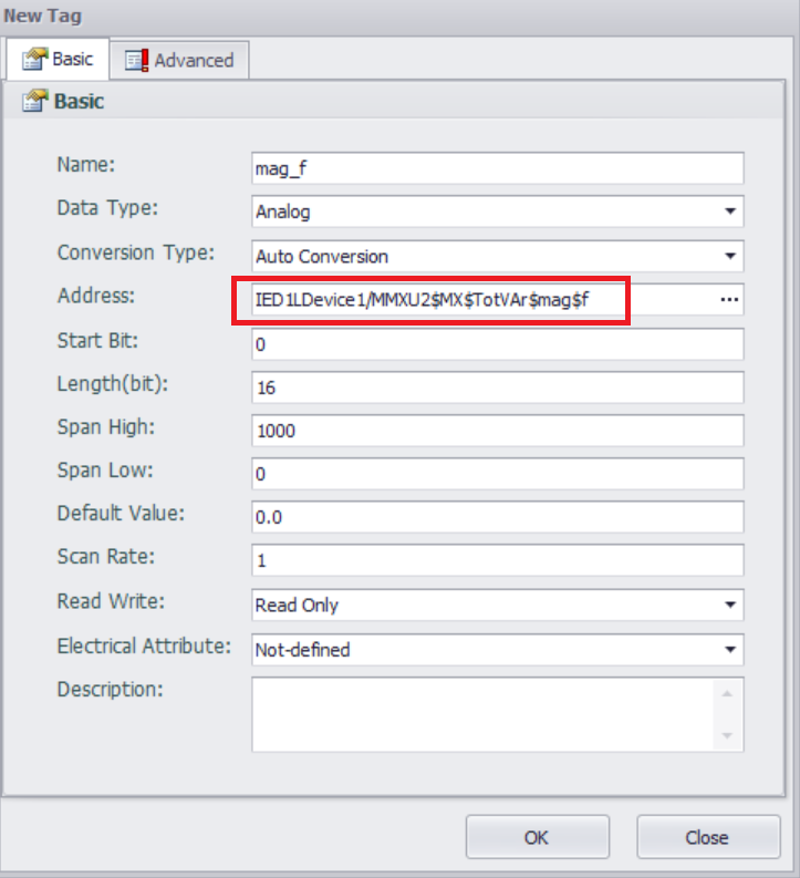

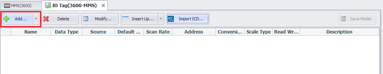

Enter the IO Tag configuration page and click the "Add..." button
On the Tag configuration page, enter the MMS DA address
Example:
IED1LDevice1/MMXU2$MX$TotW$mag$f

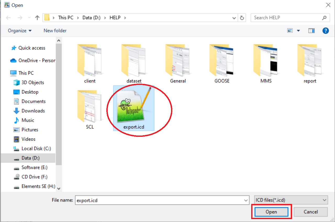

2.2 Import ICD File:
Import the ICD file, and the MMS address for DataAttribute will be automatically added
Enter the IO Tag configuration page and click "Import ICD..." button
Select the ICD file to import and click the "Open" button

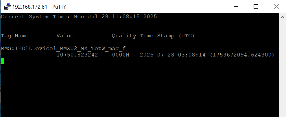

Select the DO or DA that needs to be collected
Click the "OK" button
Download the project and view the collected values

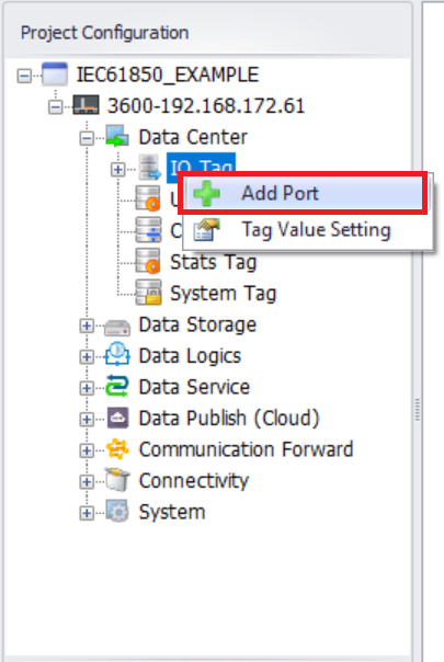

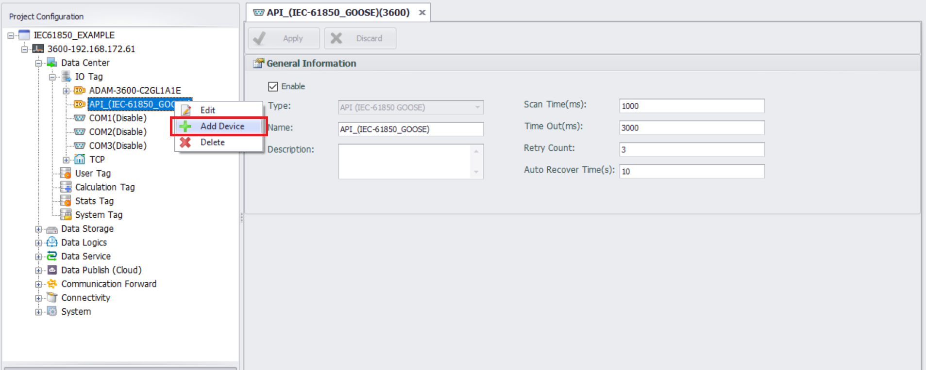

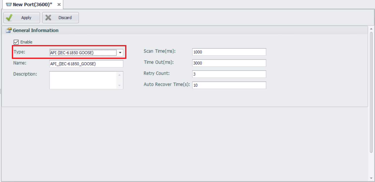

1. Add Port
1.1 GOOSE Data Acquisition requires adding API (IEC-61850 GOOSE) port
DataCenter —> IO Tag: Rigth click: Add Port
Select port Type: API (IEC-61850 GOOSE)

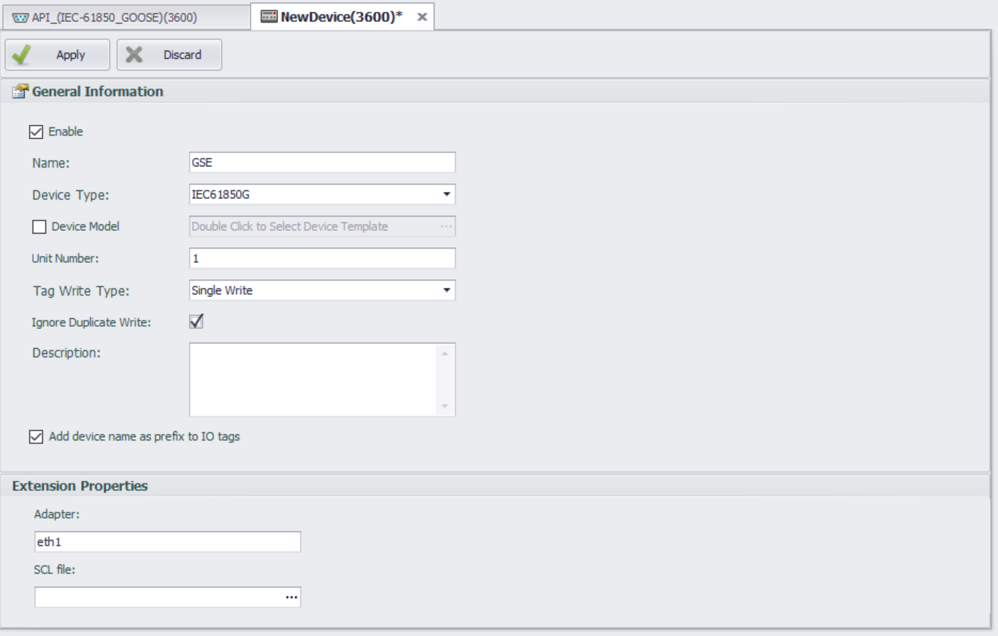

2. Add Device
2.1 Add Device
DataCenter —> IO Tag —> API_(IEC-61850_GOOSE): Rigth click: Add Device

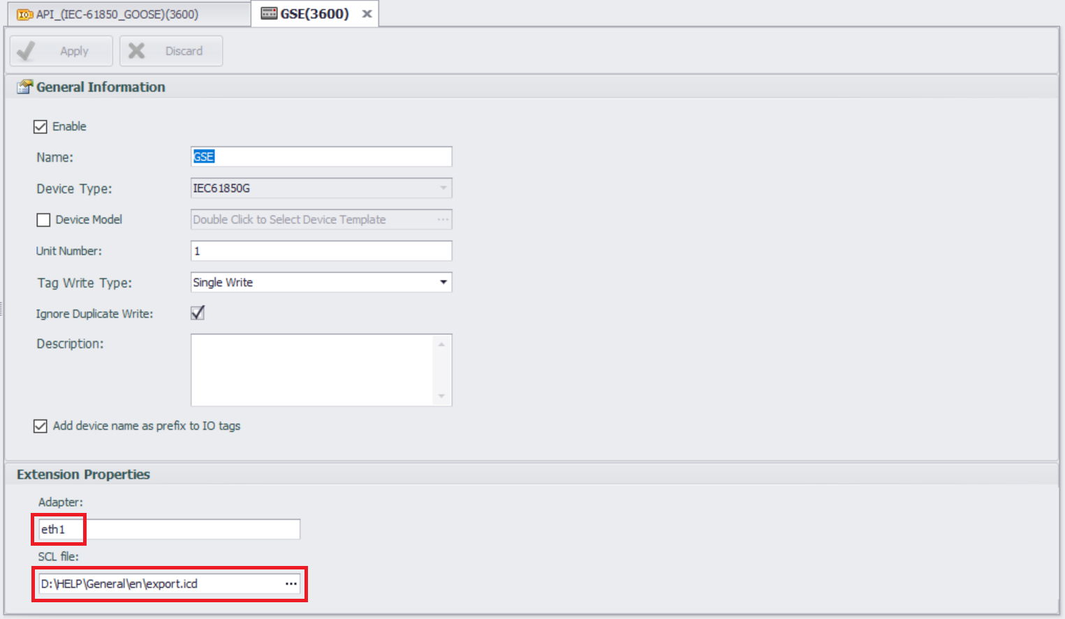

IEC-61850 GOOSE Device attribute configuration
ParametersDescriptions
Device TypeIEC61850G
AdapterPhysical network card used for GOOSE communication
SCL fileSelect the SCL file required for GOOSE communication
Configure Adapter and select an existing SCL file

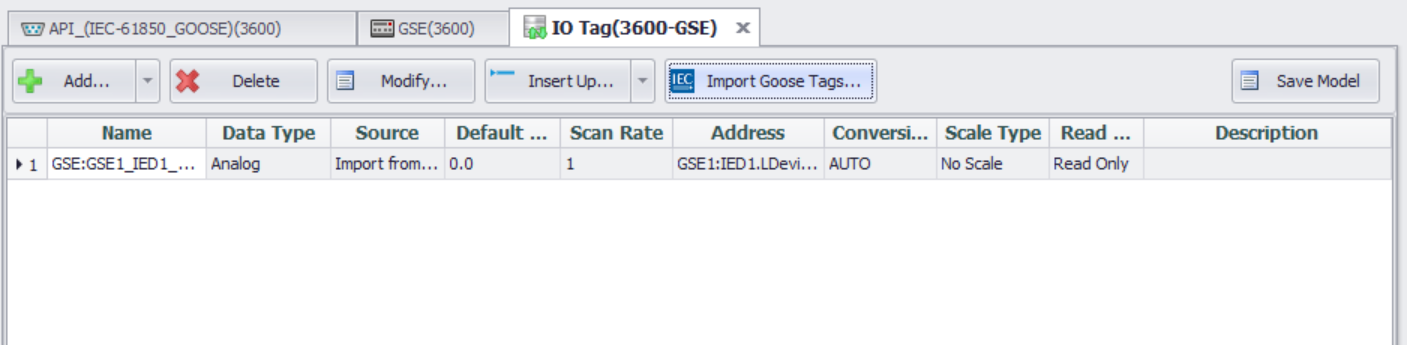

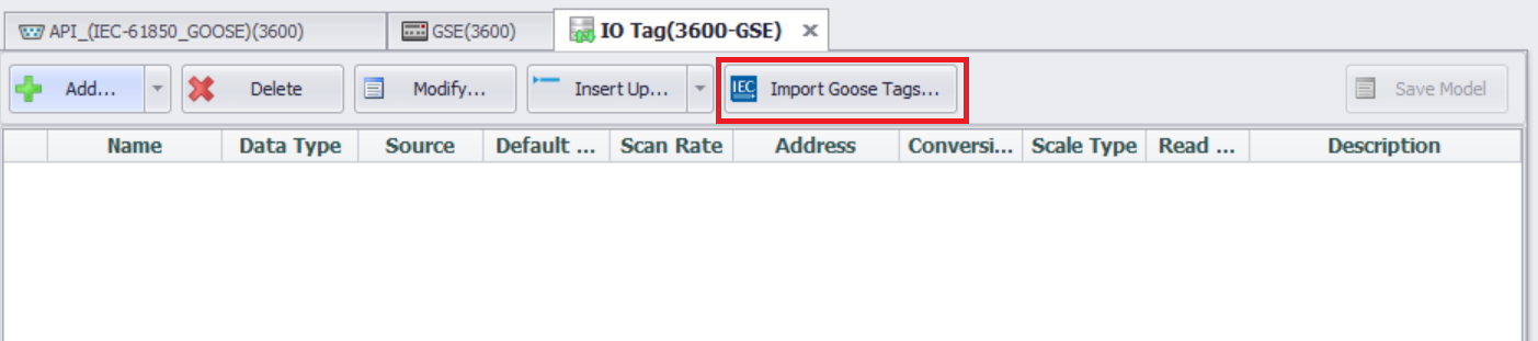

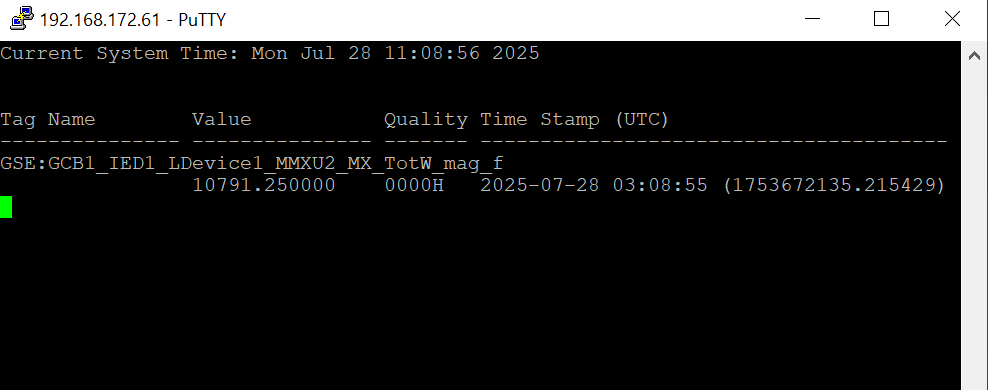

3.1 Import ICD File GOOSE configuration:
Enter the IO Tag configuration page and click "Import GOOSE Tags..." button

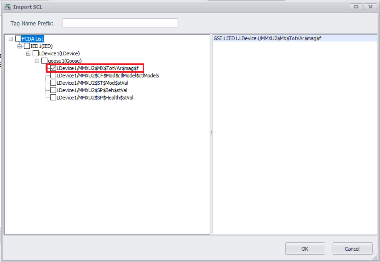

Enter the DO or DA selection page
