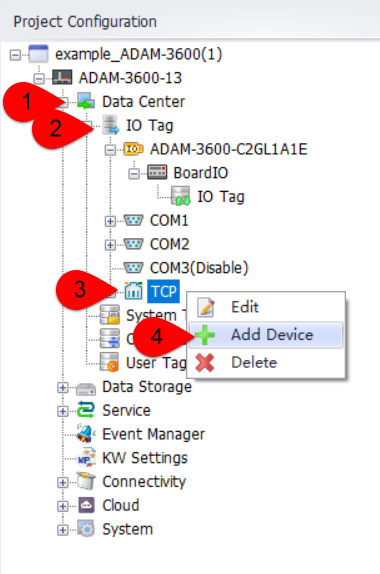

2.Add Meter
- DataCenter--->I/O点--->TCP--->Right Click:Add Device

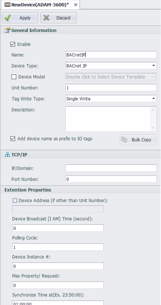

- Name: Fill in as you please。
- Device Type: Select BACnet IP。
- IP/Domain Name: The IP address of the BACnet server。
- Port Number: The port number of the BACnet server。
- Device Broadcast[I AM] Time (second):Frequency of EdgeLink sending "I AM" messages。
- Polling Cycle:Data Collection Period
- Device Instance #:Device Instance ID of the BACnet server。
- Max Property/Request: 0 means polling 70 points in one round, and other values mean the number of points configured for one round of polling。
- Synchronize Time at (Ex. 23:50:00) :Sync time with server at a certain time 。
- After configuring the above parameters, click "Apply" to add it. Click "Cancel" to cancel the operation。

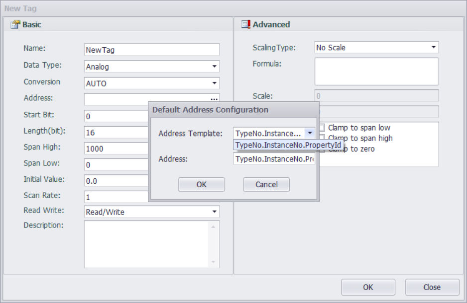

3.Add tag
1).Fill in or select the parameters on the above interface according to the requirements, and click "OK" to save the changes。
2).Tag point address format:TypeNo.InstanceNo.PropertyId
TypeNo:Representing the type number。The driver protocol supports six types: Analog Input, Analog Output, Analog Value, Binary Input, Binary Output, and Binary Value:
Type TypeNum Analog Input 0 Analog Output 1 Analog Value 2 Binary Input 3 Binary Output 4 Binary Value 5 -
InstanceNo:Tag point sequence number in the server。
PropertyId:Please refer to the Bacnet protocol。
example:The Property ID for "Present Value" in BACNet is 85 。 The address example for reading "Present Value" is as follows:
Type and index Address AI_2 0.2.85 AO_2 1.2.85 AV_2 2.2.85 BI_2 3.2.85 BO_2 4.2.85 BV_2 5.2.85
