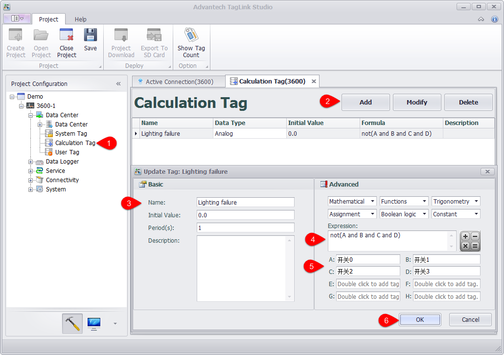

Add Calculation Tag​
Please follow the procedures to add a calculation tag:
  1. Double-click on "Calculation Tag" in the left tree menu.
  2. Click "Add" button to add a new calculation tag.
  3. Fill in the basic information. "Periods (s)" specifies how often the tags are calculated, and its unit is second.
  4. Enter an expression. Uses can select default function or operator from the pull-down lists or type them manually. The example figure shows the calculation expression of "Lighting Failure", the expression logic of which is that the lighting is failed when the value of any tag in four switches is 0.
  5. Double-click the variable box to add a tag.
  6. Click "OK" button to save the changes.

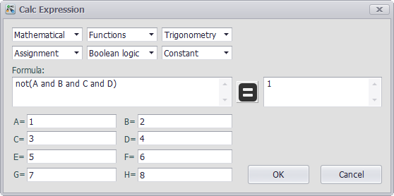

Expression Check​
On the right of "Expression" box there is a calculator button. Click it to open "Calc Expression" window shown as below. This interface is roughly the same as "Advanced" setting interface in the above, but with a "=" button and a box displaying the operation result. Besides, the variable boxes here require users to input the variable values rather than tag names.
To verify the expression is correct or not, users can click this buttonto get the result, then review it to see its correctness. After the expression has been verified, click "OK" button to update the value; if users do not want to update it, click "Cancel" button.

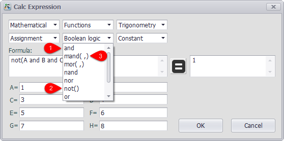

Function and Operator Description​
Through the drop-down boxes, users can set the functions and operators calculation tag supports, which is divided into five categories: "Mathematical", "Functions", "Trigonometry", "Assignment" and "Boolean logic". Moreover, "Constant" box is also provided, allowing users to select from three constants: pi (the ratio of the circumference to the diameter of a circle), epsilon (the smallest positive double value that is greater than zero) and inf (infinity).
As shown in the figure below, the functions or operators listed in the box can be classified into three types: 1. With no brackets, this indicates binary operations (labeled with 1); 2. With brackets but no comma, this means this function only has one parameter (labeled with 2); 3. With brackets and comma, this means the function supports more than one parameter (labeled with 3).
