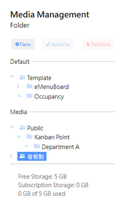

  • Media Folder:The management mechanism for media varies slightly between public and private clouds. The following provides a detailed explanation:
    • Public Cloud Media Management Folder,Here are the relevant operations and considerations:
      • First-level Media Folder: Established based on location information configured in the iService station system. The respective media directories will be displayed in interactive displays when the player is registered on the public cloud of the iService station. To change the location name, modifications can be made in the location settings of the iService station, ensuring that the media directories are synchronized accordingly.
      • Company shared folder: This is a company-level shared folder named after the company's name set in the iService station, followed by "Public". Within this folder, users can share media files, enabling convenient access and collaboration in utilizing media resources. Through this shared folder, users can jointly manage and utilize media content, promoting cooperation and resource sharing.
      • Site folder: The location folder is automatically generated once the player is registered at a specific location. Administrators can authorize whether users can view these location folders. Through the location folder, users can upload, manage, and play relevant media content specific to a particular location. If adjustments to folder authorization are required, refer to the explanation of media folder permissions below.
  • Creating sub-folders: Users can create subdirectories within the media folder to better organize and manage media content. This allows users to categorize and store media files according to their needs and structures.
  • Renaming sub-folders: Users have the ability to change the name of media folder, enabling adjustments and updates to folder names based on their requirements.
  • Deleting sub-folders: When a specific folder is no longer needed, users can delete it. Please note that deleting a folder will also remove all media content and subdirectories within it. Therefore, exercise caution when using this function.
  • Media folder permissions: User authorization to view specific locations can be granted based on the user management settings in the iService station. Such permission settings will be synchronized to the media folder in the interactive displays, ensuring that only authorized users can access the corresponding locations and media content, thus enhancing data security and management efficiency.
  • Public Cloud Capacity: Each company account offers a basic storage capacity of 5GB for users to store programs/media files.
>Note: If you find that your storage space is insufficient for storing media files, you have the option to purchase additional cloud storage to expand your storage capacity. This will allow users to store and manage more media files according to their needs. Media Management Folder.png
