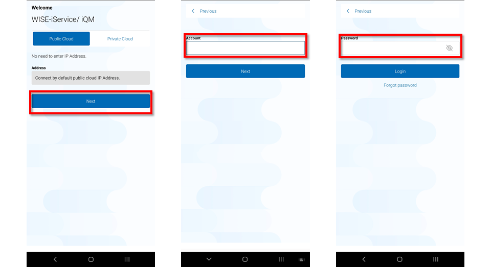

  1. Open ColdChain App in the phone.
  2. Select Public Cloud or Private Cloud, then press Next button.

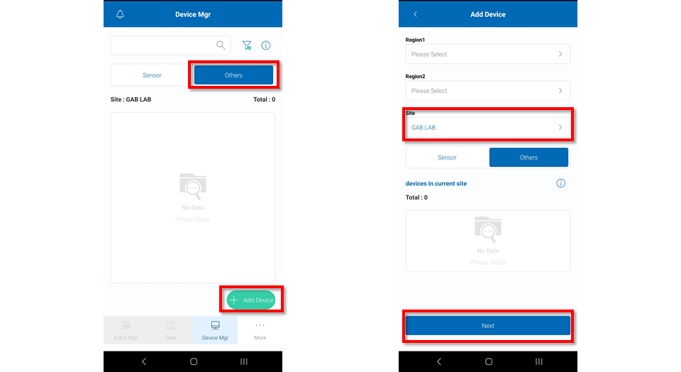

  4. Select Others icon, then press Add Device button

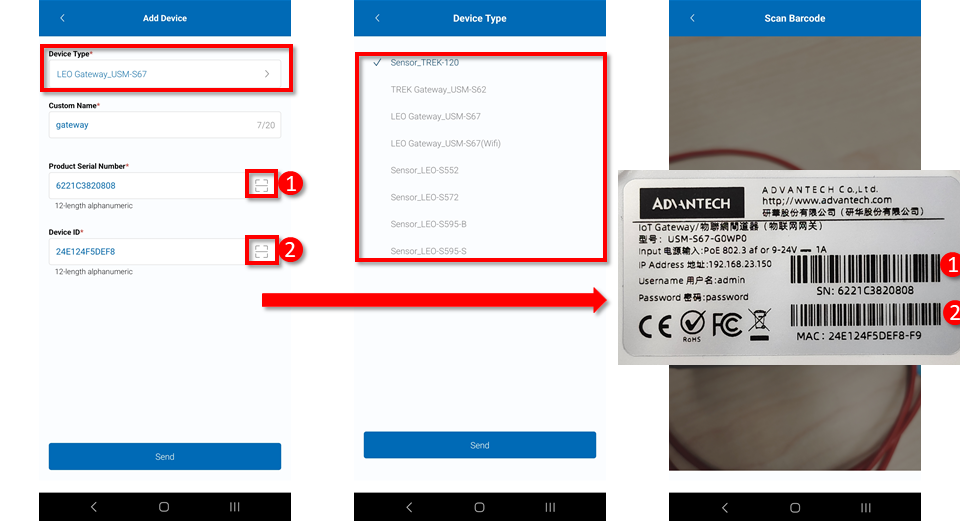

  6. Click Device Type, then choose device to register.
  7. Press scan icon, then scan the QR-Code, add the number to filed.

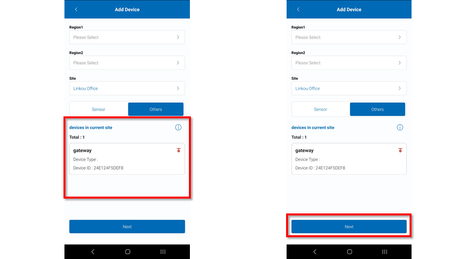

  9. The gateway has been added.
