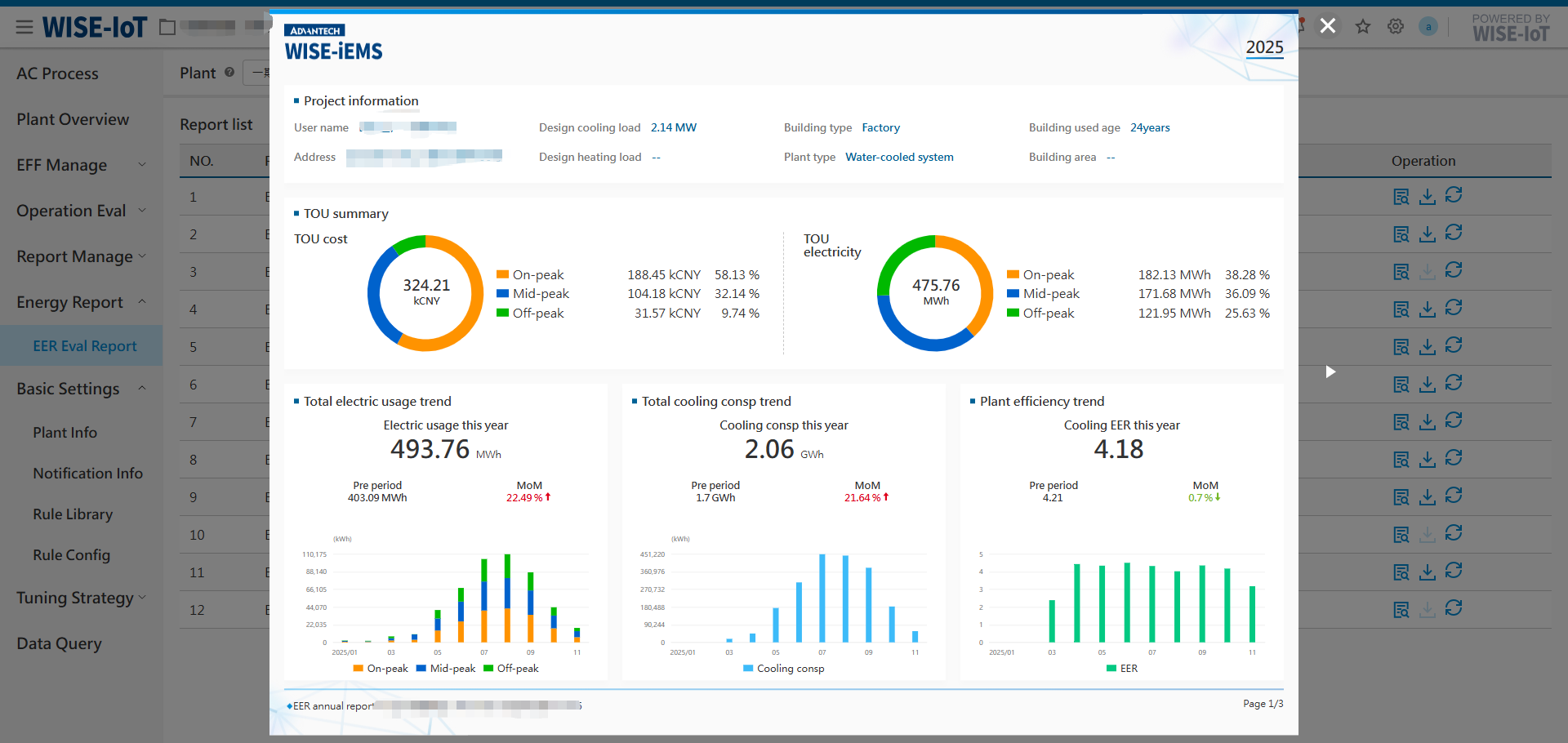

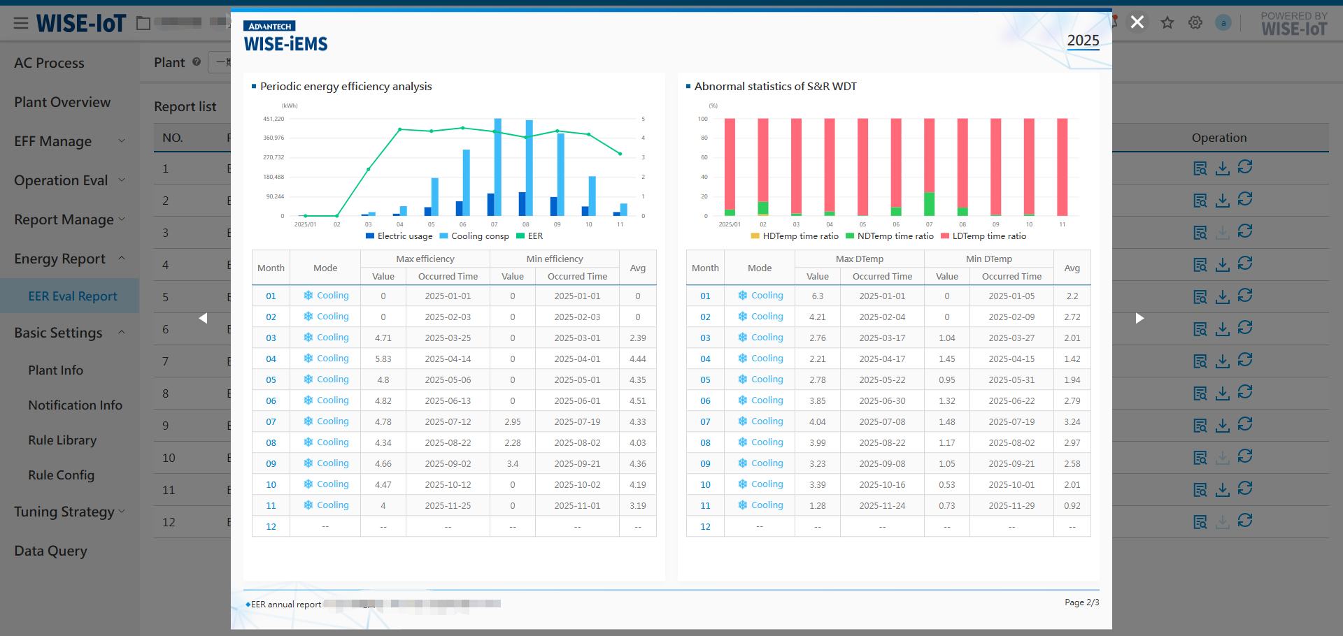

Annual Report Content (3 Pages)​
  • P1 - Annual Efficiency Overview
  • P2 - Efficiency Analysis & Supply-Return Water Temperature Deviation Statistics
  • P3 - Efficiency & Supply-Return Water Temperature Deviation Analysis, Anomaly Diagnosis & Recommendations, Energy Savings Evaluation

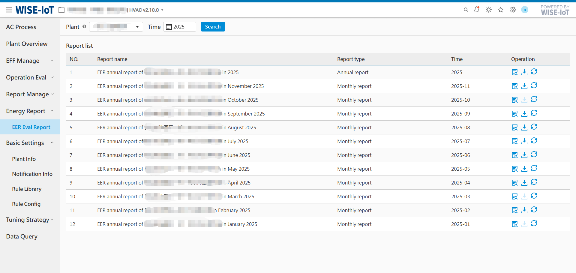

EER Report List

Annual Report Pages:
Annual Report - Page 1
Annual Report - Page 2
Annual Report - Page 3
