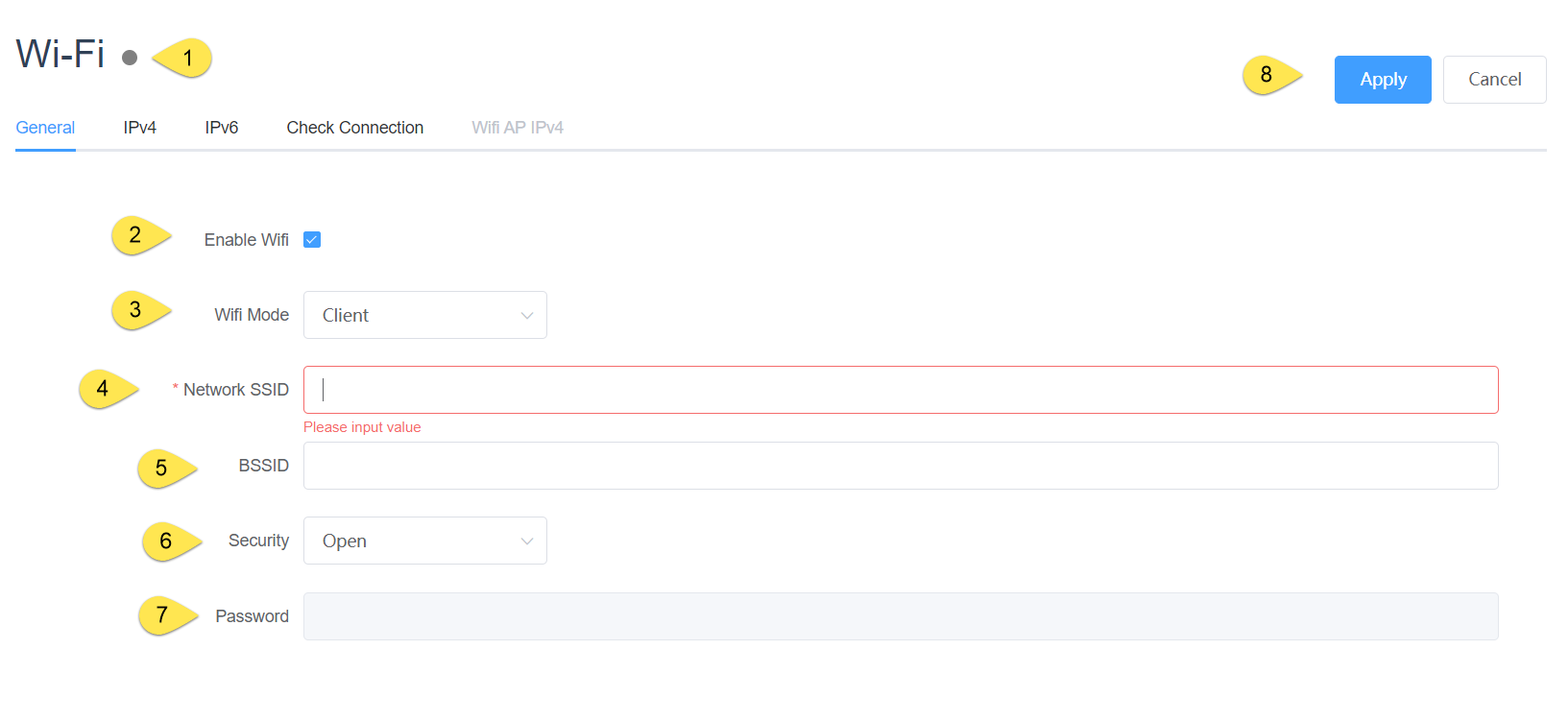

  1. led status
StatusDescription
greyThe module is unplugged
greenThe module has been detected and a network connection has been established
redModule detected but no network connection is established
  1. Whether Wifi networks are enabled
  2. Mode:Client or AP
    Client Mode​
    1. The SSID of the network that the Wifi module connects to in Client mode
    2. BSSID:Optional. Fill in this field when you need to connect to a specific AP.
    3. Security:Open、WEP、WPA/WPA2 PSK
    4. Password
    5. Effective after apply

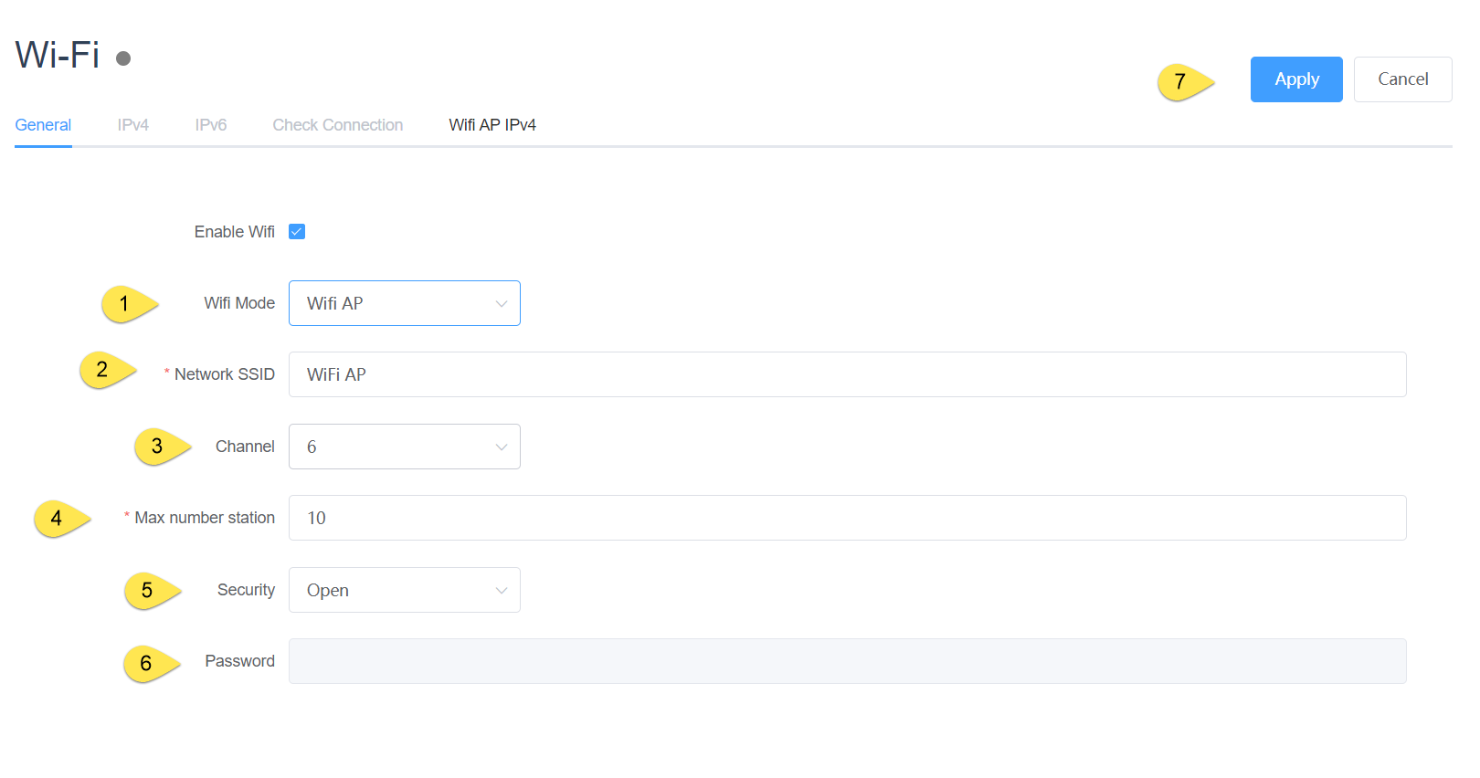

    AP Mode​
    1. select Wifi AP Mode
    2. The SSID is a unique identifier for a wireless network that is used to distinguish it from other nearby networks.
    3. Channel: Defaults to 6 and depends on the module.
    4. Maximum number of stations: This refers to the maximum number of clients that the AP allows to connect to it.
    5. Security:Open、WPA/WPA2 PSK
    6. Password:Password for AP
    7. Effective after apply

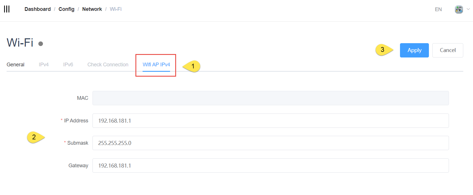

    1. select Wifi AP IPv4
    2. set up the IP range to be allocated to clients in AP mode
    3. Effective after apply
