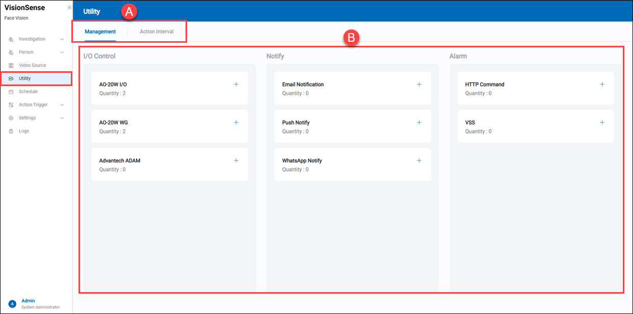

Utility Management
When Face Vision successfully recognizes a face, it can trigger external devices such as access control systems, indicator lights, or alarms. The system executes predefined actions—like unlocking doors or sending alerts—based on configured trigger rules.

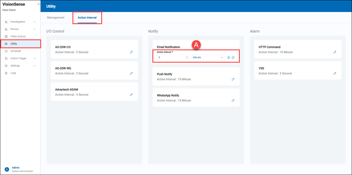

Utility_HomePage.png A.【Management/Action Interval】 ⇒ There are two function pages: 'Management' and 'Action Interval'. See below.
  • Management: The system provides eight types of utilities for sending notifications or alarms to external utilities. It allows users to perform CRUD operations on this page.
  • Action Interval: The ‘Action Interval’ feature must be used in conjunction with the ‘Action Trigger’ function. It allows the ‘Action Trigger’ to have a pause time between each trigger action and the next.
> For example:
  • There are two HTTP Command utilities, namely HTTP Command_A and HTTP Command_B. The Action Interval is set to 10 seconds, and the action interval behavior is as follows:
  • Suppose HTTP Command_A meets the trigger conditions every second. It triggers the first action at 13:00:10. Due to the 10-second action interval restriction, the next action can only be triggered at 13:00:20.
> Suppose HTTP Command_B also meets the trigger conditions every second. It triggers the first action at 13:00:15. Due to the 10-second action interval restriction, the next action can only be triggered at 13:00:25. In other words, although HTTP Command has only one Action Interval setting, each HTTP Command utility operates independently. Each action trigger follows its own action interval based on its individual trigger time, without being affected by others.
B.【Types of Utilities】 ⇒ It allows users to perform CRUD operations on this page.

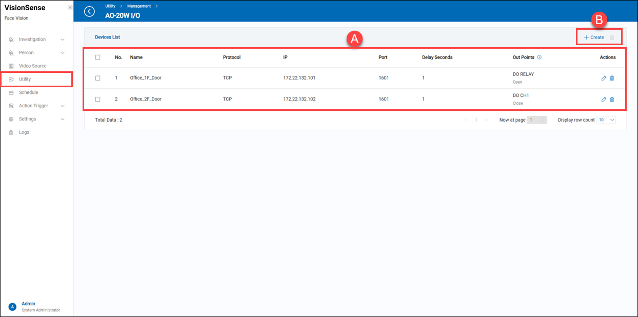

【AO-20W I/O】
  • Create: Click the Icon_Plus.png '+' to directly create a new AO-20W I/O device.
  • Quantity: It displays the quantity of added AO-20W I/O device.
  • Device List: Click anywhere to enter the settings page. Utility_List.png A.【Devices List】
  • Name: The assigned name of the device for identification.
  • Protocol: Indicates the communication protocol.
  • IP: The IP address of the device.
  • Port: The port number used by the device.
  • Delay Seconds: The delay in seconds after the output is triggered.
  • Actions: Click the icon_編輯.jpg 'Edit' to enter the edit page or click the icon_刪除.jpg 'Delete' to delete the assigned data.
B.【+ Create/Delete】 ⇒ Users can click Icon_+Create_normal.png '+ Create' to add a new AO-20W I/O device or click icon_刪除.jpg 'Delete' to remove multiple selected AO-20W I/O device at a time.

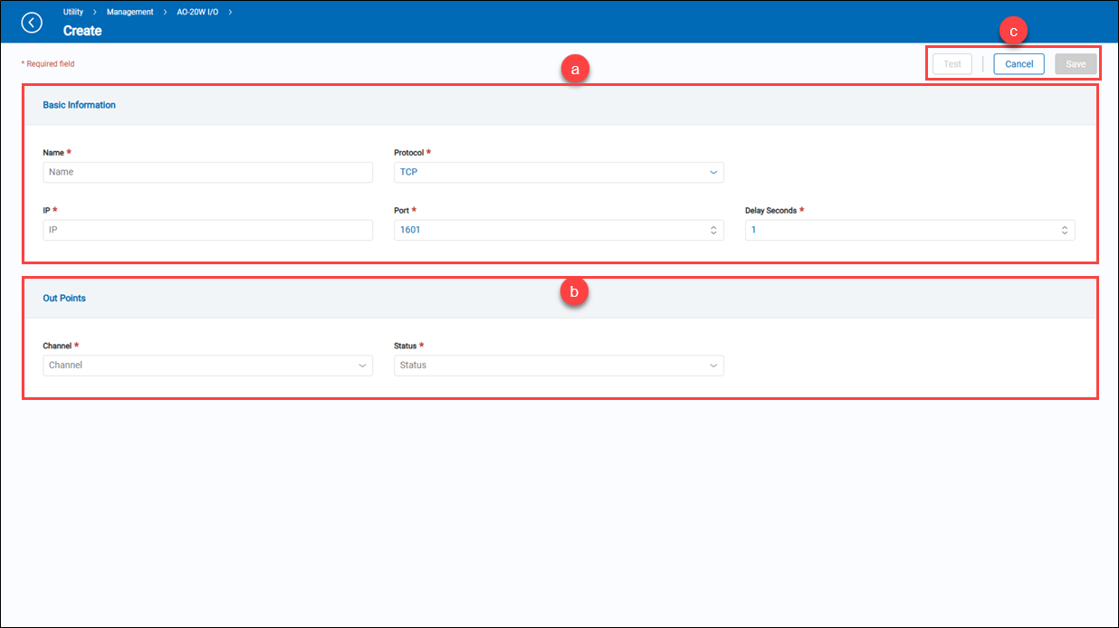

【Create a new AO-20W I/O】 Utility_AO-20W-IO_Create.png a.【Basic Information】
  • Name: A user-defined name for the AO-20W I/O device.
  • Protocol: Select the protocol (TCP/UDP) for connecting to the AO-20W I/O.
  • IP: Set the IP address for the AO-20W I/O connection.
  • Port: Set the port number for the AO-20W I/O connection.
  • Delay Seconds: Set the DO channel (Channel 1 ~ 3) and trigger status (Open / Close) for the AO-20W I/O device.
b.【Out Points】
  • Channel & Status: Set the DO channel (Channel 1 ~ 3) and initial status (Open / Close) for the AO-20W I/O.
c.【Operation】 Click the 'Save' to apply all settings or the 'Cancel' to return to the previous page without saving. Also, click the Icon_Test Button.png 'Test' to check whether all settings are connected properly.

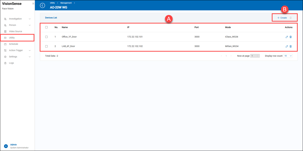

  • Create: Click the Icon_Plus.png '+' to directly create a new AO-20W WG device.
  • Quantity: It displays the quantity of added AO-20W WG device.
  • Device List: Click anywhere to enter the settings page. Utility_AO-20W-WG_List.png A.【Devices List】
  • Mode: The operating mode of the device, such as iClass_WG34 or Mifare_WG34.
B.【+ Create/Delete】 ⇒ Users can click Icon_+Create_normal.png '+ Create' to add a new AO-20W WG device or click icon_刪除.jpg 'Delete' to remove multiple selected AO-20W WG device at a time.

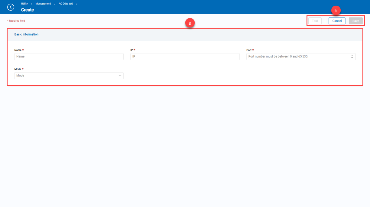

【Create a new AO-20W WG】 Utility_AO-20W-WG_Create.png a.【Basic Information】
  • Name: Custom name for the AO-20W WG device.
  • IP: Set the IP address used to connect to the AO-20W WG device.
  • Port: Set the port number used for connecting to the AO-20W WG.
  • Mode: Select the card technology (iClass or Mifare) and Wiegand bit format (26 or 34) that the converter will output.
b.【Operation】 Click the 'Save' to apply all settings or the 'Cancel' to return to the previous page without saving. Also, click the Icon_Test Button.png 'Test' to check whether all settings are connected properly.

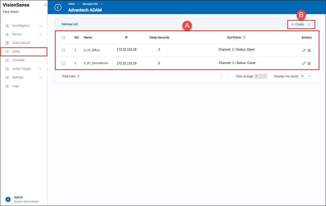

【Advantech ADAM】
  • Create: Click the Icon_Plus.png '+' to directly create a new Advantech ADAM device.
  • Quantity: It displays the quantity of added Advantech ADAM device.
  • Device List: Click anywhere to enter the settings page. Utility_ADAM_List.png A.【Devices List】
  • Out Points: This refers to the output channel of the ADAM device along with its initial state.
B.【+ Create/Delete】 ⇒ Users can click Icon_+Create_normal.png '+ Create' to add a new Advantech ADAM device or click icon_刪除.jpg 'Delete' to remove multiple selected Advantech ADAM device at a time.

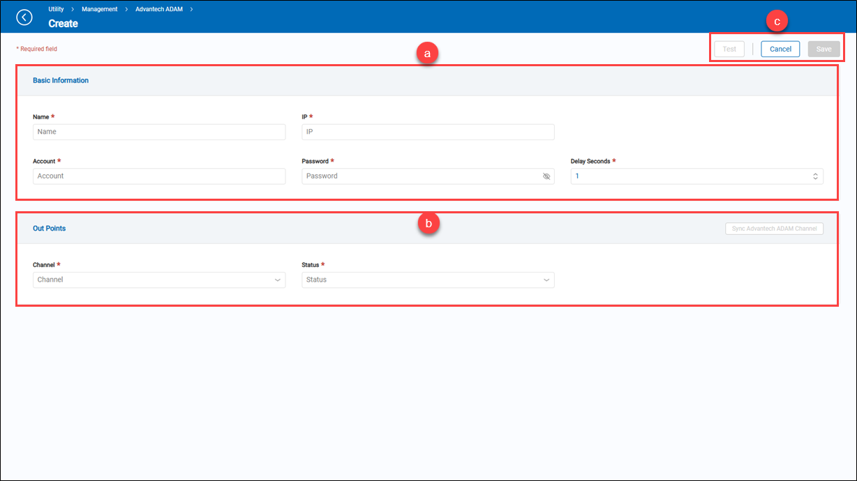

【Create a new Advantech ADAM】 Utility_ADAM_Create.png a.【Basic Information】
  • Name: A user-defined name for the Advantech ADAM device.
  • IP: Set the IP address of the Advantech ADAM device for connection.
  • Account: Enter the login account for the Advantech ADAM device.
  • Password: Enter the login password for the Advantech ADAM device.
  • Delay Seconds: Set the delay duration to maintain the triggered status before returning to the original state.
b.【Out Points】
  • Sync Advantech ADAM Channel: This button syncs the channel list from the ADAM device.
  • Channel & Status: Select the output channel of the ADAM device (e.g., Channel 0, Channel 1, etc.) and set its status to either "Open" or "Close".

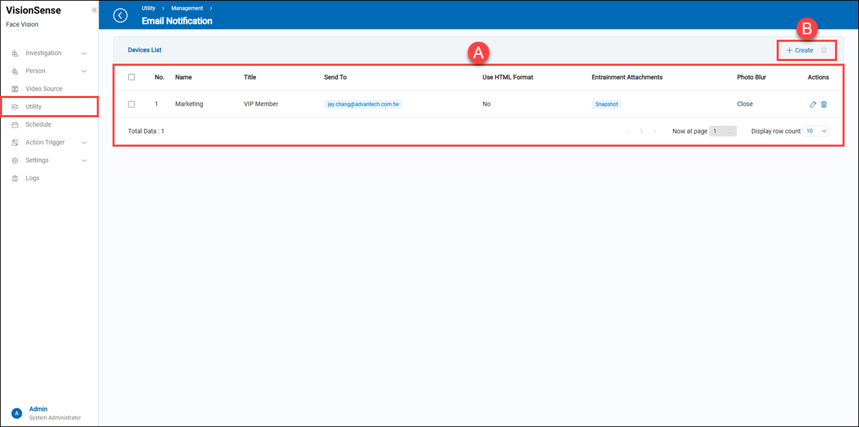

【Email Notification】
  • Create: Click the Icon_Plus.png '+' to directly create a new email notification.
  • Quantity: It displays the quantity of added email notifications.
Utility_Email Notification_List.png A.【Devices List】
  • Name: Customized Email Notification Name.
  • Title: Customized notification letter title.
  • Send To: Mailboxes of people to be notified.
  • Use HTML Format: The content of the letter supports HTML format.
  • Entrainment Attachments: Include real-time snapshots of detection area photos.
B.【+ Create/Delete】 ⇒ Users can click Icon_+Create_normal.png '+ Create' to add a new email notification or click icon_刪除.jpg 'Delete' to remove multiple selected email notifications at a time.

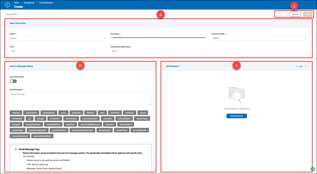

【Create a new email notification】 Utility_Email Notification_Create.png a.【Basic Information】
  • Name: The customized email notification name.
  • Title: The customized email notification title.
  • Photo Blur: Adjust the level of blurring for face images in the email.
  • Timezone Offset: Select the time zone of the location where the recipients of the email notifications are based.
b.【Send To Message Setting】
  • Use HTML Format: A toggle switch enables the feature when turned on and disables it when turned off. The content of the letter supports HTML format. If enabled, it will additionally support attaching a snapshot or person register image in the email message.
  • Email Message: Content of the email notification. It supports not only text but also variables for replacing specific data.
  • Placeholders: A set of predefined placeholders is provided for easy insertion into the message content. These represent event attributes like time, person name, camera, etc.
  • Push Notify Tips: Provides guidelines on how variables will be replaced with specific data.

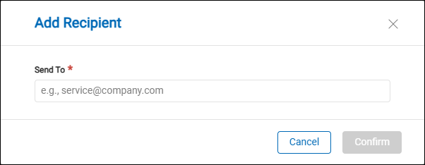

c.【Add Recipient】
  • Send To: Email addresses of the recipients for email notifications. (multiple recipients can be set).
  • + Add/Delete: Click Icon_+Add.png '+ Add' to add a new Email Notification or the icon_刪除.jpg 'Delete' to remove multiple selected data. Utility_Email Notification_Add Recipient_Ori.png
d.【Operation】 Click the 'Save' to apply all settings or the 'Cancel' to return to the previous page without saving. Also, click the Icon_Test Button.png 'Test' to send a test email to the recipient. Utility_EmailNotification_Test_Ori.png

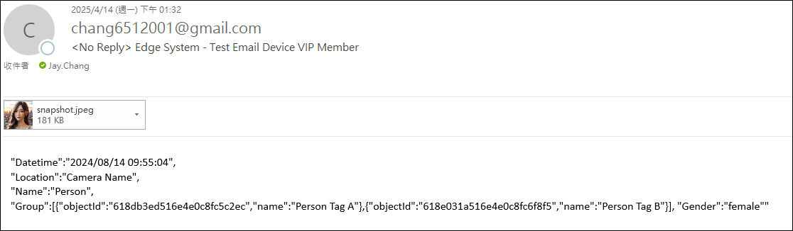

【Email Notification Example】 Utility_Email Notification_Test Example_Ori.png

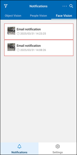

【Push Notify】
  • Create: Click the Icon_Plus.png '+' to directly create a new Push Notify.
  • Quantity: It displays the quantity of added Push Notify.
Utility_Push Notify_List.png A.【Devices List】
  • Name: Customized Push Notify name.
  • Send To: Specify the recipient of the push notification.
B.【+ Create/Delete】 ⇒ Users can click Icon_+Create_normal.png '+ Create' to add a new push notification or click icon_刪除.jpg 'Delete' to remove multiple selected push notifications at a time.

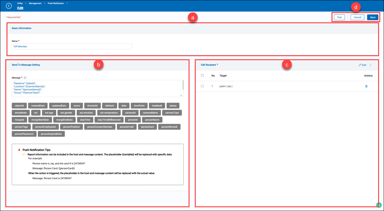

【Create a new push notification】 Utility_Push Notify_Create.png a.【Basic Information】
  • Name: Enter a descriptive name for the push notification.
b.【Send to Message Setting】
  • Message: Content of the push notification. Users can use predefined variables to dynamically insert data.

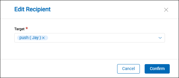

c.【Edit Recipient】
  • Target: The name of the device receiving the push notification.
  • Actions: Click the icon_刪除.jpg 'Delete' to delete the assigned data.
  • Edit/Delete: Click Icon_Edit.png 'Edit' to add a new push notification device or the icon_刪除.jpg 'Delete' to remove multiple selected data. Utility_Push Notify_Edit Recipient_Ori.png
d.【Operation】 Click the 'Save' to apply all settings or the 'Cancel' to return to the previous page without saving. Also, click the Icon_Test Button.png 'Test' to send a test push notification based on the current configuration. Utility_Push Notify_Test_Ori.png

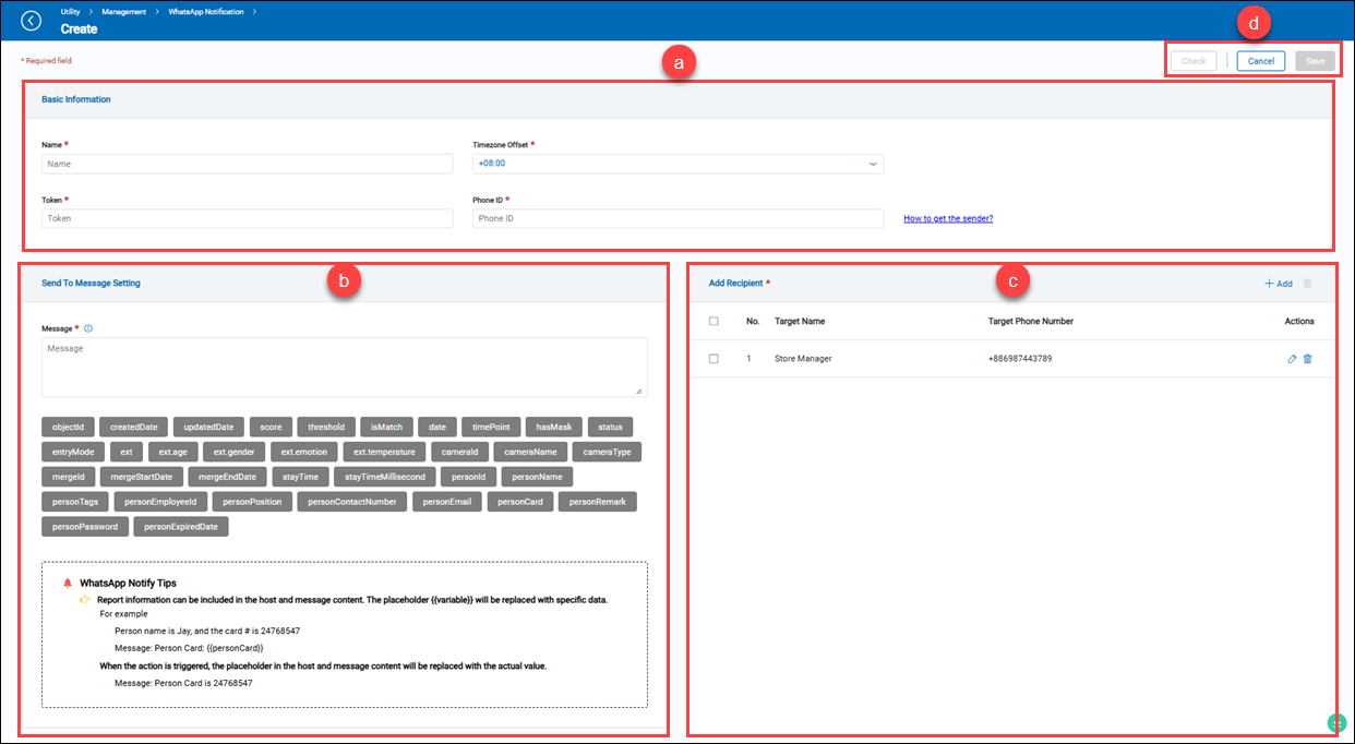

【Create a WhatsApp notification】 Utility_WhatsApp Notification_Create.png a.【Basic Information】
  • Name: The customized WhatsApp notification name.
  • Token: Enter a valid WhatsApp Token.
  • Timezone Offset: Select the time zone of the location where the recipients of the WhatsApp notifications are based.
  • Phone ID: Enter a valid phone number associated with the token.

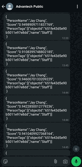

  • Message: Content of the WhatsApp notification. It supports not only text but also variables for replacing specific data.
c.【Add Recipient】
  • Target Name: The recipient's name of the WhatsApp notification.
  • Target Phone Number: The recipients' cell phone number of the WhatsApp notifications.(multiple recipients can be set)
  • Action: Click the icon_編輯.jpg 'Edit' to enter the edit page or click the icon_刪除.jpg 'Delete' to delete the assigned data.
  • + Add/Delete: Click Icon_+Add.png '+ Add' to add a new WhatsApp notification recipient or the icon_刪除.jpg 'Delete' to remove multiple selected data. Utility_WhatsApp Notification_Add Recipient_Ori.png
d.【Operation】 Click the 'Save' to apply all settings or the 'Cancel' to return to the previous page without saving. Also, click the Icon_Check.png 'Check' to send a test WhatsApp notification to the recipient. Utility_WahtsApp_Create_Check_Ori.png

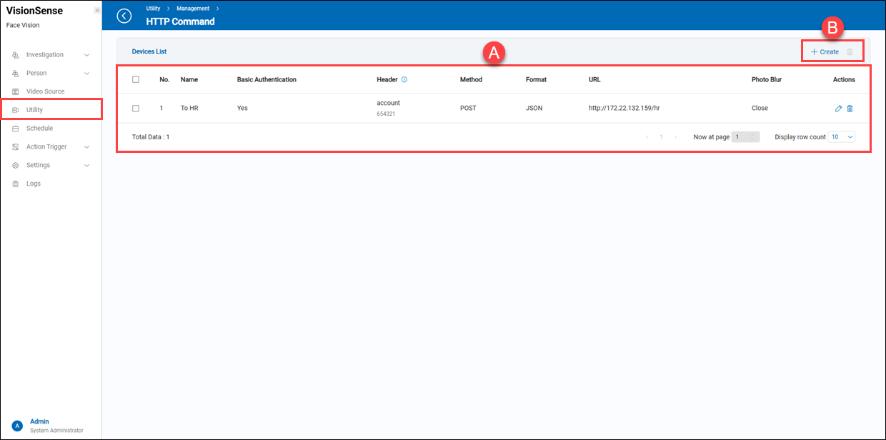

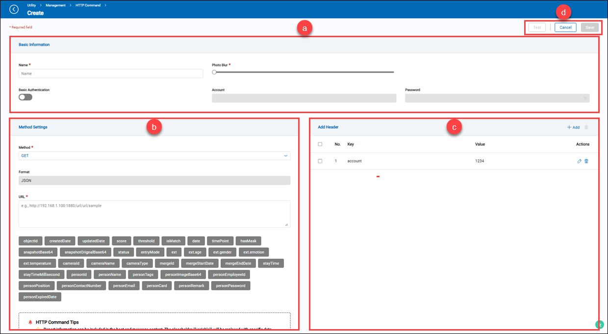

【HTTP Command】
  • Create: Click the Icon_Plus.png '+' to directly create a new HTTP Command.
  • Quantity: It displays the quantity of added HTTP Command.
Utility_HTTP Command_List.png A.【Devices List】
  • Name: The customized HTTP command name.
  • Basic Authentication: The account and password for Basic Authentication.
  • Header: HTTP Header and key values.
  • Method: HTTP data transfer method (GET or POST).
  • Format: (Unchangeable) JSON format.
  • URL: Destination URL where the HTTP message is to be sent.
  • Photo Blur: Indicates if photo blurring is applied to faces (e.g., "Close" means blur is disabled).

B.【+ Create/Delete】 ⇒ Users can click Icon_+Create_normal.png '+ Create' to add a new HTTP Command or click icon_刪除.jpg 'Delete' to remove multiple selected HTTP Commands at once.
【Create a new HTTP Command】 Utility_HTTP Command_Create.png a.【Basic Information】
  • Name: Enter a descriptive name for the HTTP Command.
  • Photo Blur: Adjust the level of blurring for face images.
  • Basic Authentication: Toggle the switch to enable or disable authentication.
  • Account & Password: If Basic Authentication is enabled, input the required account credentials.
b.【Method Setting】
  • Method: Select the HTTP request method (e.g., POST, GET).
  • Format: Defines the data format, such as JSON.
  • URL: Specify the endpoint to which the HTTP request will be sent.
  • Request Body: Input the request payload in JSON format. Users can use predefined variables to dynamically insert data.
  • HTTP Command Tips: Provides guidelines on how variables will be replaced with specific data.
c.【Add Header】
  • Key: The name of the header field.
  • Value: The value assigned to the header field.
  • + Add/Delete: Click Icon_+Add.png '+ Add' to add a new header or the icon_刪除.jpg 'Delete' to remove multiple selected data. Utility_HTTP Command_Create_Add Header_Ori.png
d.【Operation】 Click the 'Save' to apply all settings or the 'Cancel' to return to the previous page without saving. Also, click the Icon_Test Button.png 'Test' to send a test HTTP request based on the current configuration.

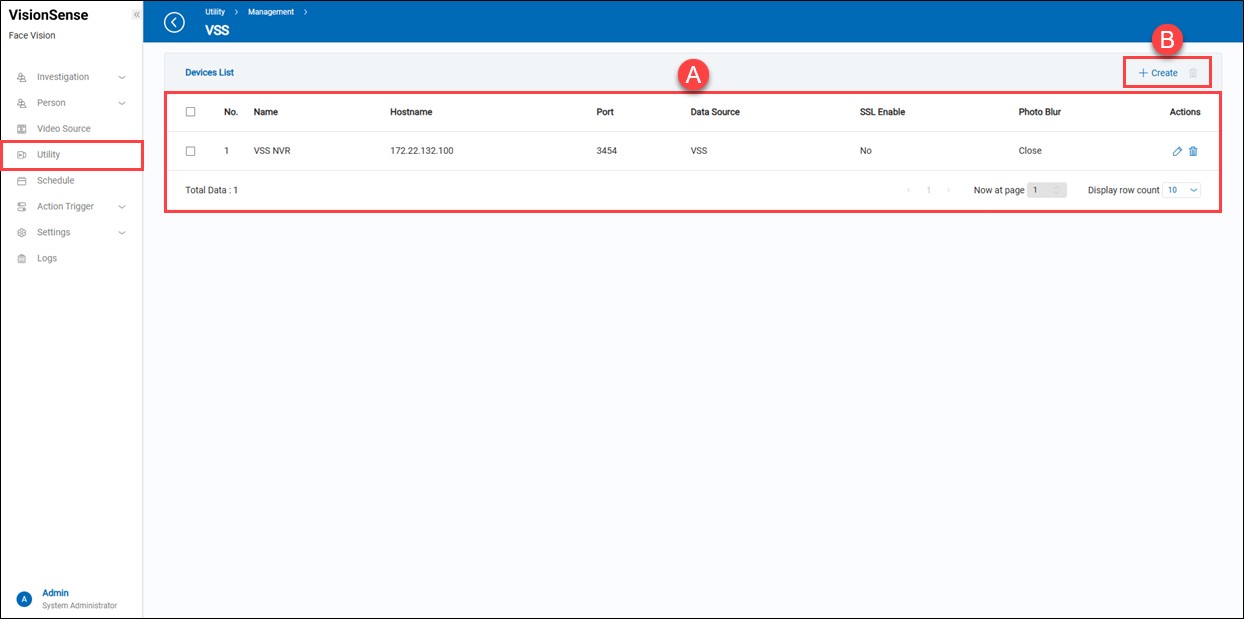

【VSS】
  • Create: Click the Icon_Plus.png '+' to directly create a new VSS device.
  • Quantity: It displays the quantity of added VSS device.
Utility_VSS_List.png A.【Devices List】
  • Name: The customized VSS device name.
  • Hostname: The host location or IP address of the VSS device.
  • Port: The port number to connect to this VSS device.
  • Data Source: The source name of the VSS device.
  • SSL Enable: This shows whether the SSL protocol is enabled or disabled.
B.【+ Create/Delete】 ⇒ Users can click Icon_+Create_normal.png '+ Create' to add a new VSS device or click icon_刪除.jpg 'Delete' to remove multiple selected VSS devices at once.

【Action Interval】
The 'Action Interval' feature must be used in conjunction with the 'Action Trigger' feature. It allows the 'Action Trigger' to have a delay between each trigger action and the next one.
Utility_Action Interval.png A.【Action Interval】 => Click the icon_編輯.jpg 'Edit' to enter the edit mode and click the Icon_Apply.jpg 'Apply' to apply settings or click the Icon_Cancel.png 'Cancel' to cancel the current operation. Three time units are supported: 'Second', 'Minute', and 'Hour'.
