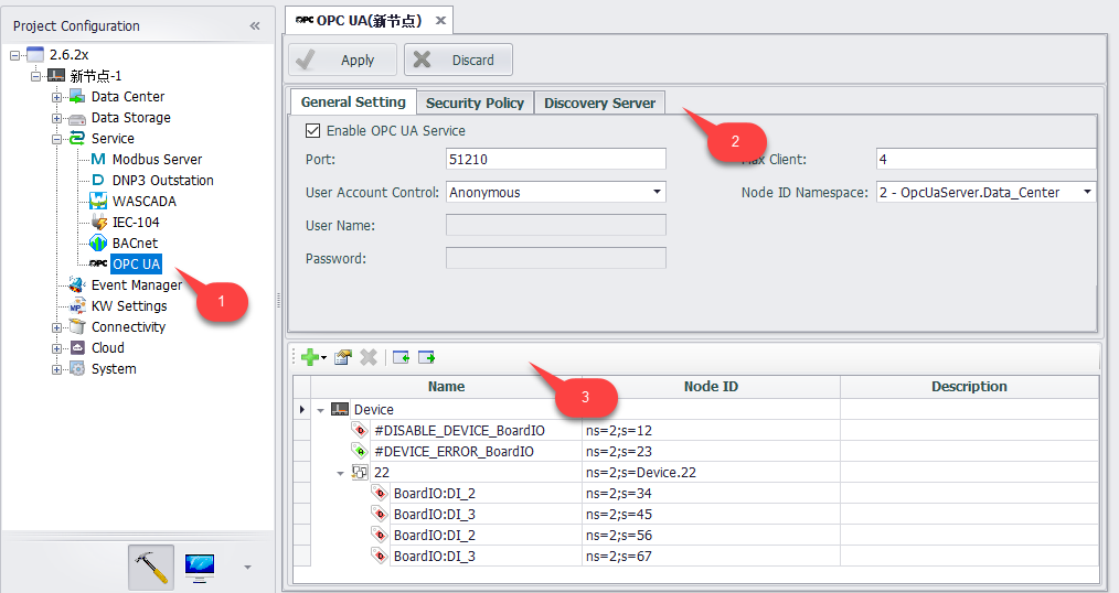

  1. The user can click on the OPC UA node under the protocol service to enter the configuration interface.
  2. The general settings and security policies of the OPC UA server on the device can be configured in the OPC UA configuration interface.
  3. The configured tags in the device can be added to the OPC UA server.

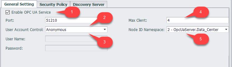

  1. The user can choose to enable or disable the OPC UA service. The OPC UA configuration document is not generated when the service is not enabled.
  2. Port: The port number of the OPC UA server on the device. The default is 4840.
  3. User account control: The server allows the client to access the server anonymously or to verify the username and password when accessing.
    Anonymous: The default connection mode. The server allows the client to create a connection anonymously without the need to configure a username and password.
    User Name/Password: The client needs to configure the username and password when creating the connection. The username must be entered and the password can be empty.
  4. Max Client:A maximum of several clients are allowed to connect to the server at the same time.
  5. Node ID Namespace:Index of the node namespace

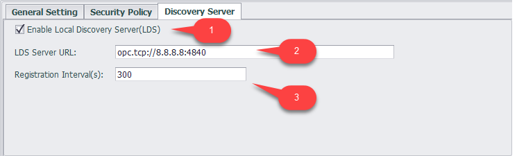

The Local Discovery Server (LDS) is a DiscoveryServer that maintains a list of all OPC UA Servers and Gateways available on the host/PC that it runs on, and is the OPC UA equivalent to the OPC Classic OPCENUM interface.
  1. Enable LDS
  2. LDS Server URL:The address of the LDS server
  3. Registration Interval:The interval for registering the OPC UA server with the Local Discovery Server, in seconds.
