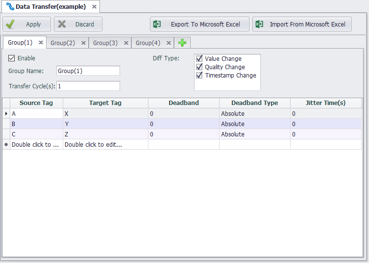

  1. The user can click the Data Transfer node under the protocol service to enter the configuration page.
  1. The configuration page of Data Transfer is shown in the figure below. Up to 4 groups can be configured, and each group can have a different cycle and change detection configuration. If you have more points, you can use Export/Import Excel function to assist in editing.
According to the configuration in the above figure, the Data Transfer program will transfer the tag values (A=>X, B=>Y, C=>Z) per second, or on detection of any change of the source tag's value, quality, and time stamp.
