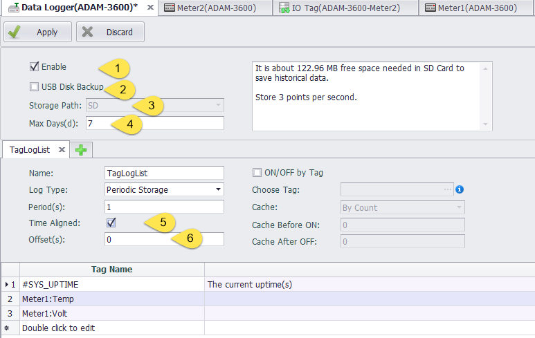

DataLogger Parameter Configuration:
  1. Enable: select this item to enable data storage;
  2. USB Disk backup: select this item, the existed historical data will be copied into the USB disk from SD card only when the system detects an insertion event. The newly added historical data is still stored in the SD card.
  3. Storage address enabled: the location of the data store is stored on the SD card by default. The SD card must be installed before using DataLogger function;
  4. Save the number of days (days): the maximum number of days of historical data is 7 days by default. If the number of days saved is exceeded, the system will automatically delete the earliest stored data.
  5. Time alignment: only periodic storage support, whether the timestamp is aligned, check to align, unchecked to be unaligned; Alignment refers to the start time of periodic storage to store the latest hourly time after the storage program starts running.
  6. Time Alignment Offset: If Time Alignment is checked, you can also set the offset
Example:
  • If the periodic storage period is 10S, the time alignment and the time alignment offset is 2S, the stored program starts to run at 13:15:17, then the time is 13:15:22 for the first stored data and 13:15:32 for the next data
  • The periodic storage period is 10S, the time alignment is not checked, and the stored program starts running at 13:15:17, then the time is 13:15:17 for the first stored data and 13:15:27 for the next data

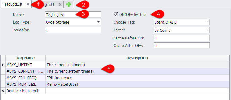

Storage group parameter configuration:
Tag values can be stored in a data table in a variety of ways depending on the configuration of the storage group
  1. The storage group configures the Tab page, and the user can click "x" to close the current configuration page.
  2. Users can click "+" to add storage groups
  3. The basic parameters of a storage group:
    • Name: the name of the storage group, which is used only to distinguish storage groups
    • Storage mode: you can select cycle storage and change storage.
    • Period needs to be configured when selecting cycle storage.
  4. The user can select a tag to control the current storage group ON and OFF. When the Tag value is 0, the storage group is not enabled, and the storage group is enabled when the rest of the values are present.
    • Select the control tag: select a tag in the Data Center as the control tag.
    • Cache mode: when the control tag ON and OFF, it will cache a certain amount of data. In the cache mode, you can choose to cache log information by count or time.
    • Cache before ON: some Tag data is cached before the storage group starts its storage
    • Cache after OFF: after the storage group stops storage, some Tag data is stored.
  5. Edit the tags to be stored in the list,and the total number of tags stored in all storage groups is limited to 200.

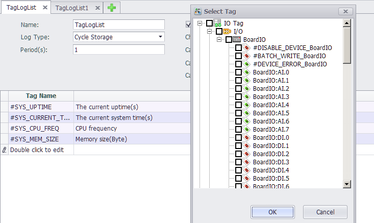

Edit the storage tag
Double-click on the last line in the tag name column to add the storage tag, and double-click the added Tag to modify. To delete the Tag, right-click on the Tag line that you want to delete, and click the delete button on the pop-up toolbar to remove the current Tag.
