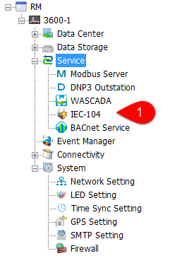

Double click the IEC-104 in the protocol service to open the IEC104 server settings interface.

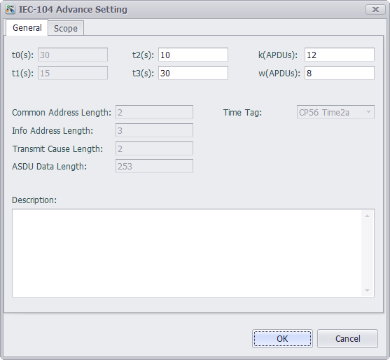

  3. Advanced parameters: set other properties of IEC-104.

  1. t0: Timeout of connection establishment. (Not editable)
  2. t1: Timeout of sending or testing APDU. (Not editable)
  3. t2: A timeout that is confirmed when no data message is received, t2 < t1.
  4. t3: Timeout of sending test frame in long idle state.
  5. K: The maximum difference between the sending status variable and the received sequence number.
  6. W: The acknowledgment is given after receiving the APD of the I-format.
  7. Time stamp format: defaults to CP56 Time2a.(Not editable)

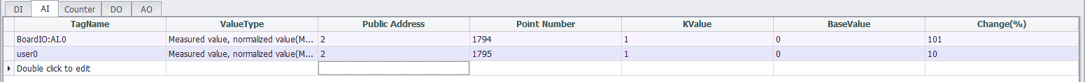

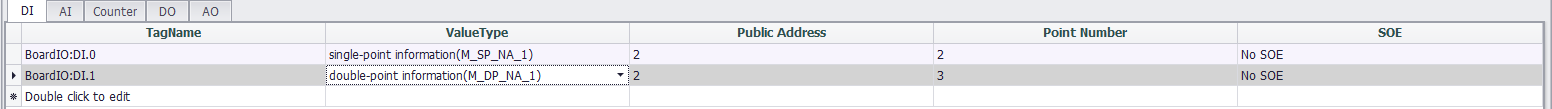

Data Tag Configuration
  1. TagName: The name of the tag created in the Utility.
  2. ValueType: The numeric type of the variable.
  3. Public address: the public address to which the variable belongs should be filled with the same value as the device address.
  4. Point Number: the corresponding variable number.
  5. KValue, BaseValue: AI: engineering value = BaseValue + acquisition value * KValue, AO: export value = (engineering value - BaseValue) / KValue.
  6. Change: this variable is greater than this percentage when uploaded to the server.
  7. SOE: records the time at which the failure occurred and the type of event.
