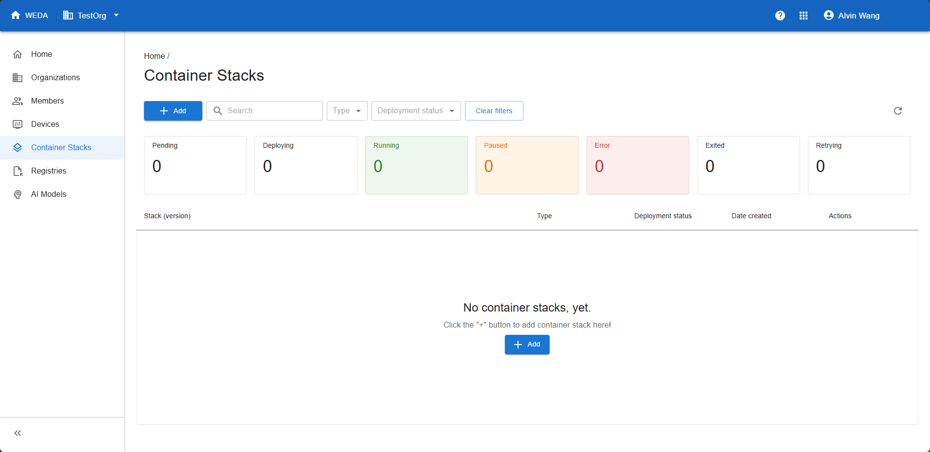

  1. Open Container Stacks in the left navigation and select Add.
Container Stacks list in TestOrg with an Add entry before the first Stack is created.
Select Add to create the Stack for your application.

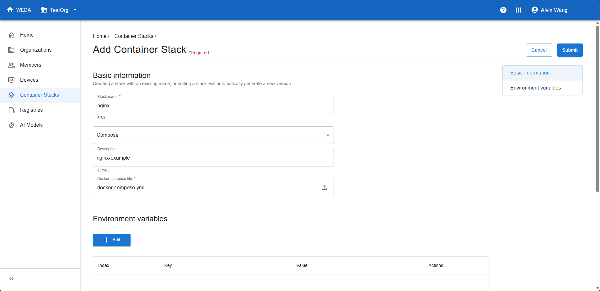

  1. Enter Stack name nginx, or another name that is not already used by an existing Stack. A duplicate name is rejected. To publish a new version of an existing Stack, edit that Stack instead. Follow these naming rules:
    • Use lowercase letters, digits and hyphens only.
    • Use no more than 63 characters.
    • Do not start or end with a hyphen, or use consecutive hyphens.
  2. Select Compose as the type. For this example, enter description nginx-example.
  3. Upload the downloaded docker-compose.yml.
Add Container Stack with name nginx, Compose type, description nginx-example and uploaded docker-compose.yml.
The nginx example is ready to submit. No Environment variables are needed for this file.

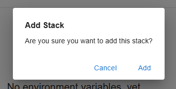

  2. Select Submit, then Add in the confirmation dialog.
Add Stack confirmation dialog with Cancel and Add buttons.
Select Add to save the Stack definition.

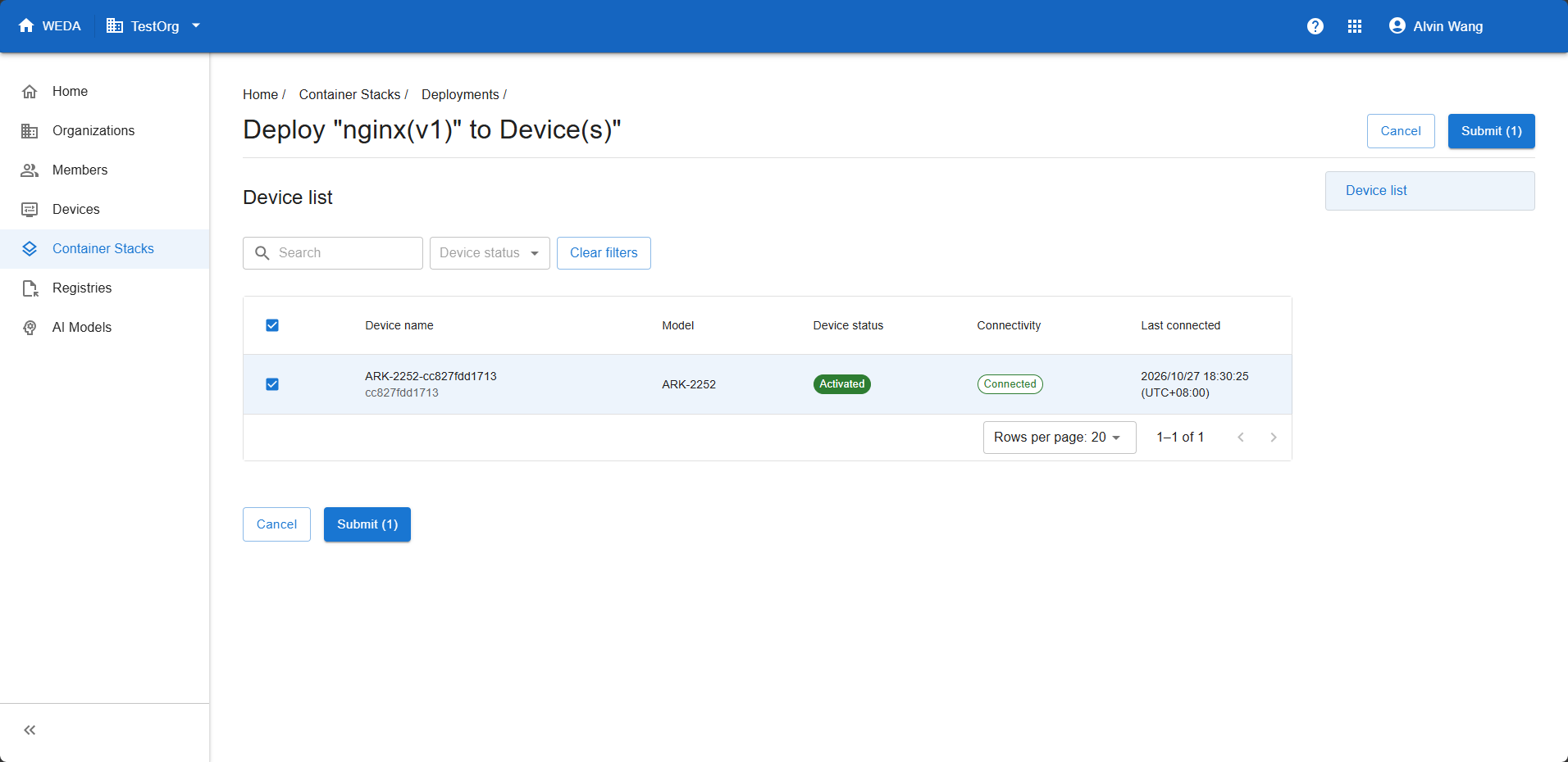

  1. In Container Stacks, find nginx (v1) and select its Deploy action.
  2. In the Device list, select your target WEDA Node. The screenshot selects ARK-2252-cc827fdd1713, which is Activated and Connected. Confirm that the page heading identifies nginx(v1).
Deploy nginx v1 to devices with ARK-2252-cc827fdd1713 selected, Activated and Connected.
The Stack revision is already selected. Choose the device that should run it.

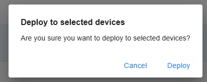

  1. Select Submit, then Deploy in the confirmation dialog.
Deploy to selected devices confirmation dialog with Cancel and Deploy buttons.
Select Deploy to submit the selected revision to the device.

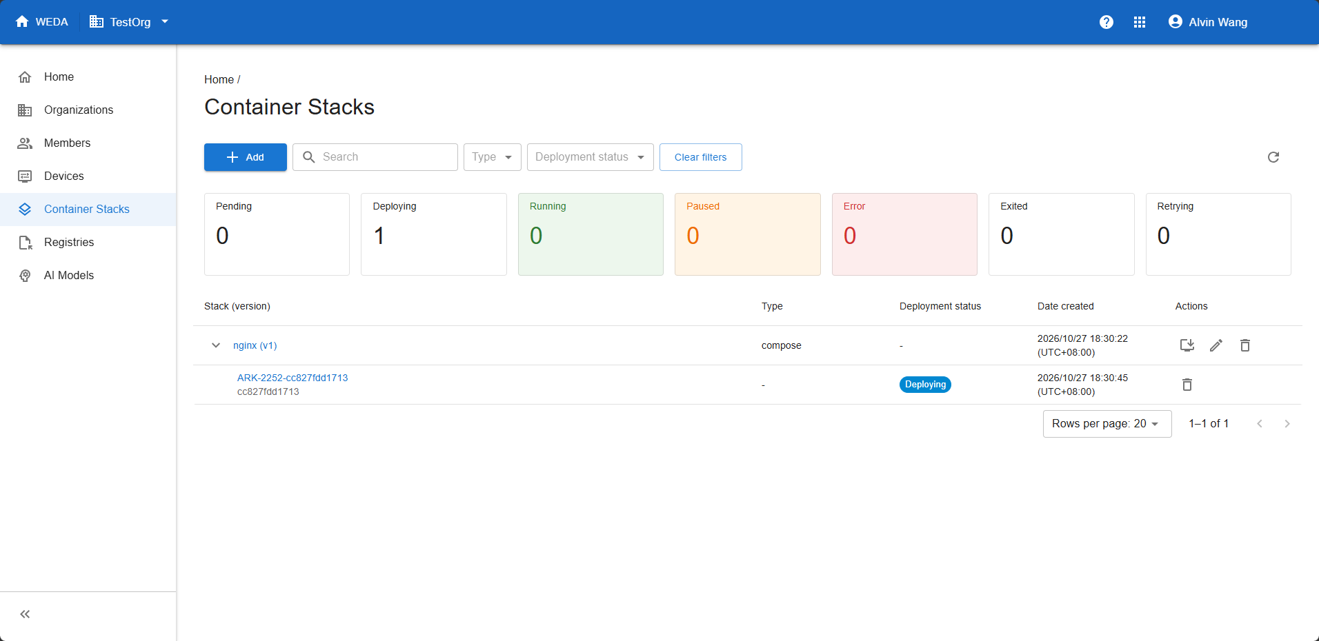

Expanded nginx v1 Stack showing ARK-2252-cc827fdd1713 as Deploying, with Deploying count one and Running count zero.
Deploying indicates work in progress. It does not confirm that the application is running.
Check the result: Track the deployment status reported for the selected device. Keep the device connected while deployment proceeds.

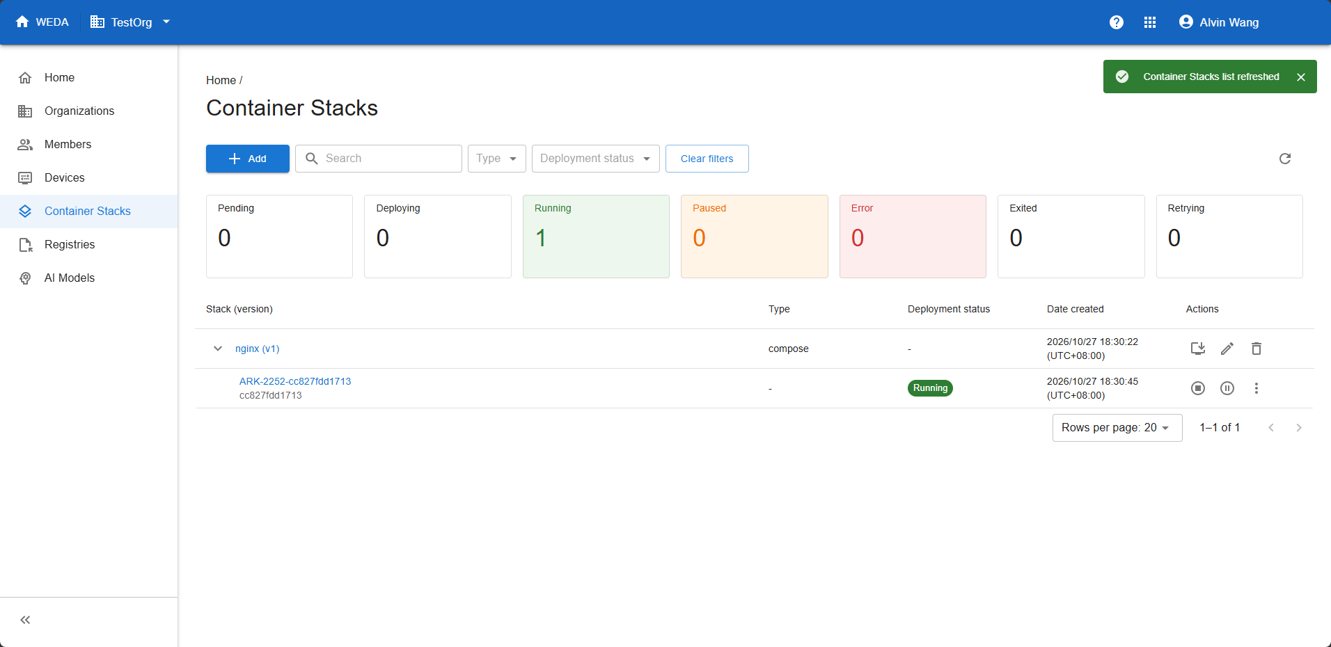

Expanded nginx v1 Stack showing ARK-2252-cc827fdd1713 as Running, with Running count one and Deploying count zero.
The nginx deployment now reports Running on the selected device.

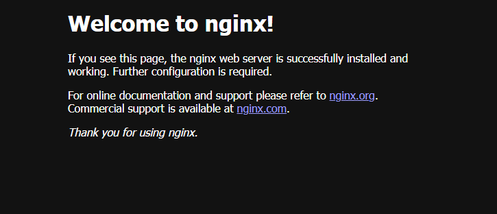

  4. Open http://DEVICE_IP:8080 in a browser, replacing DEVICE_IP with your WEDA Node's reachable IP address. The nginx sample should display its default welcome page. The Console screenshot confirms Running; this browser check verifies that the web service is reachable.
Default nginx web page displaying Welcome to nginx and confirming that the web server is installed and working.
The example web server returns the default Welcome to nginx page. Verify this application response as well as the Running status in Console.

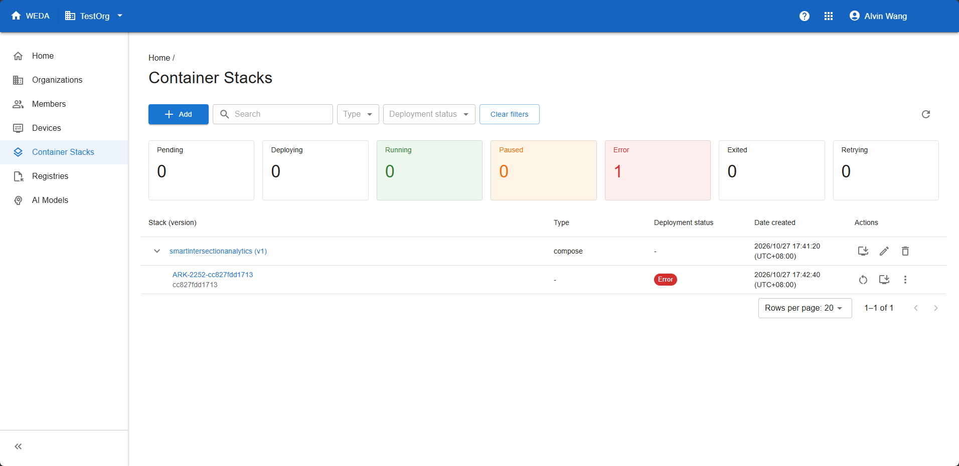

If deployment or startup fails, begin with the reported error:
Expanded smartintersectionanalytics Stack showing an Error result for ARK-2252-cc827fdd1713, with the Error count at one.
Separate failure example: Smart Intersection Analytics reports Error. This is not the nginx deployment shown above. Inspect the deployment reason and logs rather than diagnosing from the badge alone.
