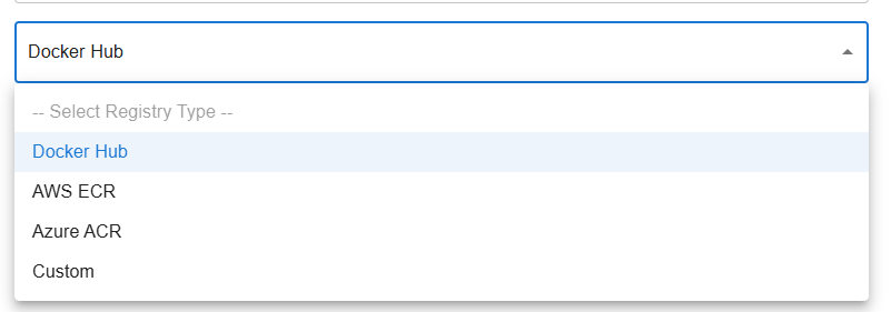

WEDA supports four registry types:
| Registry type | Credential fields |
Docker Hub (DockerHub) | username + accessToken, both required. |
Azure ACR (AzureACR) | username + userPassword, both required. |
AWS ECR (AwsECR) | Provide region, accessKey and accessSecretKey together, or leave all three empty for anonymous access. For authentication, use a valid region code such as us-east-1, a 20-character access key and a 40-character secret key. |
Custom (Custom), for example Harbor or GitLab Container Registry | username + userPassword are optional; provide both when authentication is used. |

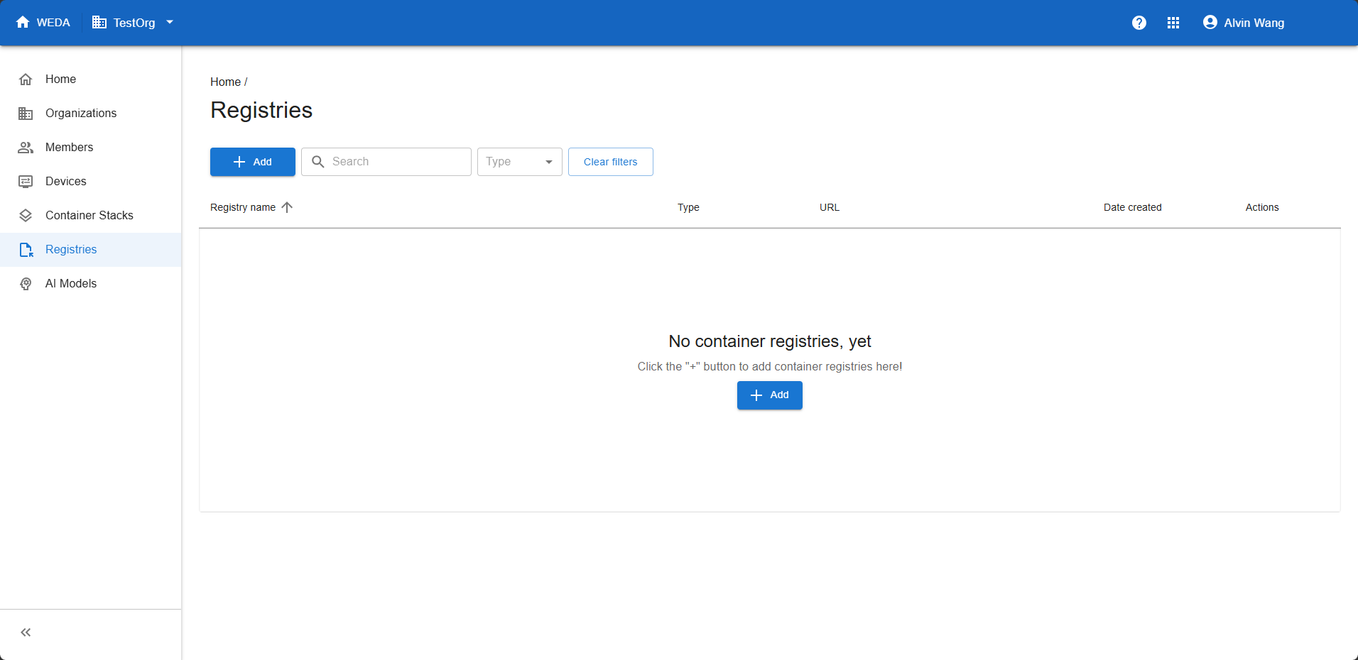

- In WEDA Console, select the target devices' Org and open Registries.
- Check whether a configuration for the registry host already exists. Reuse or update that configuration when appropriate.

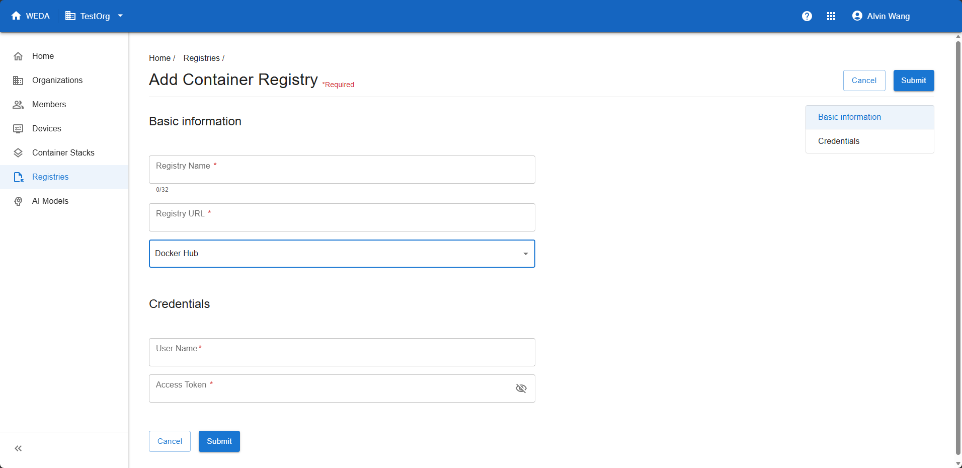

- Select Add.

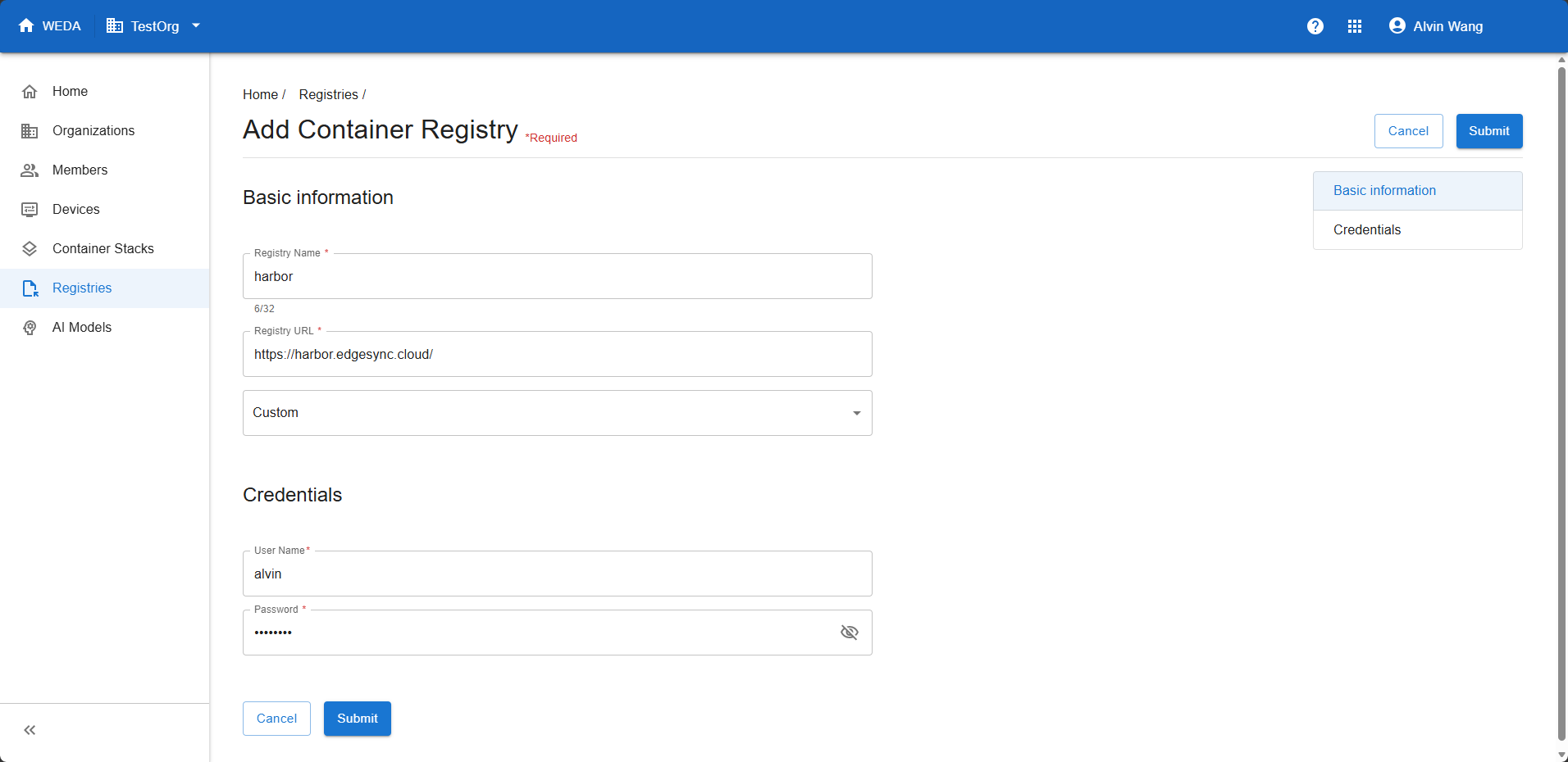

- Choose the Registry Type and complete Basic information:
- Registry Name: A unique name, such as harbor.
- Registry URL: Your registry address, such as
https://harbor.company.com. - Registry Type: Custom for this Harbor example.
- Enter the registry account's username and password in Credentials.
- Select Submit, then Add in the confirmation dialog.

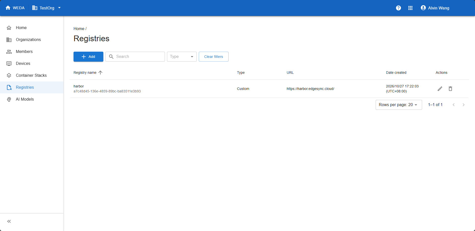

Check the result: The configuration appears in the selected Org's registry list. Confirm its name, URL and type. API clients receive 201 Created and should retain the returned registryId for later reads, updates or deletion.
Saving a configuration does not confirm that a target device can reach the registry or pull a particular image. Check those results during deployment.

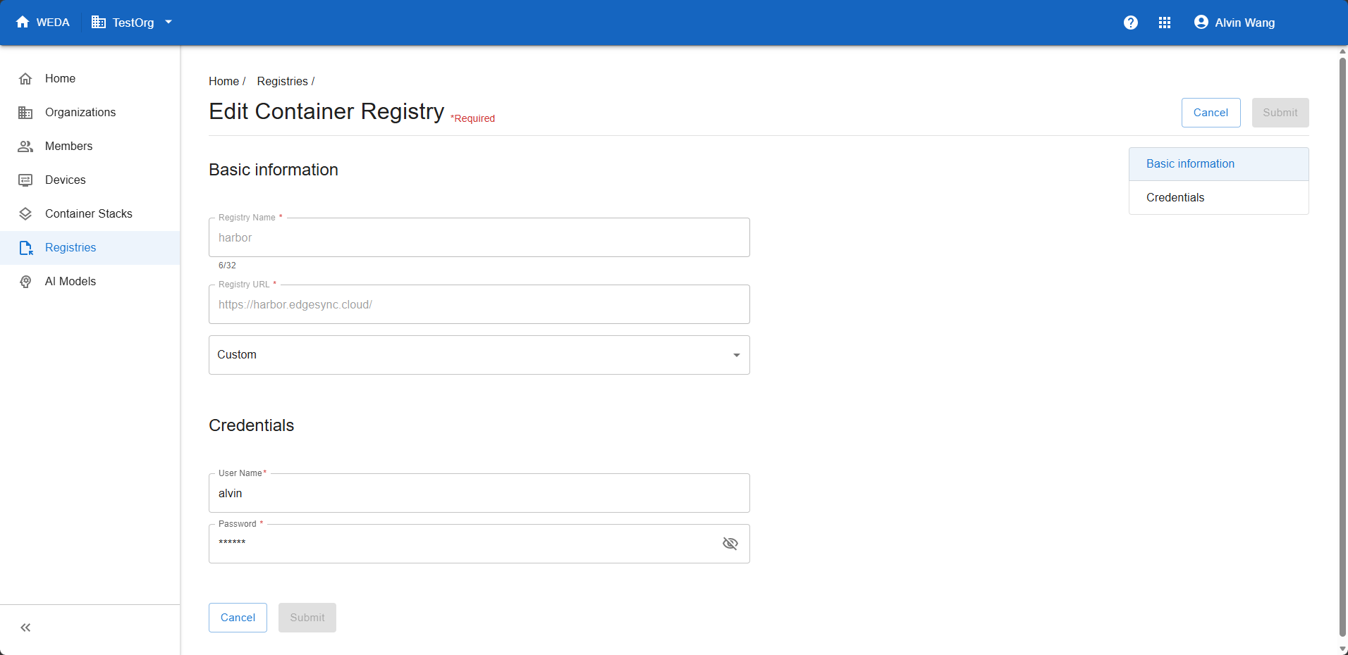

In WEDA Console: Select the configuration's edit icon in the registry list. In the form shown below, Registry Name and Registry URL are read-only; edit the available type or credential fields as needed, then select Submit and read the configuration back.
