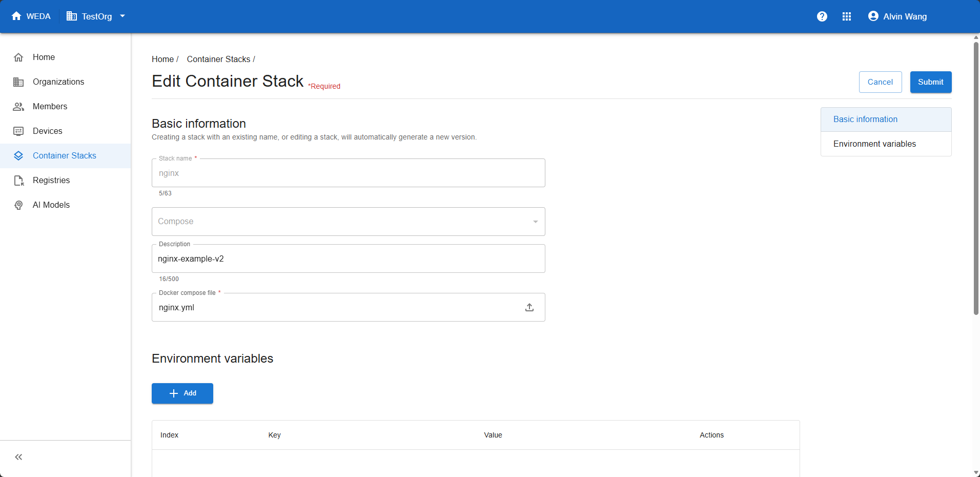

Update and Compare Revisions​
To create a new version in Console:
  1. Select the pencil icon for nginx (v1) to open Edit Container Stack. The name and type are read-only.
  2. Change Description from nginx-example to nginx-example-v2. Keep the sample Compose content unchanged. The edit screenshot displays the uploaded file as nginx.yml; the filename does not determine the Stack version.
  3. Select Submit and confirm the edit if prompted.
Edit Container Stack for nginx with read-only name and Compose type, description nginx-example-v2 and uploaded nginx.yml.
Saving the edited definition creates a new version, even when the demonstrated change is its description.
Stack list showing nginx v2 and nginx v1, with ARK-2252-cc827fdd1713 still listed under v1.
The saved edit appears as v2. The device remains listed under v1; saving v2 has not deployed it.
Check the result: Both nginx (v2) and nginx (v1) are listed. Deploy v2 explicitly when you want the device to use it. This example demonstrates a saved revision, not an nginx image upgrade.
