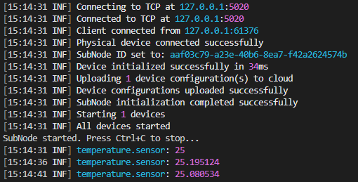

Quick Test
You can execute the template project on a built-in simulator, allowing local development and testing without physical devices.
The simulator emulates device data and interactions, enabling you to validate API endpoints and integration logic before deploying to real hardware.
cd MyDevice
dotnet run
Expected output:
Template Subnode quick test
🎉 If you see periodic telemetry data, congratulations! You've successfully created your first SubNode!
