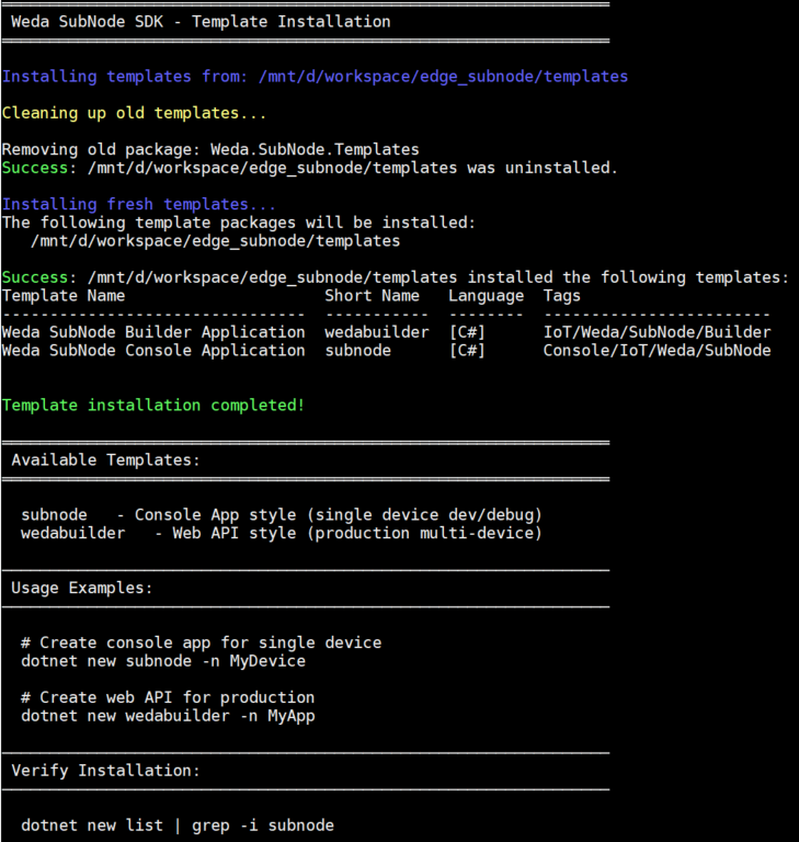

Navigate to the SDK repository root and run:
bash scripts/install-templates.sh
Expected output:
WEDA SubNode Install Script
