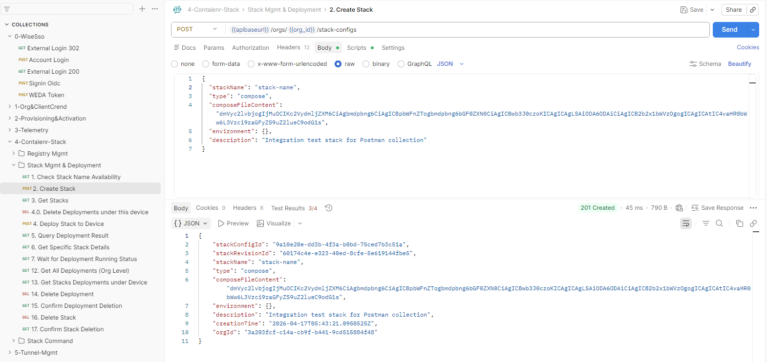

1.3 Create a Container Stack
Use the following API to create a container stack. Put the Base64-encoded Compose file in composeFileContent. The system will automatically assign a revision number.
Postman Collection: 4-Container-Stack > Stack Mgmt & Deployment
  1. Check Stack Name Availability: Check if the stack name is duplicated with existing stacks.
  2. Create Stack: Create a container stack with the Base64-encoded compose file.
  3. Get Stacks: Get the list of stacks to confirm the new stack creation.
postman create stack
Example Request: Curl
curl --location --request POST 'https://{domain}/{tenantPath}/weda/api/v1/orgs/{orgID}/stack-configs' \
--header 'Content-Type: application/json' \
--header 'Authorization: Bearer {access-token}' \
--data '{
"stackName": "stack-name1",
"type": "compose",
"composeFileContent": "{Base64-encoded}",
"environment": {},
"description": "this is description"
Example Response
"stackConfigId": "e700312d-18e9-4a93-b291-0108596b0a91",
"stackRevisionId": "70e1771a-0fd3-4e85-9a17-6ea752f92d0b",
"type": "compose",
"environment": {},
"description": "this is description",
"creationTime": "2025-10-30T09:42:39.014305Z",
"orgId": "3a203fcf-c14a-cb9f-b441-9cd515884f48"

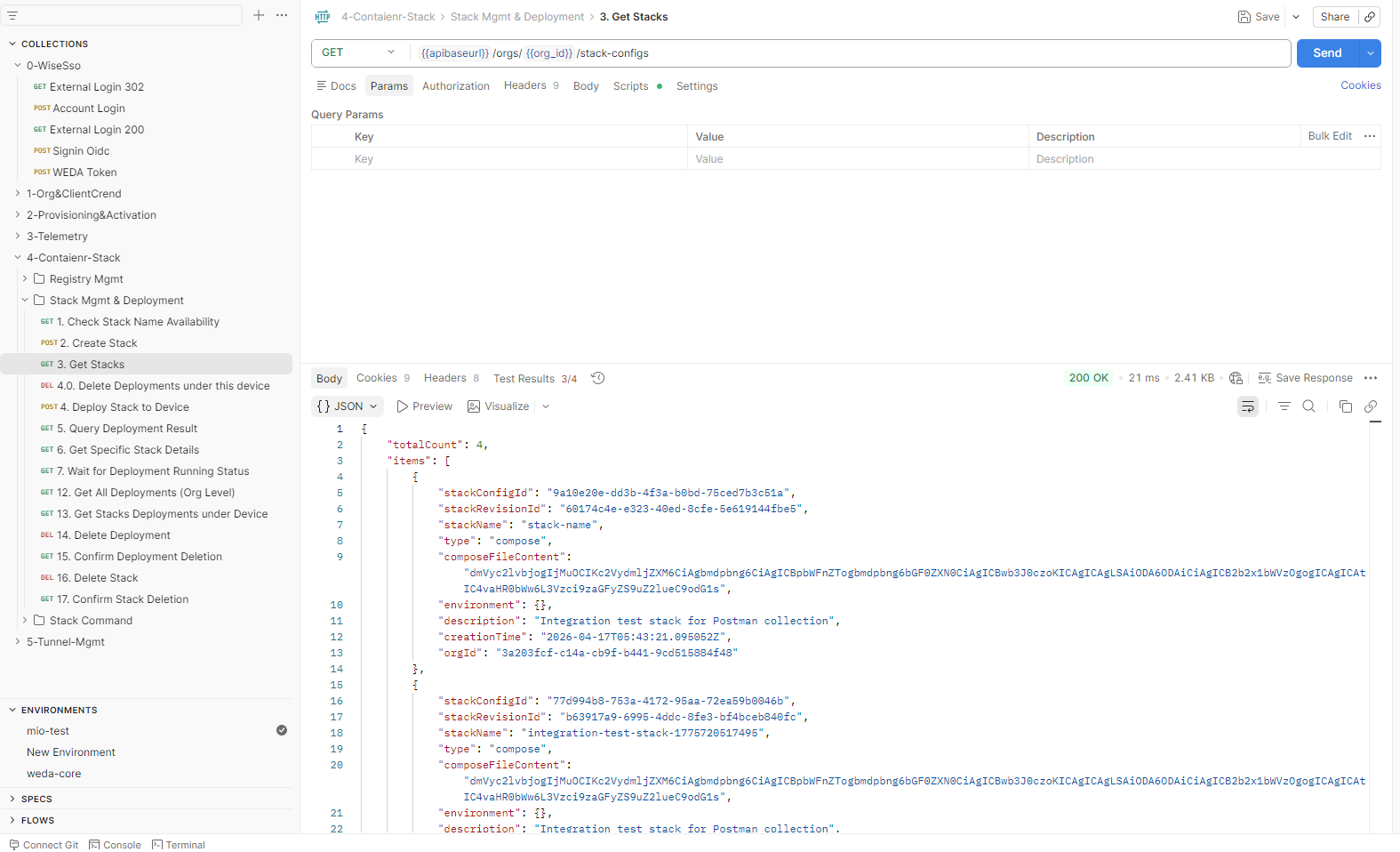

postman get stacks
curl --location --request GET 'https://{domain}/{tenantPath}/weda/api/v1/orgs/{orgID}/stack-configs' \
Example Response
"totalCount": 1,
"items": [
"type": "compose",
"environment": {},

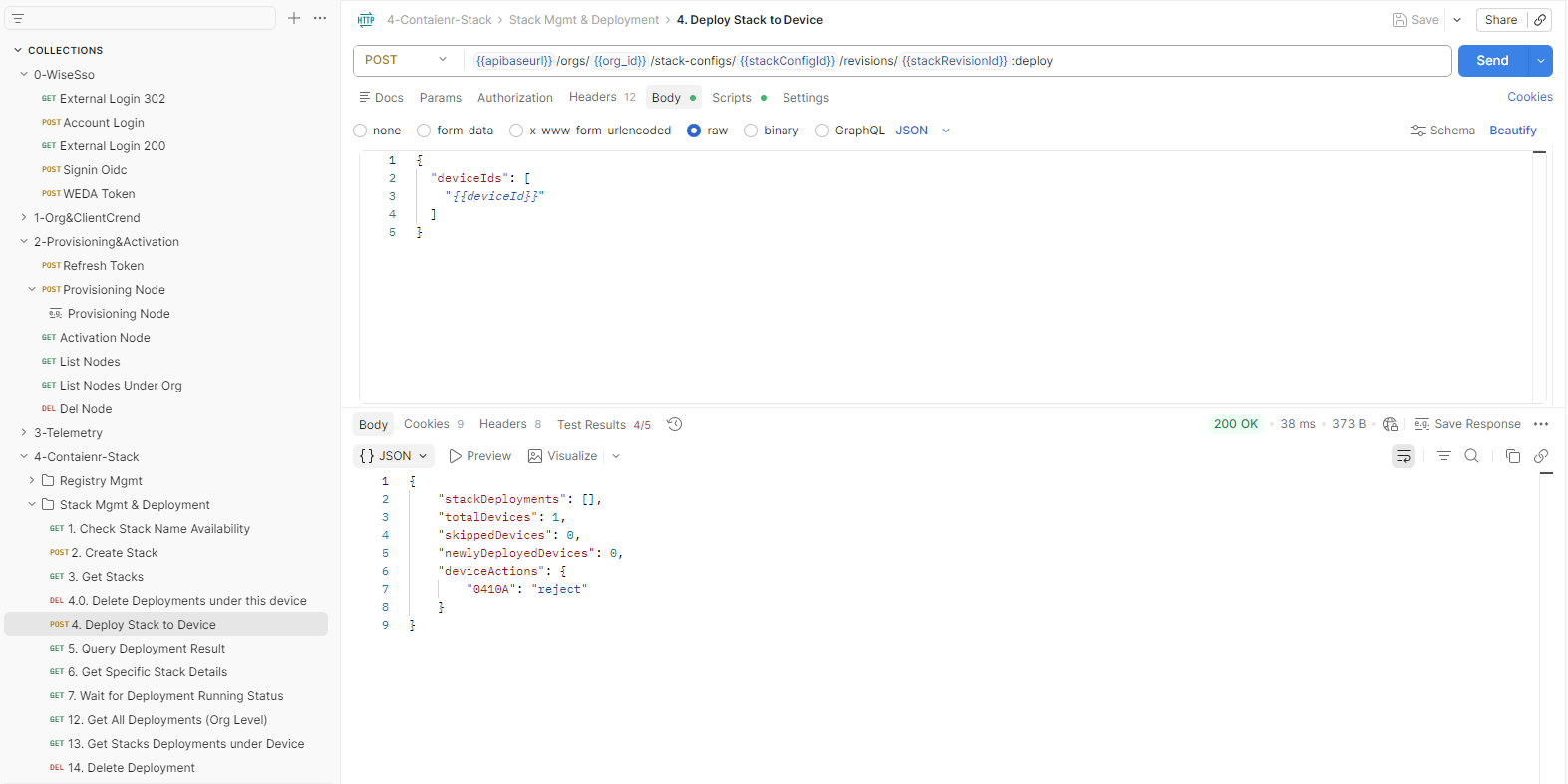

STEP 2: Deploy the Container Stack to the Device
2.1 Deploy the Container
Use the following API to deploy the container stack to an edge device. You can deploy the same stack to multiple devices by providing a list of deviceIds.
  1. Delete Deployments under this device: (Optional) Delete all existing stack deployments on the device to avoid conflict with the new deployment.
  2. Deploy Stack to Device: Deploy the stack to the device by providing the stack revision ID and device ID.
postman deploy stack
curl --location --request POST 'https://{domain}/{tenantPath}/weda/api/v1/orgs/3a1d40ed-4f97-aed8-c727-57704d3d5d2e/stack-configs/e700312d-18e9-4a93-b291-0108596b0a91/revisions/70e1771a-0fd3-4e85-9a17-6ea752f92d0b:deploy' \
--data '{
"deviceIds": [
"48b02d8861de"
Example Response
"stackDeployments": [
"stackRevision": "70e1771a-0fd3-4e85-9a17-6ea752f92d0b",
"deploymentId": "b4833ebb-ac6c-4a77-a075-e7ad0e036790",
"taskId": "c0383dfc-e918-41f3-997e-4f5fa1ace7d8",
"deviceId": "48b02d8861de",
"status": "deploying",
"containers": [],
"error": {},
"active": true
"totalDevices": 1,
"skippedDevices": 0,
"newlyDeployedDevices": 1,
"deviceActions": {
"48b02d8861de": "add"

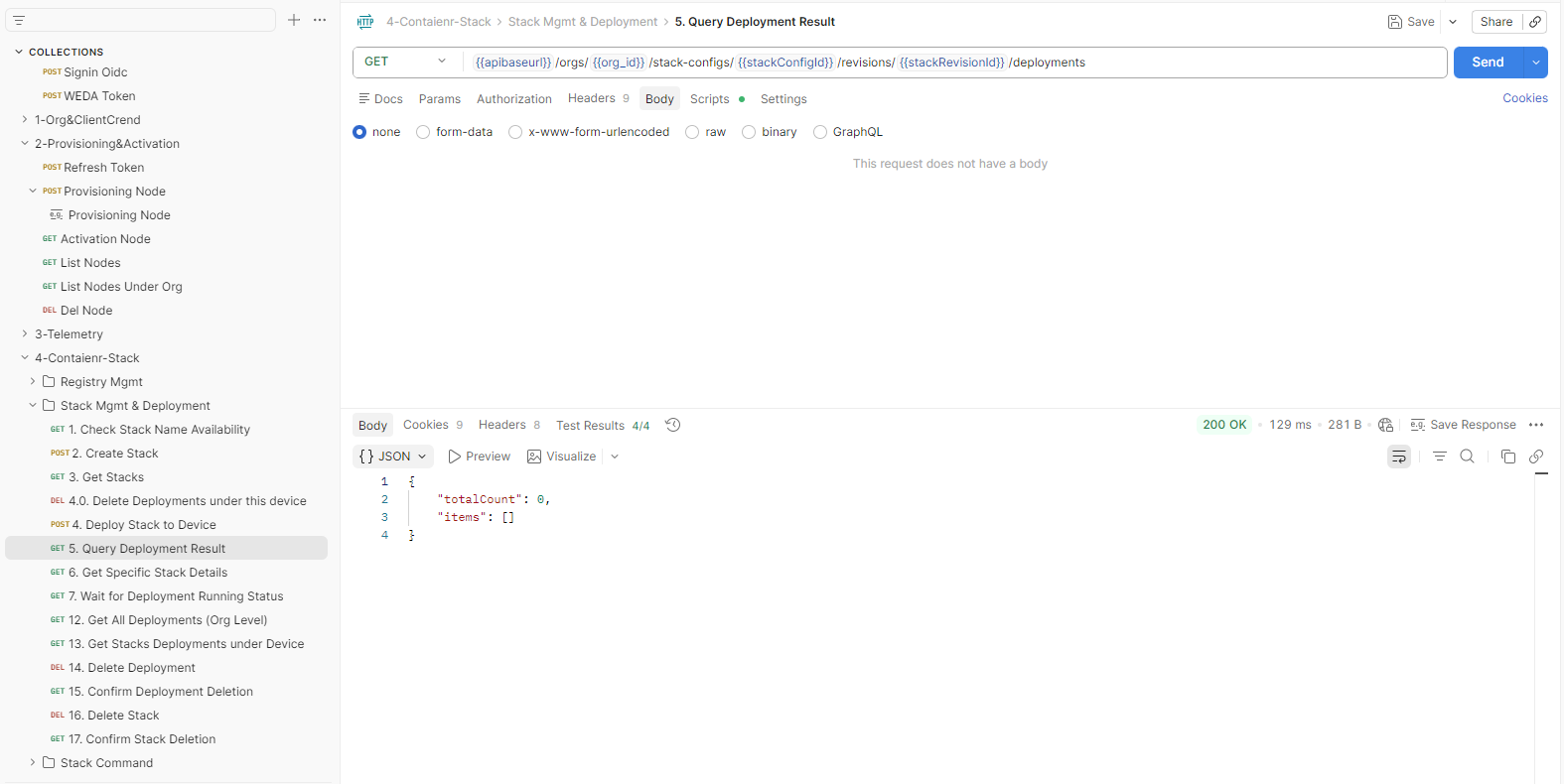

2.2 Check Stack Deployments
Use the following API to view active stack deployments and verify the stack status on the edge device.
Postman Collection: 4-Container-Stack > Stack Mgmt & Deployment & Stack Command
  1. Query Deployment Result: Get the list of active stack deployments in the organization.
  2. Get Specific Stack Details: Get the deployment details of a specific stack by providing the stack revision ID.
  3. Wait for Deployment Running Status: Wait and refresh the stack deployment status until it shows "running".
  4. Execute Stack Command (Pause): (Optional) Execute a command to pause the stack and check the stack status change.
  5. Query Command Execution Logs: (Optional) Query the execution logs of the stack command to verify the command execution result.
  6. Query Command Results - Without Range Parameter: (Optional) Query the command execution result without providing the time range parameter to get all execution results.
  7. Query Command Results - Latest Only: (Optional) Query the command execution result with a time range parameter to get the latest execution result only.
  8. Execute Stack Command (Resume): (Optional) Execute a command to resume the stack and check the stack status change.
  9. Get All Deployments (Org Level): Get the list of all stack deployments in the organization to confirm the current active deployments.
  10. Get Stacks Deployment under Device: Get the list of stack deployments on a specific device by providing the device ID.
curl --location --request GET 'https://{domain}/{tenantPath}/weda/api/v1/orgs/3a1d40ed-4f97-aed8-c727-57704d3d5d2e/stack-configs/deployments' \
Example Response
"totalCount": 1,
"items": [
"status": "running(1)",
"containers": [
"id": "586e6eb9-5f0c-4173-9c9e-937a50c45fa7",
"name": "advantech-yolo-vision",
"state": "",
"restartCount": 0,
"created": 1761891735912,
"errors": []
"error": {},
"active": true
If the response shows "status": "running", the container is successfully running on the edge device.
