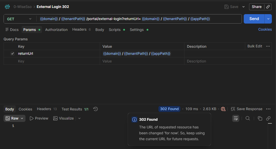

  1. External Login 302
  • Method: GET
  • URL: {{domain}}/{{tenantPath}}/portal/external-login?returnUrl={{domain}}/{{tenantPath}}/{{appPath}}
  • Description: Initializes the identity federation redirect flow and parses the query parameters to set client_id, tenantId, and redirect_uri environment variables.
  • Result: WEDA Cloud returns 302. External Login

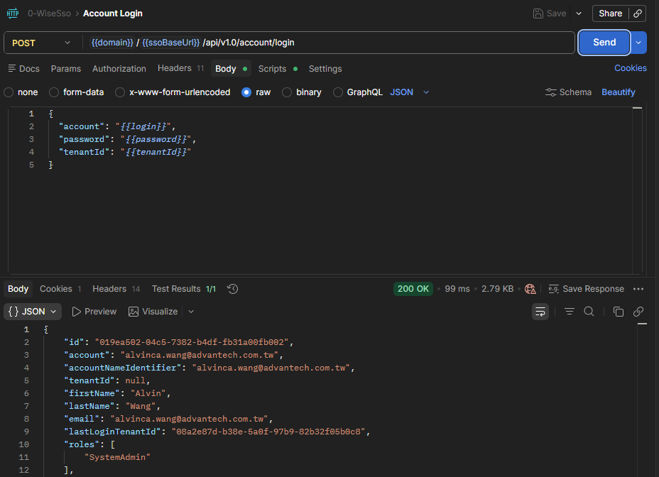

  1. Account Login
  • This step submits your account credentials to authenticate the user with the identity service.
  • Expected result: WEDA Cloud returns 200, accepts the login, and updates the authenticated session context. Account Login

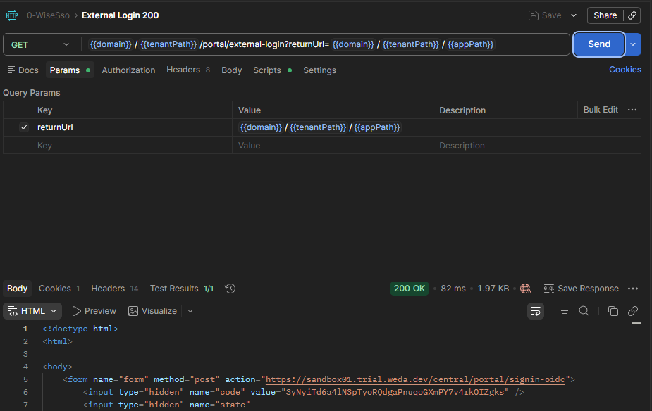

  1. External Login 200
  • This call completes the tenant-aware login return flow and confirms the correct tenant context.
  • Expected result: WEDA Cloud returns 200 with the expected tenant context. External Login 200

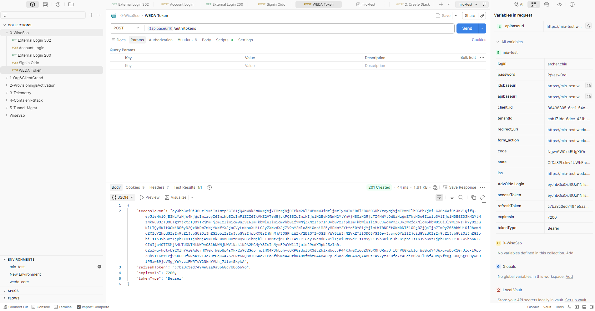

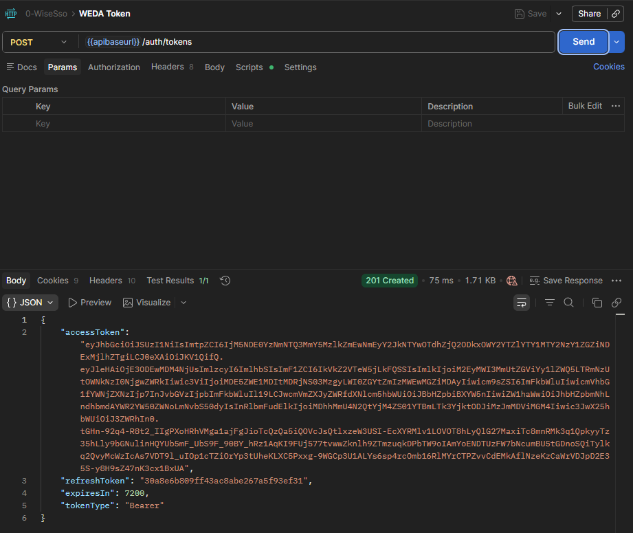

  1. WEDA Token
  • This final request exchanges the OIDC result for the WEDA access token used by subsequent API requests.
  • Expected result: WEDA Cloud returns 201 with a valid WEDA access token for subsequent API calls. Access Token

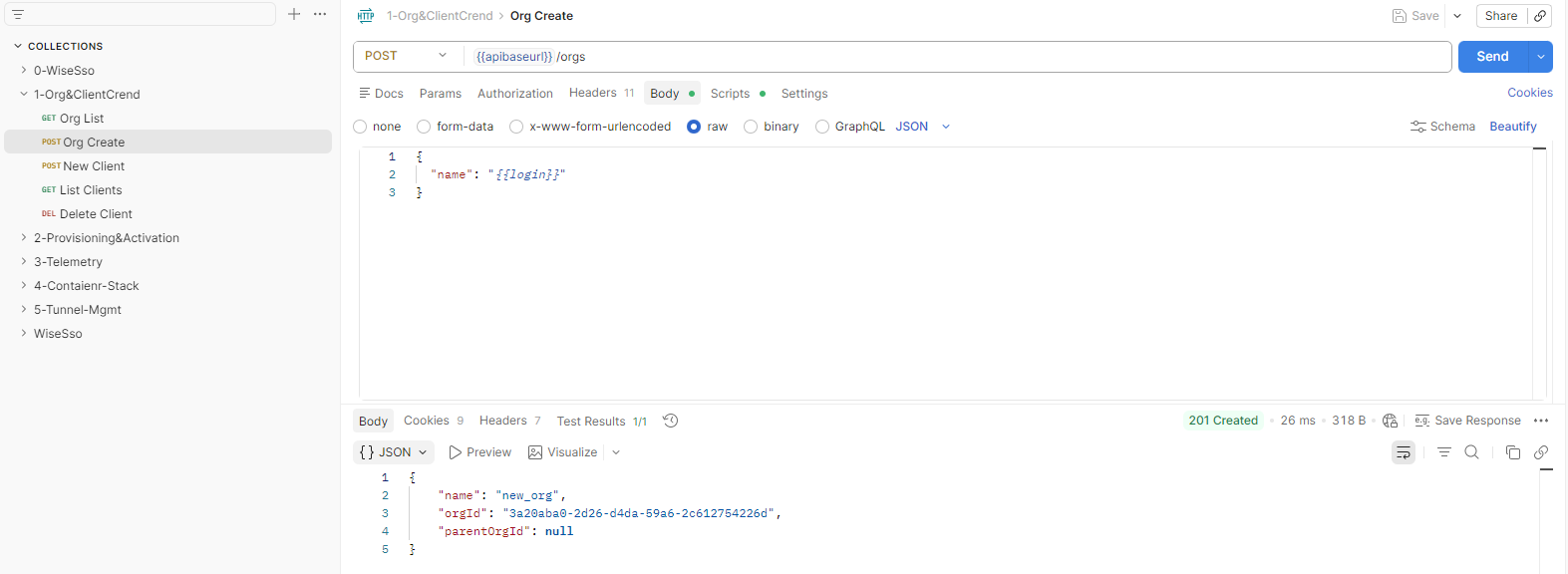

  • Org Create: Create a new organization with a unique name.
  • Method: POST
  • URL: {{apibaseurl}}/orgs
  • Payload:
"name": "someOrgName"
  • Description: Creates a unique organization associated with your login account. On success (HTTP 201 Created), Postman extracts the ID and saves it to your environment as org_id.
備註
If the organization name already exists, WEDA Cloud returns 409.
Postman org create

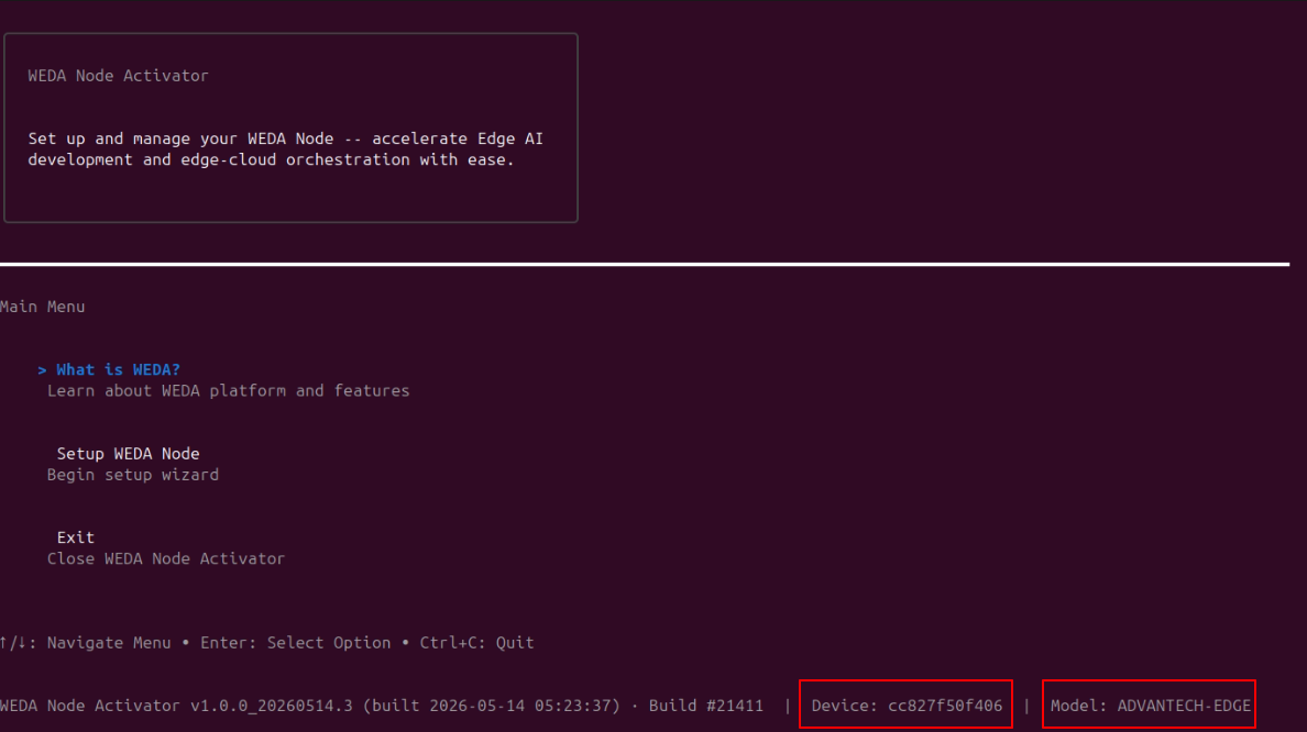

  3. Launch the WEDA Node Activator utility, a shortcut is created on your desktop after setup.
  4. Copy the metadata details from the Activator GUI (see below):
  • Device (deviceId): The device's primary MAC address formatted as a lowercase, continuous string with no colons or hyphens (e.g. cc827f50f406).
  • Model (hwModel): The local system model name retrieved from /etc/board (e.g., MIC-710 or UNO-2484v2).
  1. Save these values directly to your Postman environment under the variables deviceId and hwModel. activator_initial
  • deviceId: Find this value in the Device field.
  • hwModel: Find this value in the Model field.

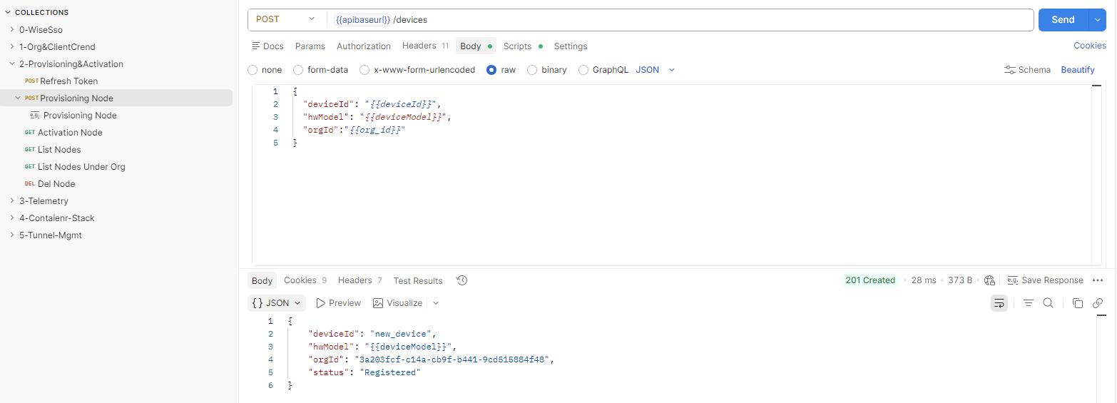

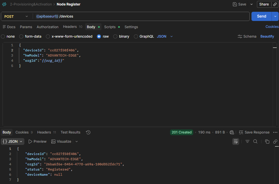

  1. Node Register: Create a new device under the organization.
  • Method: POST
  • URL: {{apibaseurl}}/orgs/{{org_id}}/devices
  • Payload:
"deviceId": "{{deviceId}}",
"hwModel": "{{hwModel}}",
"deviceName": "{{hwModel}}-{{deviceId}}"
  • Expected result: WEDA Cloud returns 201 and provides the registered device information. At this stage, WEDA Core recognizes the identity of your device. Its status remains Registered until the WEDA Node client daemon is launched and activated on the physical edge.

Example Response
"deviceId": "cc827f50f406",
"hwModel": "ADVANTECH-EDGE",
"orgId": "26ba6f6e-8454-4778-a69a-100d852fdc71",
"status": "Registered",
"deviceName": "ADVANTECH-EDGE-cc827f50f406"

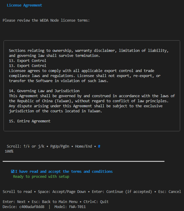

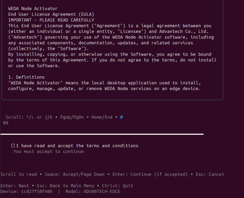

Step 2: Accept License Agreement​
step2
Review the End-User License Agreement (EULA). Press Space to scroll and confirm consent.

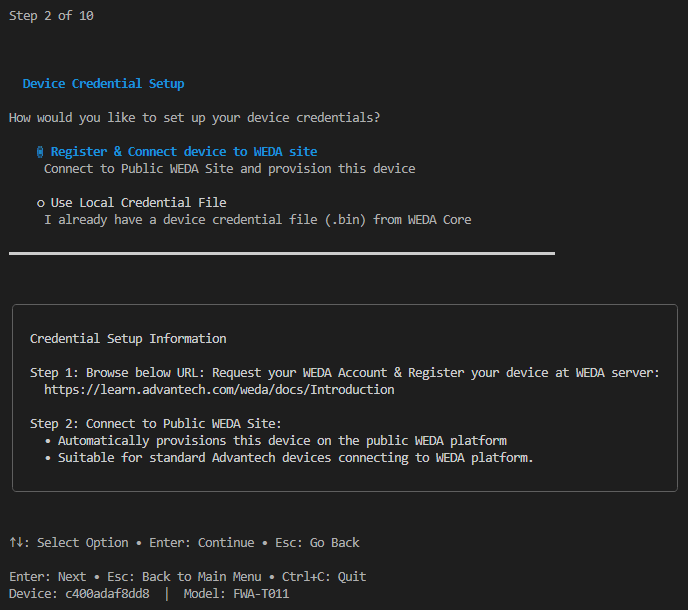

Step 3: Select Credential Source​
step2
You will be prompted to select how this device securely pulls down its central synchronization keys:
Ideal for internet-connected standard devices. It directly links the local WEDA Node to the public WEDA Core service over HTTPS using pre-built master keys bundled with the Activator. Select this option and press Enter.
Expected result: The device will automatically provisioned on the public WEDA Core service on upon starting the Activator.

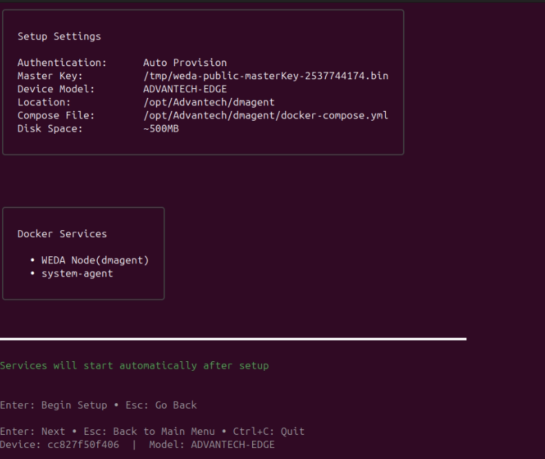

Step 4: Confirm Configuration Settings​
step9
Verify the displayed installation targets, target endpoints, network interfaces, and parameters, then confirm configuration.

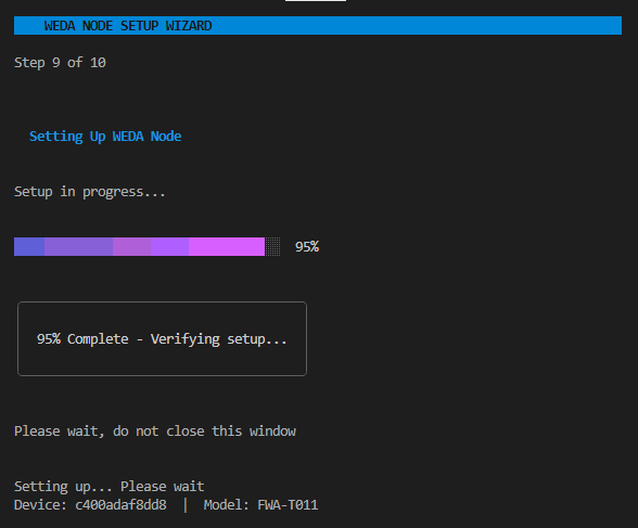

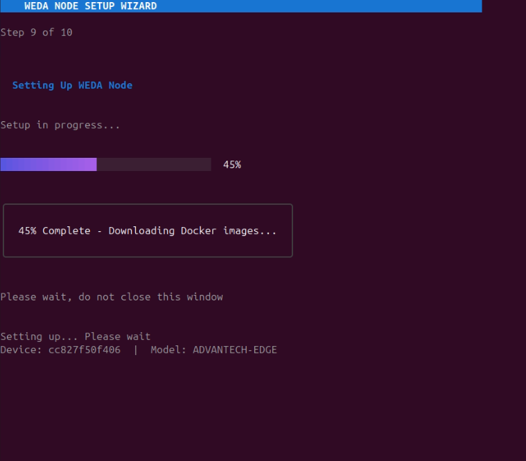

Step 5: Finish Service Connections​
The installer pulls the WEDA Node container images, sets up secure network boundaries, and spawns the WEDA Core client services. This takes roughly 2–5 minutes depending on network bandwidth. Do not close the console window or press Ctrl + C, which can interrupt this terminal process. step9
Expected result: Container images downloaded, started, and services running.

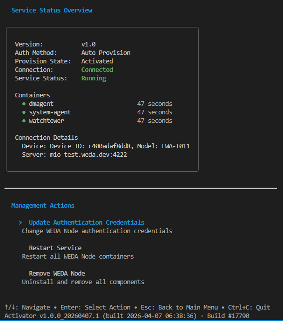

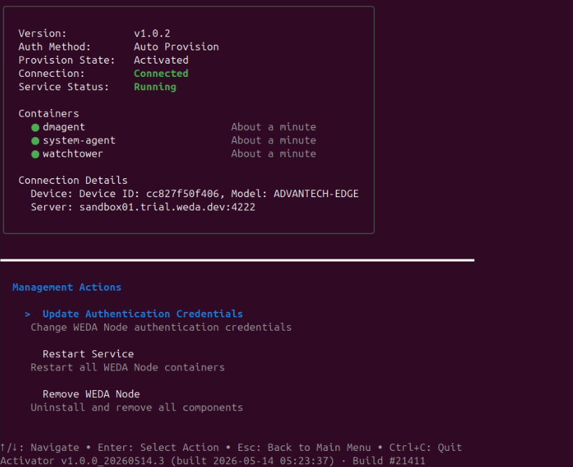

Once completed, the Activator launches the live WEDA Node Service Dashboard.
Service Dashboard​
Status icons:
  • ● green — running / connected / registered
  • ○ grey — stopped / unknown
  • ✗ red — failed / disconnected
Connection box color:
  • Green border — device connected to WEDA server
  • Red border — REG_FAILED or container not found
  • Grey border — intermediate states
The dashboard auto-refreshes every 5 seconds.
Management Actions​
ActionDescription
Update Authentication CredentialsReplace the master key or credential file without reinstalling
Restart ServiceStop and restart all WEDA Node Docker containers
Remove WEDA NodeUninstall containers, volumes, and configuration (type REMOVE to confirm)

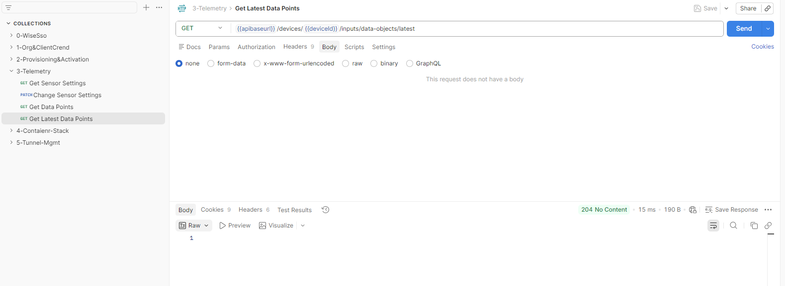

Each sensor the device reports becomes one DataStream. Reading a value is two requests: list the device's DataStreams to find the one you want, then query that DataStream's latest value.
Step 1: List the device's DataStreams​
  • Data Stream List
    • Method: GET
    • URL: {{apibaseurl}}/orgs/{{org_id}}/devices/{{deviceId}}/data-streams?skipCount=0&maxResultCount=10
    • Description: Returns every DataStream on the device, covering both system status and onboard sensor measurements, with the dataStreamId you need for the next request.
    • Expected result: WEDA Core returns 200 with totalCount and a paged items array. A typical WEDA Node reports around a hundred DataStreams, so raise maxResultCount or page through with skipCount to see them all.

Step 2: Read its latest value​
  • Data Stream Latest Value Get
    • Method: GET
    • URL: {{apibaseurl}}/orgs/{{org_id}}/devices/{{deviceId}}/data-streams/{{dataStreamId}}/values/latest
    • Description: Returns the most recent sample for one DataStream, within the system-defined retention period (default 60 minutes).
    • Expected result: WEDA Core returns 200 with the latest sample.
Postman get latest data stream value
Example Request: Curl
curl --location --request GET 'https://{domain}/{tenantPath}/{appPath}/api/v1/orgs/{orgId}/devices/{deviceId}/data-streams/{dataStreamId}/values/latest' \
--header 'Content-Type: application/json' \
--header 'Authorization: Bearer {access-token}'
Example Response
"dataStreamId": "e033b4b3-36e0-4dbc-a6e4-1e77185402f4",
"dataStreamName": "cpu_usage",
"dataType": "double",
"dataObject": {
"timestamp": "2026-06-13T19:27:21.9064265Z",
"value": 52.46
Key parameters:
  • deviceId: The target device for the telemetry query.
  • dataStreamId: Which DataStream to read — captured for you by the Data Stream List request.
  • dataType: Declares the type of dataObject.value.
  • dataObject: The sample itself — timestamp (ISO 8601 UTC) and value.

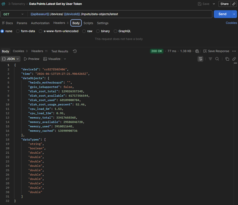

Other APIs in the 3-Telemetry collection:​
Note (Data Stream Historical Values Get):
To change the query time range, open the Scripts tab and set startTime and endTime. Both values use URL-encoded ISO 8601 datetime strings (for example, 2026-03-24T06%3A41%3A04.231Z), not milliseconds.
Default script behavior:
  • startTime: current time minus 1 hour
  • endTime: current time plus 1 minute

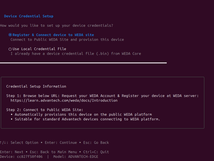

Appendix: Register by Local Credential File​
Use this method when you need offline deployments or pre-provisioned devices.
  1. Get Local Credential File: Download the credential file (.bin) for the device.
  2. Place the downloaded credential file on the Edge device, or confirm the exact file path before setup.
  3. In WEDA Node Activator, select "Use Local Credential File" and press Enter.
  4. At previous Step 3 (Credential Source), select the authentication method and choose Local Credentials Setup for this scenario:
MethodFileUse When
Auto ProvisionN/AMass deployment - auto provisions many devices
Local Credentials SetupDevice Credential (.bin)Single device with a downloaded credential file
  1. In WEDA Node Activator file picker, select the credential file (.bin) and press Enter.
  2. Verify registration is successful on Edge and Cloud sides (for example, service is connected on Edge and device status becomes Activated on Cloud).
Expected result: WEDA Node is successfully registered and connected using the local credential file.
Next Step
Congratulations! You have successfully onboarded your edge device to the WEDA framework by connecting WEDA Node with WEDA Core, and verified data telemetry. Continue to the next chapter to deploy AI Containers.
